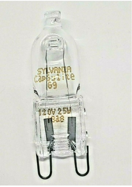

That is (possibly a copy of) an Osram sylvania 66725 oven 120v 25w 2800k g9 halogen light bulb
of which there seems to be a complete shortage of stock everywhere!
There are similar things available, but I don't know if they are rated for the oven environment, eg:
There seems to be confusion over the rating - for example, where did the suggestion that it was only 2.5W come from - you suggest the manual says 5W max, but I don't think they ever made such bulbs in 5W rating.

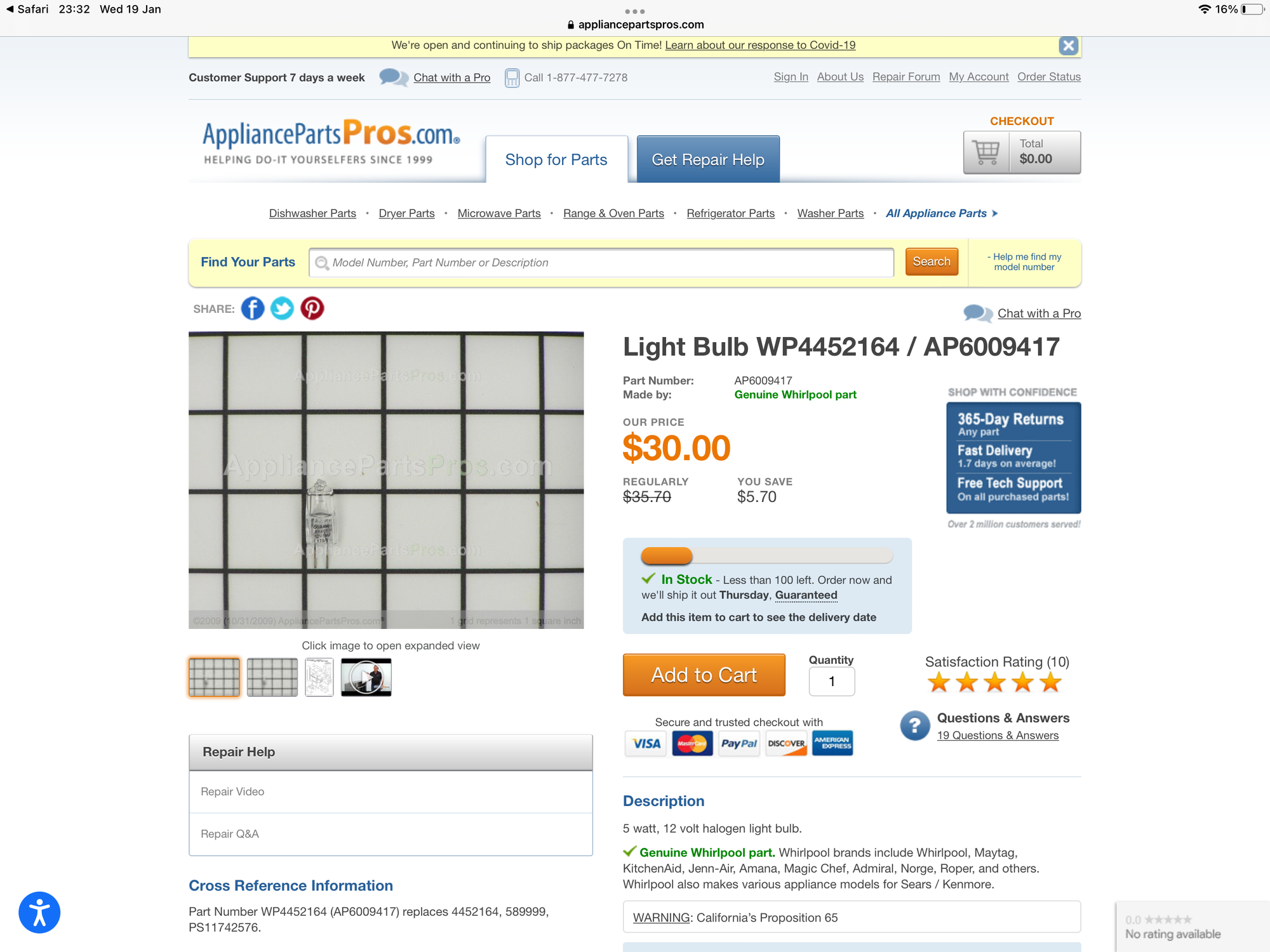

Manual for the appliance indicates 5W max. The original bulb is Sylvania Capsylite G9 marked what I read as 2.5W and 12 V. thnak you for the guidance. Unable to get any informaiton from the manufacturer Ktichen Aid/Whirlpool. Their site is selling a replacement bulb for ~34 USD.
Not really helped by the fact that the numbers and lettering are composed of printed dots, so difficult to say where the number ends and a decimal point, if any, begins. To me, it reads 120V and 25W.
The 120V can be checked by measuring the voltage or temporarily fitting any 120V G9 lamp, and 25W is about what I'd expect an oven interior light to be rated at.
I fitted a couple of 2.5W G9 lamps earlier in the week, but they were LED types, and the equivalent brightness to about 25W halogen.

On further research I see there are indeed Kitchen Aid/ Whirlpool ovens that do use 12V 2.5W or 5Watt bulbs, example below.
But the markings on such bulbs are very clearly just 12V - no spurious zero after the 12 for example, and they have a different G4 base.

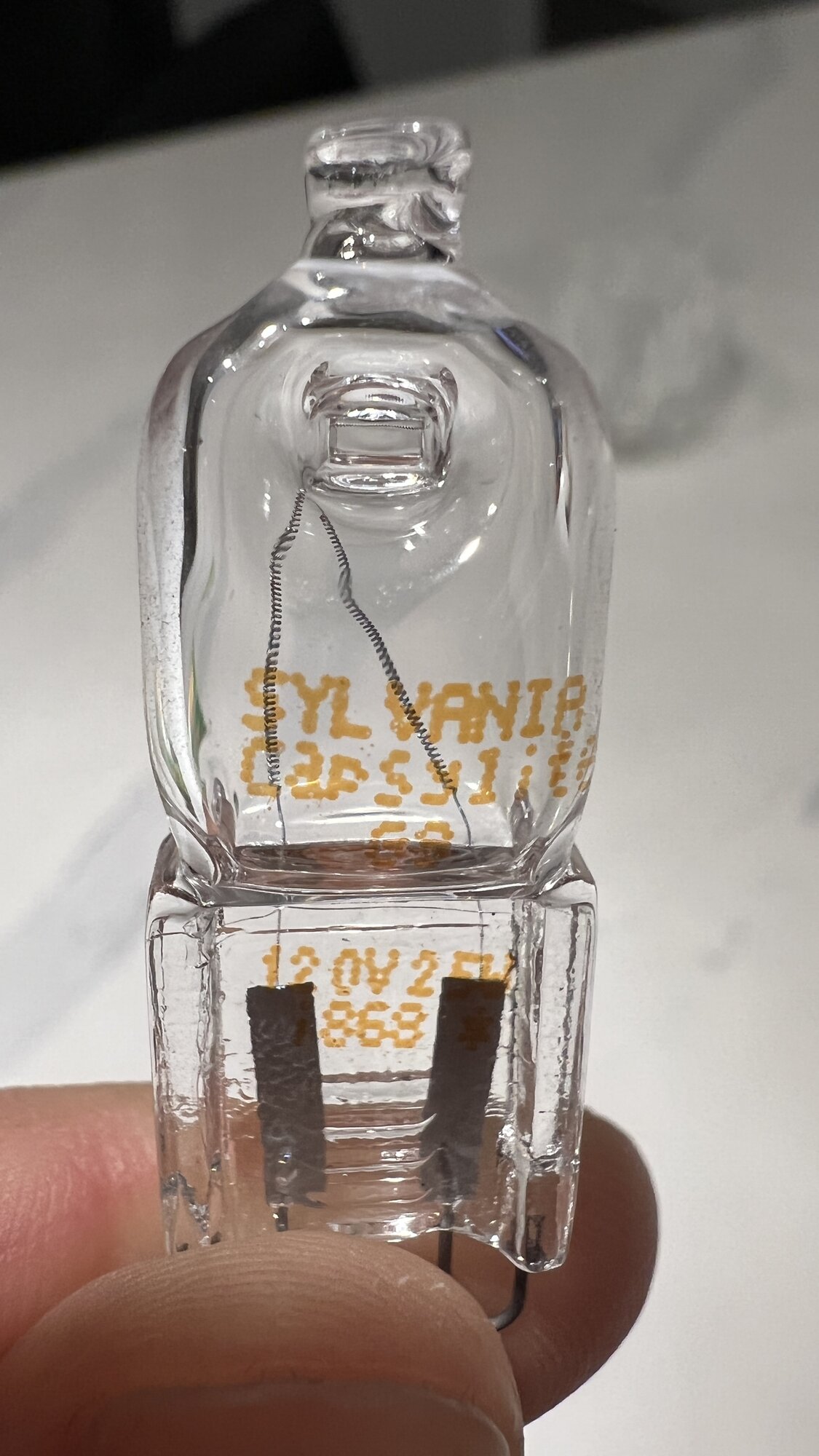

I have a Kitchenaid Wall Oven using the identical bulb. In the manual for the oven, it states “The oven lights are 12-volt, 5-watt maximum halogen bulbs.” I see a few posts here saying to get a 120v bulb and although misleading based on what’s written on the bulb, I trust the manual.

Is the bulb you're holding in your hand (post #23 ) out of your Kitchenaid wall oven? The filament appears to have failed, so is that one you've replaced? It appears marked G9 120V 25W. Have you replaced it, and if so what with?

The picture I posted is the original burned out bulb I am replacing. I ordered the G4 12v 5W bulb and it should arrive soon for me to try. Worst case the bulb bursts because it received more voltage and wattage that it can handle.

Yeah I'm leaning now towards just using what's written on the bulb as the spec. Getting a G9 120v 25W bulb.
Bulbs options: Example 1, Example 2
They look good. I would go for one that specifically mentions suitable for an oven (like Example 2), as it has to work in a slightly higher temperature environment than in a normal light. Otherwise their life could be shortened.

Hi all, to close the loop on this thread, I bought this 120v 25W bulb and it worked fine with my Kitchenaid wall oven. I guess the moral of the story is, don't believe everything you read in the operating manual!
