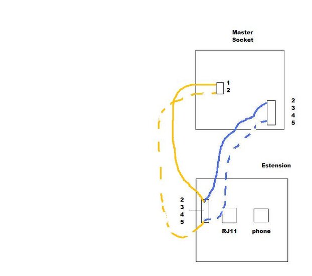

Hi, I need to move my router, and I'm stuck. :book:
At present it is connected diresctly to the rj11 socket in Bt master socket (Type 5: SSFP Infinity)
Bought a combined rj11 + bt socket from TLC and I'm using Cat5e
It’s only got 4 pins labelled 2,3,4,5 - I have connected 2&5 and the ring wire to 3 same at master socket,
Unsurprisingly only the voice works. See pic above.
I have 2 pins at the master socket for extending the adsl - question is where to they go on the extension socket I bought ?
I would ideally like to use what I have, should I just go and get a dual modular plate with a bt & rj 45 module (for the rj 11)
Thanks in advance for any pointers.

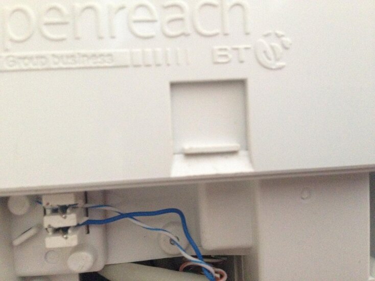

Not quite sure from the parts mentioned and picture what you are doing
I assume you have the BT NTE5 and the BT vDSL faceplate fitted at the master position if so you can take vDSL extensions from this faceplate using something like this for the vDSL modem
If you are adding voice extensions do not connect terminal 3 only connect 2 & 5 connecting terminal 3 can / may cause interference that will affect your broadband signal quality and speed

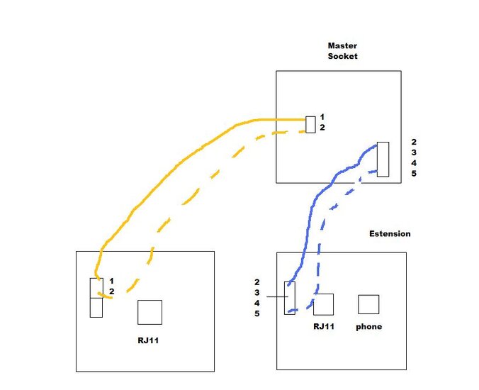

I drew this quickly on paint.
The left shows what your suggesting and the right shows what I have minus the ringer (which I have removed.
I’d like to use 1 cat5e cable in any case., and I can’t figure why they’d sell a dual rj11 + phone socket if it can only connect the phone not the vdsl ?? HA ha I must be doing something wrong.

You said that you had taken 2 and 5 from the BT socket to 2 and 5 of the extension?? as shown in your picture
If you have done that then only the voice will work as this is a filtered point for phone only.

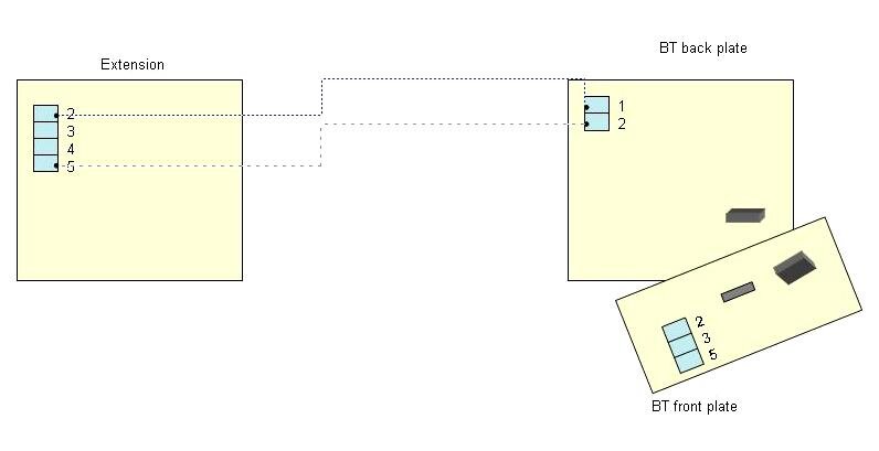

From your paint diagram you need to run from 1 and 2 (this is a different 2 to the 2 and 5, 2) on the BT socket to 2 and 5 on the extension socket.
Looking like I should not have replied!!!
The BT output i have identified as 1 and 2 is not filtered, i.e. it is sending both ADSL data and voice.
In order to be able to use this line then the signal needs to be split up in separate ADSL lines and voice lines.
to do this a twin filter is used, one filter blocks the ADSL and so this line is used for the phone, the other filter blocks voice and so this line is used for data.
You want to use both signals at a remote location, so what you do is send (from 1 and 2) both signals from the BT plate, unfiltered, over to the new faceplate.
The faceplate you have has the filters built into it. when a line is connected to the faceplate (to 2 and 5) the faceplate filters the incoming signal and distributes the correct information to the front outlets.
Therefore you will now be able to use both ADSL and voice from the new faceplate.

I suggest you read the OP and all the replies the pressac thing is the socket he was trying to use as an extension he has an NTE5 as his master connection
FYI the ADSL removable filters are useless on vDSL (infinity) connections which is why BT install this type of filter if you scroll down the link it shows the vDSL extension terminals and other phones can be wired from the small faceplate as normal

Glad you did, that’s worked a charm mate. :crowngrin:
Did a speed test I’m getting 68.Mbps
I phoned in and out of the line while surfing - no probs.
