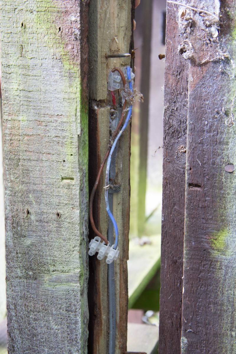

Found this outside light wiring in a decking balcony/fence, hidden under a wooden strip. Also note how close the nail is to the cabling.outsidelighting.jpg
