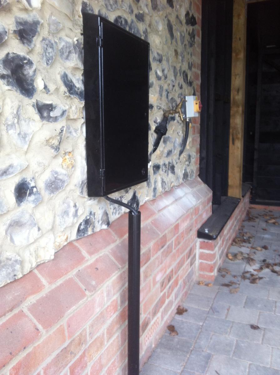

Re: Tell us about your faults !
Scary thing is the whole lot has fallen off the wall and is hanging on the incoming service. The service is almost completely bent back on itself.
Horrified to find that there wasn't a mixed wiring colours label either :)
