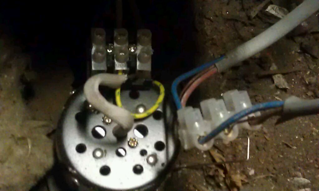

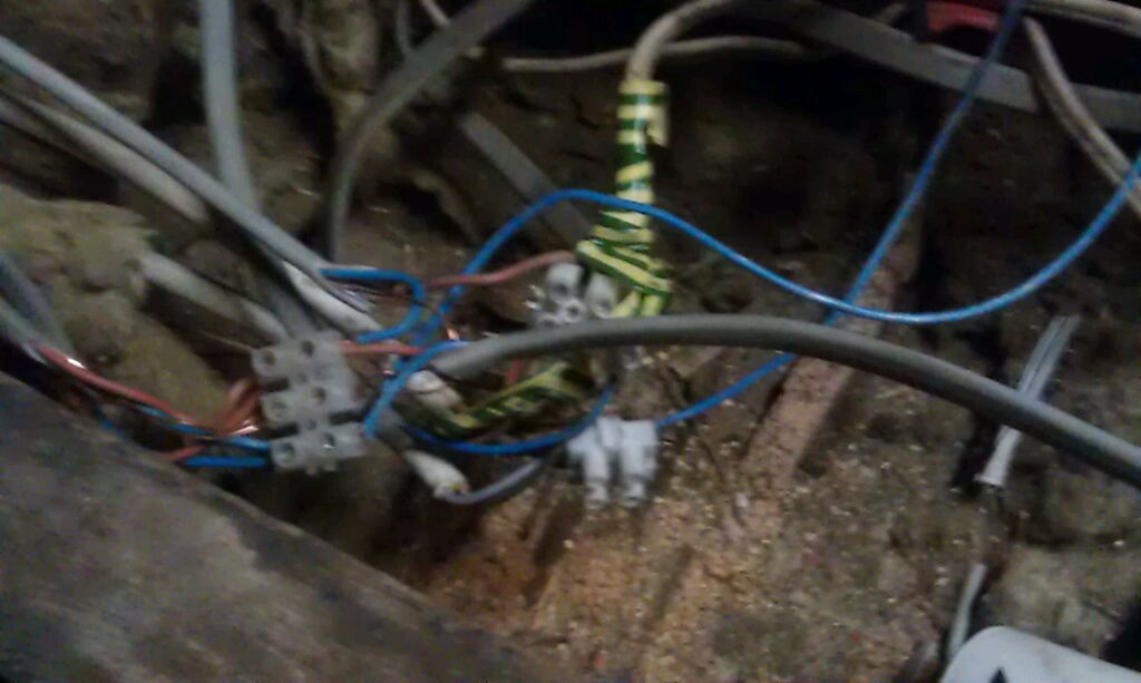

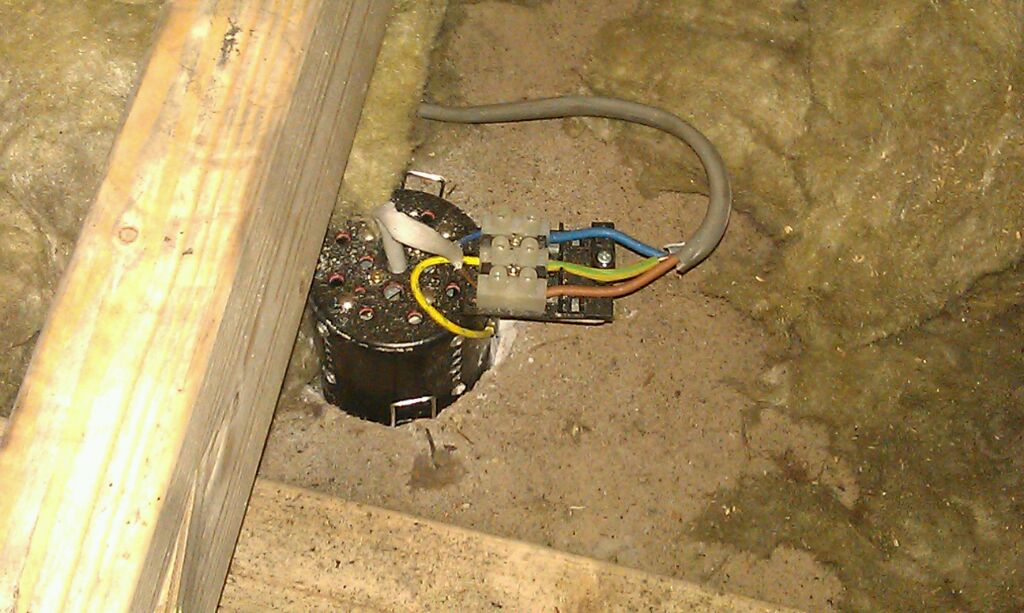

Completed a re-wire a few months ago and was called back after complaining that SKY box was powering off and mcb tripping. This was after the alarm/camera engineer had carried out some work. Checked in the loft to find a 4 way extension wired into the lighting circuit running an assortment of equipment including dvd recorder, router etc !

This house has two lighting circuits and each has an RCD (safety switch?). No problems on any power circuits in the house but one light fitting trips the RCD when light switch is turned on. It does not trip if there is no light bulb in the socket. Obviously all the lights on that circuit go out but lights on the other circuit stay on. If the RCD is returned to the on position then the other RCD trips. It seems that it only trips once current has reached the neutral side of the light socket. No wiring in this house is old or appears to have any damage. Has anyone seen this type of problem before? Thanks - all comments and theories welcome.
Can't say I have seen this sort of problem before,on a lighting circuit. but I would firstly insulation test the wires from the switch to the light and back to the CU. I had a similar problem with a ring circuit, it turned out to be a slight defect/thinning on the basic insulation covering the neutral, you couldn't neutral see it it was about 400mm further up the sheathing, manufacturing defect. The RCD would hold then trip when an a load was switched on, I had changed the CU to a split load double RCD by the way, it must have been like that since the house was built, but obviously not enough fault current to burn the fuse wire. Maybe you should check that the neutral at the CU for that circuit is terminated in the correct bank of Neutrals for the correct RCD Live in RCD A and neutral in RCD B That may explain the other tripping.

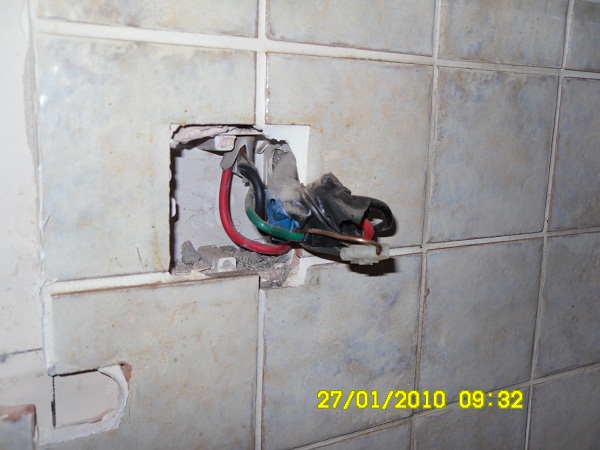

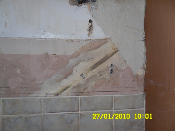

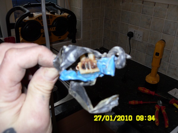

When I ripped out our old kitchen to fit a new one, the electrics were a mess, apparently my girlfriends ex husband had wired it as favour when they were divorced. I had to take pictures to show her. It also goes to show how incompetent people who think they know what they are doing. If it works, it's ok attitude.....
Copy of SAM_0167.JPG Cooker control switch
Copy of SAM_0169.JPGCable to the cooker control switch, notice the position the extractor hood was.
SAM_0163.JPGcooker connections...
SAM_0165.JPG I think I rewired just in time
SAM_0154.JPG Bonding connection, see next pic. notice the position of the double socket under the worktop edge on the top left. which the washing machine was plugged into.
SAM_0155.JPGThat'll do..... it looks like it is in the right place.....

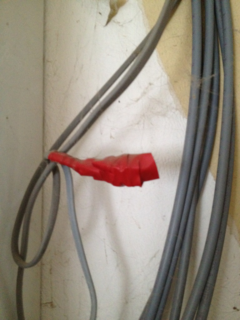

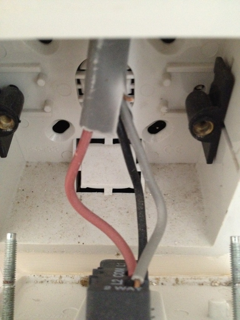

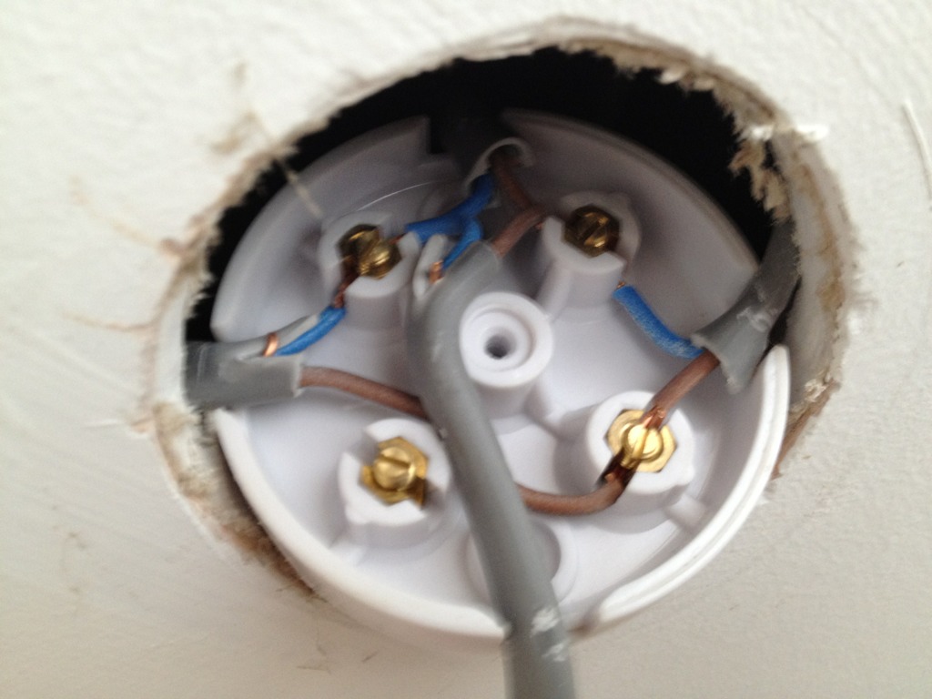

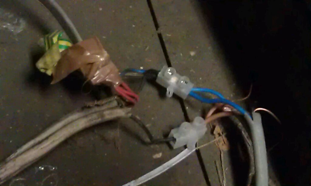

Been subbing some kitchens from a guy, he rang last night and asked me to attend a job where he had wired some cabinet lighting and some new spots for kitchen. Apparently when he turns kitchen lights pñ the bathroom ones glow, and when turn bathroom ones off the cabinet lights go off too, even when operated individually. Had quick look today and this is what ó found in the loft
Sent from my HTC Desire S using Tapatalk 2
Also found extended washing machine power cord, using crimps and black tape under the sink, all socket fronts hanging off with all conductors stripped too far and showing exposed copper, all live and being used by customer, you cpuldn make it up
The above pics of cable birds nest has really got to be seen to be truly believed. He then , after I told not do any more electrical, had the cheek to say just tidy it up, dont spend too much time on it. My immediate fesponse is not fit to quote, but needless to say I will spend as long as it takes, I think this may be last job i do for him
