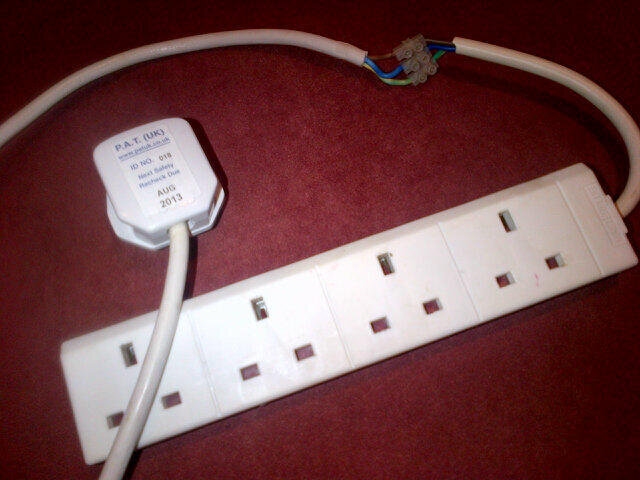

I taught a PAT Testing training course in a hotel last week. My customer, who organised the course, had told the hotel staff I was coming, and it seems they panicked, and booked somebody to come in and test their own stuff. I think they were worried in case I noticed that they hadn't had it done!
Anyway, it appears it backfired, as they phoned around for quotes and went with the cheapest....
When I arrived I was shown the AV cupboard, so I could plug my laptop into their projector, and was invited to plug into this lead! (see picture)
Mostly, when things like this crop up, the PAT Testing company say 'it must have been done after we tested it' but in fact the testing was carried out at the end of August, and the manager told me specifically that nobody had touched the equipment in the cupboard since the PAT Testing had been carried out.
Needless to say, the hotel are now wondering whether they can rely on ANY of their PAT Test results. If anybody gets a shock from ANYTHING in that place, they're going to be in big trouble.
You pay peanuts.....

That is just out right incompetence at its finest, if I were the hotel manager I'd be on the phone to P.R.A.T (uk) and be going mental at them, or get them back to do some more but set a trap.
Reactions: 1 person
Yep you are telling me something I already know as I have added PAT to my services and plenty of examples for the sticker brigade the most common is the bedside or table light with the 13 Amp fuse in them instead of a 3 amp.
A letting agent said how come you find things other people dont and I reply well if you want me to do it then it gets done right and remember thats the whole reason for PAT testing to make sure the correct fuse is fitted. Thing is I was in one house and founf 5 13A fuses so did this happen between the 2 tests NO this happened over 2-3 years ie lamp goes and takes fuse with it the tenant firs a 13A because thats all he has then this gets repeated over the year.

I have seen lots of this before, the 6 or so times that I have seen the connector block one have all been in portacabins and staff canteens where for some reason they have a double socket inside the under sink cupboard, there's a tea water urn on top of the worktop next to the sink beside the window and there's a hole drilled in the worktop, the flex is cut and put through then rejoined with a section of terminal strip and plugged in, with the terminal strip left flapping about next to the leaky drip and the tins of polish , spare handwash etc....ideal for somebody to have a feel about looking for something and grab the bare ends or a terminal connector with a wet hand....
I got rid of this socket a few times and one time was told Oi ! leave that it stops people from unplugging the hot water urn.....
I failed a few grills and ovens before that were badly damaged and abused and had things like 1.5mm yellow 110 flex on them joined with tape wrap, they were put straight back into use within 20 minutes and I was told to clear off and leave them alone...
