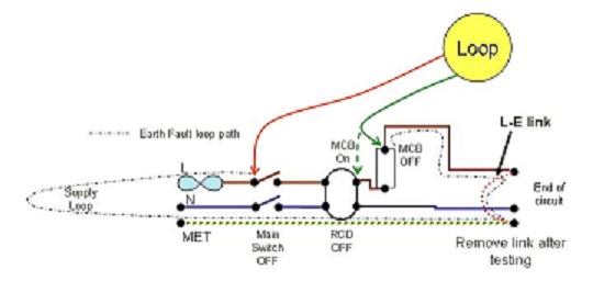

Hi
I bought a holiday lodge last month and decided to test the circuits to see how they measured. The lodge itself is fed from a central point in the holiday village by a 16mm PVCSWA. The main earth wire terminates into a MET it looks to be a 10mm earth that is crimped onto the incoming earth, I cannot see what its crimped onto as the head the mains terminated into prevents this. Anyway I carried out the the normal tests on the circuits R1 R2 RN and these tested all within the expected parameters as an example the one of the rings measured R1.24 RN.24 R2 .39 and R1/R2 .25.
The other circuits all tested within expected parameters. The Ze measured .6, however when I powered up and did a Earth Fault loop impedance test the machine measured 23 ohms, this was repeated on all the sockets and the same measurement. Assistance required please as to the possible reason (s) for this.

I would put my bets on RCD uplift as @telectrix suggested, I had some BG ones a while ago that made some circuits wildly high Zs.
If you can do a bypassed Zs on the circuit that will prove it one way or another. To do this I isolate the supply then put a R1+R2 link cable in between live and earth at the furthest point on the circuit in question. Then put the tester on high loop and place between the outgoing circuit feed and the non isolated incoming live, this will give you a non uplifted reading to compare with your current one!

here is a method.you turn off the RCD and/or MCB. short L-E at point you want to measure. them MFT on hi current Zs setting (2 leads).bridge to RCD.MCB with the meter. this will give you a true Zs.
don't forget to remove the short before re-energising.

something like that. the higher current helps to get past tarnished contacts, that's why low current test often gives slightly different results. ( well that's my theory, anyway ).
