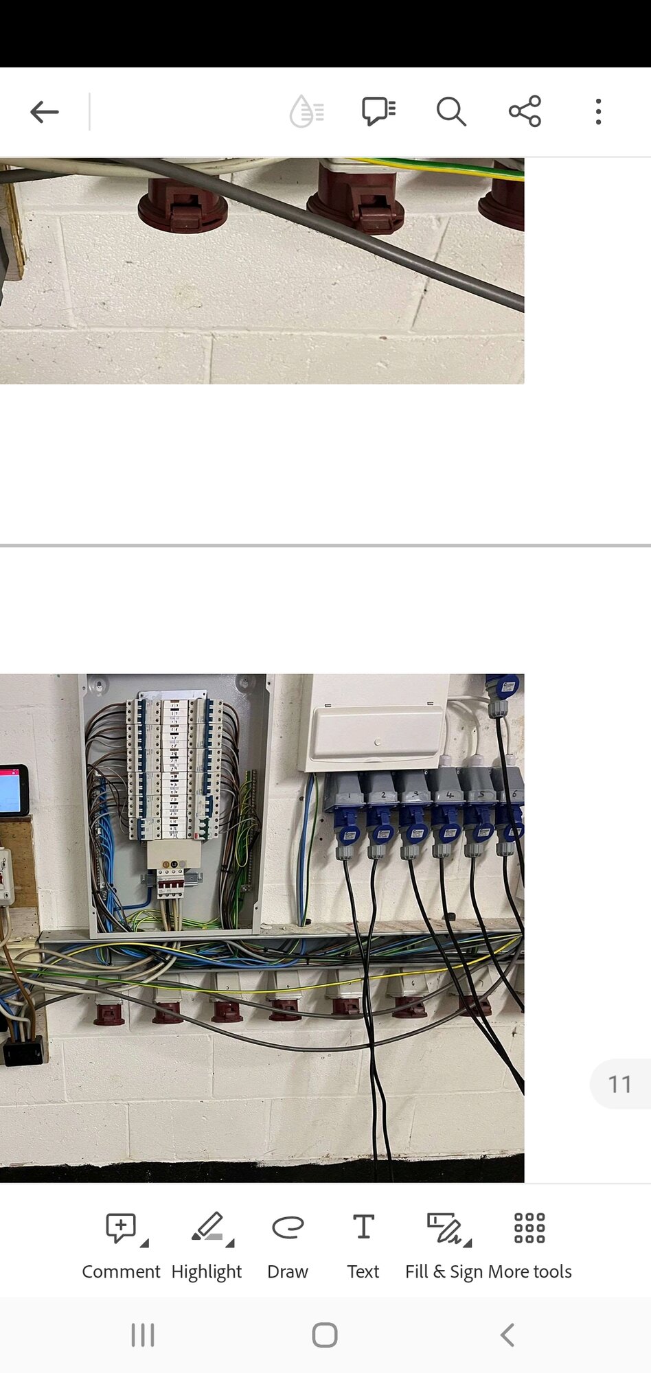

L2 in that three phase board loo from the electrical
No, definitely not.
The fault you show is of the top (input) of a single phase consumer unit. A 3phased balance load would not have any bearing on the fault IMHO.
The damaged cable is a 'red herring', I believe as the clamp being insulating material there would nothing to make a circuit and cause a 'short'.
I would think the DP Isolator has failed and there has been a L-N 'short' within the isolator, or maybe a stray strand!
The clamp is mild steel
Only going to know for sure with photos of the back of the clamp and back plate, if there are no marks i would agree and internal failure of the isolator comes into play, then was it caused by a loose connection or an internal failure of the DP Isolator. I saw the split in the tail on L2 supply and blamed the clamp (until proven otherwise) - it possible the heat generated by a loose connection compromised the tail insulation, hence you would need to see the components to work out what went first.
However i think we all agree unless the CB in the TP board is welded shut, then ADS should have saved it from this mess if it was indeed overload. (assuming the SP board is fed from the TP board) - i cannot tell from pic
L2 in that three phase board looks like its got hot too?
Could that have come from the electrical fire in the box we had it was cleaned up but initially there was a load of soot and detritus all over the box
I cannot see a SP breaker in the TP board to feed the SP board, so do the tails go to the Henleys and then straight to the incoming fuse? - If so i assume (again) this is either a 80A or 100A TP supply?

Yes the cover of the board was blown off and there's a lot of black soot all over the switches so clearly a lot of heat was generated
The cover was blown off? Really?
Reactions: MFS Electrical
Yes 100% he took them out and put them back in again
Certainly not a standard thing to do on an inspection.
When you do the 2391 (inspection and testing) you are told to disturb as little connections as possible to ensure you don’t create faults.
It’s highly unlikely that the electrician would have removed the tails and reterminated them on an EICR (inspection)
Also, the picture you’ve posted looks like a single phase main switch?
An overloaded board but it's run fine for 5 years and it just happend to blow a few hours after they wiggled the wires plus each phase is perfectly balanced with 9 feeds

Morning the best evidence I can produce is that we had perfect balanced system un stressed working well and a few hours after someone did work on it the system failed I do have a video of the electrician who came the next day to rectify on the phone to the office saying "it looks like we've nipped the outer casing when we put it back" and her boss saying is the main fuse that blew on the same line as the breaker......they know they've balls'up but that'd why I so great full to you guys as I'm not an electrical engineer and they are trying to lead me by the nose to bankruptcy

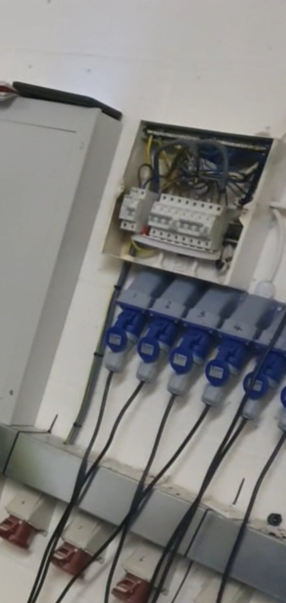

That single phase board doesnt appear to be fed by the three phase board, so at some point L2 looks to have been loaded up, or loose, with the visible heat damage there, but is possibly un related, theres just so many unknows here for us, which board are you saying blew off the wall? If you could post the report on here with the inspectors details redacted that may help, but im not so sure. You mention data loss, was there no off site backups? Or ups? Or anything to alert you to the supposed high temperatures in that area by the fans not working? I may have detsils mixed this threads getting a bit long now
Reactions: DPG
The Sp consumer unit is fed from the Henley block.
Op - Please could you confirm whether the feed to 3P board second from left which looks discoloured is L1 or L2. Is this feed actually discoloured from overheating?
How do you know your system is perfectly balanced? Why is that board fed in tails? Generally heavily loaded single phase boards would indicate the system is unbalanced in my experience. I can’t really see why the spark had the tails out for testing either, just doesn’t really make sense.
Edit- no answer to my previous question either, did the cover actually blow off? How did that happen with threaded screws on the cover, did they break? Do you have a picture?

There's a pic of inside the box there's black all up the rhs and inside it's black and scorched

There's the best I can get of the burnt tail after it has been taken our
But thats all hanging off that single phase board, so i dont get why you keep talking about phase balancing? How many amps are each of those servers drawing? If the full or near to the 16A that is mighty loaded, With that board connected straight off the henleys i wonder what the upfront main fuses are. Are they greater than 100A?
Hi 5 amps a unit and yes the fuses are 100amp per phase there's a small drawn through the main board to run the fans but it's tiny
