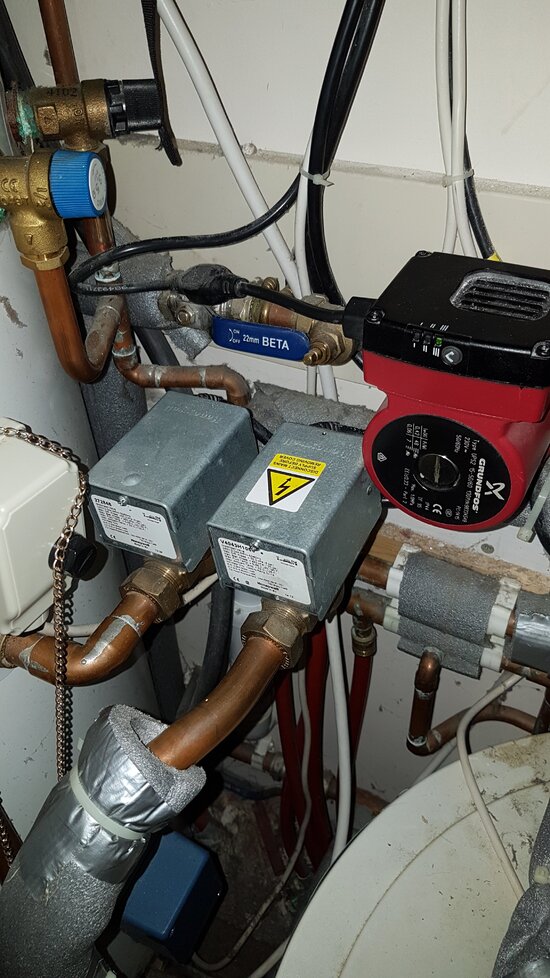

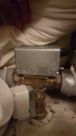

Pics as promise, turns out I have a 3 port valve on the buffer tank. The 2 port valve with the warning sticker is the one stuck on manual.
This was taken when both heating and hot water are on, the water pump is working as is the heating (as the hot water is on)

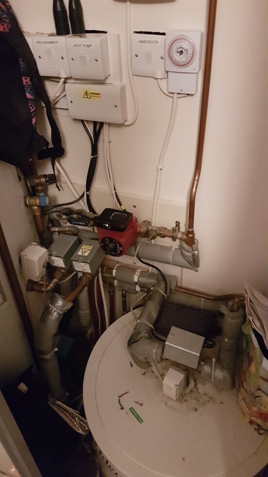

The one on the wall next to the switches.
You'll probably find a multi core flex going from there to the HP.
One core will go to terminal 9 on the HP and the heating MV should be connected here also.
I'm not sure what the three port is doing, especially in the position it is. Might be a return diverted.

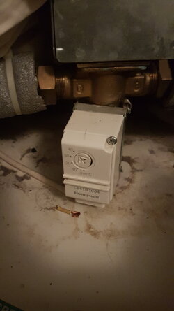

It's difficult to see whats going on in that photo otherthan there is a call for heat as the pump is/should be running. I've never seen a buffer used like that before. What room stat do you have?
It's a Honeywell but it doesn't appear to be working (heating is on no matter temp on stat) EDIT, scrap that, it works fine:

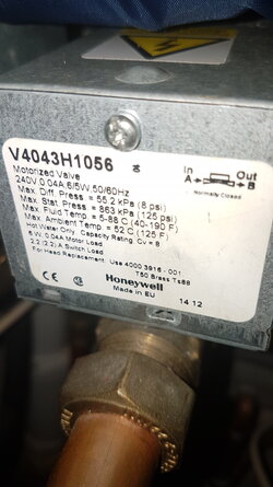

What solenoid valves do you have and their type - just post a picture of the label on them or the part number and make.

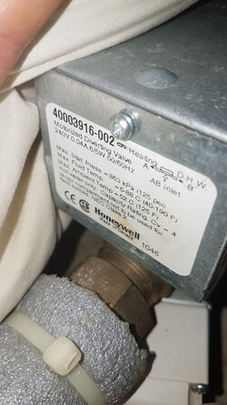

The third pic is of the 3 way valve, it doesn't seem to work when hot water or heating is on (had the cade off when it was running, no movement on the valve) this is on the buffer tank
15702925454729099408404481090219.jpg 15702926341375235744937405277492.jpg 15702927328101080254114779878475.jpg

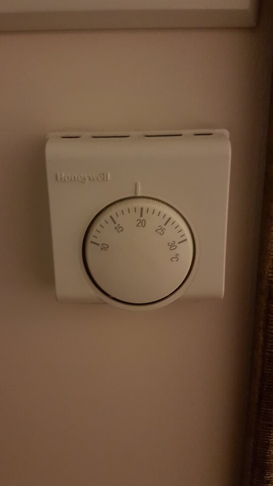

Please confirm whether there is a 'stat on the buffer tank - I'd expect to see one.
The programmer does have HW and CH selected to on and either in a timed on period or sert to constant?
No don't do any measurements.
So the fault is that the ASHP will never run up in demand to a space thermostat to warm the water in the buffer tank?
That's correct there is a stat on the buffer tank, all pumps and MVs work when heat is called for just not the heat pump.
And yes the programmer works correctly.
See pic of stat on buffer tank and stat on HP itself, HP turns off when this reaches 55.c

There is a rectangular junction box with a yellow warning stick on it near the tanks and valves. Could you carefully remove the lid and take a photo of its innards for me?
