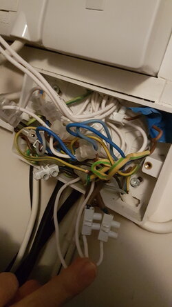

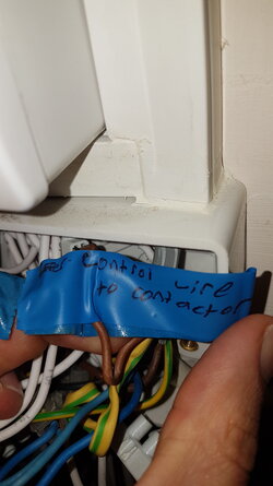

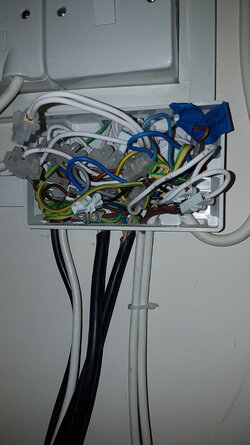

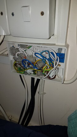

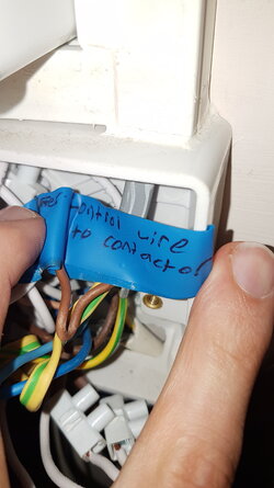

Are you able to post a photo of the innards of the JB I mentioned?
Ah sorry I forgot, it's a bit of a mess (not my making!) I tried to take as many detailed pics as I could but some wires are short and a bit tangled
20191006_134512.jpg 20191006_134614.jpg 20191006_134635.jpg 20191006_134710.jpg 20191006_134948.jpg
In #53 could you clarify please into which terminals the set of 3 white wires are connected which are to the right of the second earth terminal numbered 7.
View attachment 52898 View attachment 52899 View attachment 52900 View attachment 52901 View attachment 52902
That shows VERY poor workmanship. I am currently in the home straight of recovery from diarrhea which is why your problem has been such a welcome distraction! It is such a mess - your wiring, I am minded to travel down to you and investigate with you rather than remotely. I me no insult to you, but I have probably gone beyond the limit of 'step-by-step- with you through the EF. So would you like me to visit once I am recovered? Chichester is where you live? I am not far from the Dartford Crossing. I have started so would like to finish. No insult to me if you want it fixed sooner by someone esle. Would you just pay my diesel there and back?
