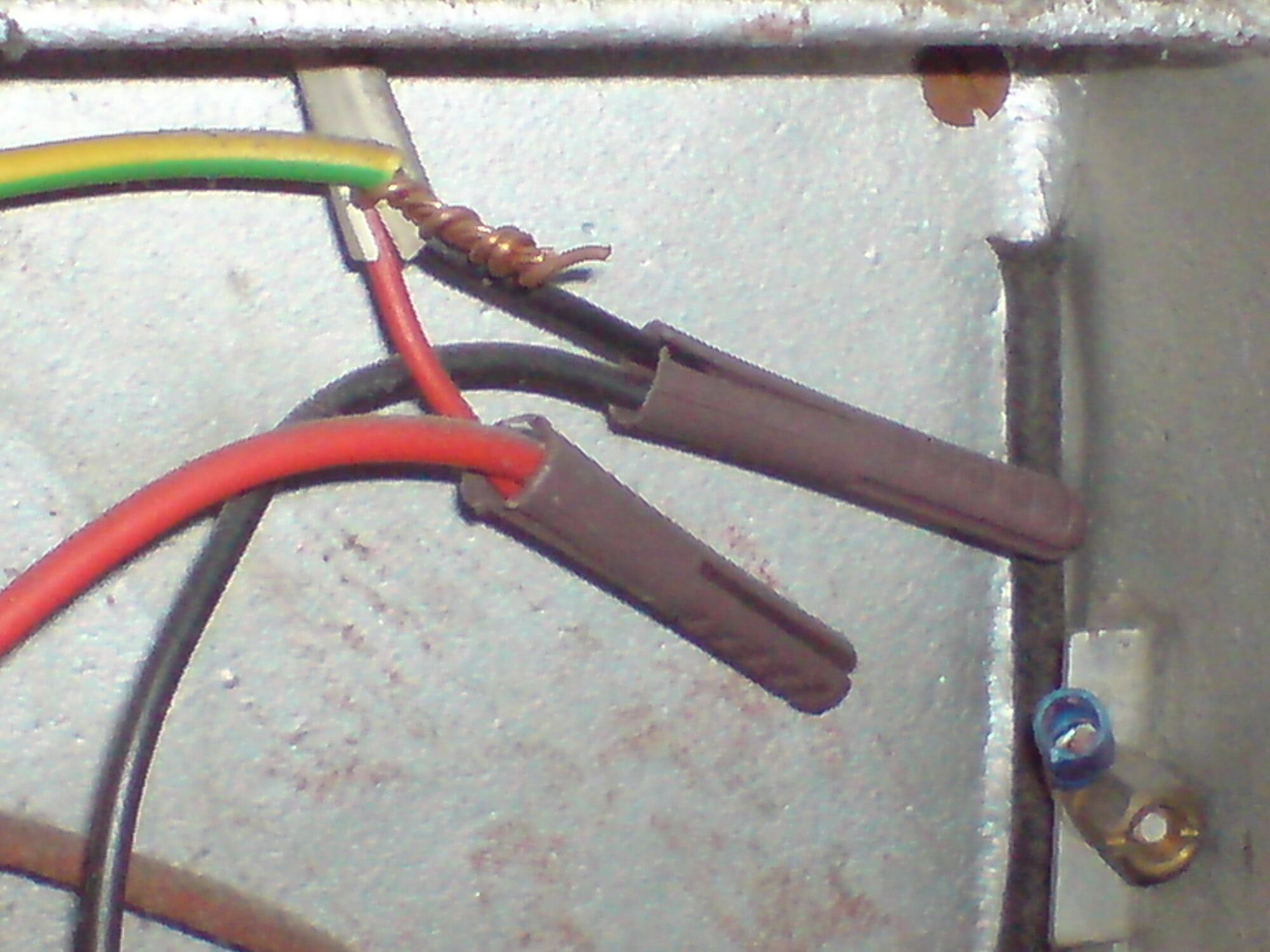

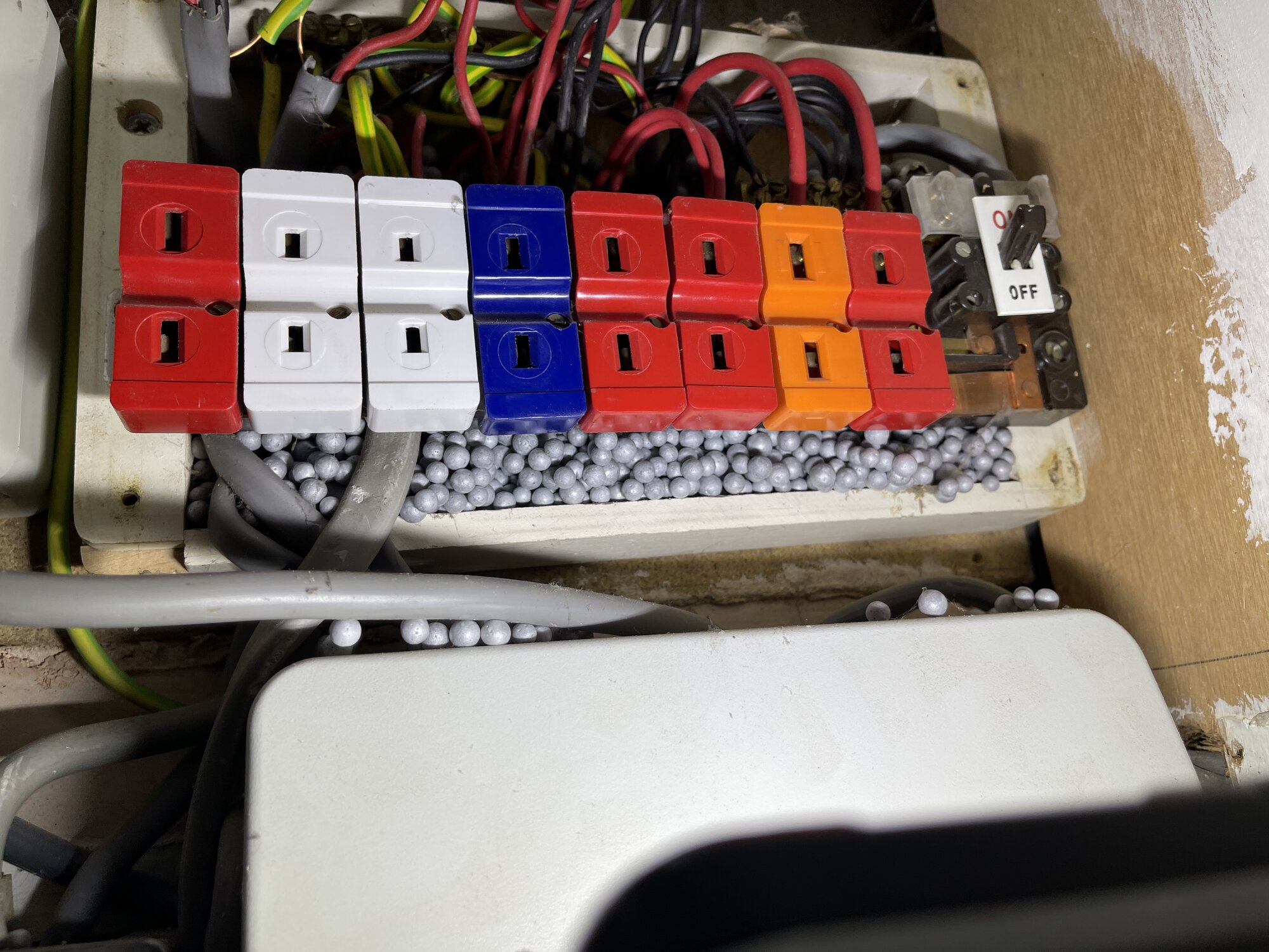

I've seen the old twist and tape done many a time, even on socket circuits which have been like it for years without a sign of arcing pitting etc
Oh yes I have seen 100s of twist and tape jobs which as you say have been in a wall or under the floor boards for decades and in full use without issue

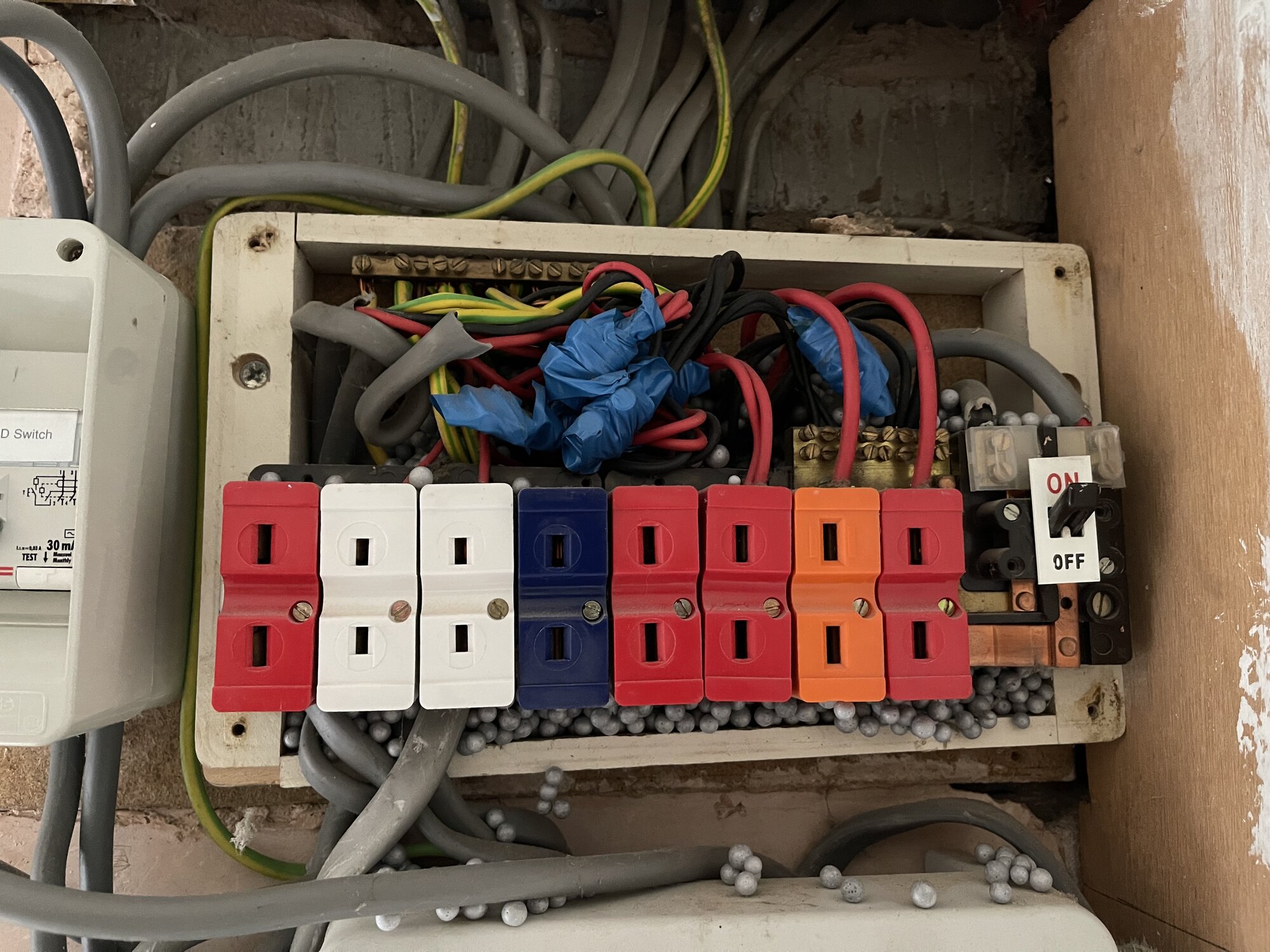

I was questioning the use of brown wall plugs which I thought the OP might have stuck over the cables as a bit of a 'joke'

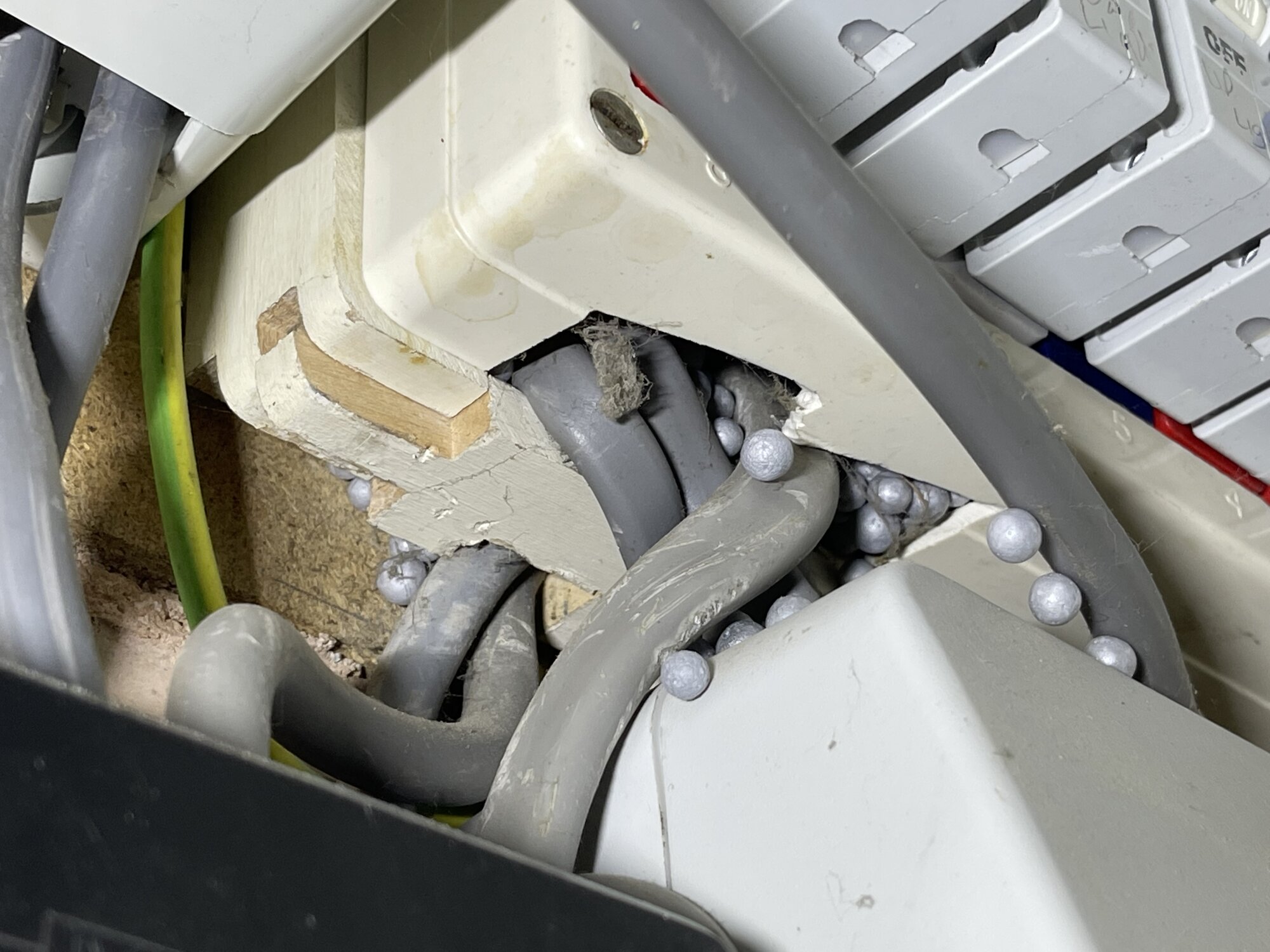

If they are polystyrene balls, the whole cable installation is scrap.
if they are polypropylene then it is just the thermal effects you have to consider.
I am told it’s polypropylene. It was only done in Dec so I’d hope it was to modern standards. But I’m not sure how I could prove one way or the other.
Client is going to check with the company that did it. I hope they have good insurance that will cover removal and a possible rewire if it’s the former. 😂

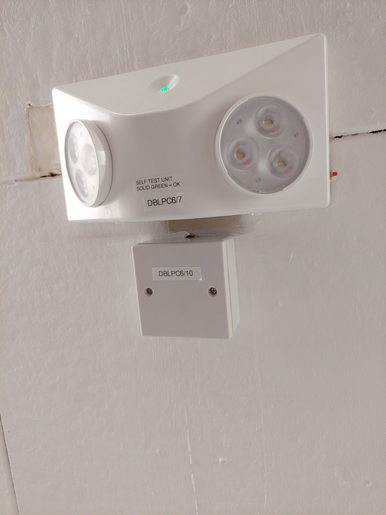

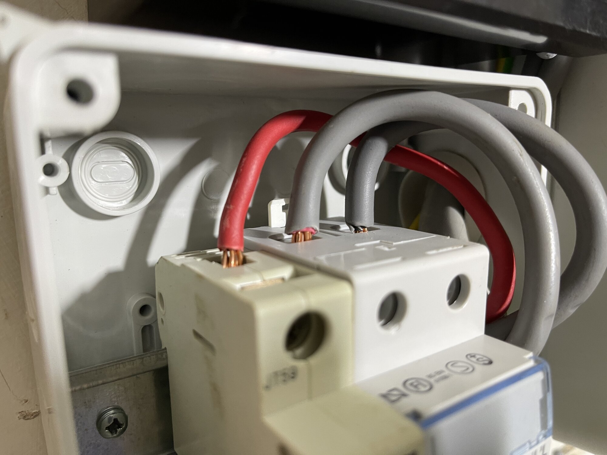

An important reminder on safe isolation - no matter how simple the job. Replacing emergency light fittings:
Isolated CCT at DB. LNE terminals all checked between and confirmed safe to work on.
Note the grey T&E with taped up ends also entering the enclosure.
It would have been easy to assume this was dead, or at least connected to the circuit just isolated that feeds the luminarie (in singles)
Nope.
Fed from an entirely different circuit, still live with tape over the ends. I assume a previous worker found it, couldn't trace it and left it with tape over. Very poor show.
The second photo shows my repair once I'd traced the circuit and made good - just to explain in pictures what I'm probably not doing very well with words.
Volt stick came in handy here. Obviously testing the luminaire with my contact Fluke probes - but it's hard to probe something that's been cut flush with tape wrapped around it....
This is the sort of stupid stuff that kills people.

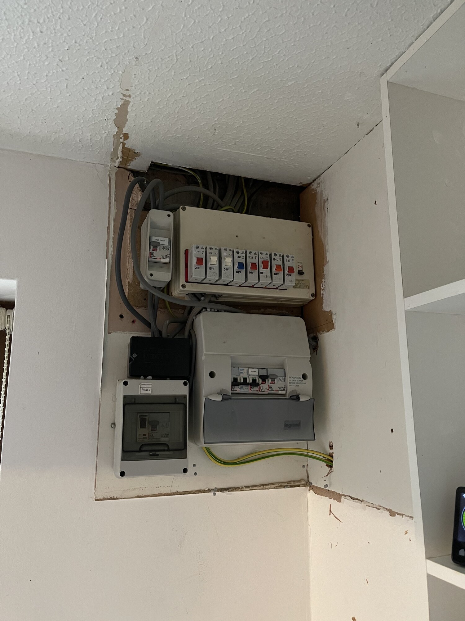

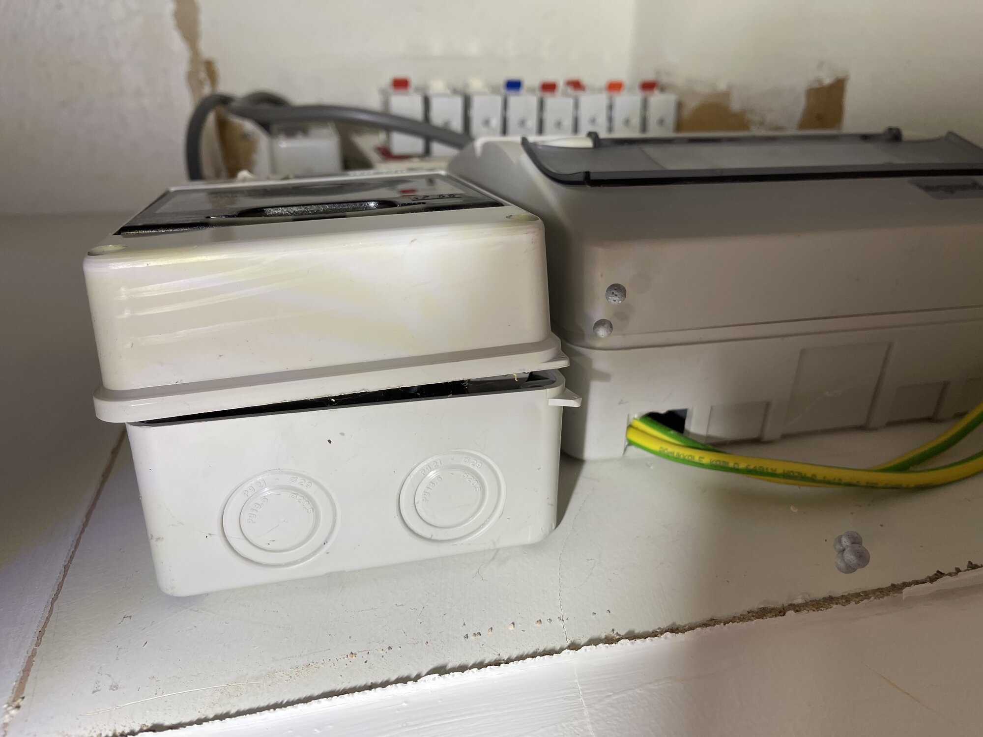

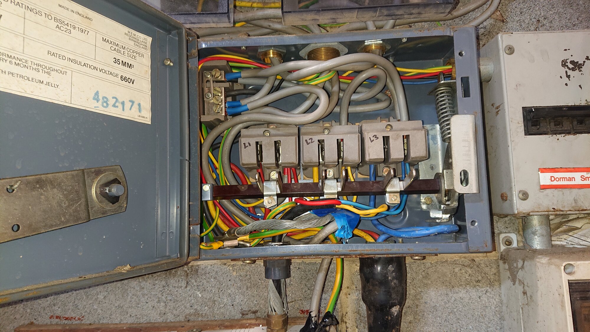

To add more info to the post I made yesterday.
I have a 100A cutout (confirmed as 100A by DNO as they put in an isolator for me in Dec) which feeds in to the property on 16mm tails (25mm to meter and 25mm to isolator then 16mm in)
This leads to a upfront 80A 30mA RCD. Which feeds the main board.
Then there is a feed from the RCD to a Henley block which feeds the board below and that has a 80A 100mA RCD switch and the sockets, cooker and 1 of the showers is on this board.
Then there is a second set of tails jammed into the top of the 100mA RCD feeding the third board on the bottom left which has a 40A 30mA RCD switch.
I’ve put the first pic on again to make it easy to see what I’m describing.
That's going to be a fun one. Are you putting in new 25mm flexi tails?
Not obvious why there are insulation balls in the CU. There are at least eleven cables that we can see are surface mounted into it, so why is there a hole into the cavity?
The insulation company could argue (quite correctly, if it's an external cavity wall), that there shouldn't be cables in the cavity. The cavity is not built to provide an easy path for sparkies.
Fully agree. Never a fan of running wires in a cavity wall. How many houses have meter tails waiting in the cavity waiting for someone to drill through them for an outside tapc etc . No safe zones, no RCD protection etc.

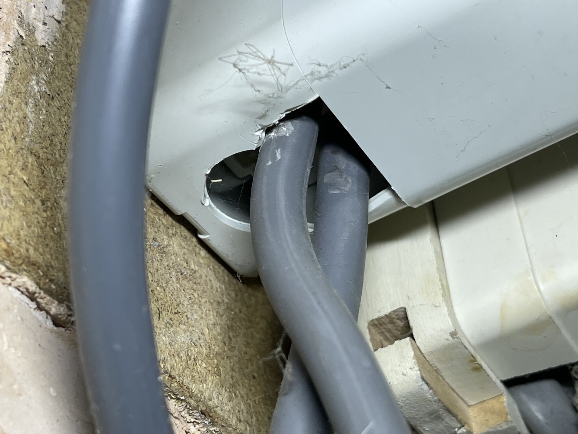

There was a hole I could get my arm in at the back of the board. Why I don’t know as only the tails where in it. 🤷🏼‍♂️
This was inside the cavity as I was having to rummage around to dig rubble out as it took me almost 2hrs just to run a new set of 25mm tails. 🙄
You can just make out in the far end of the pic my ball chain from my cable rods. That and the ferret cam saved me battling further. Without the cam I’d have never got them up due to the rubble in the cavity.

Odd, when they installed my smart meter and upgraded my cutout to 100A they also ran a new set of 25mm tails to the CU.
It’s often impossible to run a straight through sleeved set of tails. In fact in almost every property I’ve worked at you couldn’t. I can only think of one at the moment when I installed an EV charger where the CU was directly behind the cabinet.
Eg the one I did today.
Meter box is outside at chest height. Consumer unit is 2m away at 2 o’clock to the meter and up by the ceiling. The cabinet is also straddling the point where there is an internal separating wall. So I either sleeve the tails straight through in to one room, put some form of trunking or box to cover it and then drill though the wall to the utility where the CU is and then run more trunking up to the CU. (Could also chase into the wall but would be a deep chase and far too invasive). Or I could just follow the existing tails and run it up the cavity.
Out of curiosity. How would you have done it if you always sleeve? Not having a go, I’m always happy to learn other methods. I’ve yet to see a property with a straight through sleeved set of tails.
Tails would be in trunking if I couldn't get them into safe zones. I don't compromise regulations for aesthetics. If the customer complains, tell them to take it up with the architect who did the sloppy design in the first place.
