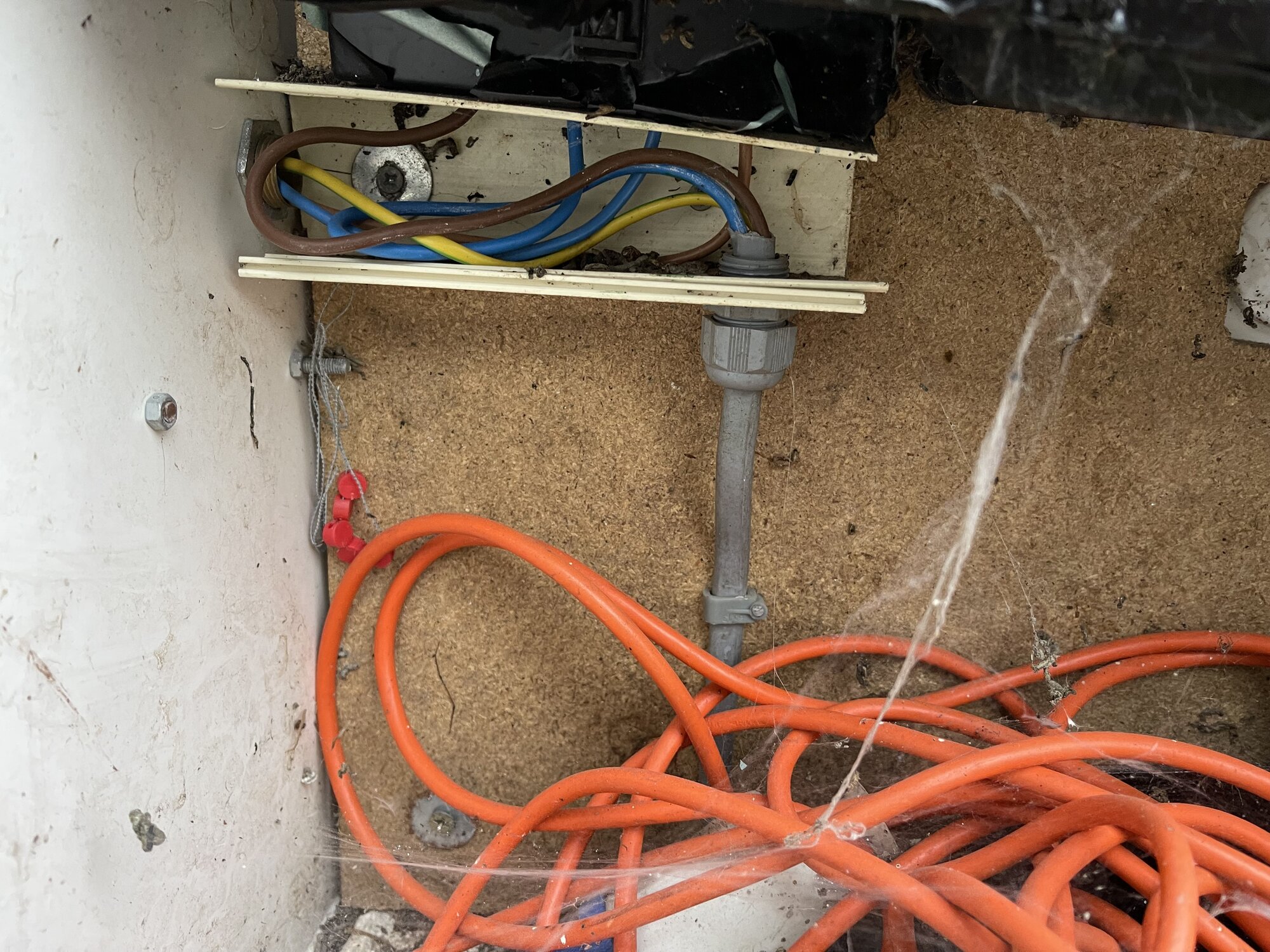

Their RCD stopped working so they used a car battery connector and a jump lead to bypass it 🙈
Their RCD stopped working so they used a car battery connector and a jump lead to bypass it 🙈View attachment 93968
Repeated on another thread, so you might want to ask a mod to delete one of them.
I’ll repeat what I said on it.
Would that be on a farm by any chance?
nah. there.s no cowshyte on them jump start cables.
Right mess by anybody's standards, but I can't see anything that I'd describe as "a threat to life".
Replacing the covers on the trunking, and a few cable ties and clips and it'd look a lot better.
The tails with the join is the worst bit, although I thought it was floating Henleys with a bit of tape around them.
Reactions: pc1966
Tripping / entangling in the cables on the floor is quite an immediate threat to anyone going in to read the meters or do any work!
The photo is not good enough to check things though, might be floating Henley blocks, but looked like tape to me. Also not much sign of grommets on trunking, and to the right just below vertical conduit there are some wires that might be taped or bare, or maybe just a trick with the brown live crossing the blue and G/Y.
Also a suspicious lack of G/Y earths around the wall of meters, etc, but maybe part of trunking?

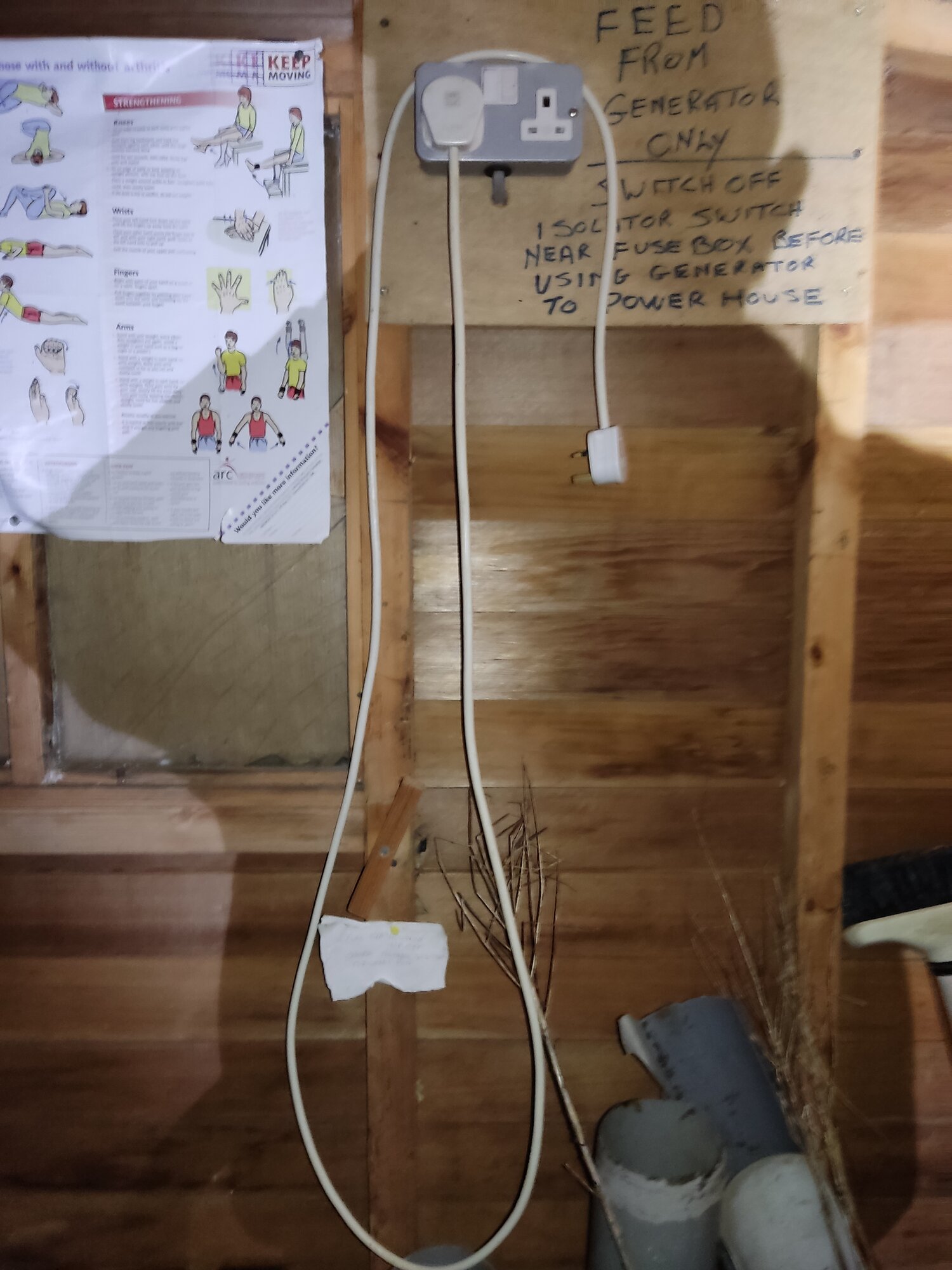

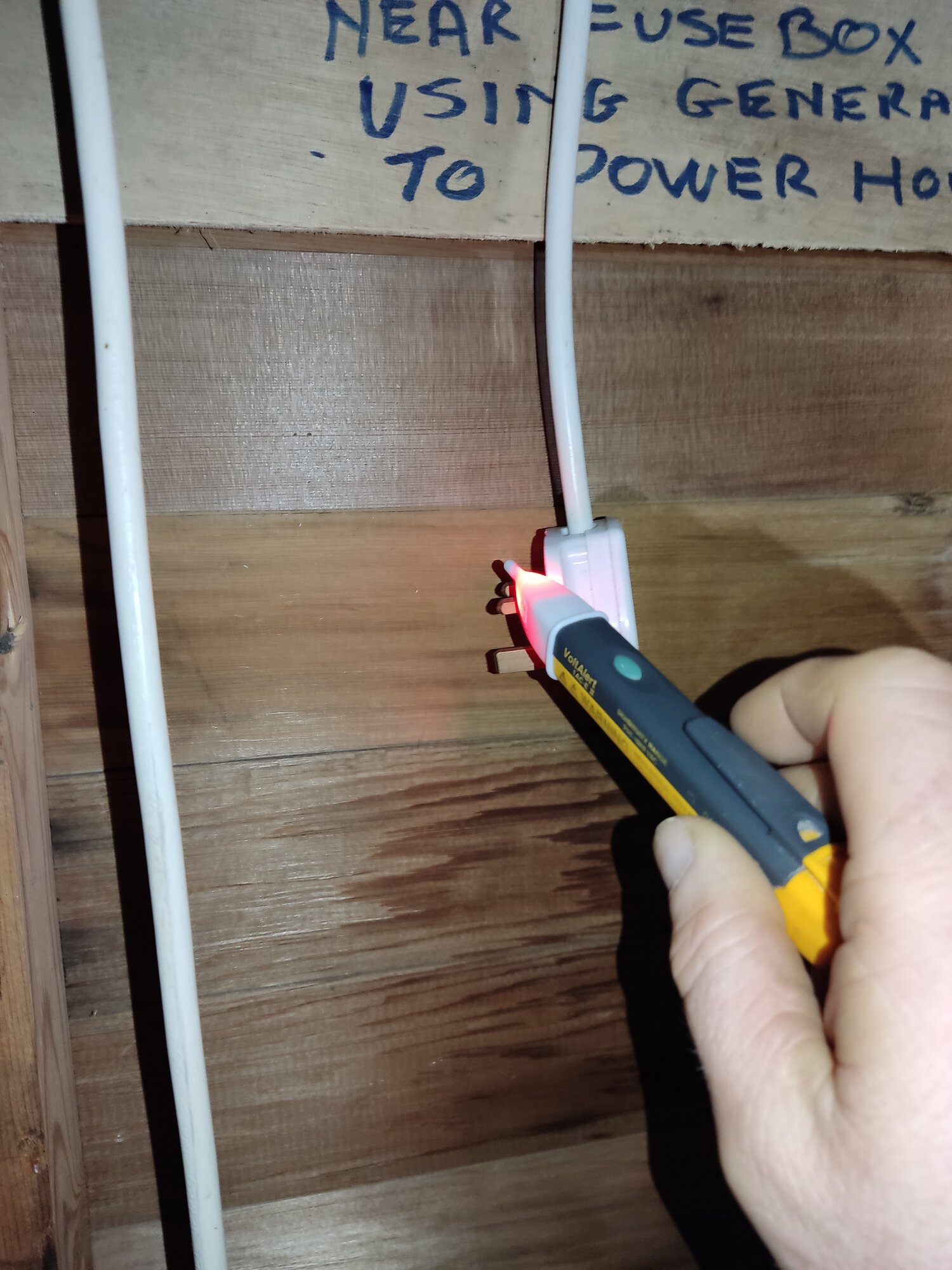

Littlesparks genny thread got me thinking of this little treasure I found the other day.
WOW,
the only time I have ever seen it done was a member of my family.
his theory was that it was ok because he knew what he was doing and nobody else would touch it.
it was difficult to educate him because he knew the danger but argued it was not a real risk because only he would touch it and he knew what he was doing.
Reactions: ferg
  • Creative
Reactions: ferg
Initially I though that was an "electric shock safety" poster next to it for irony.
No Baldric, it is not like silvery or goldly only less shiny....
