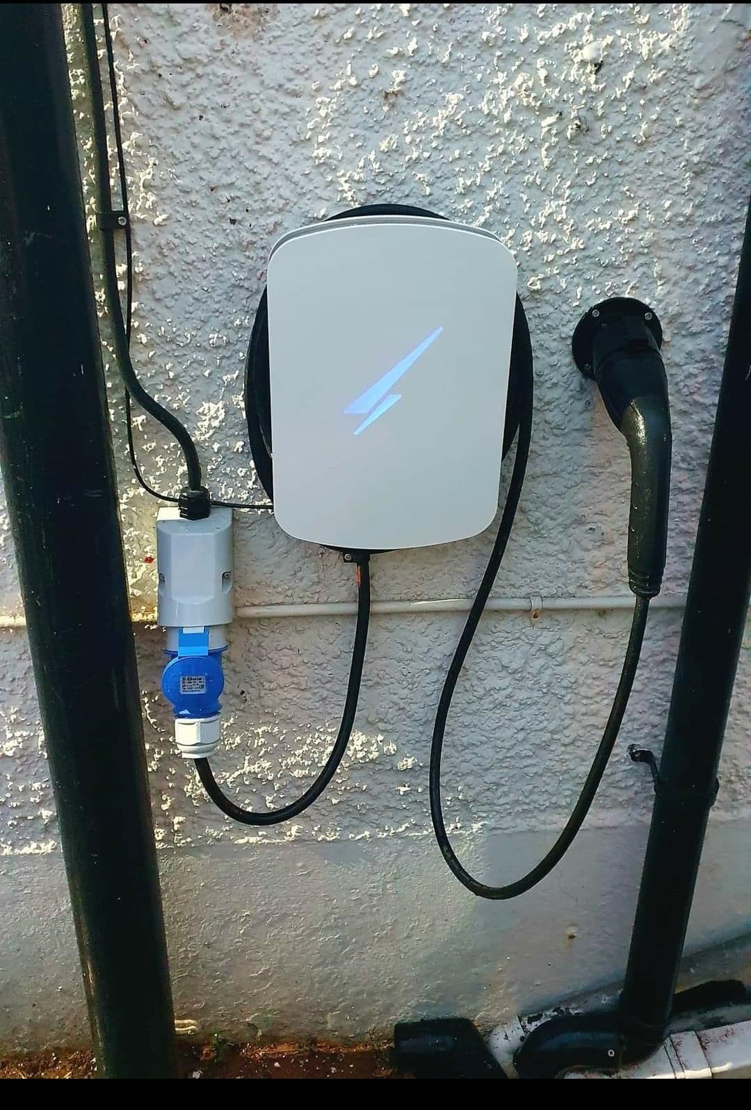

Eg this one. Which was first installed by a so called qualified and competent installer on a 115v commando with the inlet on the supply side. So exposed live pins.
Then when it was ‘rectified it still wasn’t done correctly as it wasn’t using an interlocked socket which is mandatory in a residential setting.
But the customer saved £200 by using this particular installer.

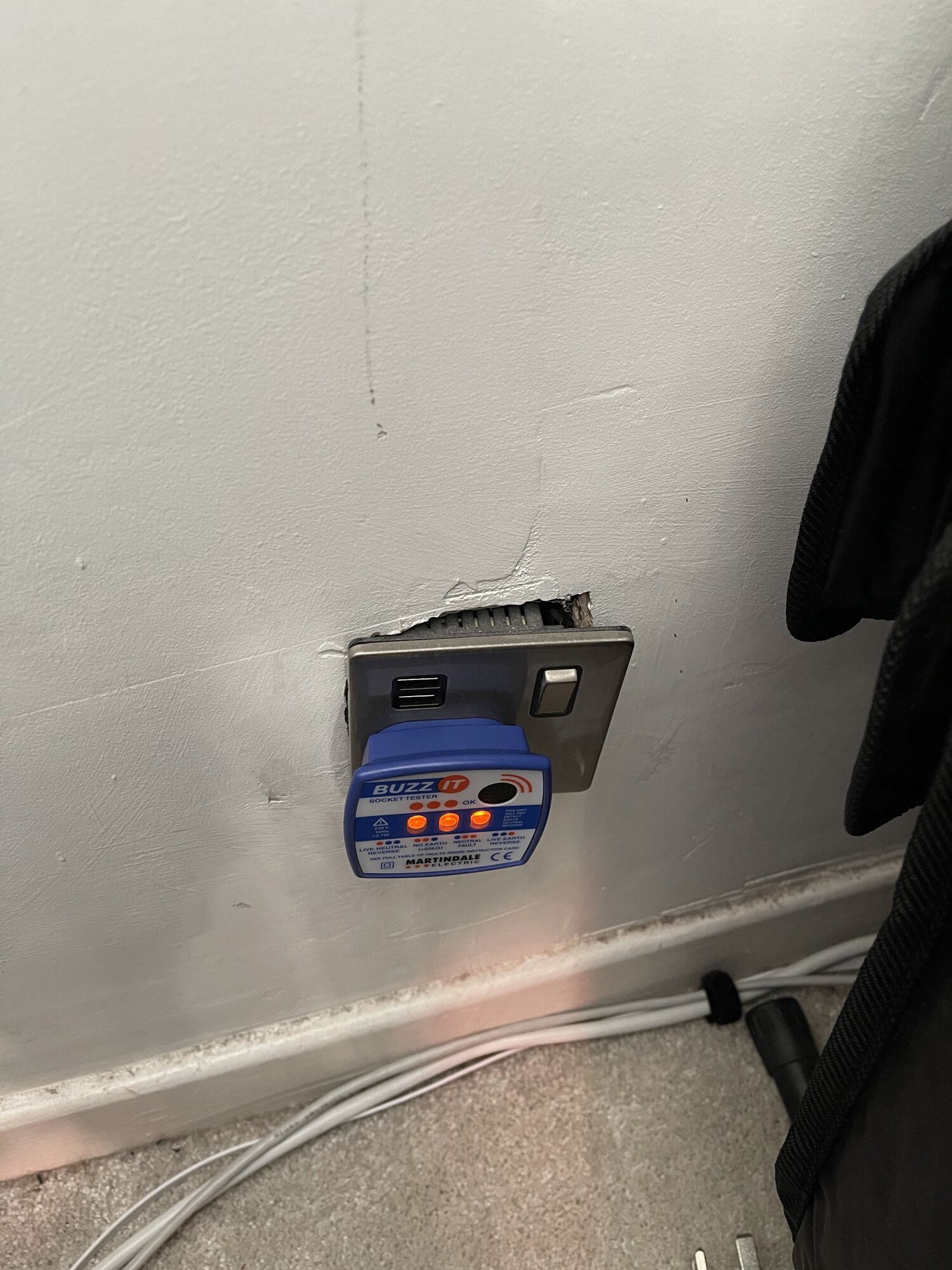

Currently doing an EICR on the same property and the first thing I see (after nearly tripping over the plumbing) as I walk in the garage where the CU is located. But it’s ok as it’s above head height….. 🤔
This is also ok in the bedroom as they know to hold it as they plug/unplug stuff

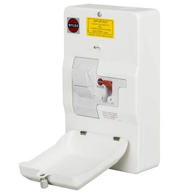

try the wylex one. I always use these. Really robust and side entry possible.
Can it be wired with the meter supply in from the top and out to the CU from the bottom? I am assuming yes, but wanted to check before I ordered it.
I have no idea. There is a picture of the innards on the CEF site but I can't see any lable to say if one is input and other output:
I doubt it is like the Schneider quadbreak switches where both fuse ends are isolated when off so direction unimportant, but hopefully if you pull the fuse cartridge forward it is isolated before you can touch the end!
Appears they are fed from the bottom. So this is going to be fun as I either need to crimp that SWA to extend, or hope there is enough slack there to re-gland and terminate it longer.

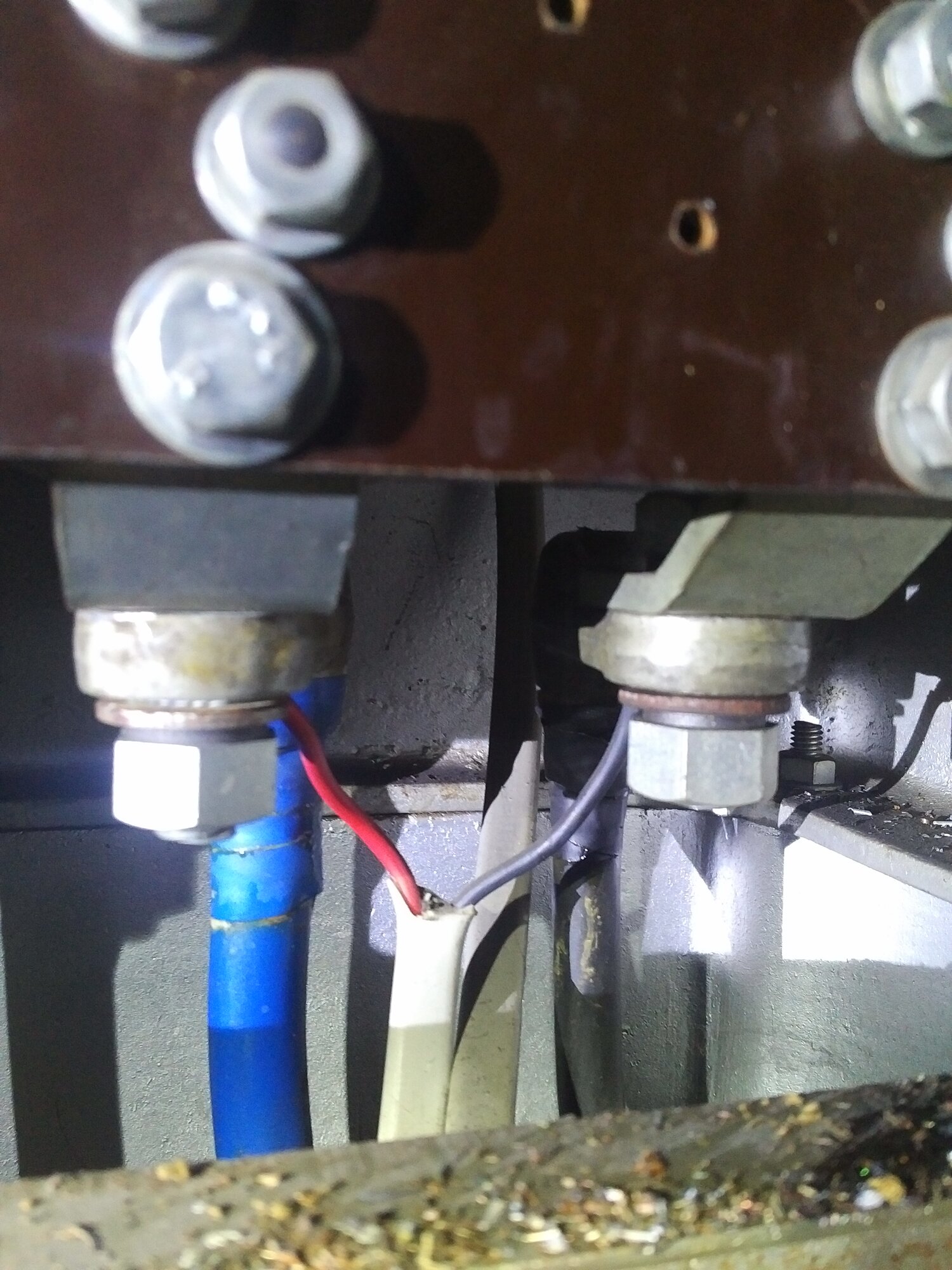

Had Western Power out yesterday to a factory shut down so they could assess the incoming supply and fuses. I went round and switched off as much of the distribution as possible before switching off the 200a switch fuse for the whole installation. We sat there for a second or two in silence before I heard a gas blown air heater kick in, mmm that's strange I said that was the main switch for everything?! We agreed to remove the main cut out fuses and have a look in the 200a switch fuse. Oh dear some quality bodgery gone on in the past then!
So that's a 2.5mm twin with the earth cut out, onto the incoming side of a 200a switch fuse with the 120mm tails backed up by a 200a network distribution fuse!!

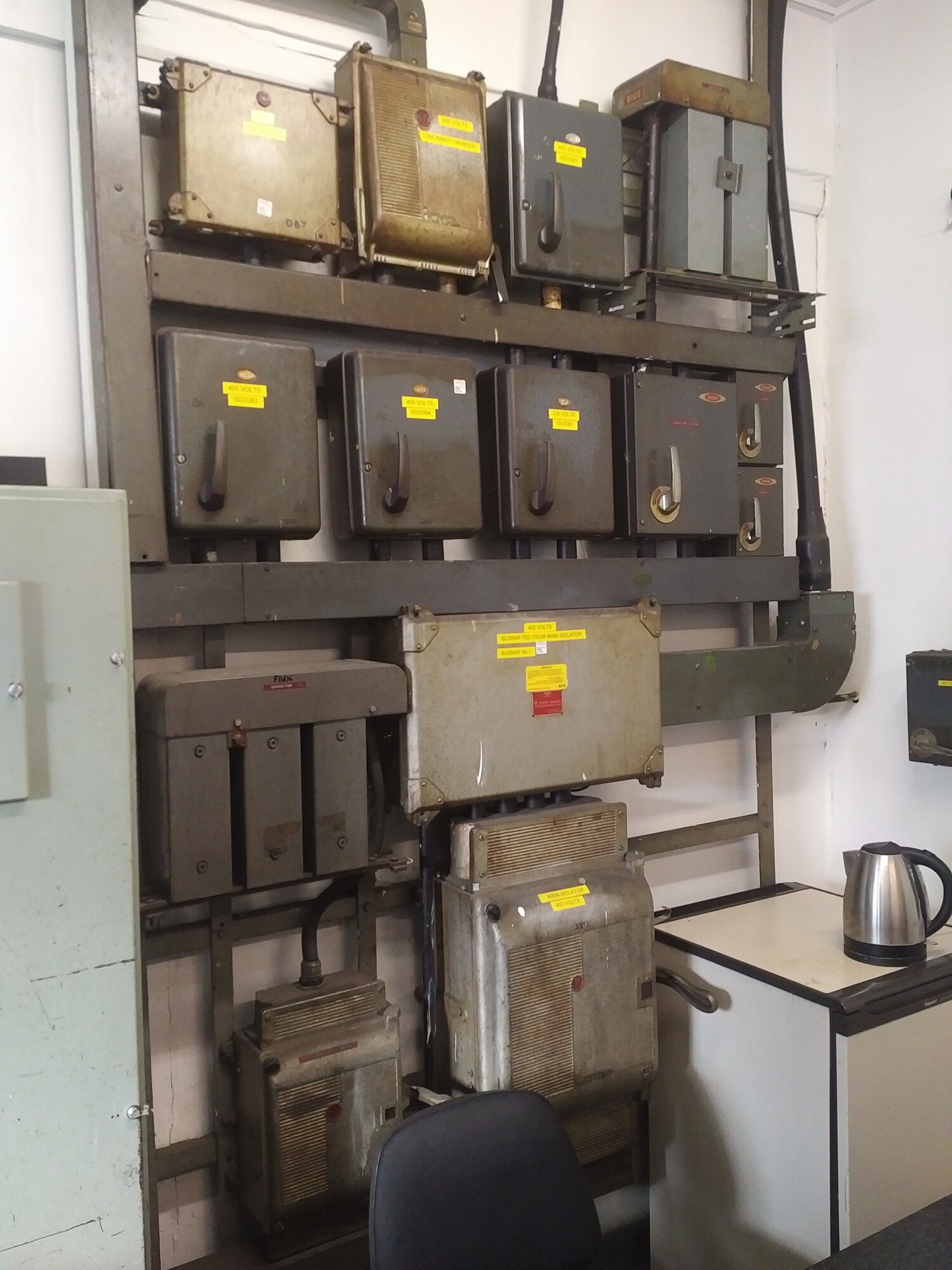

Yes a time bomb waiting to go off! This is the installation in question.
The main isolator is the one bottom right, the supply tails run in the trunking below it from the main intake just out of shot on the left.
The original work was very well done and this set up is repeated in the same building further up, it's just all the carp work done since that leaves a lot to the imagination!
This is in the next factory shop 2 rooms up from the supply intake!
Definitely a lot of C's of all descriptions in this one!

Myself and the DNO engineer were of the same opinion as all the main seals were all intact on the cut out and metal supply intake cabinet! We came to the conclusion they either were damn stupid and incredibly lucky or they had some serious balls of steel!
Yep. Beyond comprehension is that.
Could say 'they deserved to fry like pancakes'.......to$$ers
Even with hot gloves arc protection and insulated sockets or spanners it would have been lethal and I wouldn't have wanted to trap the 2.5 under the washer! Imagine if there had been a fault on that circuit as it was connected live 😱
That's the part which perplexes me - I can't see it having been connected live, but can't imagine anyone with authorisation to shut a place down carrying out such work.
