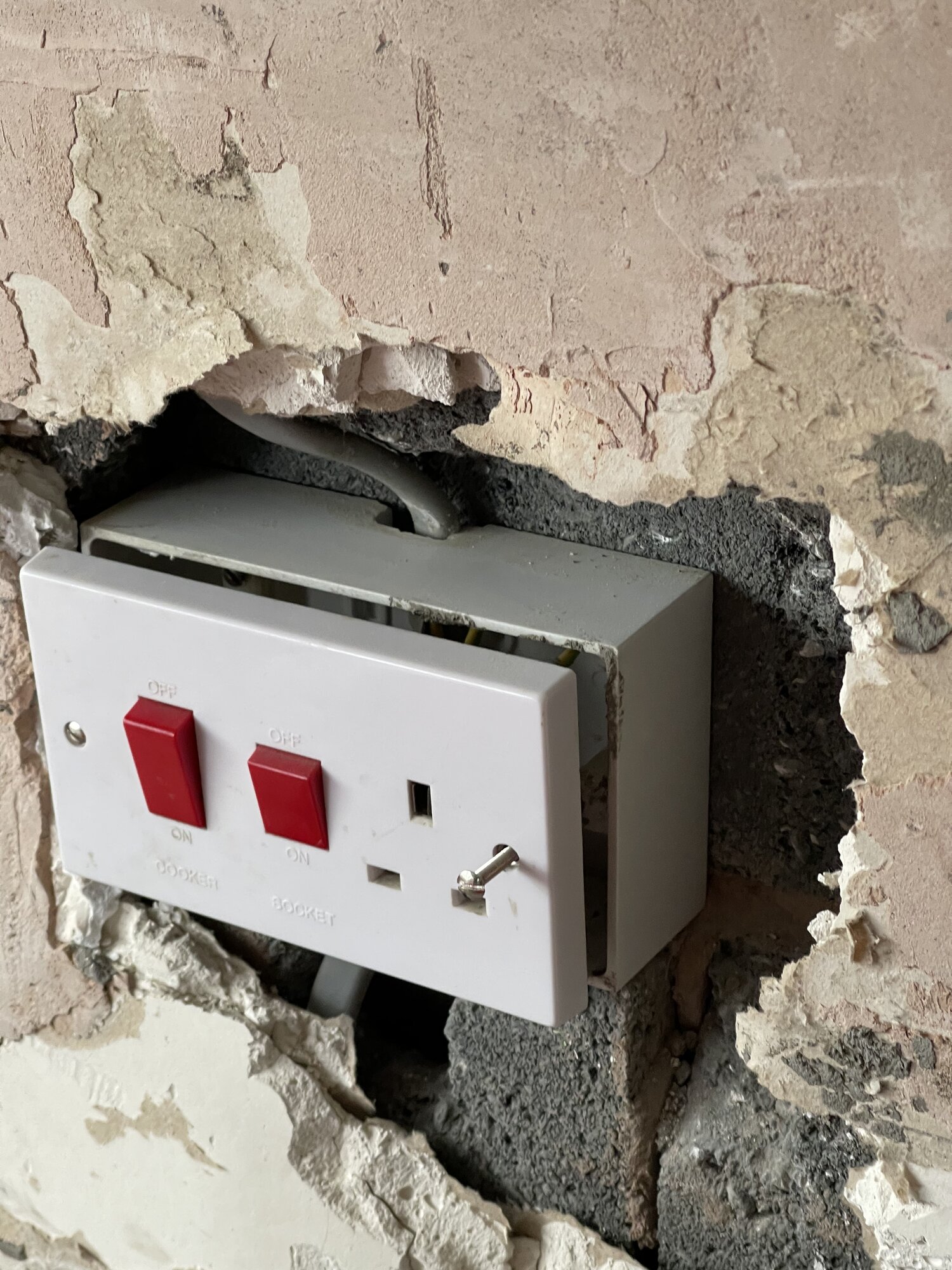

Saw this on another group, and thought it fits here....
Took me a second to realise what had actually happened...
Looks to me like it's been screwed to the plasterboard and it's given way. Possibly having a row of holes in the board has created a weakness that's failed. Funnily enough, was watching Shawn the Sheep (ah the joys of grand kids in the house, well that's my excuse), an episode involving a 3D TV just the other day - had a similar theme !
it does remind me of a job I did a good few years ago now. We had an estate agent for a client (did all their IT and "stuff"), and they were setting up a new branch. So loads of stuff ordered, including 3 big TVs to use and displays. A couple of them were fairly easy - very expensive bits of pipe (would probably have been a fraction of the price to pop round to the motor factors, buy some lengths of exhaust pipe, and a can of black paint) and brackets, and a bit of ply screwed through the ceiling for a top support (bottom end screwed to the floor).
But one of them, on a "swivel about" bracket like that, fixed to the wall. Oh boy, was that "interesting" - cobble and lime mortar 😱 I got it fixed, but TBH was never 100% sure about it. But it did survive until a couple of years later they decided that branch wasn't working and we got to take it all out again - I was relieved when I got that telly down.
Some people don’t realise the extra forces caused on one of those sticking-out-from-the-wall type brackets compared to the flat ones.
How did we ever fix CRT tv brackets to the wall, I’ll never know 🧐
Yeah, a lot of tension in those top screws.
With a tall fixing plate and either lots of screws or big screws. I've sometimes been accused of "over engineering" things - but surely you should always assume some 20 stone person is going to "test" your workmanship 😆 I sometimes think that my fixings won't fail, but what about what they are fixed to ?

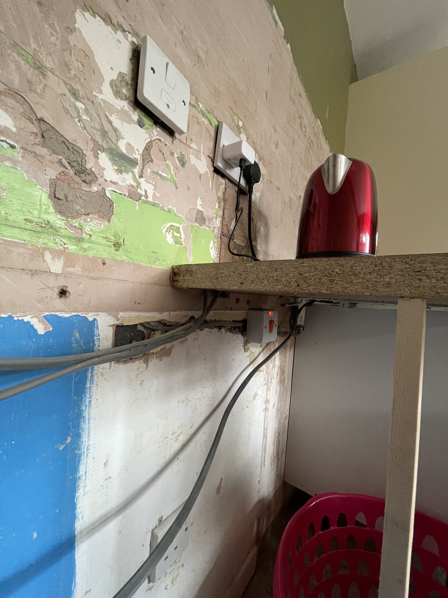

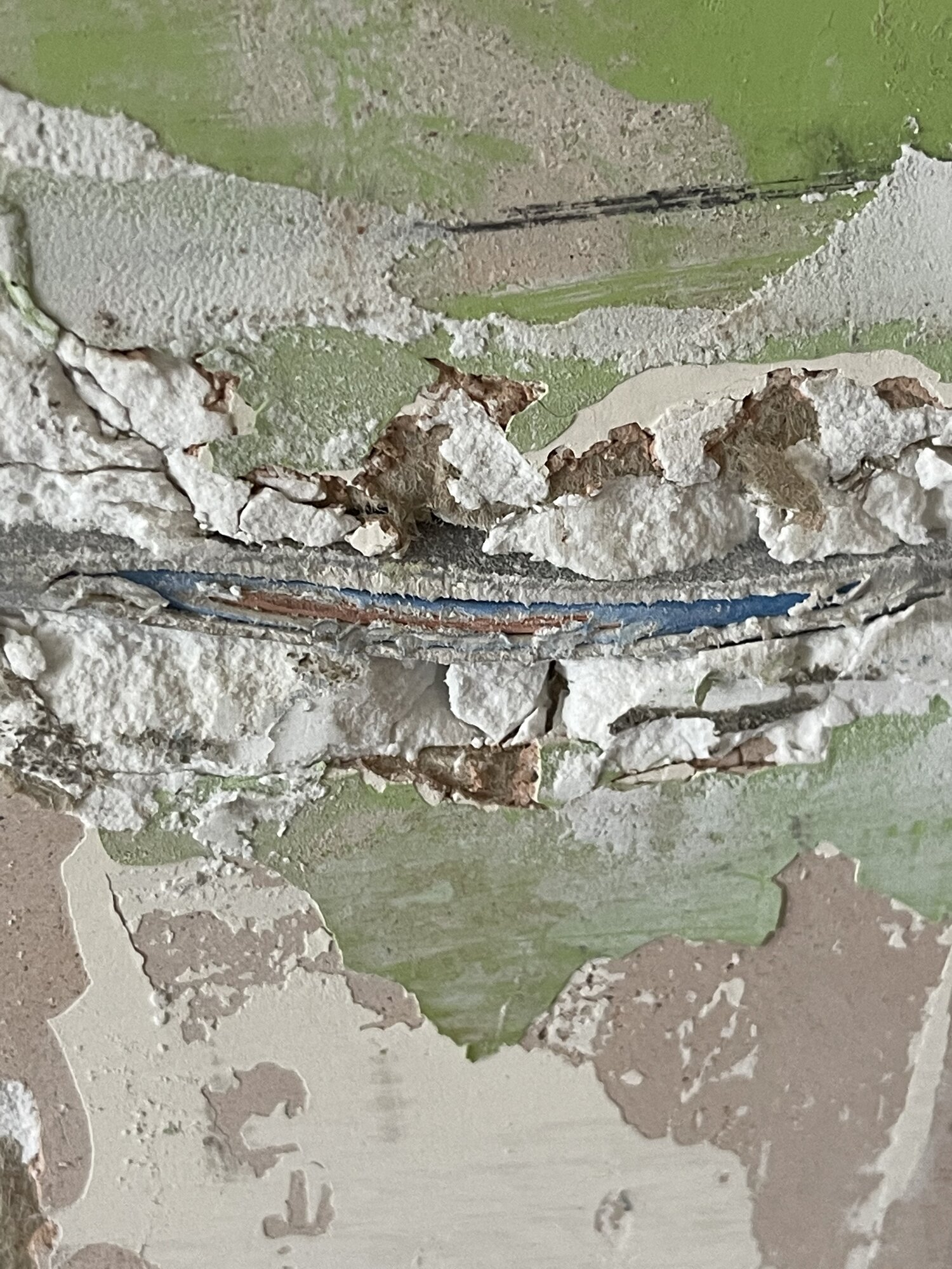

Went to look at a job today.
Lady got in touch as having work done and builders have had their ‘electrician’ in to sort the work out ready for a new kitchen.
All apparently done last year but they won’t come back now and have not given her any certificates for any of the work. I can’t think why….🤔🙄
Nice...
Pretty sure that's not the intended use of that pattress.
Bare copper showing through on the conductor. Not sure what they have done apart from not done a deep enough chase, not use cable clips correctly and/or used capping to protect.
Lovely use of connector blocks and maintenance free enclosure for the cupboard lights...
Cooker switch feeding a 4.5kw inbuilt oven and grille fed from the 13a isolator next to the socket

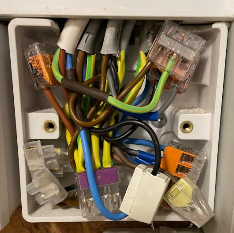

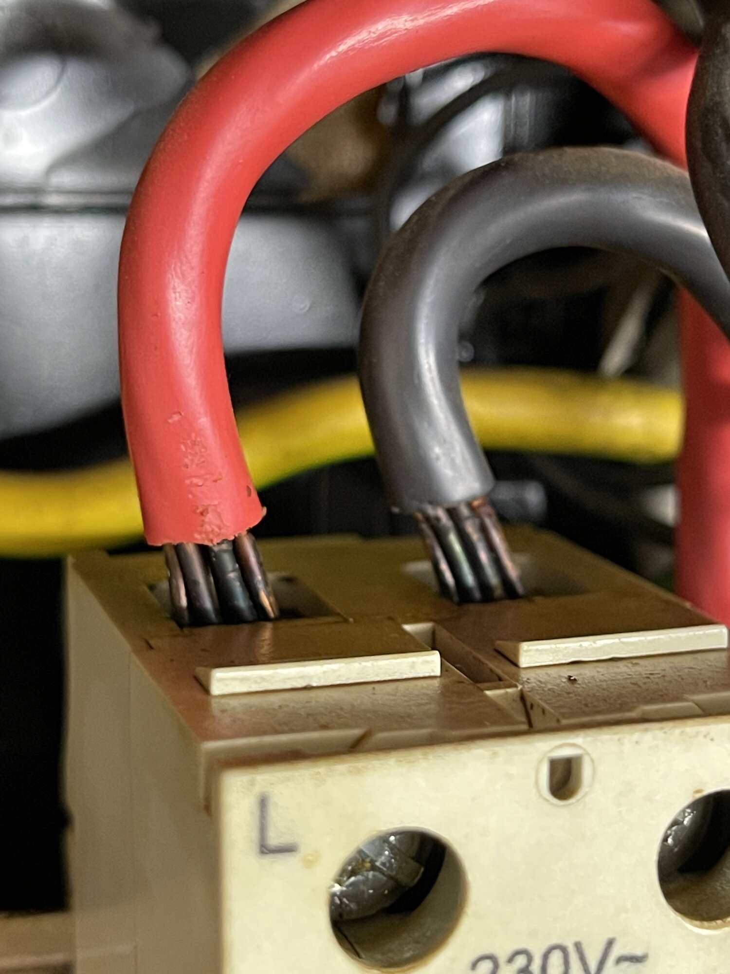

More rubbish heating wiring, conductors falling out of terminals, copper exposed no cord grips etc. Was wired incorrectly so you couldn't have heating on the ground floor unless the first floor or cylinder were calling for heat.
Also saw this in the WC where I was working on Friday and couldn't help but laugh.
More rubbish heating wiring, conductors falling out of terminals, copper exposed no cord grips etc. Was wired incorrectly so you couldn't have heating on the ground floor unless the first floor or cylinder were calling for heat.View attachment 95982

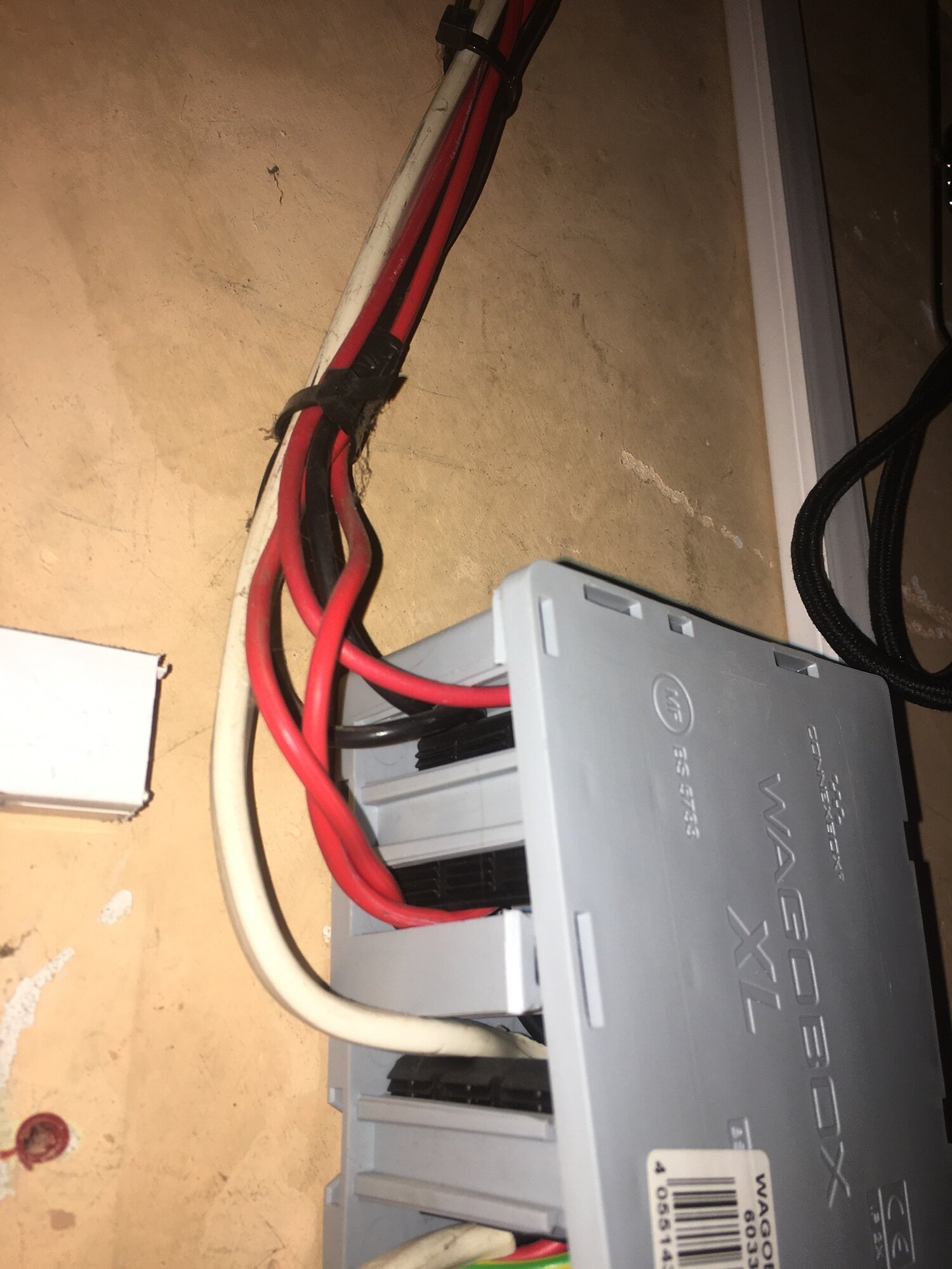

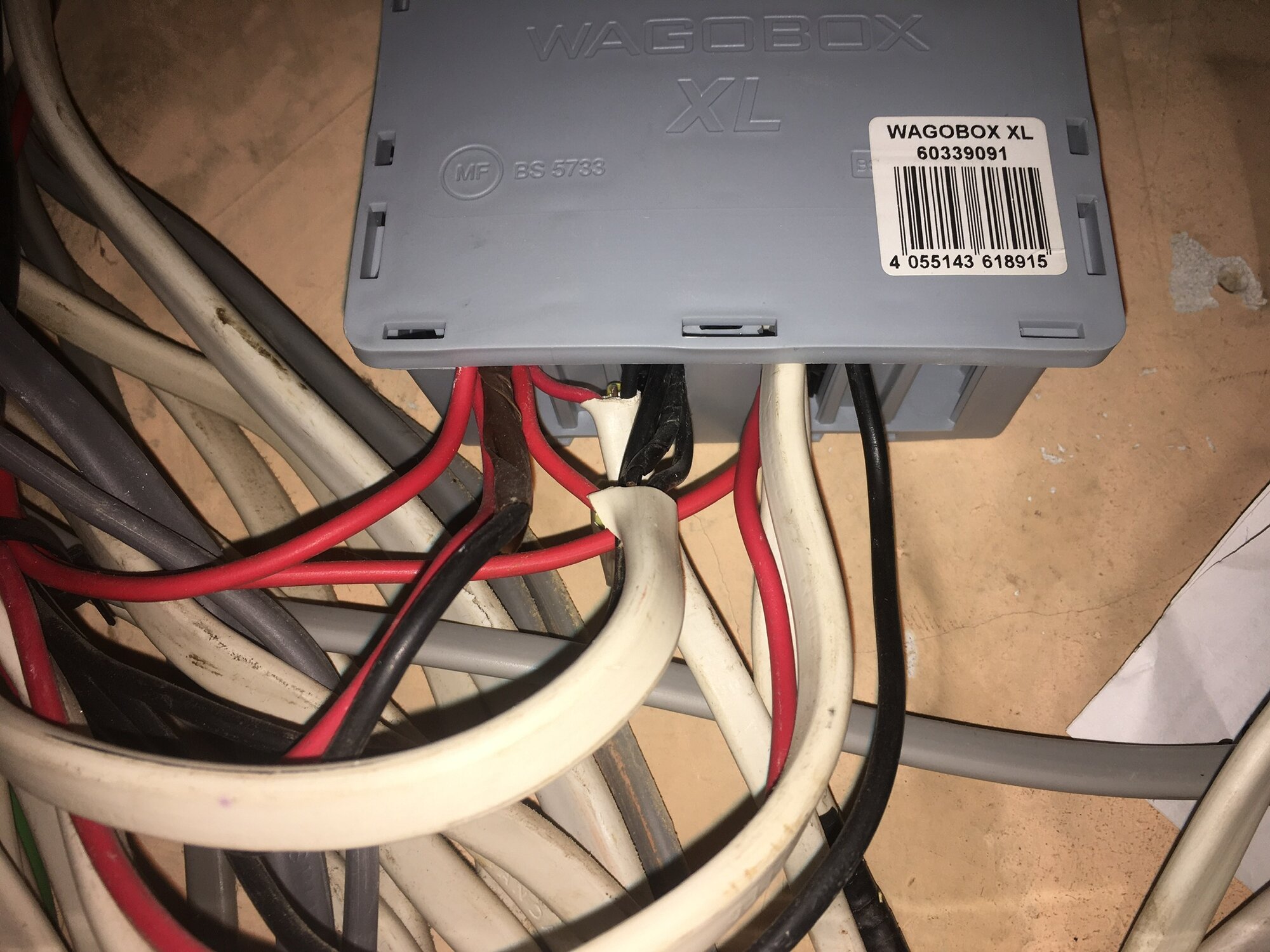

I hate finding plumbers wiring for heating systems. Took me 4hrs to fix one bodge like that once and get it all into a proper wago wiring centre.
Took me that long to work through all the wiring, black being used for neutral didn't help. They had connected a core of one flex to the core of another then at the other end connected that core to another going back to where it started I ended up pulling a 5 core and 4 core flex out between 2 junction boxes as they just weren't needed. Have to go back and get extra cores to 2 UFH manifolds, fit 3 pole isolators to the 2 boilers, proper wiring centres, labels etc.

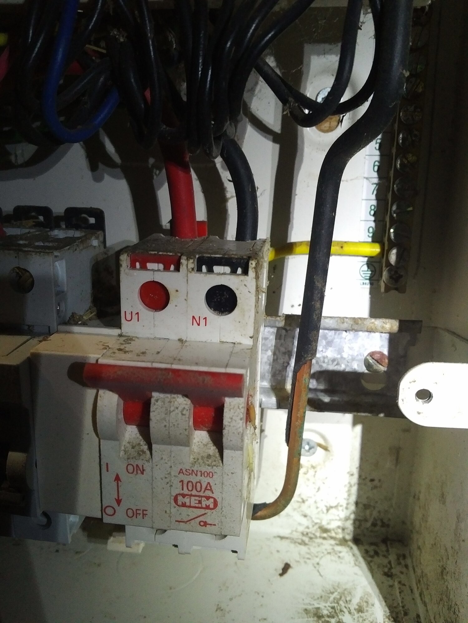

Hot and slippery, Just the way I like my isolators.... hmm wait, i was thinking of something else there for a moment.
Is this in a chippy, or pub kitchen by any chance?
Mainswitch looks like it’s had a coating of airborne cooking oil fumes
10 points to littlespark. Pub Kitchen.

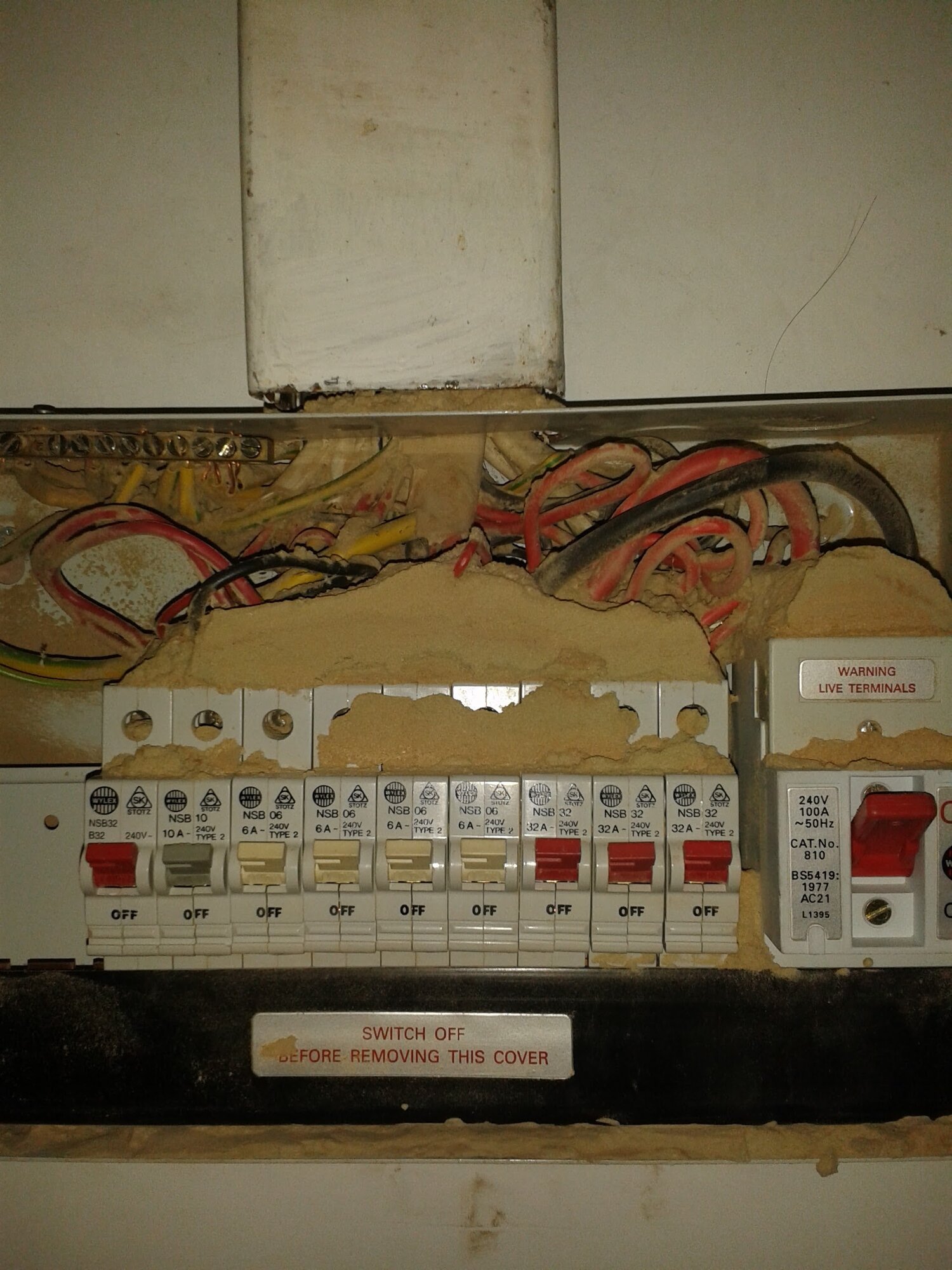

I took the cover off a board just last week and it was full of cavity wall insulation that had found it’s way inside from the rear…
Got a surprise when the good lady of the house stretched over me with the metal tube of her vacuum cleaner to clean it out
Had to stop her and explain the dangers
I bet there was more in there until you removed the cover and it snowed it everywhere 😄

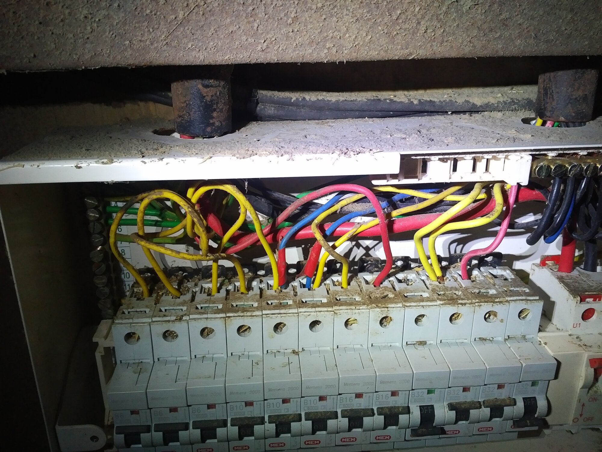

Sure I've posted this before. This one was full to the very top of chaff and mice bedding, only after removing it was the damage they had done revealed! I had the cavity wall insulation one a few times, its a right mess to clean up!
So....leaf-blower or Henry?
😂😂 It was in a wood mill extraction booth maintenance didn't know it was there, you couldn't actually see it due to a dust mountain it was the trunking that gave it away.

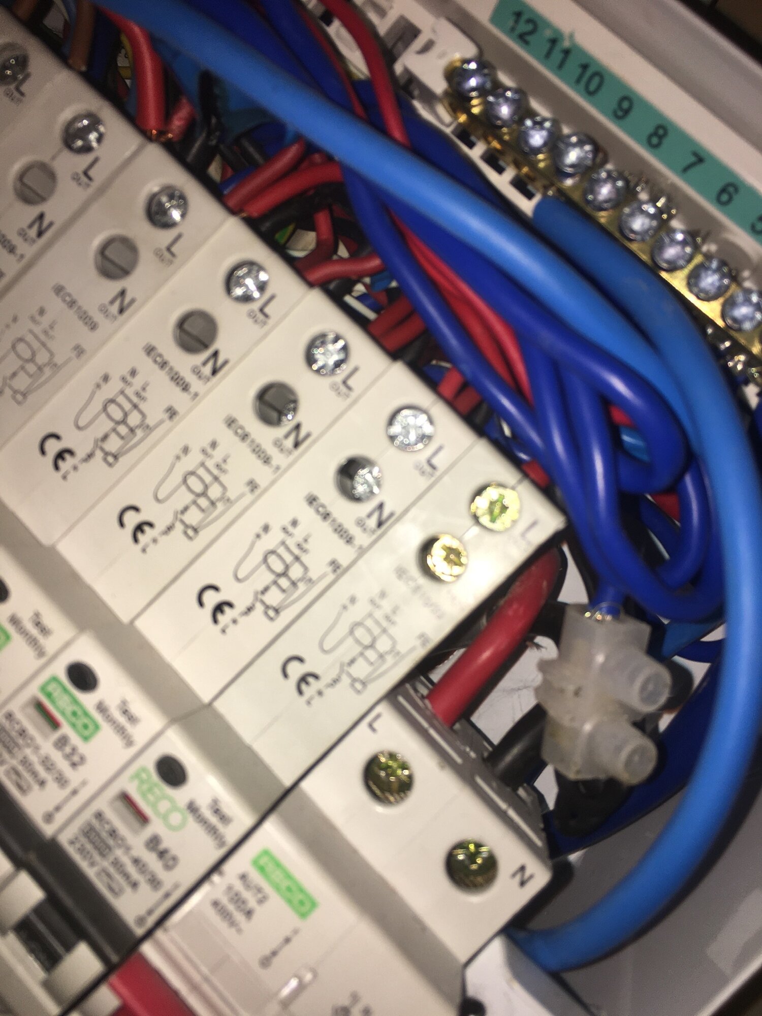

cant believe he’s used additional CU internal neutral conductors to extend the rcbo neutrals how would they be too short ???
looking forward to ripping that lot out and rewiring

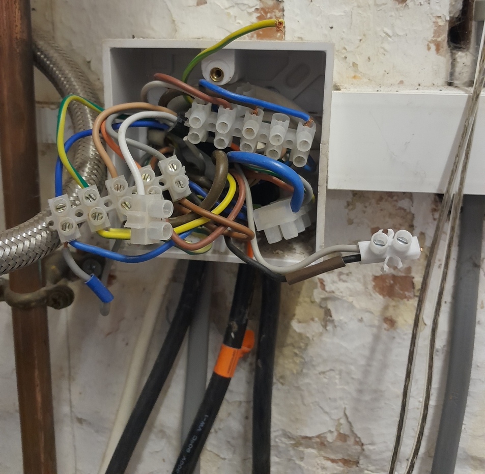

Not so much the high number of connections crammed into a box which is bad enough, but the entire circuit concept...
This is next to the CU on one side:
The other side of CU is a DIN rail timer:
Connections are CU to the joint box. Joint box uninterrupted back through CU to timer. timer back through CU again to joint box using 3 core flex with brown sleeving on all three (naughty!). Then off to three outside lighting circuits.
The circuit feeding it all was showing 0.07 Mohms IR L+N to E so I'll be starting again.
I also found the timer is linked out anyway!
G/y core as a live conductor?? Tut tut
I don’t like it and wouldn’t also, but I have been informed this is acceptable if it’s sleaved.
I thought G/Y was explicitly only for CPC use?
Edit: Yes, see 514.4.2
