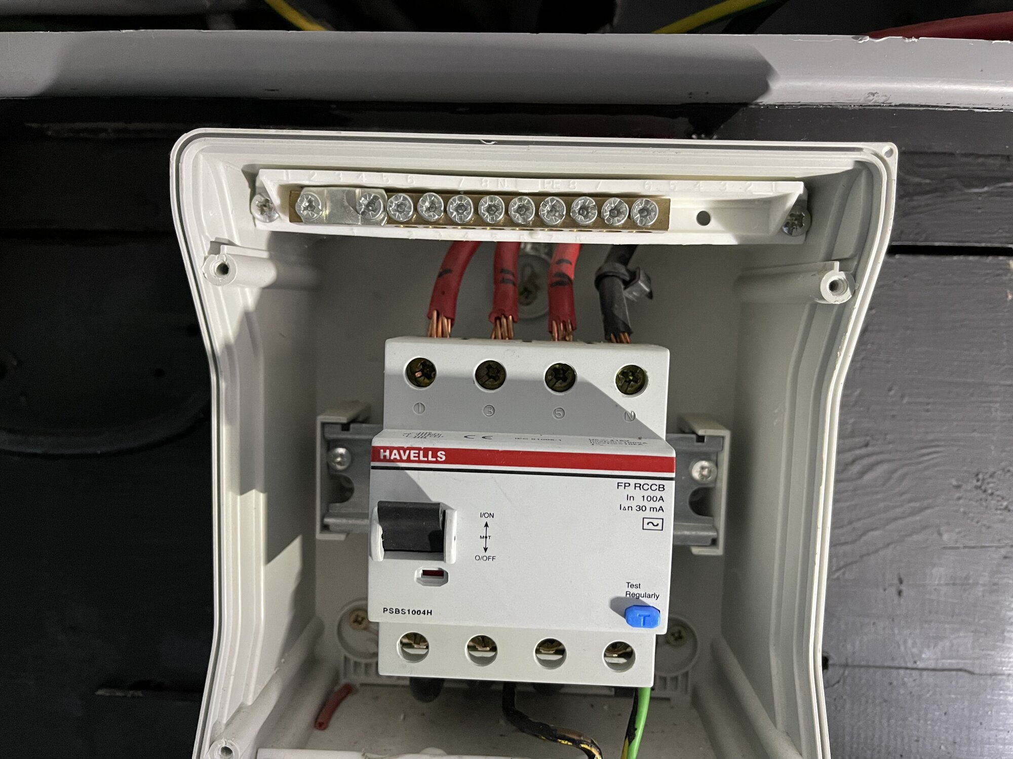

Also had a call out for a loss of power to half of a house this morning.

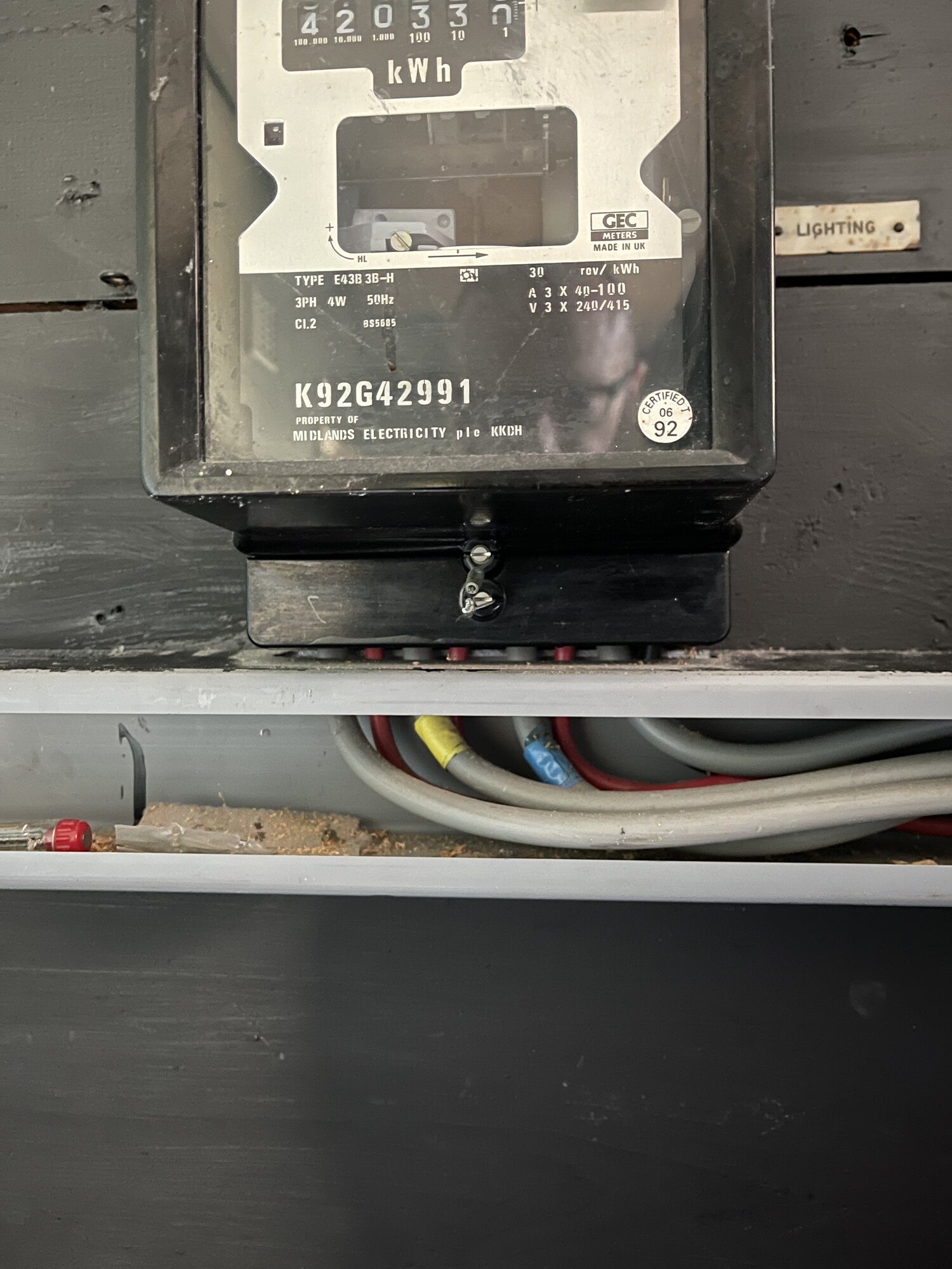

Established that 2 of the phases had no power. Rang Western Power and they tried to assure me the property only had single phase. 🤨
Bit of a discussion, explained the cable runs, the 3ph meter etc but they were adamant. So hung up. Scratched my head for a min, rechecked everything again. Rang NAPIT technical and described the layout. Funny enough they agreed it was a 3ph supply.
Rang WP back, got a different call handler. Sent a team out who arrived about an hour after the call.
Established I was correct (odd that, I am now quite proud of being an electrician and knowing what a 3ph supply looked like! 😂).

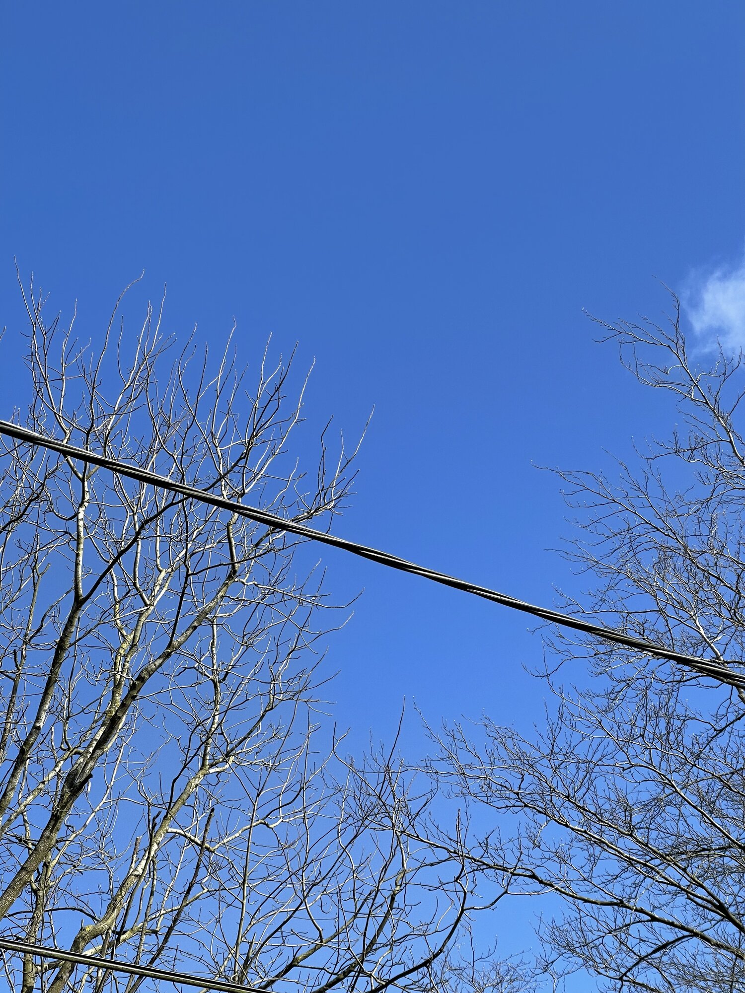

They found that something had eaten through 2 of the phases on the pole for the supply coming into the house. No idea what but couldn’t see any dead animals. Once they sorted that they had power back to the rest of the house.
Whilst everything was dead I re-terminated the cables into the RCCB. Need to go back and sort that earth out as it seems a tad inadequate for a 3ph supply!

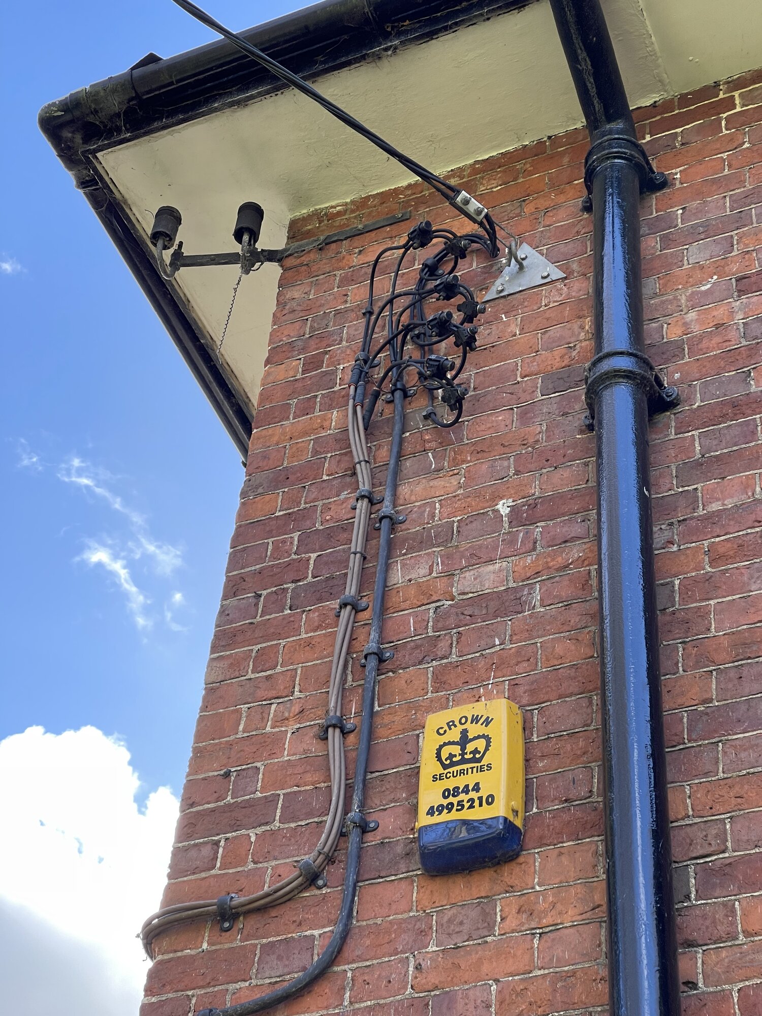

Found this beauty just hanging out the bathroom wall above a wash hand basin and at eye level on an EICR this morning. I particularly like how they’ve used masking tape over the ends.
When I explained to the client that I can’t just leave it like that, she goes it’s ok, I know it’s live and not to touch it…😂
Needless to say, I made safe before I left.
