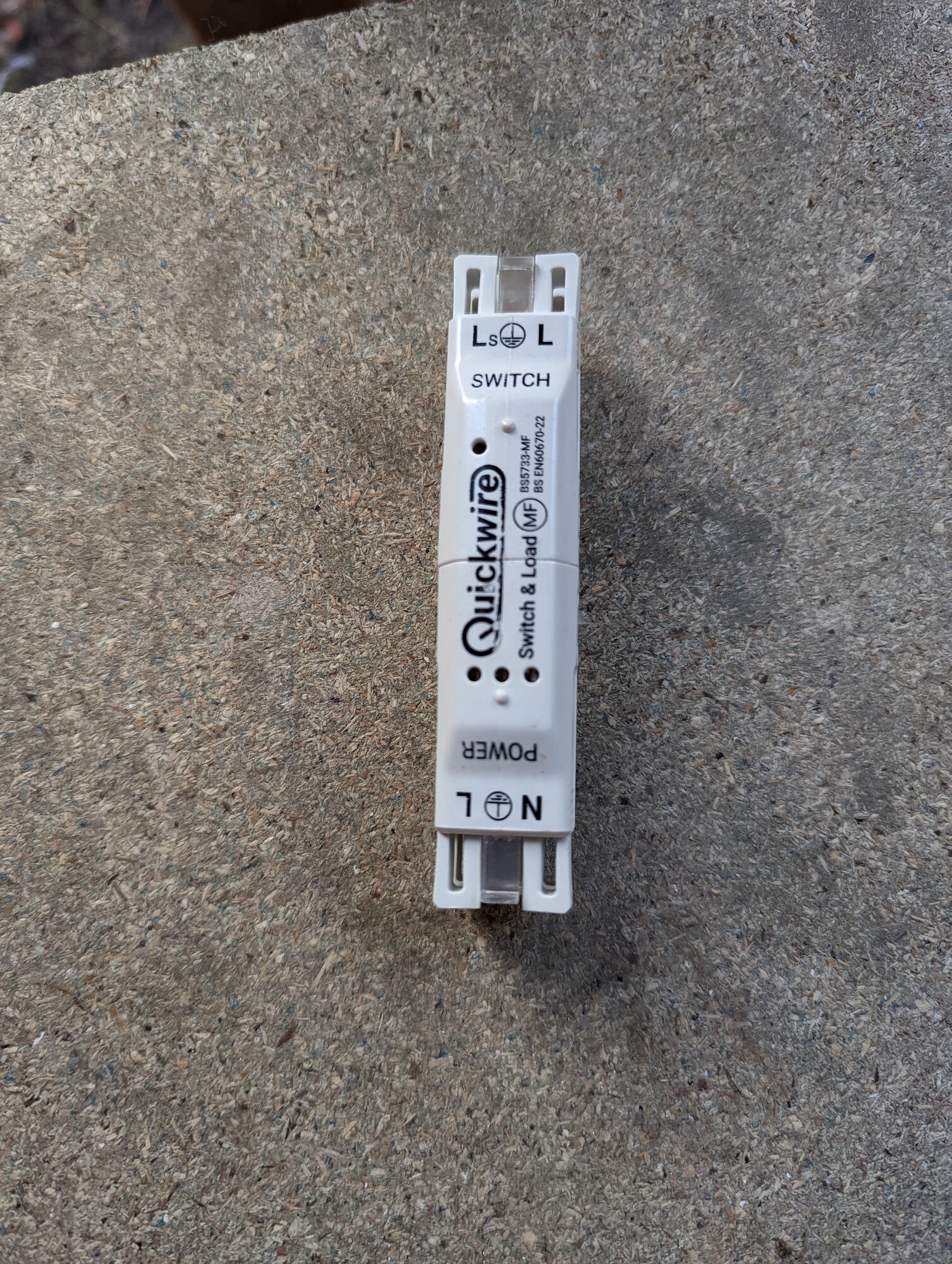

I know Quickwire are relative newcomers, and there are quite a few other easy-style connectors out there, but I do think Quickwire will be the new "Wago" for lighting. I also know that many think the cost is quite high, but the time-savings are considerable.

I'd place quickwire in a different category to wireless interlinks. While both offer time saving solutions, at a price, there's no prospect of wireless failure with their connectors.
Wireless switching and smoke detector interconnection is something I'd only consider when adding to an existing installation, where it saves considerable time and upheaval, and there's no question that this may often be the better option for customers. For new installations I'm firmly of the opinion that everthing should be hardwired.
I'm not sure about the t connectors but I thought that too about the switch and load. If you look there's little holes in the sides I believe you can get a probe in there. I'll try it later but would be pretty sure thats what it's for.
That thought struck me last night, but I didn't have one to hand. Looking at images online I could only see holes on either side, so wonder if that's what they really are and, if so, where CPC can be accessed.
Edit: seems I should have looked elsewhere as this was answered in Quickwire's FAQ section, back in 2017. All of their junctions have test points.

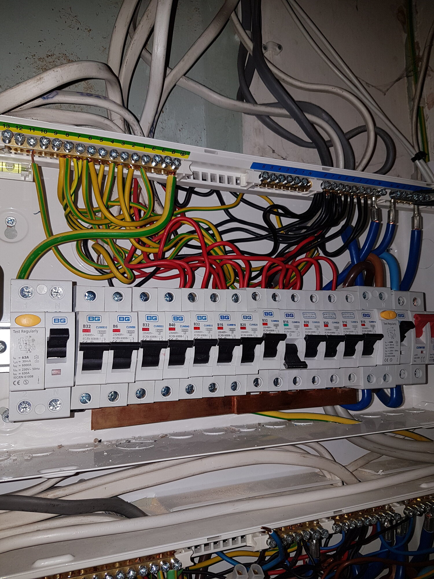

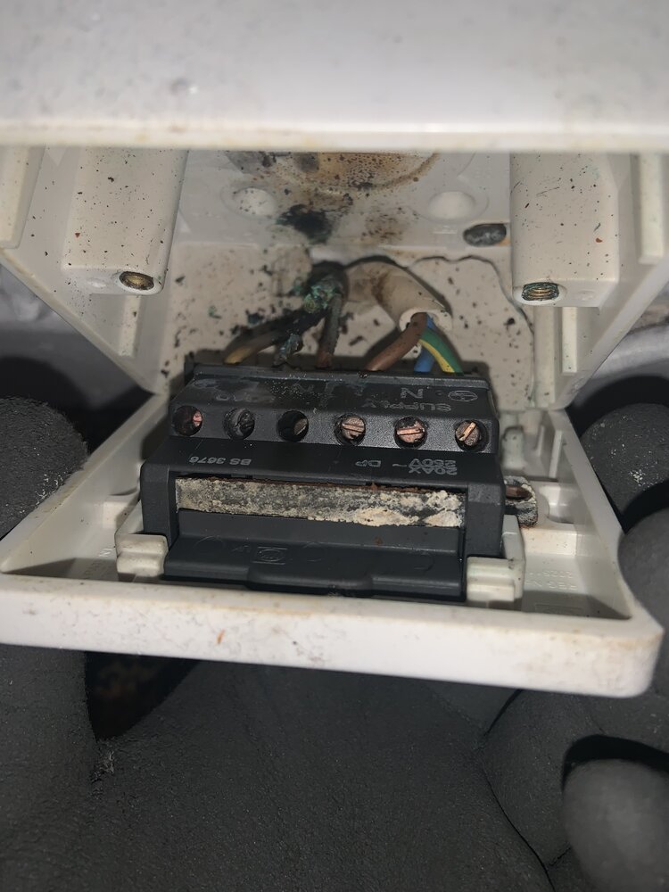

New customer. Lighting fault, breaker would reset, 4 or 5 times… then wouldn’t reset at all, and tripped with a crack.
Boiler is also off this lighting circuit so I’ve ran a temp supply for that just now.
Reading 5Mohms and rising on L-E and N-E.
Suspect circuit is second from left and disconnected for now.
Other issues with board include inner cores of flex on left most breaker supplying bell transformer (no bell) into exposed connector block. Took that out straight away.
There’s so much excess copper on show.. and no idea with the black going into a breaker.
Neutrals don’t correspond with lines and this was supposedly rewired in 2002.
I’ll get all the faults sorted, then get some rcbo’s for it.
