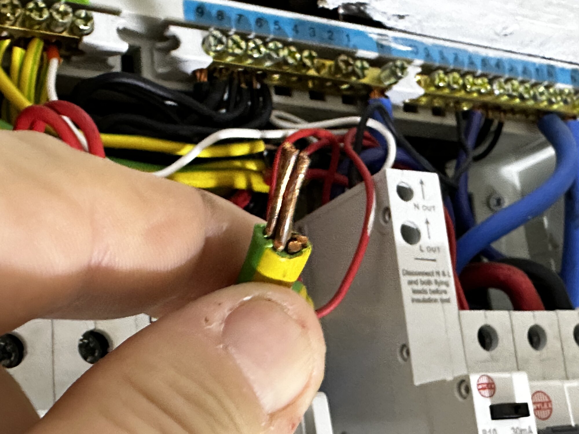

Ooh R/W/B cable.... If you pull this out and it's more than a couple of feet, I'll pay you to send it over for the museum. Keep failing to secure any reasonable lengths of R/W/B.

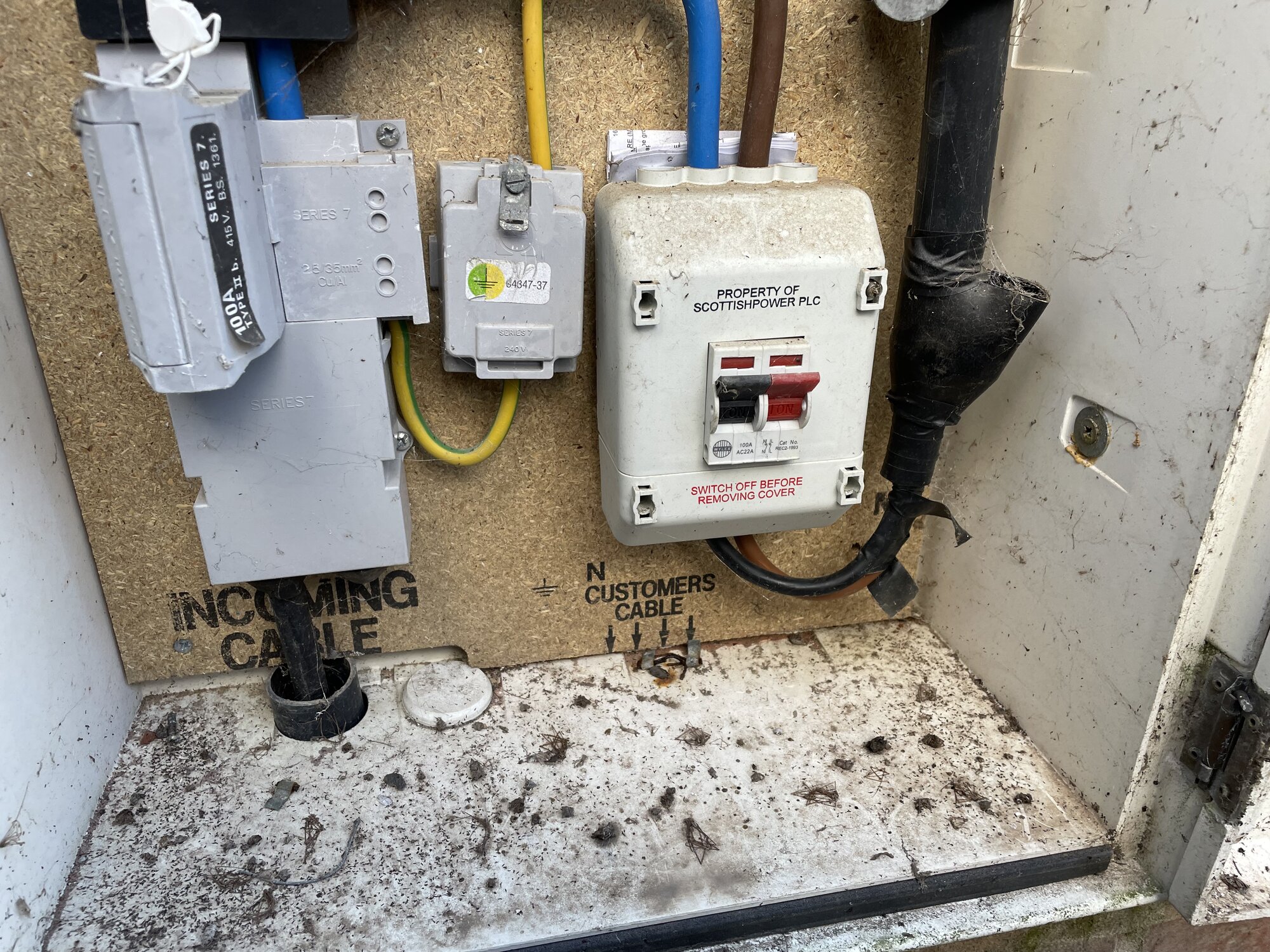

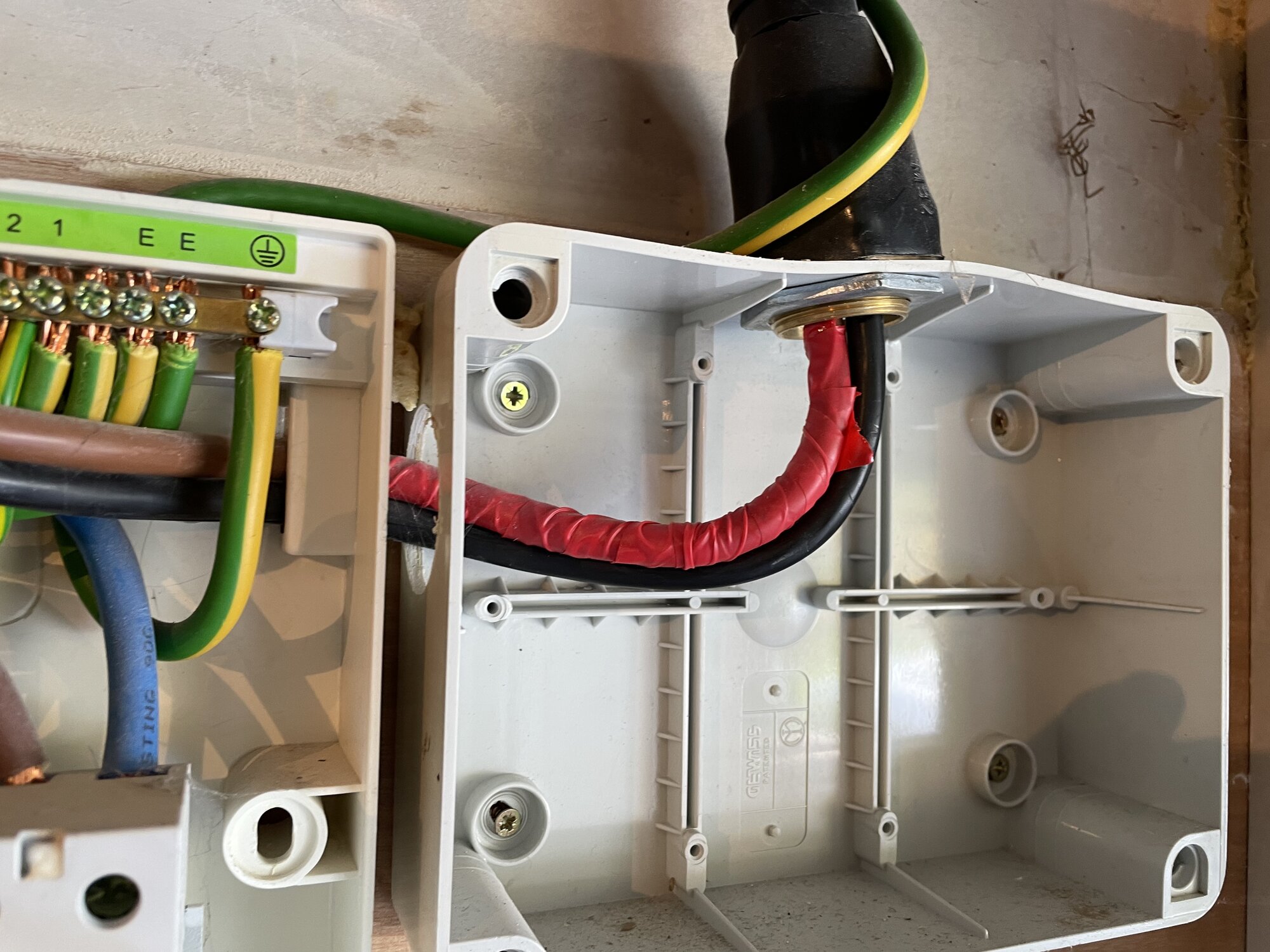

I don't know what I'd have done in your situation. As that's only a 60947-3 isolator the meter tails are effectively extended all the way to the EVCP....!
I told them not to use the charge point and to get on to the installer as they should be given the chance to rectify.
It would be interesting to see what would happen if a fault occurred and his charge point and/or car went up.

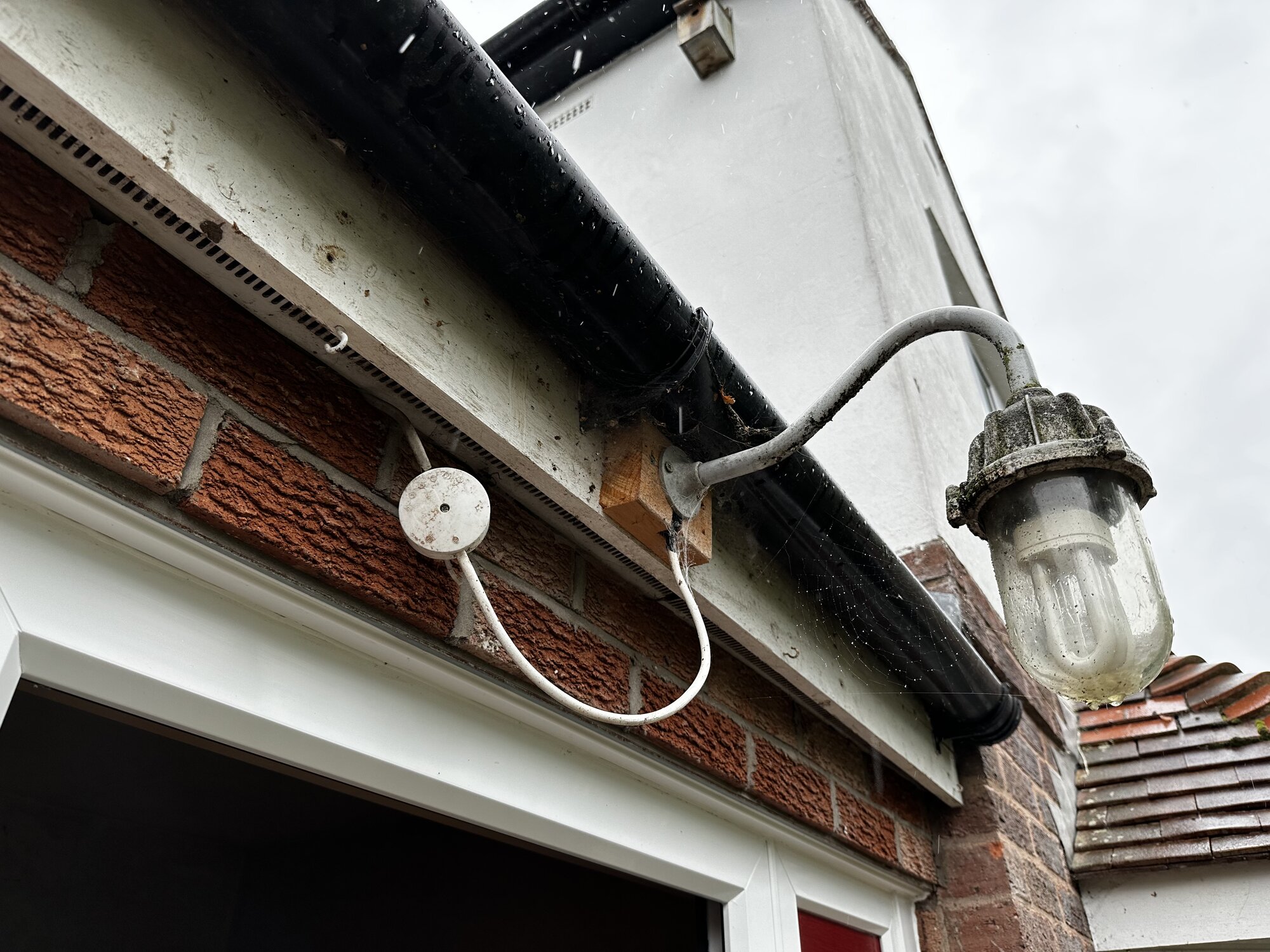

Earlier today customer says can you look at an outside light that hasn't worked for some time, problem being it's quite high up near the apex on a 2-storey house, No problem I say whilst grinding my teeth as it's also peeing down, get up there thinking It's probably just a bulb, change bulb ask them to try it, reply is ohh I don't know where the switch is.
Come down cant find switch, end up in attic. Turns out it's never been wired. 😩

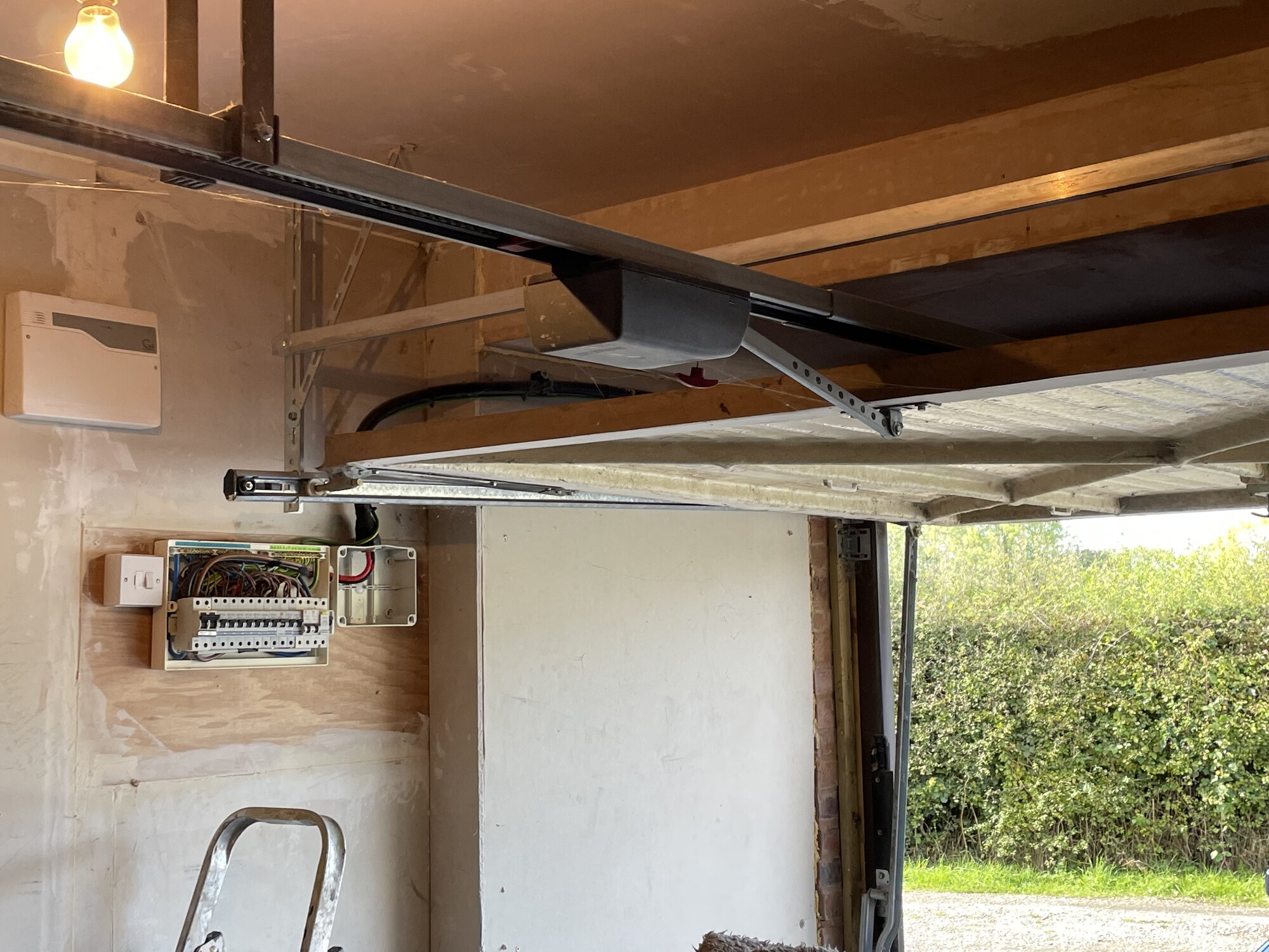

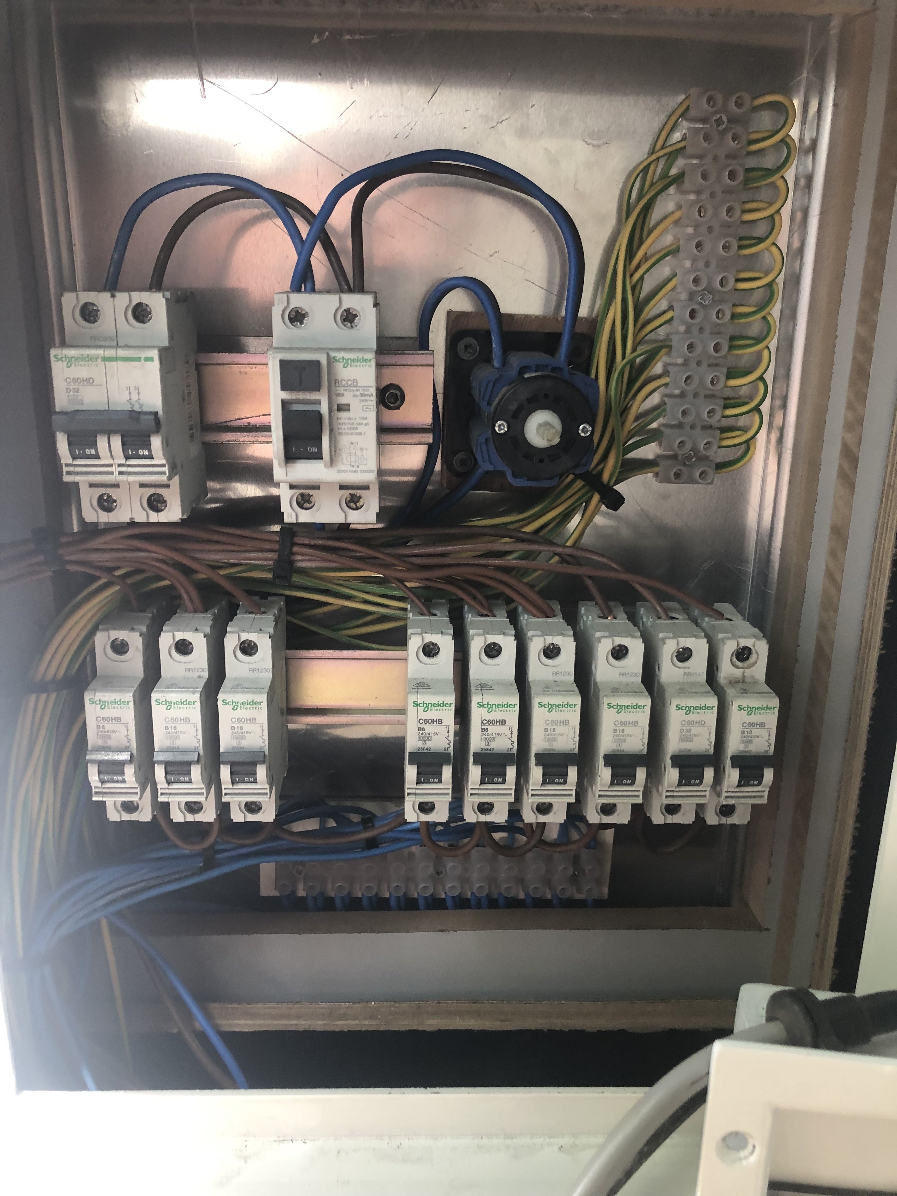

Had a call Saturday afternoon just as I was about to go home from a friend of mine saying that he's lost power to his boiler and outbuilding /Sun room.
He tells me that he's checked at the CU for anything tripped and also checked the fuse in FCU at the boiler.
I ask if he's got any sort of multimeter etc, he says no (although this fella is a mobile locksmith and I would have expected him to have something).
After being on the phone for 20 mins and him having the lid off the Cu it's decided that I go and look as he's got his freezer in the outbuilding and also some pump in a tank that's not working either.
Problem for me is that he lives well into the country, and it's almost a 100-mile round trip on a lot of single country lanes.
I debate whether to go home and take the car and also risk having to tell the missus face to face that we won't be going into town or to go now in the van.
The telling the missus face to face was the deciding factor in not taking the car.
So after a Text message to her indoors, off I set.
Slow progress it seems like every farmer in their tractors are out and about, but after a quick stop at a fuel station that sells Costa coffee and Cornish pasties I'm not feeling too bad.
On the way, brain is ticking over thinking what it could be as I've asked him things like is it a Swa cable to the out building etc.
Half way there I get a text from him with very accurate directions as he says the sat nav may get it wrong OK, no prob.
After a little while, I look at the sat nav, and it says 10 miles to go.
Then the dreaded happens he phones me I think I've found the problem, a fuse has gone in a Fcu a 5amp one it was in the airing cupboard upstairs.
I say it can't be that because you said the outbuilding is dead he said I haven't replaced the fuse yet, but it's definitely gone as I put it in another FCU for the cooker hood to try it and the hood doesnt work with that fuse.
Ok well I'm almost there now.
Get there Straight to the Cu split load neatly done, all good 16 amp MCB feed to heating boiler fine.
Boiler FCU which is in airing cupboard fuse blown.
I said what happened when the power went, he says it went when I plugged a hoover in the outbuilding.
Ok to the outbuilding we go Clock the isolator on the wall 1.5 swa feeding a pump for some tank (septic I think but wasn't interested)
In the outbuilding, CU Swa feed in is 2.5 Swa RCD /16 amp / 6 amp Feed is dead.
2 DBL sockets and a few LED lights
Where does it get the feed from, I ask ? From the pump, he says.
Where does the pump get its supply from because there is no Swa out of the CU.
Don't know, he says,
Who connected the Outbuilding ? Electrician I paid him cash, and he connected to the 1.5 swa ? yes, he said, not knowing where that supply was from ? Yes.
Turns out the original owner connected the pump off the boiler supply to the tank pump.
So the 5 amp Fcu feeds boiler, pump, and a fair sized outbuilding.
I put a 13amp fuse in the FCU and told him I'm off home.
Still, it was better than going shopping.

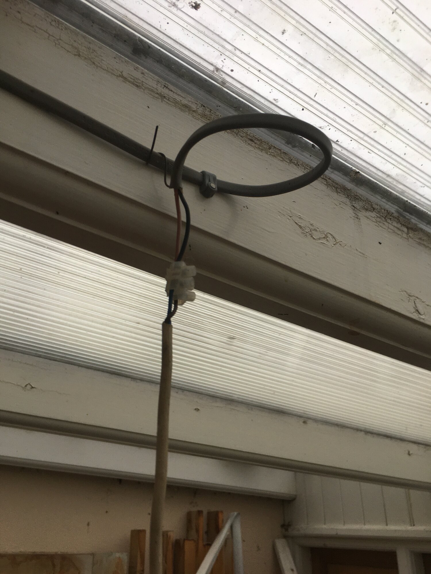

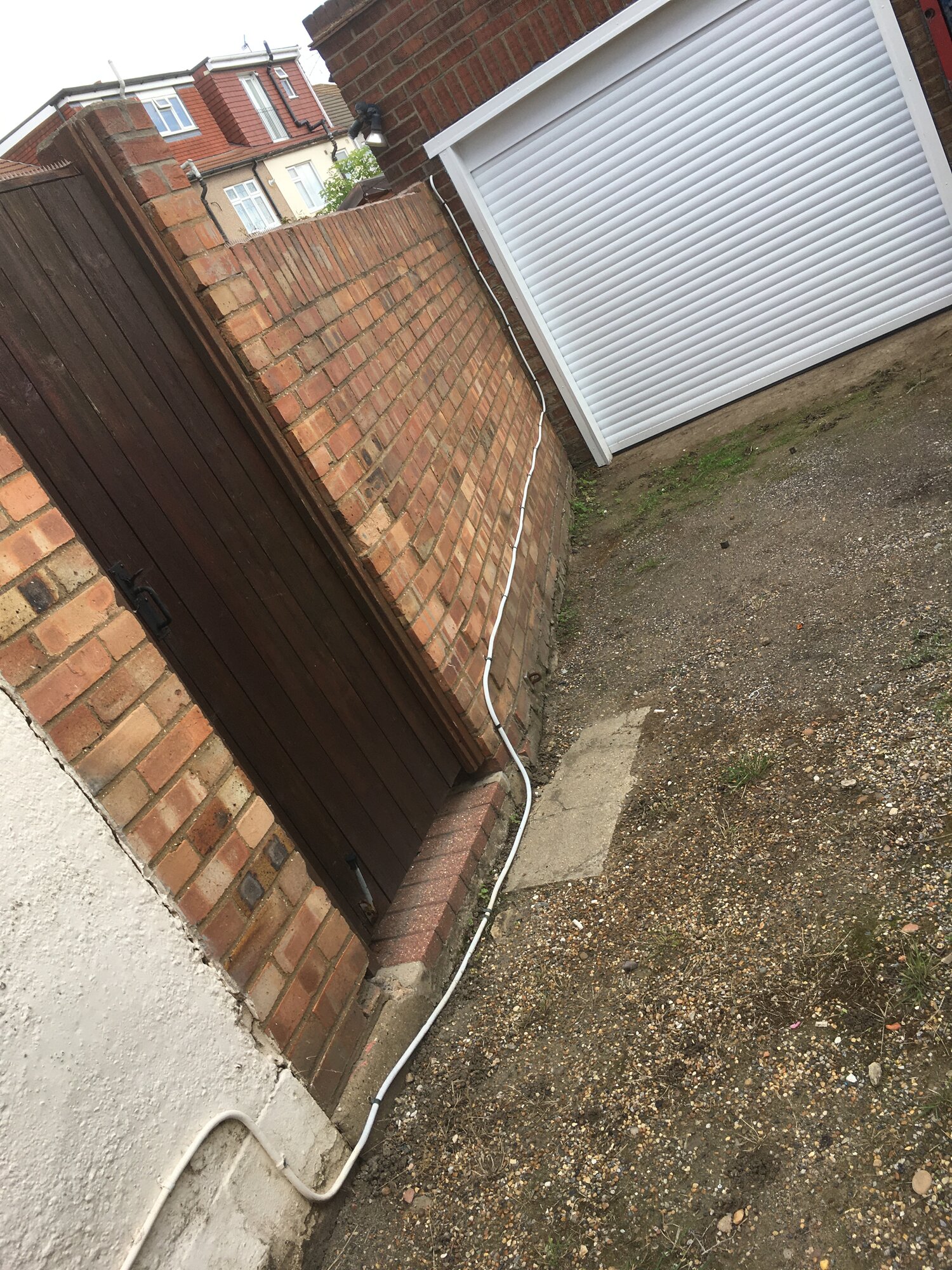

Strange, looks like maybe they were trying for a TT supply to garage but have failed on many points

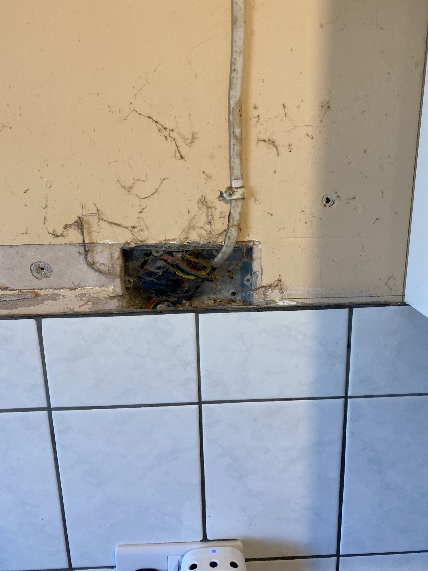

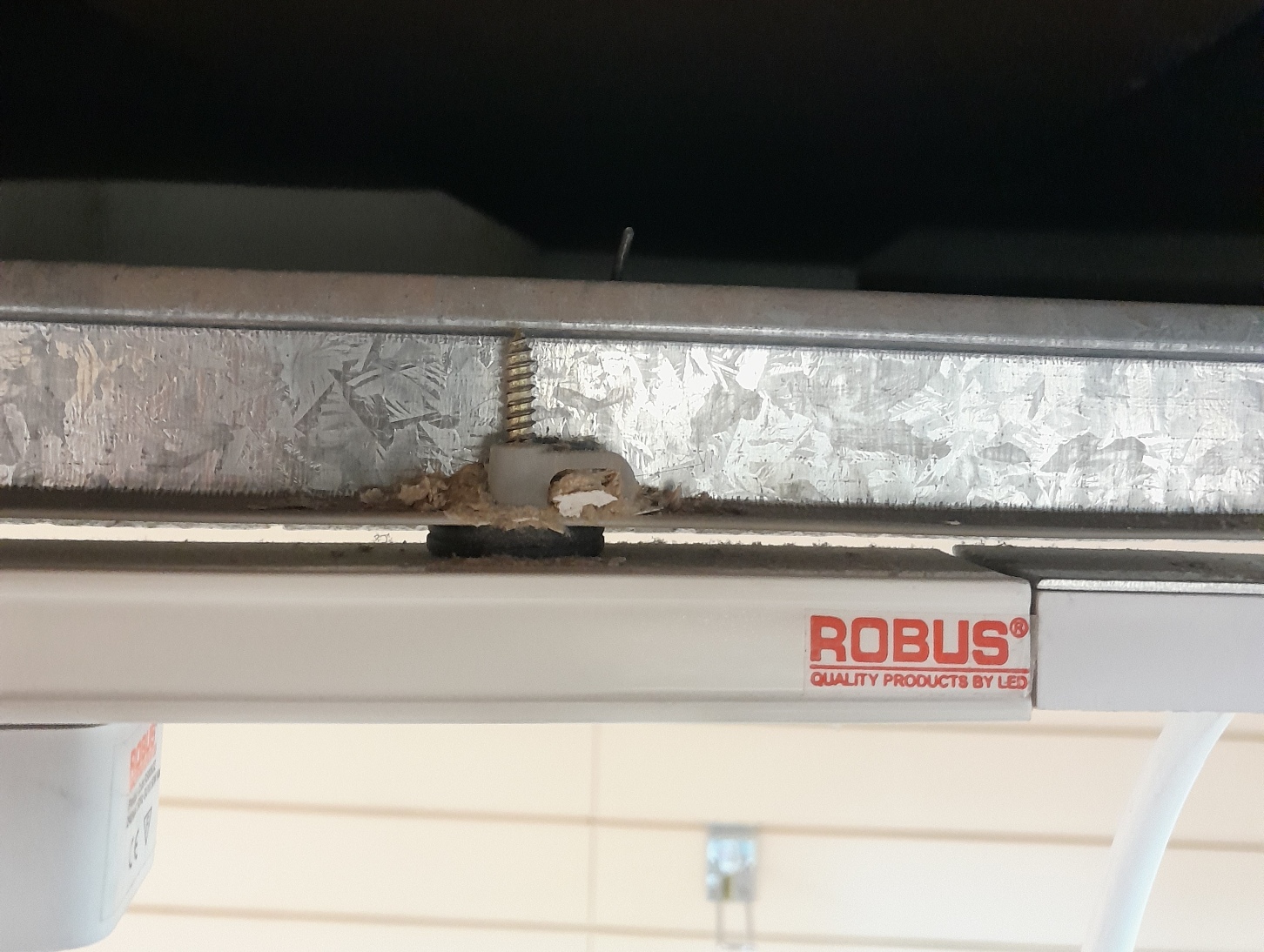

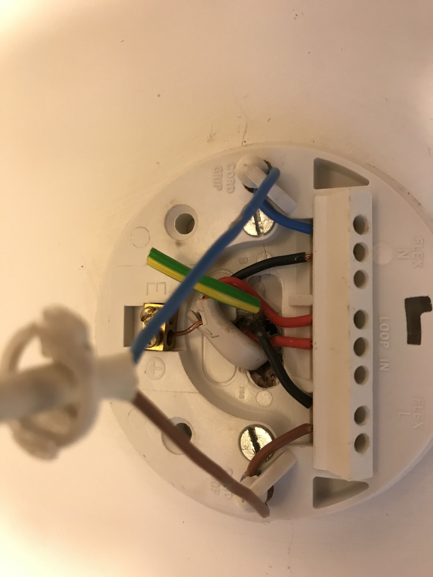

I am presuming the parts we are looking at were hidden behind kitchen furniture and appliances.

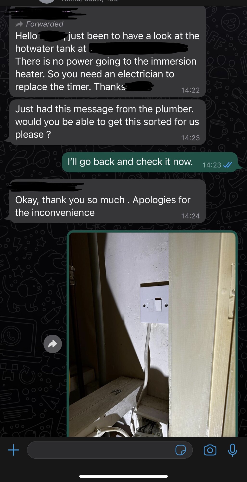

Pic 2 was the only one that was hidden, that being the redundant original cooker switch. Now being used to supply a cooker hood, double socket and two fcu's for appliances.
Pic 1 is the cooker hood socket outlet located on top of the cupboard, easily visible if they had bothered to look.
He had fitted a new double socket.
Mcb was still the 40 amp
