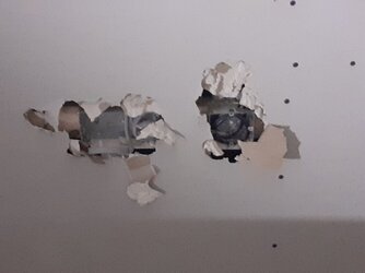

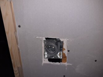

A builder we do work for is building a kitchen extension, I know he has done electrical work himself in the past before I knew him as half his house has "DIY" electrics all over the show. So we are wiring the kitchen/diner/utility for him, last time we were there the kitchen was 2nd fixed and the utility was 1st fixed, we turned up on Friday and he had taken it upon himself to move all the sockets we 1st fixed into new positions as he changed his mind, not only that he got it plastered and he second fixed it himself, All he wanted us to do was swap the fronts for chrome (oh and a cert).
Firstly he said the screws didn't quite reach so he got longer screws but they were too long so when he tightened one of them it ripped the lug of one of the boxes, when I removed the fronts I was this. as you can see, no grommets, way too short and stripped back with a machete. Can you imagine the pain it caused trying to sort that out, wonder if he has adhered to safe zones.

I went to second fix a kitchen I had wired a while ago and some sockets weren't where I had pictures of them. The Builder had moved them over and finished the wall! It was very quickly unfinshed by me and a chisel, especially after seeing the state of the cable sheath and insulation at the socket and the brand new twin KO box! Looked like he had used a claw hammer to remove it rather than a screwdriver!
The standards of some are very very sloppy indeed!
He's interfered with your installation without even informing you, besides ferkin' it up completely. I definitely would not sign off a certificate for that.

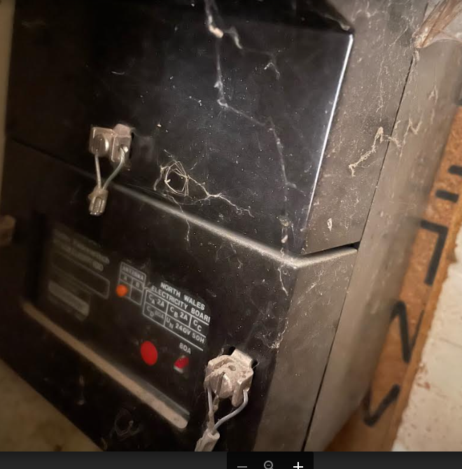

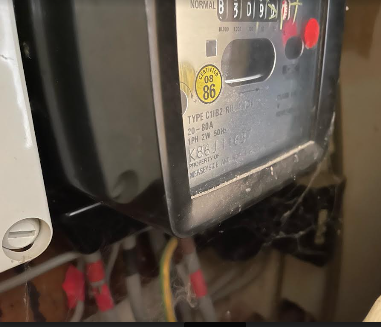

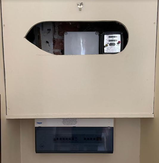

Today's fun. I was only there to change a cracked socket front a quick end of day job, which I did.
As far as I can tell it's TT (found the rod and getting 2 ohms Zs from CPC bar) but can't verify what else is bonded at this point. There's only one earth wire that isn't a CPC coming into the board, so suspect there's a MET somewhere in Narnia.
I didn't want to try a high current test in case there's an upfront RCD in there too!
Also of note is the split load board, so potentially inadequate fault protection for right hand half if parallel paths are removed.
I had to say that I couldn't prove I'd left it in a safe condition and I'd have to return, take the panel off and see what is actually going on.
(The panel is actually about 4 times as tall as shown and extends to the top of the stair well just to help matters)
Some photo's pointing my phone in the hole...
The earth wire below goes to an old oil pipe not the cut-out btw
2 ohms is either a very rubbish TN or a suspiciously good TT result!
Of course if there is a lot of oil pipe or whatever buried in damp ground then 2 ohms is possible, but it feels to me like a lot of buried metal or extraordinarily wet & salty ground.

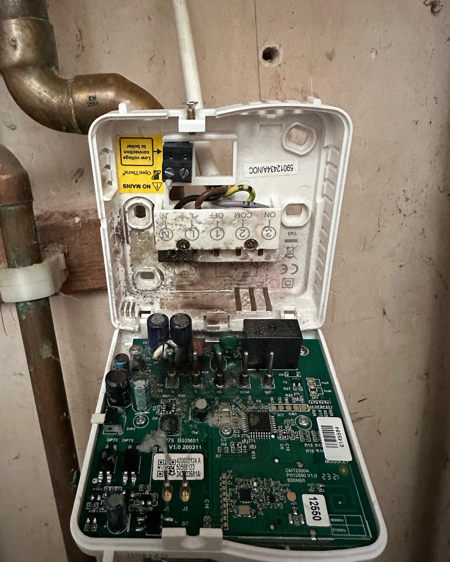

First one was a tripping boiler. Plumber had the wisdom to put the wireless stat directly under the boiler, which leaked straight into the stat. They’ve also used the earth as a core.
