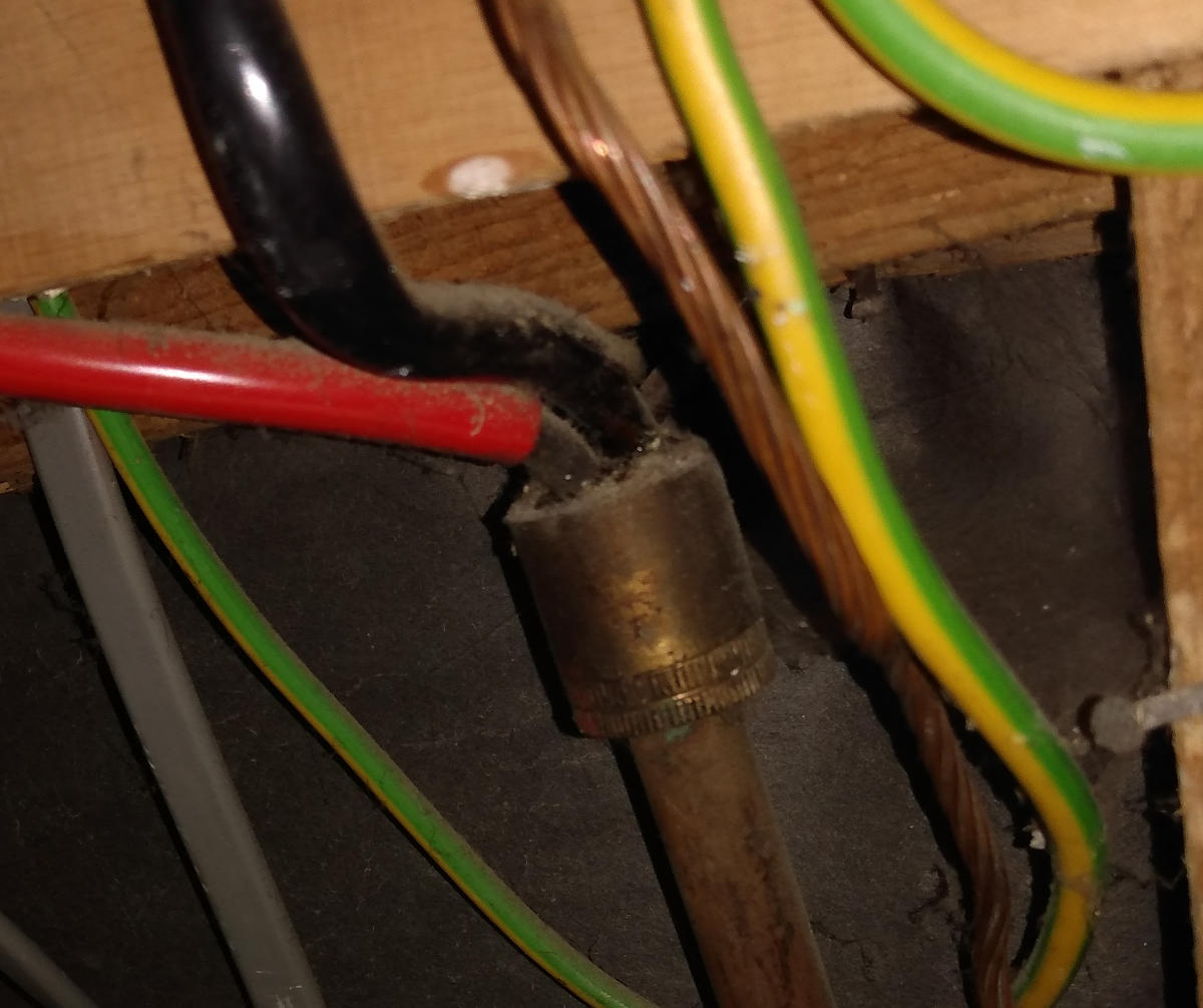

Black as the N and Earth as a Phase, Nice work there Mr Plumber and you wonder why you should be banned from touching anything with Wires
He may have used the grey and green/yellow as a 'volt free' switching pair from the relevant boiler terminals - still not right though.

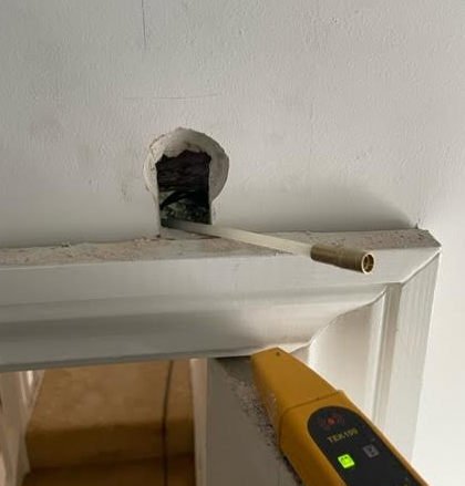

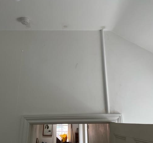

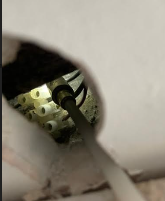

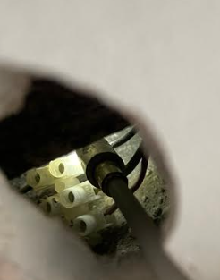

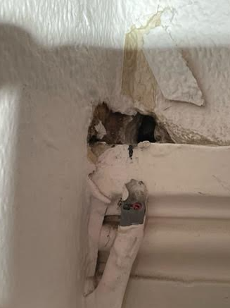

While trying to find out why a bathroom light doesn't work (for 3 months and multiple people have looked at it and ran away), it was obvious there was no power to switch...and the cable toner/tracer led me to this point as where it left the room. There was a suspicious severed cable the other side of the wall so I thought I'd have a look.
I decided to make the old feed safe and run a new one in the end. As there was no loft at all in this house it was time to break out the super-rods and today was my lucky day:.
And then some D-Line, sticks like, and filler (and some future sanding and painting....)
The exciting candlelit bathroom visits are no more.

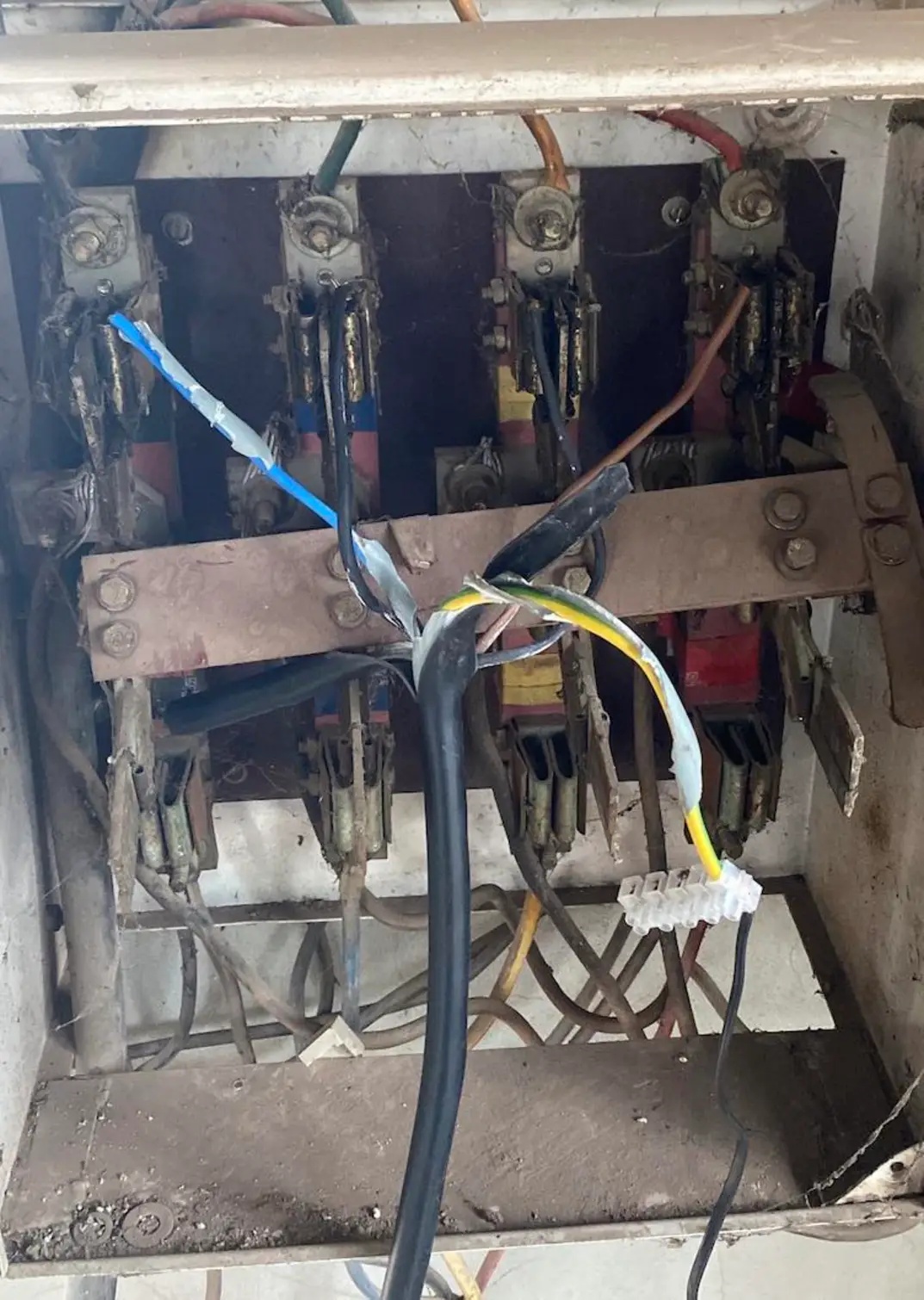

This is at the funeral directors I’m at today.
Behind a locked door, so no immediate danger, but I’ve told them to talk to DNO.
3ph cut out. L1 unused, L2 does the funeral parlour and L3 (which I suspect is a link) runs upstairs to another fuse for a flat.
Should have been noticed when the meter was changed last September.
L1 has two exposed terminals, L2 has its spare terminal capped off with a plastic pin and L3 has 1 exposed terminal.

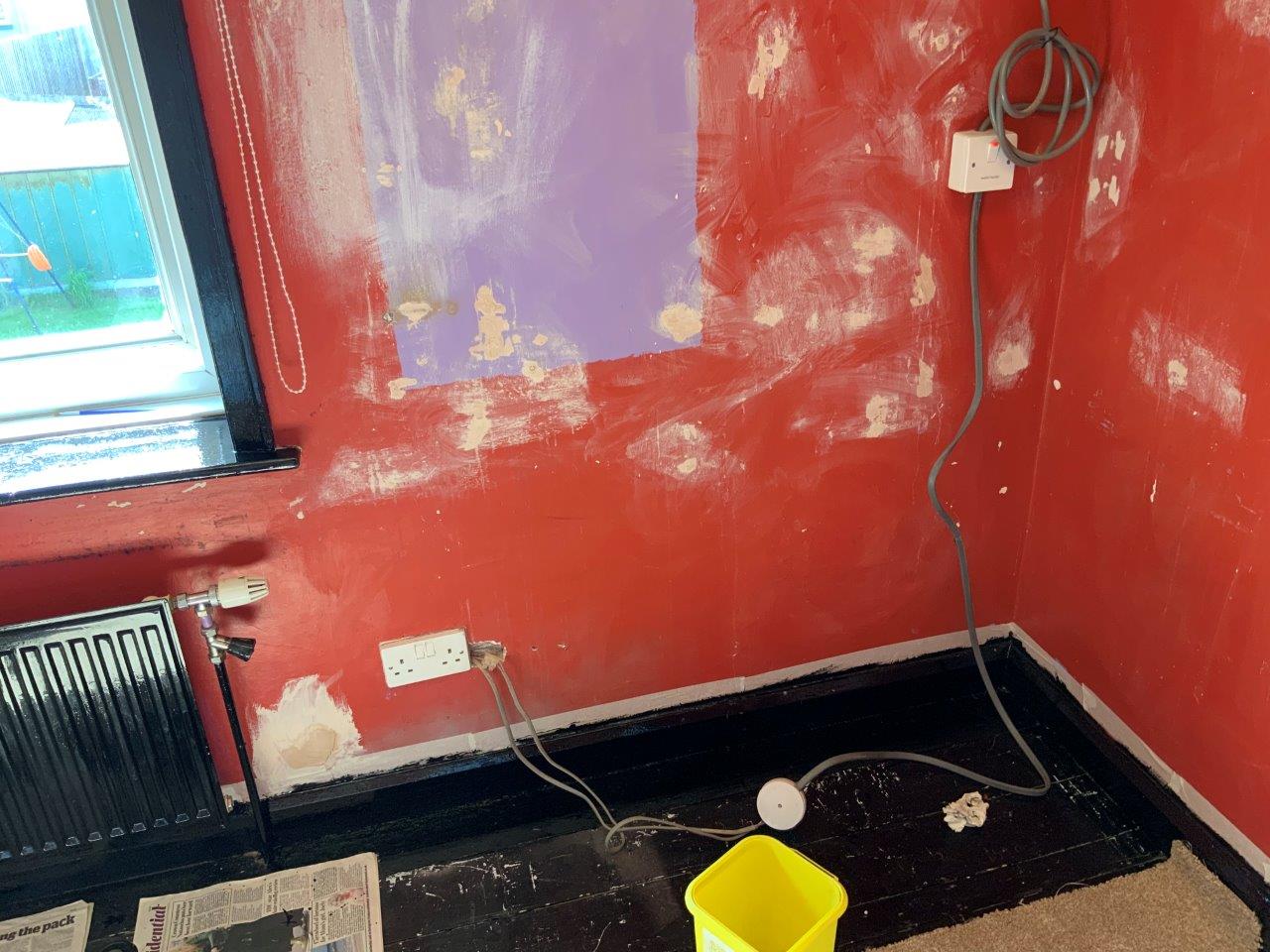

Can't have flat plate accessories in my (new build) new house I guess....
Reactions: nicebutdim
You can , but you will need to remove the 25mm box , hack out another 11-12 mm of wall and put a 35mm box in :)
Yeah I know but thought it would be a nice easy swap but most boxes mounted onto a dot and dab wall protrude by like 4mm
you will probably find the 25mm boxes are screwed straight on the block work hence they are sticking out 4-5mm

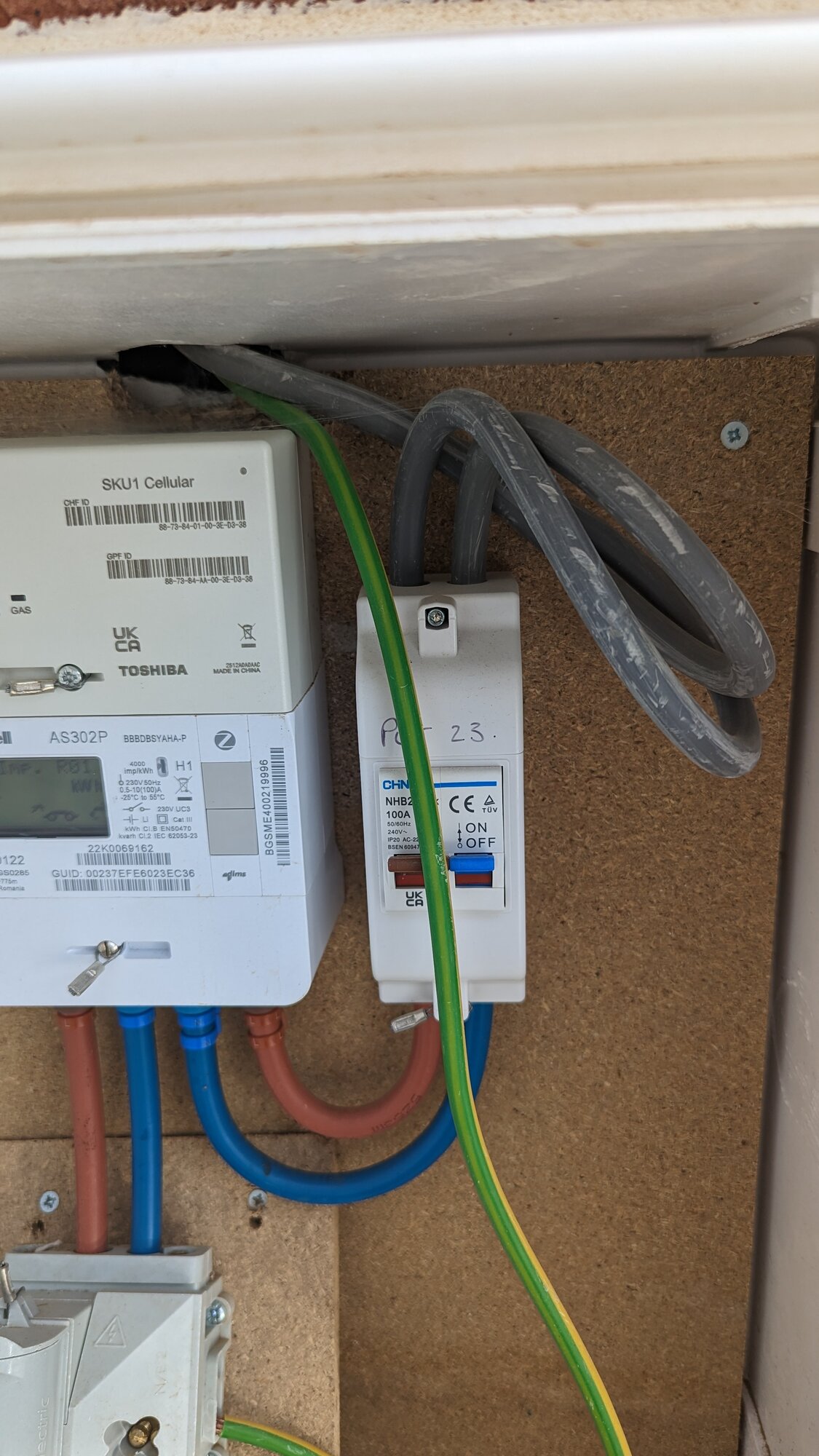

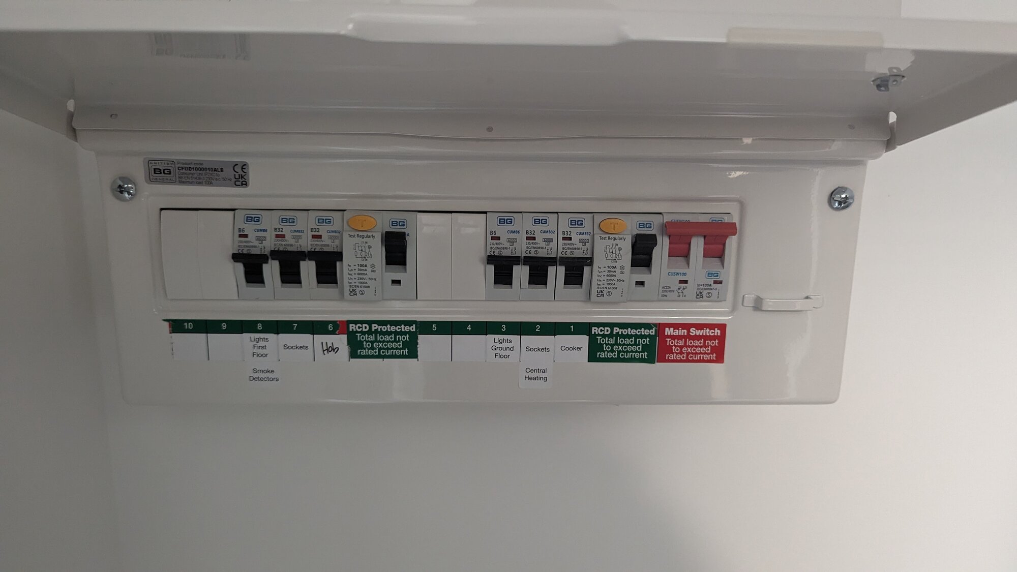

Classic stuff though meter tails must run 10 meters through the house, 100A isolator at the mains, and a BG dual RCD board in a house finished 4months ago....
Yeah man all done quick and easy like my ex wife
  • Funny
Reactions: pc1966 and Dave OCD
What an utterly stupid position to fit the main switch with the top so close to the top of the meter box, the outgoing tails then look a mess, that was probably the meter bodger fitter though. I don't suppose the Electrical Contractors have the initials CE by any chance ?
Bingo
Reactions: Dave OCD
I knew it ! :) If you have a detached garage it's probably fed in 1.5 SWA.

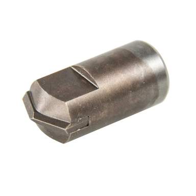

Might be an excuse to try one of these (and the matching SDS adaptor) to get a new rod down through rocky ground:
It has also been very dry so if the rod is not deep it probably has got that issue as well.
Already have the adapter and have quoted for the sacrificial bits.
Used them before and they are very good. I’m guessing they have only used 1 rod as I can usually get the reading somewhere around 50ohms if I use two 16mm rods.
Good to hear! I modified M16 stainless threaded rod with angle grinder to achieve much the same before.
