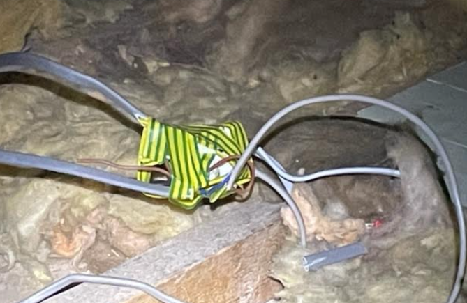

So they are normal non-sealed boxes with some attempt to pot with resin or whatever?

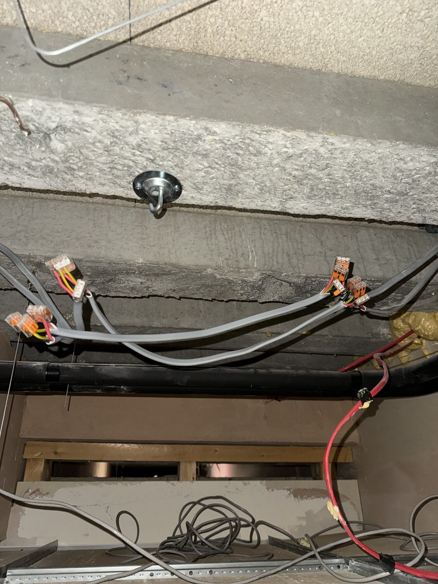

Galv Tees with some form of resin poorly poured. Best thing about the job is the Wagos. Honestly I’ve spent a day trying to break this circuit down, from the R1R2 reading we estimate this circuit is about 250 metres long 2.5mm lighting circuit.

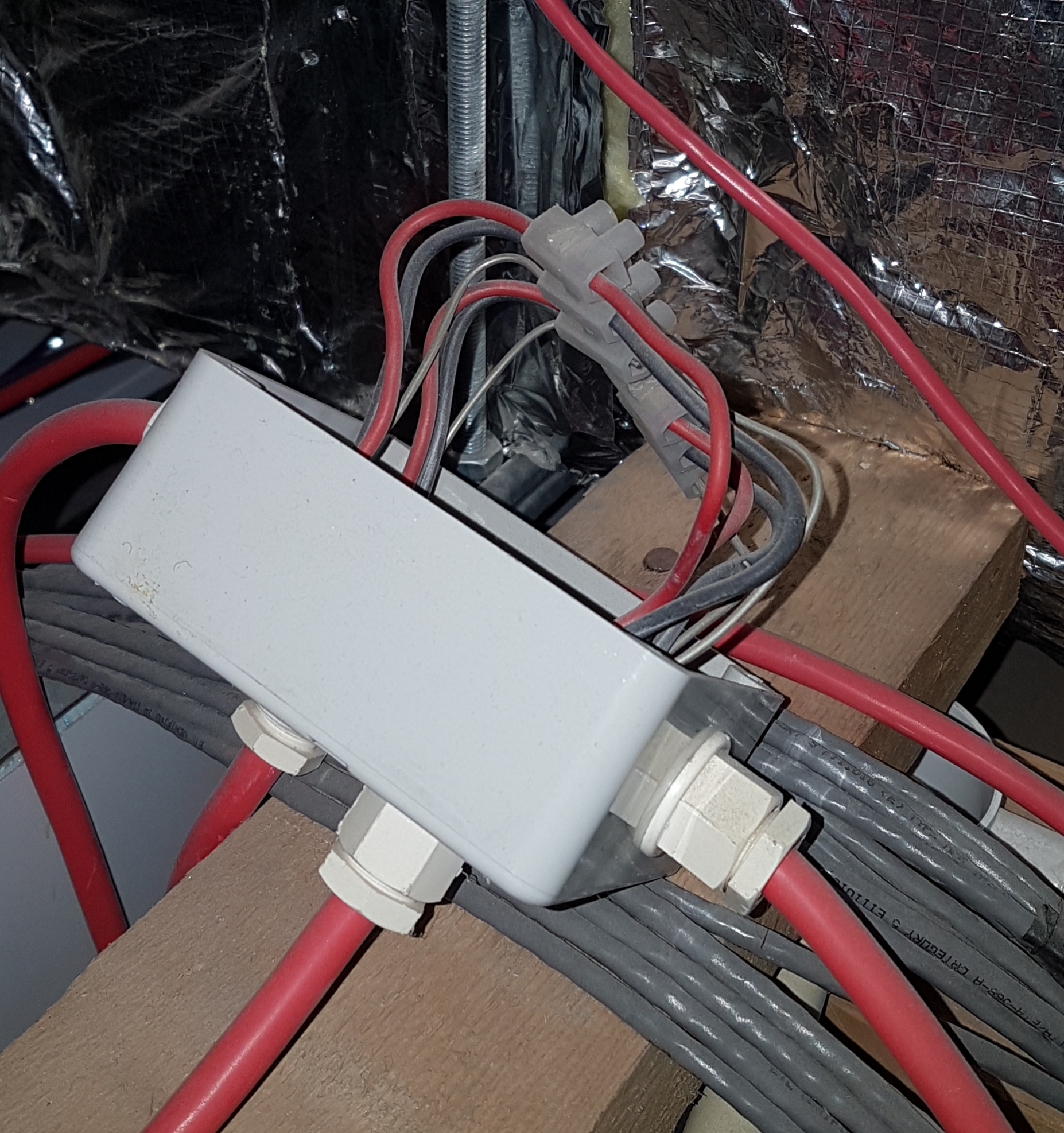

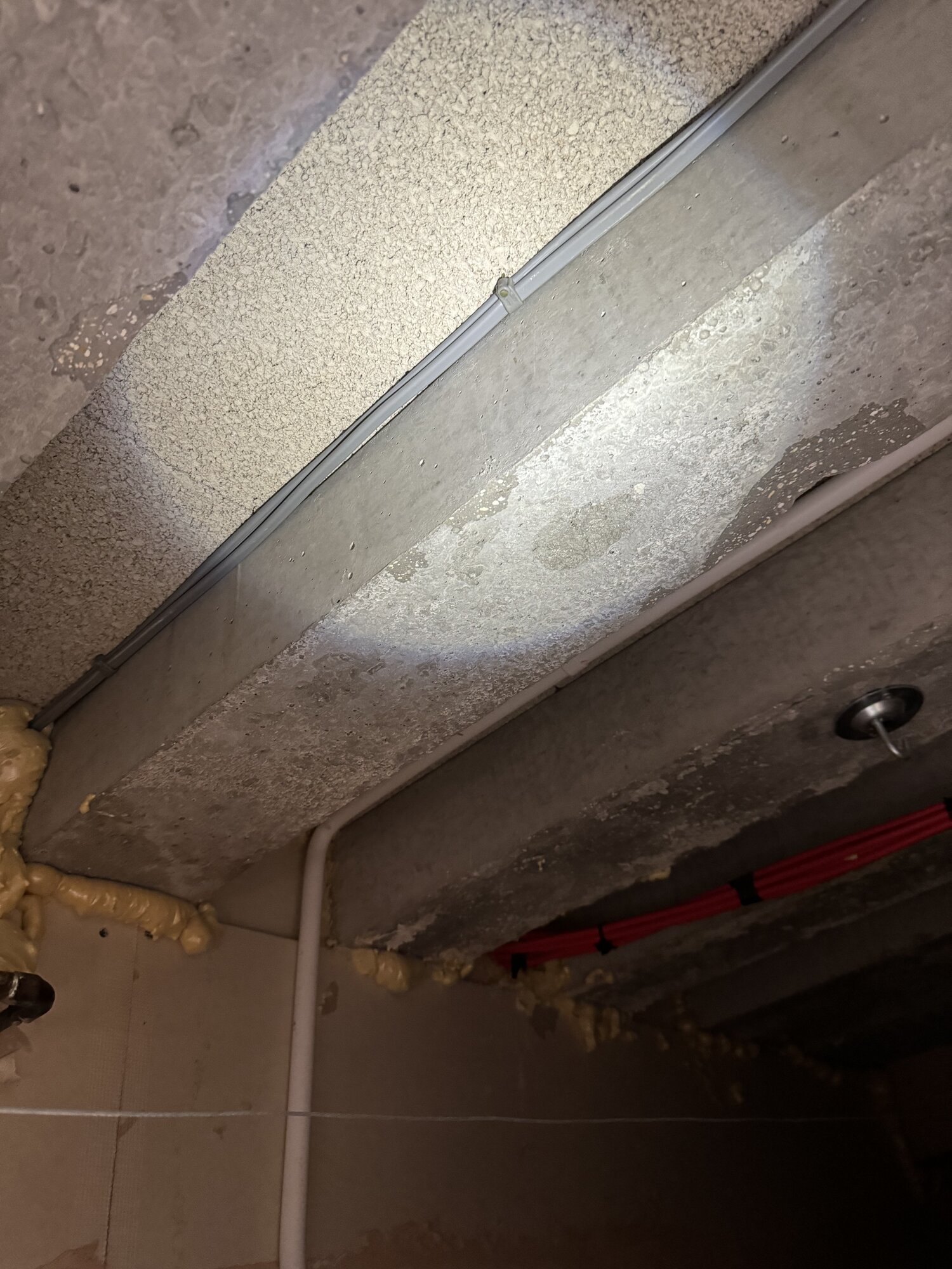

Was re-routing some fire alarm zone cables and found this inside mini trunking.

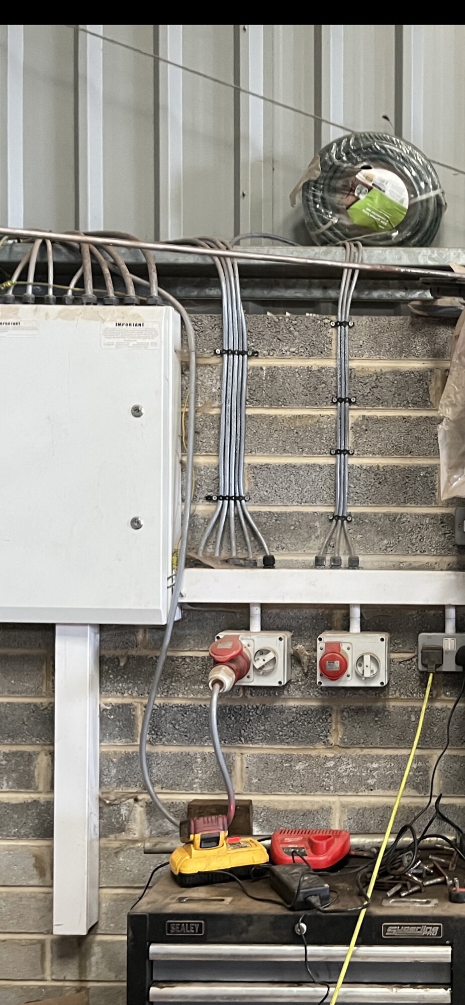

Losing the will to live. 2 of us spent a few weeks at a commercial site disconnecting/removing unsafe wiring and testing repairing what could be saved when a company opened a new depot in an older unused site.
Half of the site was separated to be rented out, so we split the circuits on that side into a new DB via a sub meter, all thoroughly tested and inspected as quite a number of shoddy/unsafe diy alterations had been carried out by the previous owners, a shame as the original ~50 year old installation was installed to an exemplary standard. All defects were removed or faulty circuits disconnected for future repair if they were needed, and the area was safe to use by the new tenants.
Back there today, new tenants moved in a week or 2 ago, and we are being contracted by the landlord to repair the lighting in the workshop area of the rented side as this was now required, previously disconnected by us due to unsafe switching alterations that led to shared neutrals, circuits from different mcbs linked and other serious defects.

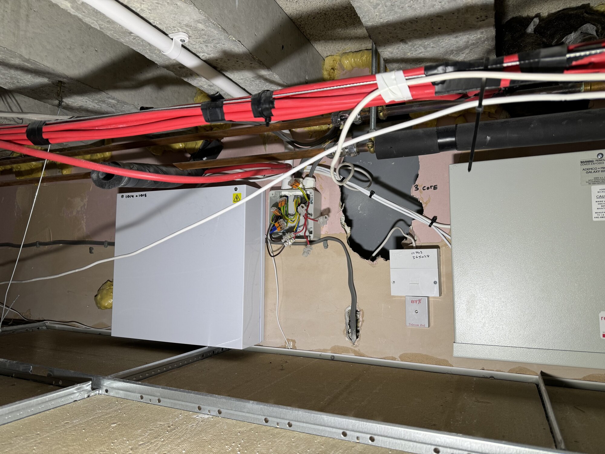

Following on from yesterday’s post, look at the state of the cables buried ??. Wiska box is our new joints

what's the gland on top of the wiska box for. that will eventually let water in.
Reactions: ChrisElectrical88
I do love the storm glands they are great, much better than the cw ones. @ChrisElectrical88 do you not use the wiska earthing plates or piranha nuts for the swa glands? They too make life soo much easier!
Reactions: Rpa07
I normally will use the Piranha nuts mate, wholesalers run out though and this was sort of dropped on me yesterday. Banjos are bolted on the outside rear of the Wiska box, bit rough, but all I could do with what was available
Reactions: SparkySy
Didn't think earthing nuts fitted those boxes which is why Wiska developed those earthing plates.
@ChrisElectrical88 sounds typical of the wholesalers at the moment. All you can do is the best with what's available!
@westward10 Quite possibly not on the 308 size box I think you are right that is why the earth plates were created, but I'm sure I've used earth nuts on either the wiska or wago box of one size or another and they worked in the past.
Yep, piranhas don't fit. Also the Wiska earth bars are different for the two sizes of boxes ( ask me how I found out)
