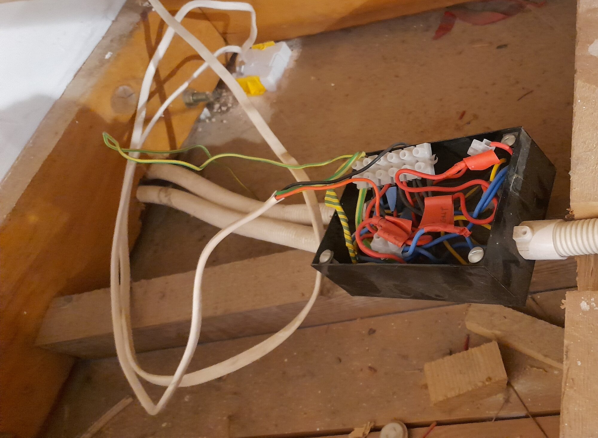

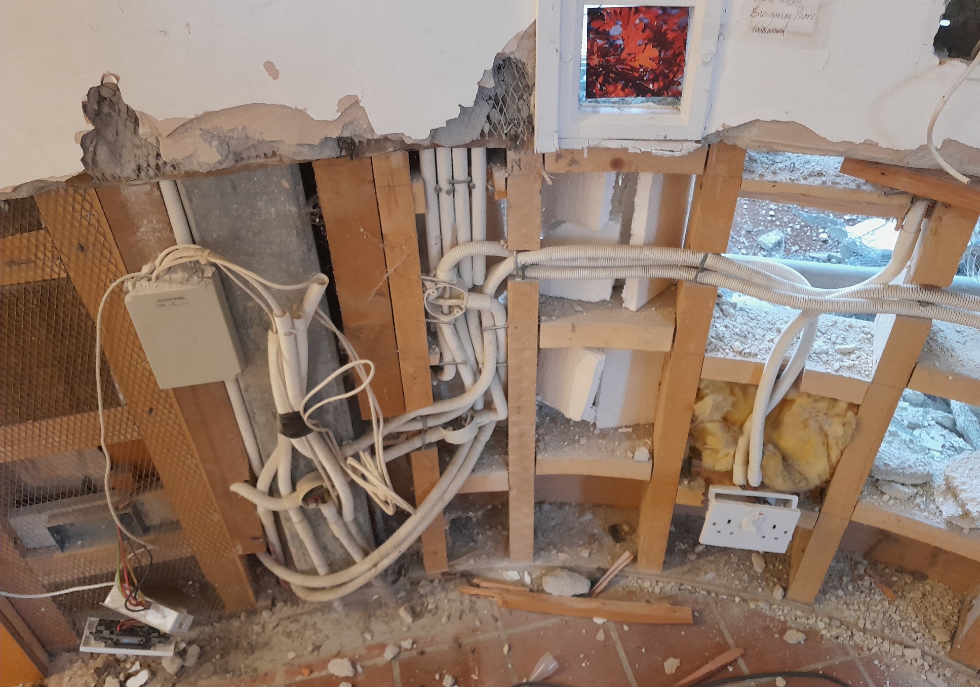

First day back to work in 2024 and it's started already. Thank goodness this is all being demolished.
Junction box as found, lid missing, metal box not earthed, neutrals from multiple lighting circuits mixed up, wiring extended via front of box. flexible conduit poked into female adaptors.
This total mess was behind the plasterboard. Someone actually installed this. Very little in the zones, singles unprotected all over the place. The whole building is wired like this in flexible conduit buried wherever.

I didn't photograph all the live cables with taped up ends, or any of the twist and tape cable joints.

There was probably a time when someone thought it was a job well done and beyond the minimum requirements.

Looks like different teams to me, why would someone start to use flexible conduit with glands and then not finish the job properly, or am I being over optimistic.
They use a lot of cable in smooth flexi conduit all over Europe… and the white stuff there is possibly the closest thing we have that is similar.
Therefore, I deduce Doctor Watson, that this installation was put in by none other than…… (dramatic pause) …. A foreigner!
Ok.. that’s not fair, there’s plenty of non Uk sparks that are good and do have an understanding of our bs7671…. This one apparently doesn’t.
What’s that old song? “Rip it up and start again….”
Dramatic difference between the black conduit you can buy in TLC (20mm Flexible Conduit Pack c/w 10 Glands - Black | Flexicon (FPP-CP20B) - https://www.tlc-direct.co.uk/Products/AF20BSB.html) you get glands, but in Europe you get a draw wire already installed, but no glands, back box's are unsuitable. (https://www.leroymerlin.fr/produits...a/gaine-icta-diam-20-mm-l-100-m-62900572.html)
That sort of flexible conduit is one step up from being of no use whatsoever. Awful stuff, although I invariably install quite a bit of it in stud walls to provide a route from A to B - generally short runs to an exit blade or for the likes of low voltage door controls.

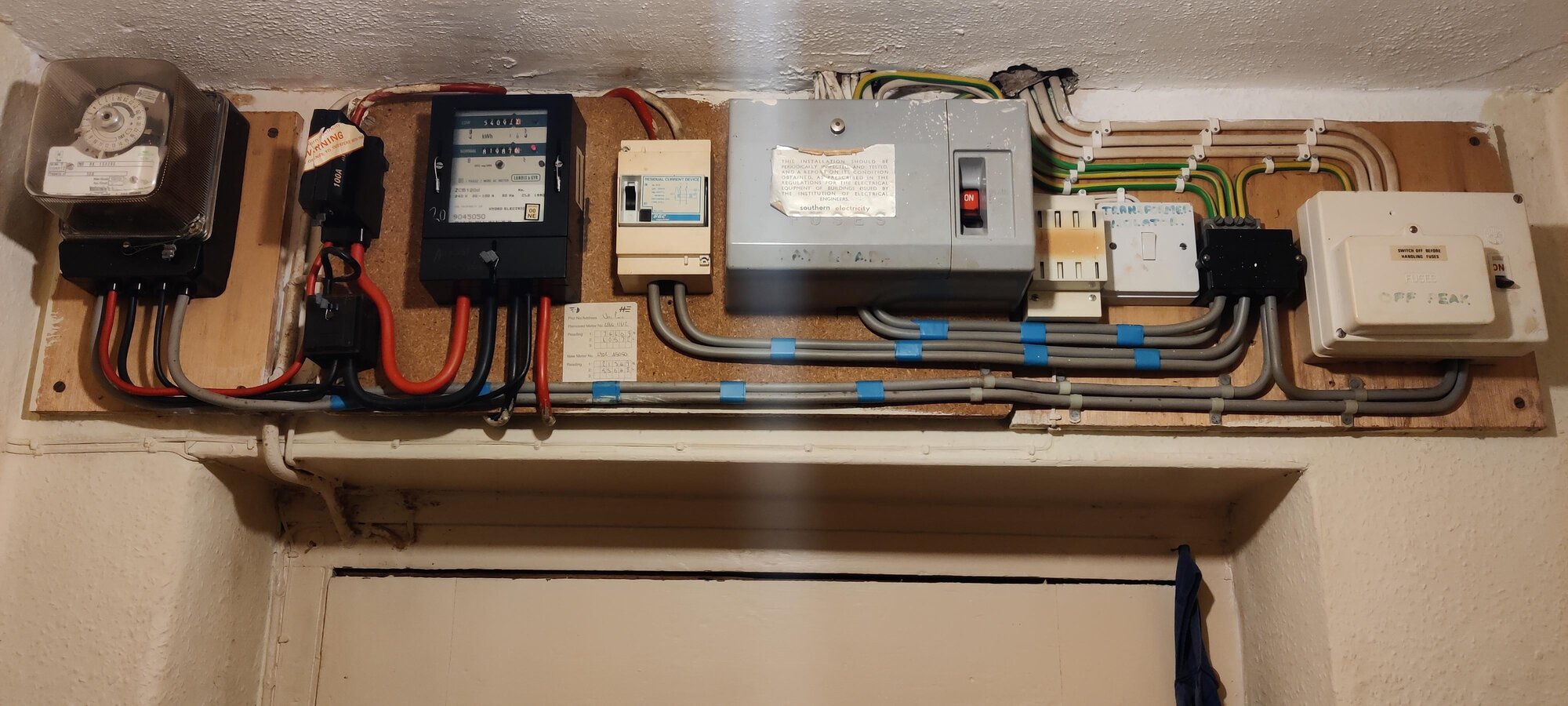

Meter man came to install a smart meter, Pity he wasn't as smart as the meter.
^^^^^ so not only has a neat installation Benn made rough, but was that RCD needed for fault protection? Looks like a TT system to me!
Sy
Oops just looked again and PME I take it from the second Henley/ service blocks.
