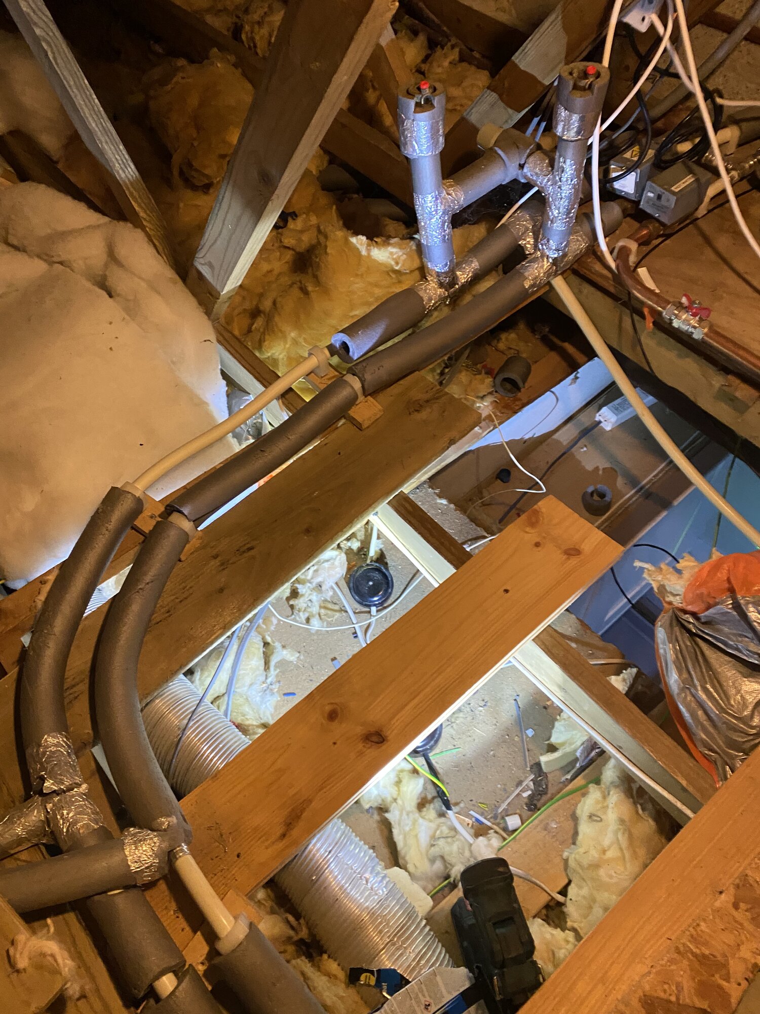

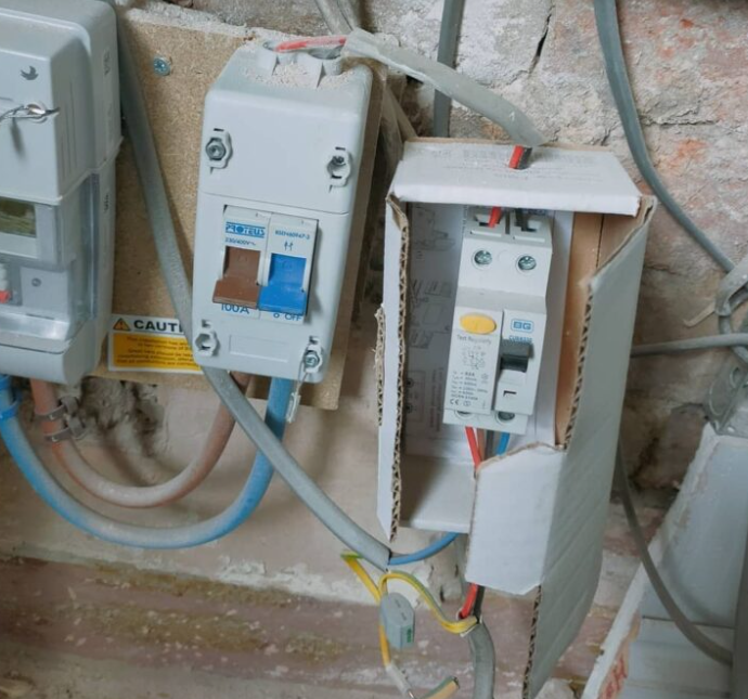

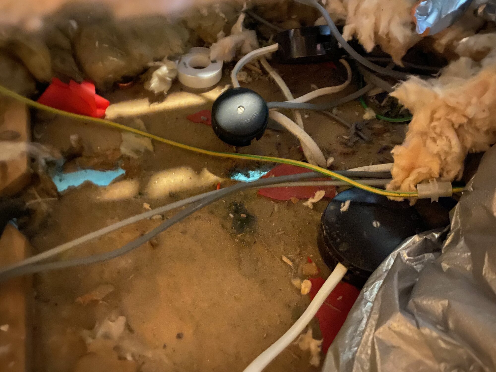

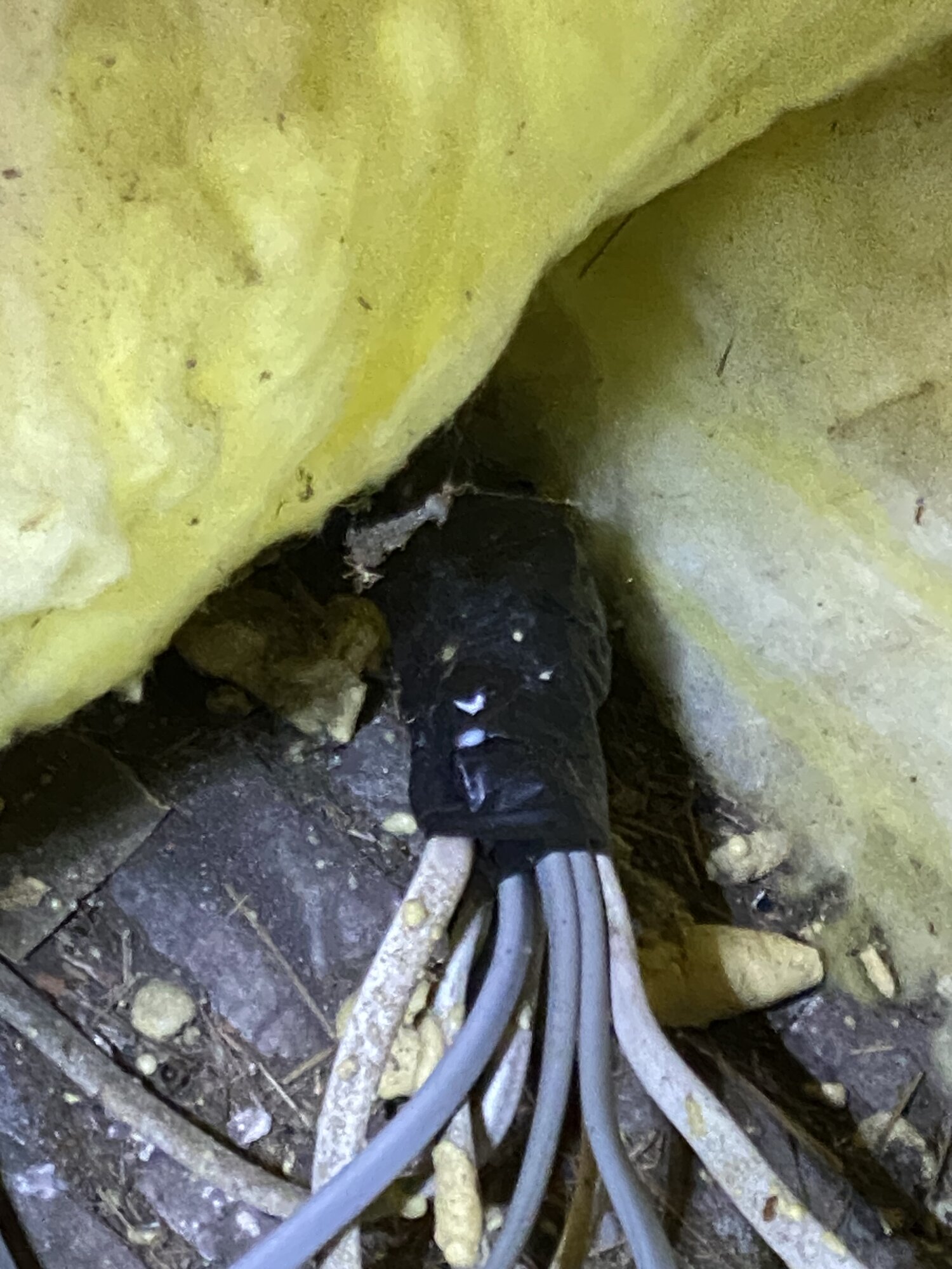

More DIY crap. The whole house was like this. Thing is the couple had only bought it a few months previously yet the surveyor didn't flag up the electrics as a point of interest at all. If they had then they could have an EICR done and possibly knocked some money off the purchase price. What would you recommend their next course of action be? I think they deserve compensation.
Fuse board was 16 edition clipsal. It had a plastic shelf glued onto the top. What should the surveyor be looking for? Right beside it is a bit of twin and earth dangling about an inch away from an incandescent bulb, all under the stairs.

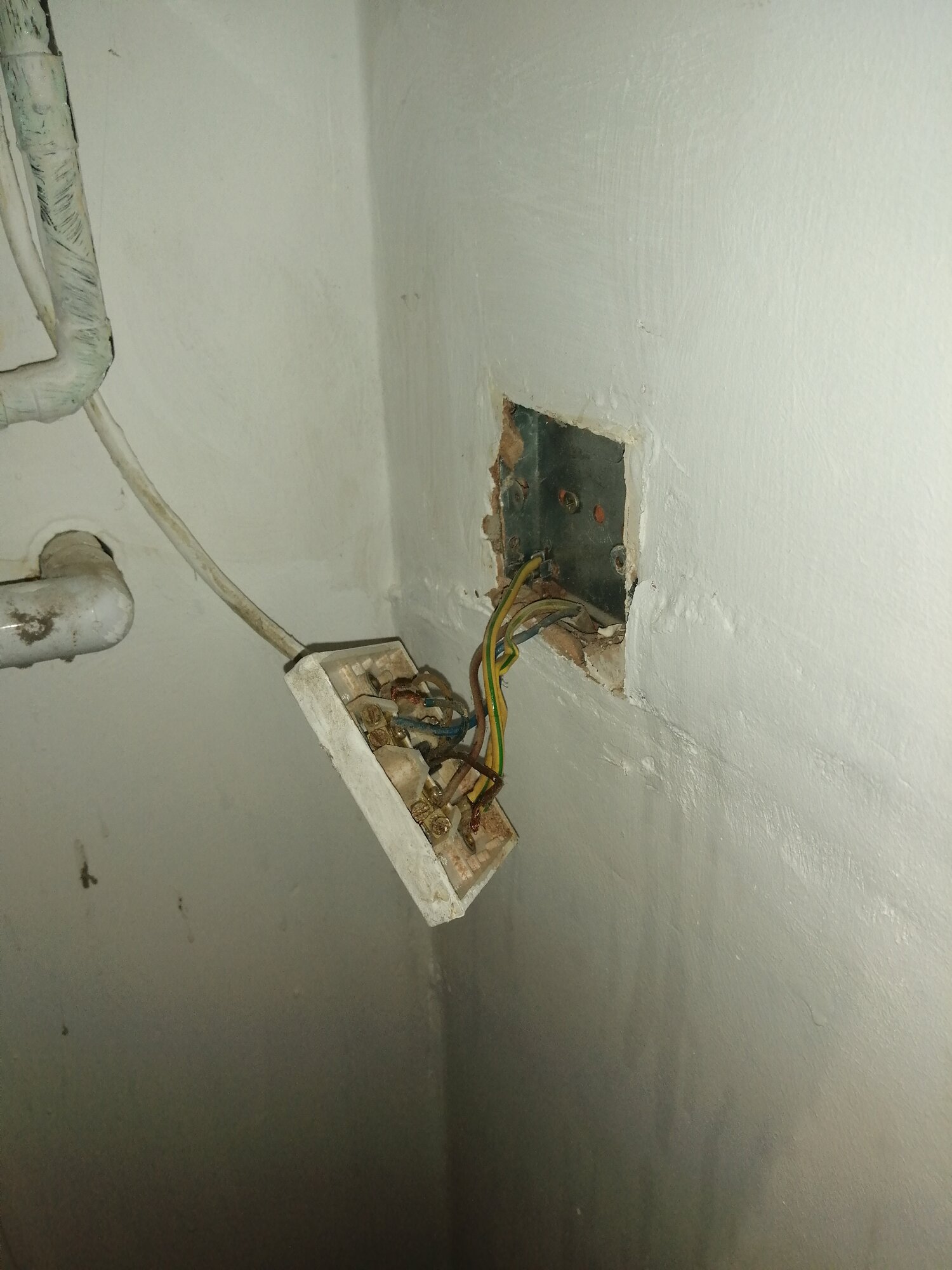

Yeah. Understood. I'd like to know what these surveyors do though. This pic is also from under the stairs right by the consumer unit. I wonder what their electrical training is?
Qualified Building Surveyors (RICS) are trained in all aspects of building work, however they are also trained in Law and how to word any document produced to ensure they are not liable for anything missed by their survey and not included in any report.
