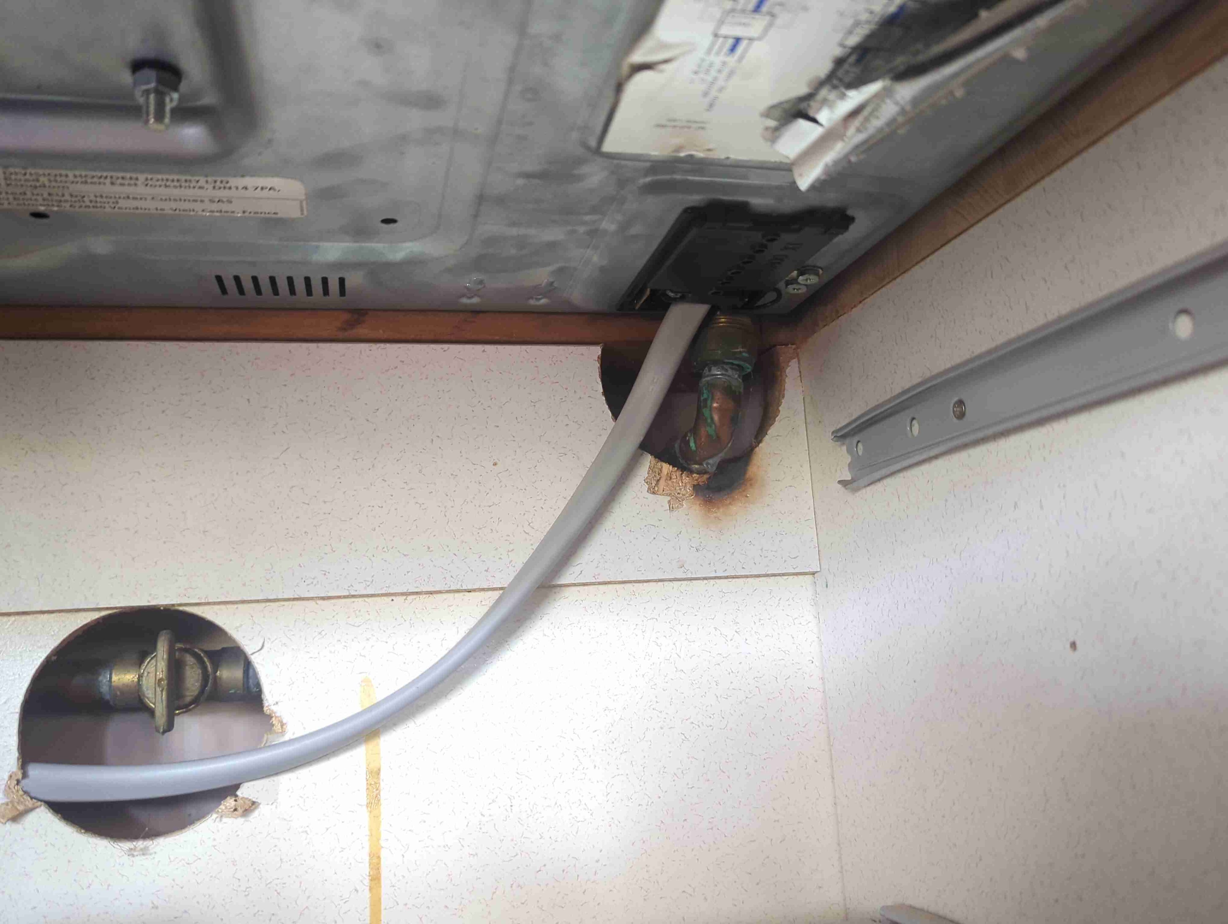

Not great. At least the gas valve there is turned off.
At least it HAS a gas valve. A few years ago in our rental flat the hob developed a leak. No gas valve, so had to pay someone to come in and disconnect it temporarily while I bought a new one, then pay them to come back and fit the new one. Asked if he could fit a valve and told no, no room for it (which to be fair was probably correct without pulling units out to alter the pipework.

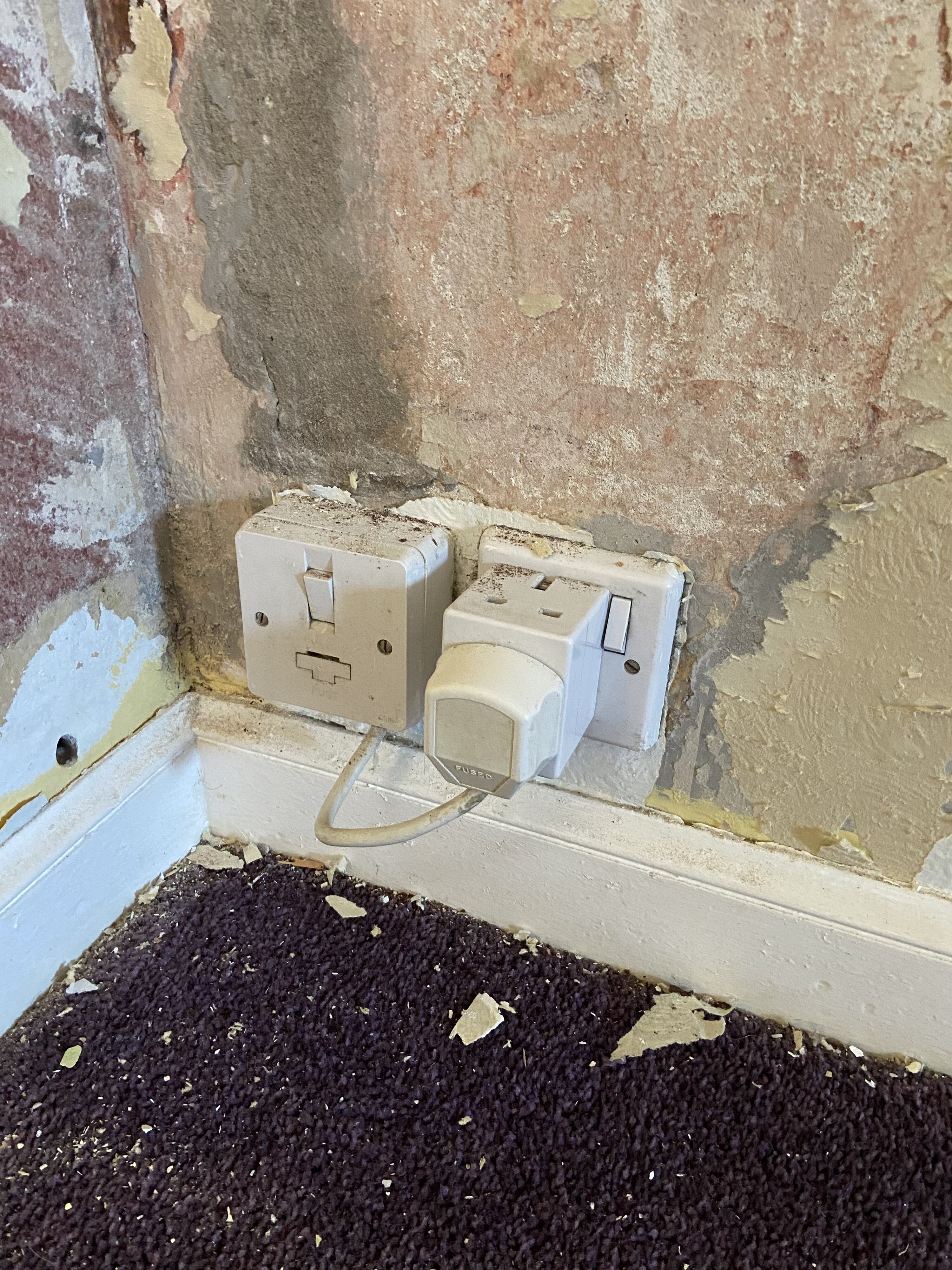

The plug flex goes into the fcu, supplying it backwards… then buried t&e up to this lightswitch.
Up the wall, the left turn and buried in the plaster around the edge corner of the chimney breast to feed the spotlights.
Guess where the rawlplug is holding the spotlights up.
All this has been stripped out. But I’ve discovering more and more strange things in this flat.

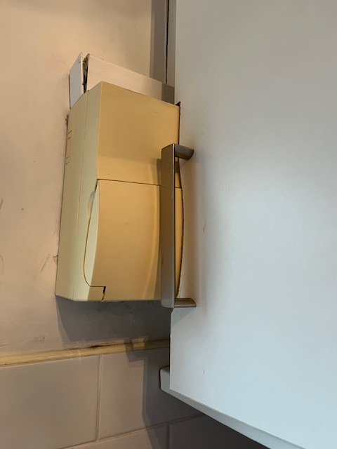

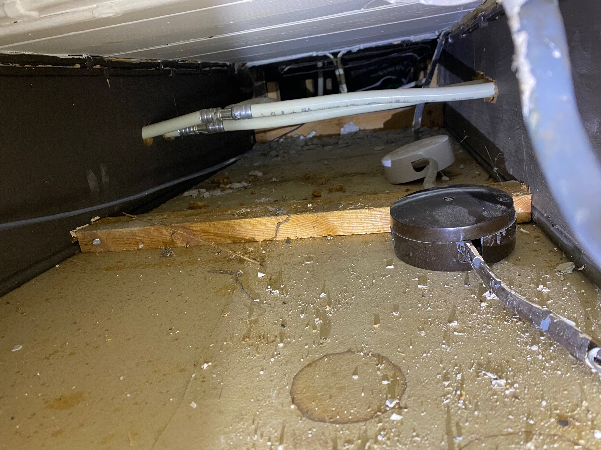

I stayed at a little self catering place last night. I noticed the splash back thingy wasn't fixed to the wall so I took a look behind.

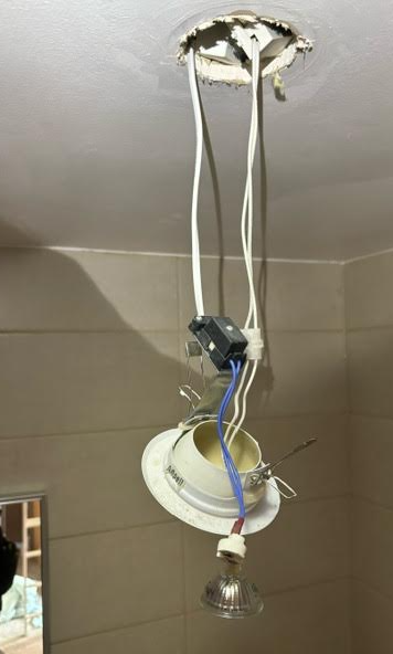

2 - I don't think I've ever found 3 live sources over a single downlight before... 2 transformers with primary energised, secondary failed on one, both bulb holders still connected, and in addition a live GU10 bulb holder...

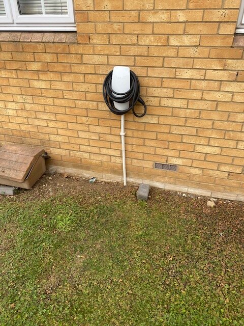

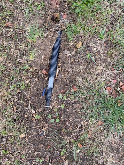

The block of flats i do maintenance for had a brand new Tesla charger installed, I knew the guy whose parking space it was lived in the next block on the 2nd floor
Had to have a nose to see where he supplied it from
Gonna see alot more of this type of thing!
What about the poor guy who cuts the grass!
I wonder how its been protected at the consumer unit end?
Report it.
Is there a management co. that looks after the grassed areas? This has introduced a hazard that shouldn’t be there…. As you say, the grass cutter might get a bit of a shock when he next runs over it.
Is it a UK compliment charge point or an Amazonian special?
Report it.
Yeah i did report it, they were actually given permission to install it apparently and the managem,ent company didnt seem too bothered, i forwarded these pictures to cover my --- tho
It was a Tesla unit
It was a Tesla unit
Could they have not rearranged the parking spaces so his was directly below his flat… negating the need to cut across the grass.
It’s an actual Tesla charge point?
You think he could afford to have it done properly then

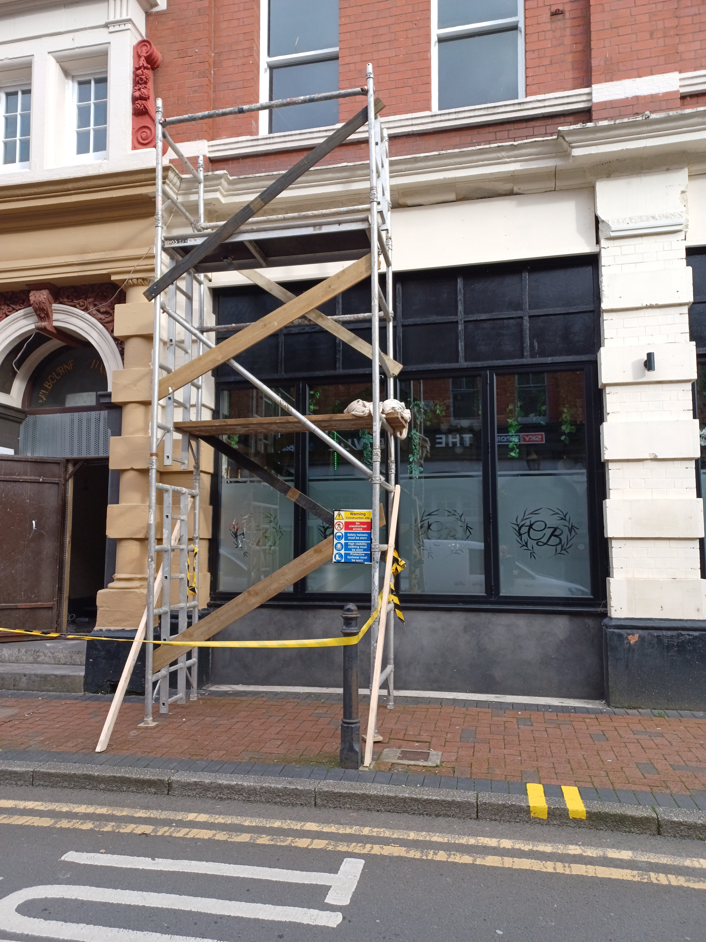

Not electrical but I found this amusing. While wandering around Merthyr waiting for my Transit to have the work done on it's recall I saw this on a busy(ish, as busy as Merthyr gets) street. I didn't see a scafftag on it though. They did take safety seriously, those planks are screwed into the ally poles of the scaff :D
i read that wrong.... I thought you said "While wandering around Merthyr LOOKING for my Transit"
Like, damn, i forgot where i parked it....
I thought this was a new transit? whats needing done to it already?
If you leave it long enough in Merthyr you will have to look for it, it'll be long gone.
Anyway, there's a recall on the new shape Transit. The software on the body control module needs updating. The main problem is the alarm going off whenever it feels like. I've had to leave it unlocked overnight whenever I'm home. If I'm working away I just park somewhere where I won't hear the alarm going off.
That scaffolding has been there for a few years.

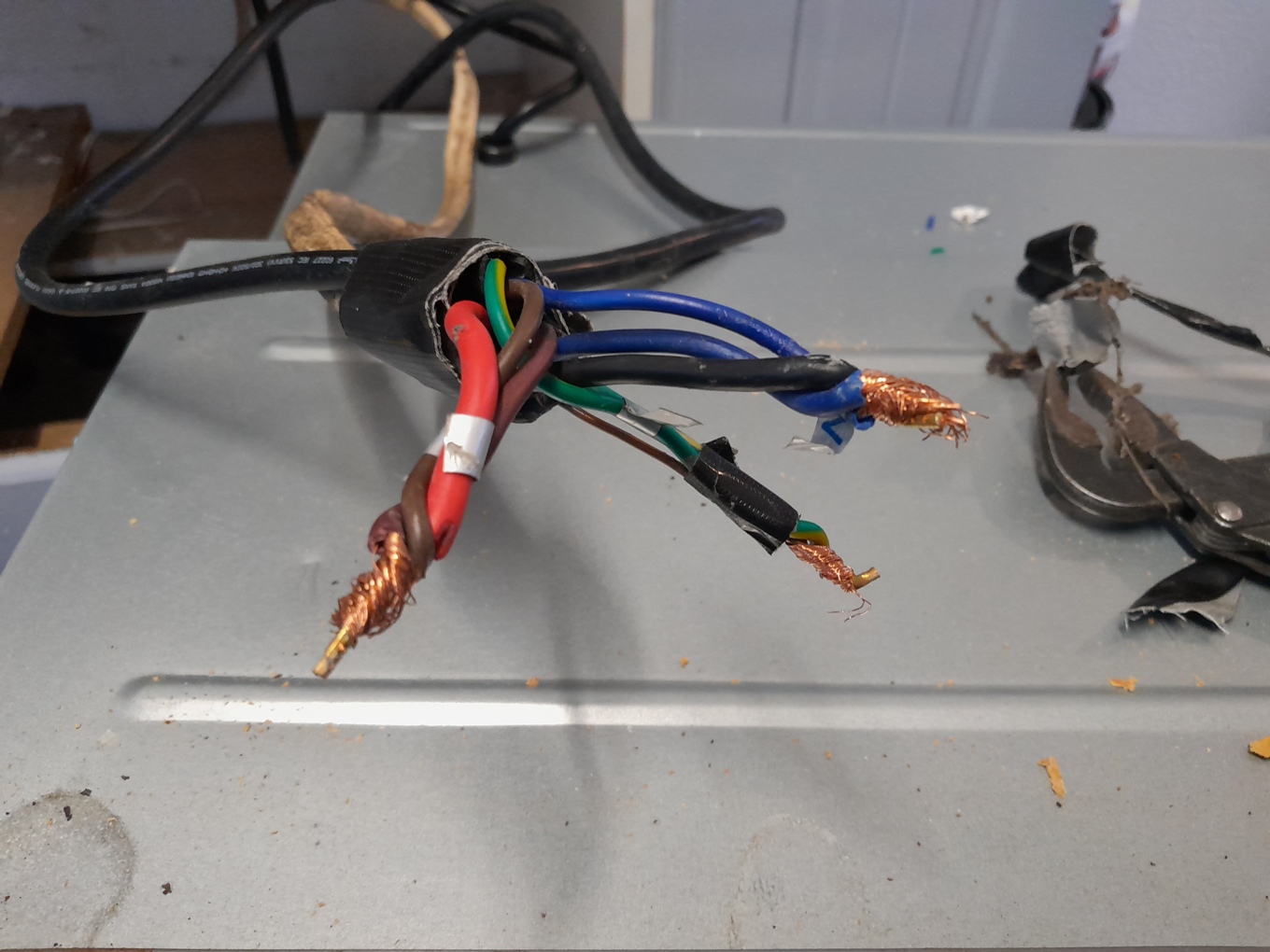

One of a list of jobs during a small referb of a guest house on a large estate was to replace the built in oven and hob.
Thought there might have been connectors under the tape.
Nope, just twisted together! That is a 2.8kW oven and 5.5kW hob, twisted and taped. Can't have had much use, didn't see any signs of overheating.
The wood screw holding the cooker switch back was the fist sign of issues.

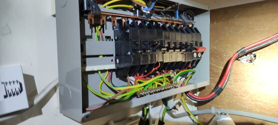

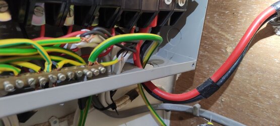

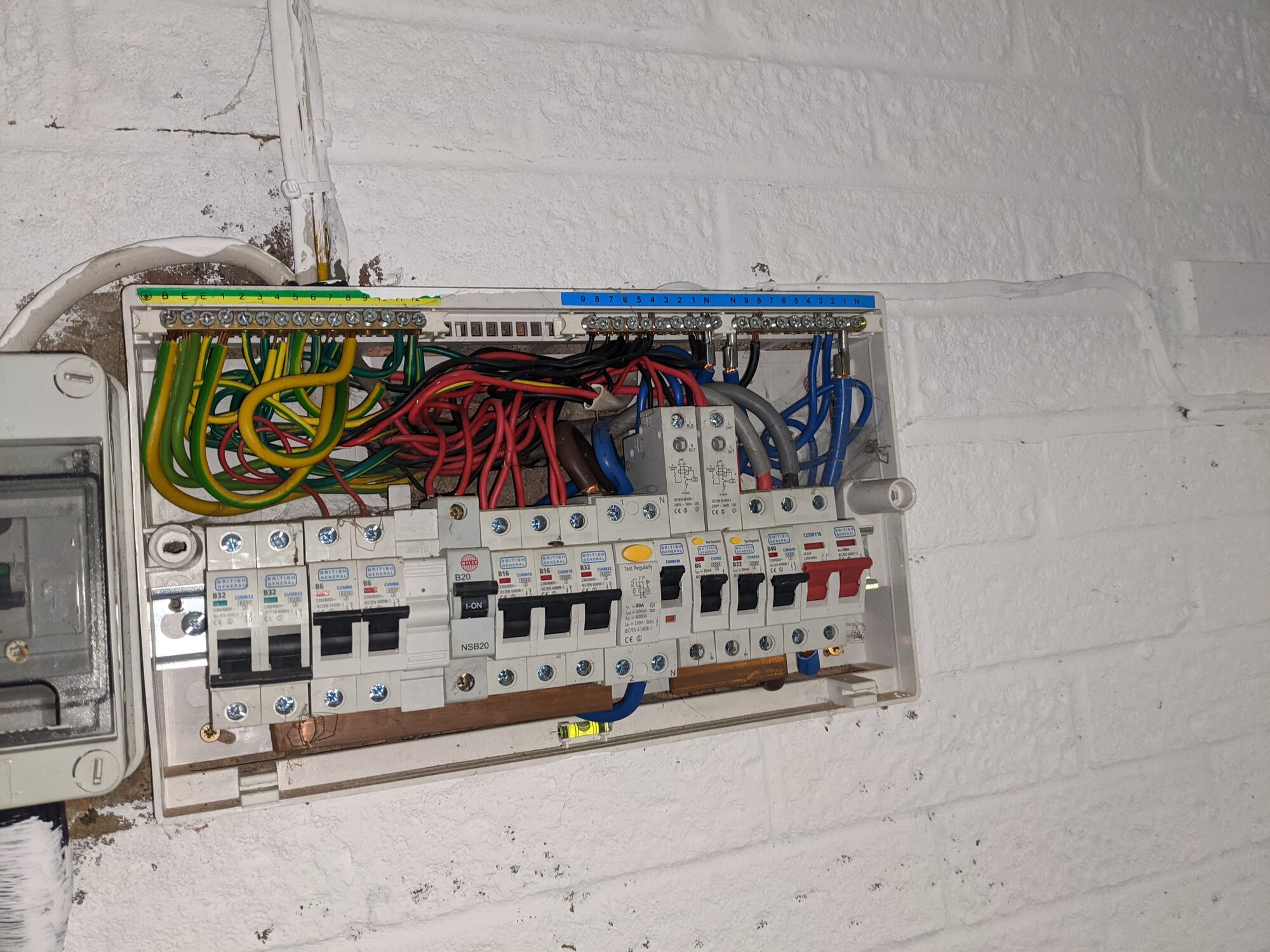

Looking at a potential job recently, discovered what appeared to be a very narrow CU! However opening the cupboard door revealed a full size board!
You can see where the door has been scribed around the CU profile to provide a close fit! Ingenious or what?
Not sure if that belongs in dodgy pics, I am leaning more towards ingenious!!

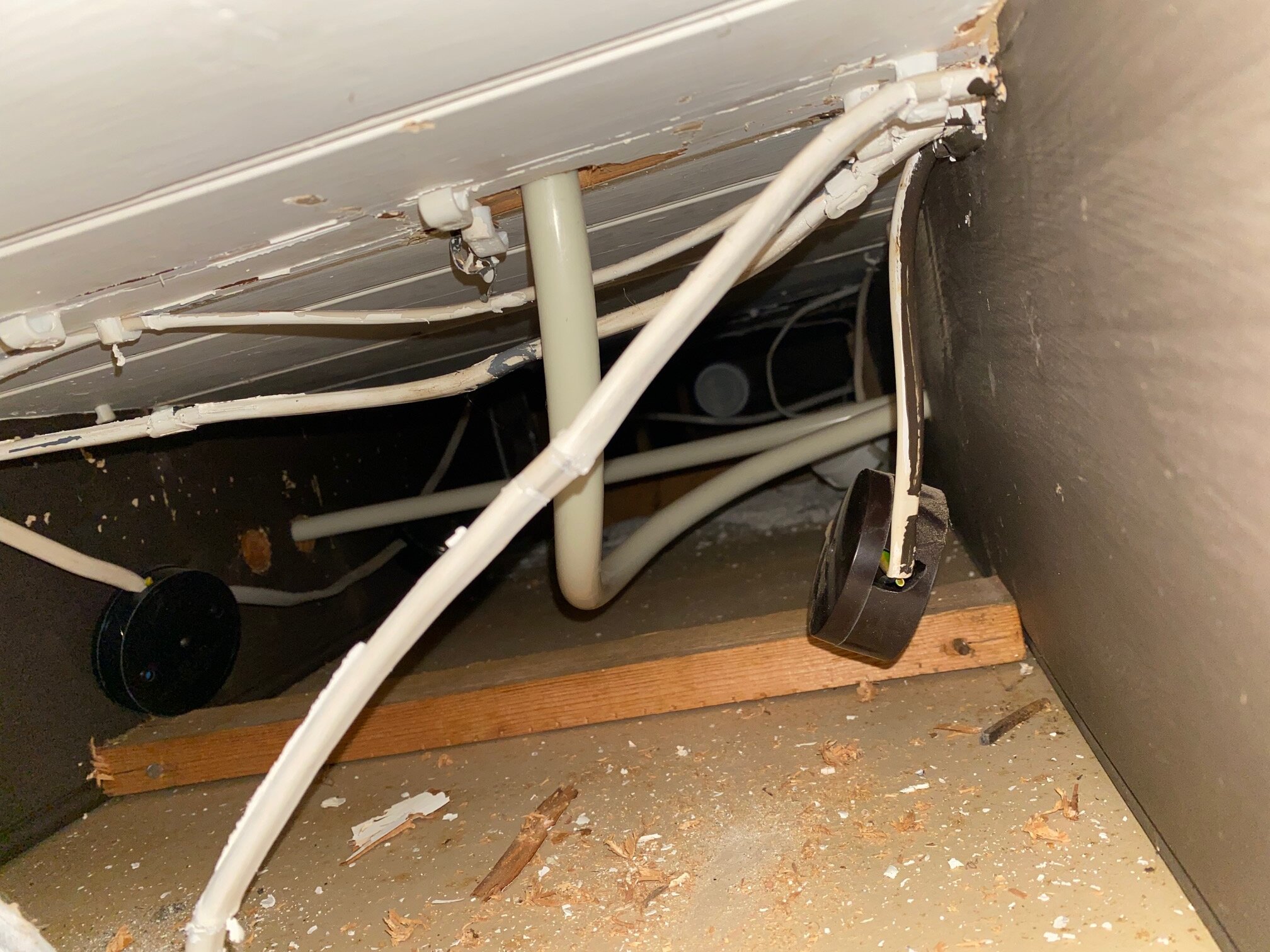

It had 5 Fcu's in the ceiling feeding upstairs sockets, I'm guessing he thought every spur needed a fcu for each socket outlet.
Eicr done 3 months ago.
I had to pull a floorboard to install smokes, guess it's going to take a bit longer :)
The underside of the floorboards look painted…. So exposed at one time? The cables would have been clipped if on show.
It’s just been added to badly over the years?… then ceiling put up and forgotten about.
Yes, you can see the joists are painted black.
Instead of clipping to the joists, he clipped to the floorboards for some reason.
Loads of junction boxes, some for no reason other than the cable was too short.

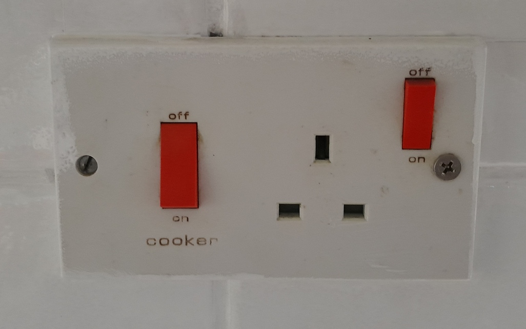

View attachment 118891 Nope, just twisted together! That is a 2.8kW oven and 5.5kW hob, twisted and taped. Can't have had much use, didn't see any signs of overheating.
