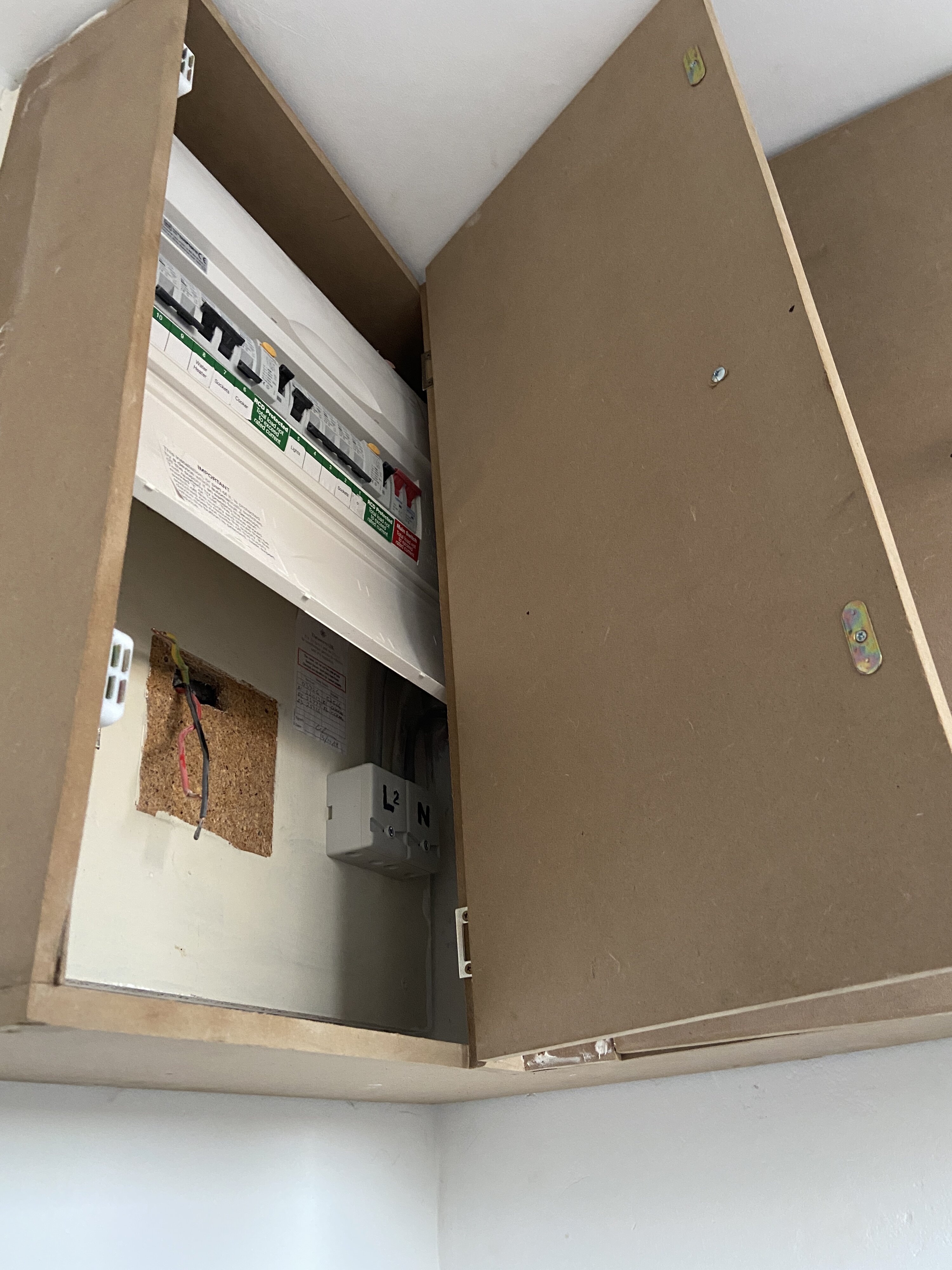

This one is from a handyman. Not a joiner. But someone who can turn his hand to anything….. ok, that hand must have a boxing glove on it looking at this.
Nice custome made cupboard to hide the meter and the consumer unit…..
Unfortunately…. I’m going to have to ask them to remove it….
Cos I can’t get the lid off the box now.

He should use cabinet hangers, so it could then be simply lifted off.

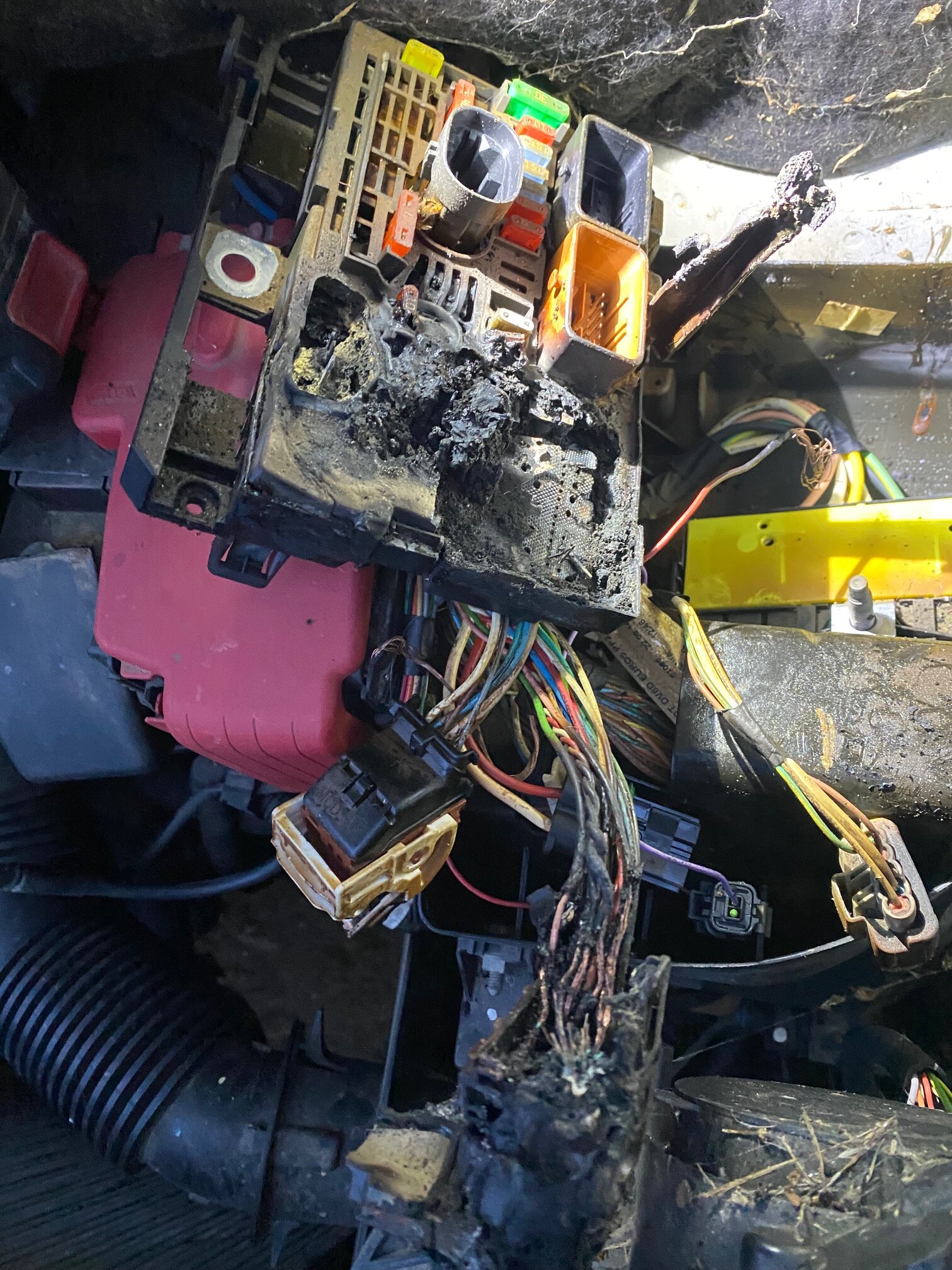

Had a call the other night from a mate whose van was dead after turning it off a few hrs before.
He had tried jump-starting but still no crank/start.
After a 20-mile journey, it took me around 30 seconds to see why.

Ouch.hopefully the garage is still in the season of good will .a good mechanic , relative or mate is worth there weight in gold .

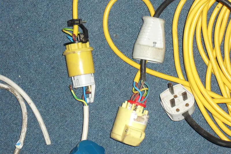

A colleague found this during a PAT on a builders welder back in 2012, the white cable was on the welder
Initially he was just going to change the blue socket (wrong gender) on the welder to a plug and put the blue socket on the black cable, however the white cable
The full extent of it wasn't found until I exercised a screwdriver:
Blue socket wired incorrectly (L= blue, E= brown N & earth not connected) and no cord grip, yellow plug altered to fit into the blue, yellow socket (used as a join) no cord grip, 13A plug not sleeved and what doesn't show in the pics is the black rubber cable was brittle and cracking (perished).
However the yellow cable was almost pristine and repaired as a 110 extension.
Oh and of course the user didn't think there was anything wrong with it other than sometimes tripping breakers, but the boss apparently gave him grief

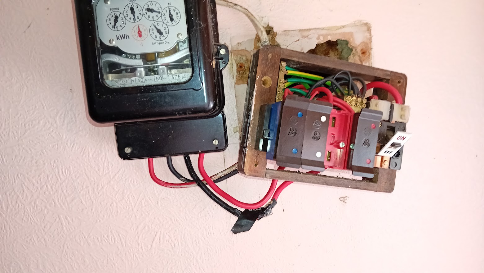

July 2024, rental property:
Tenant has been there since 2018 and Agent arranged EICR, landlord blames tenant, tenant showed me the Estate Agents papers from 2018 where that can just be seen in one of their pics and of course a line saying the electrics needs updating. It's a 10mm² T&E from the cutout.

That piece of electrical tape needs removing because it makes it look untidy.

Good to see the rubber covers still in place over main switch tails.certinaly could cause a nasty shock.

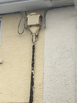

It's a wonder the dno never just used a wet piece of string from cutout.they do as they please wheneverer it pleases them

A colleague of mine on the leccy board put a 13a plug and socket in the middle of his board-issue 110v extension, thereby making it dual-function! he was well impressed with it...

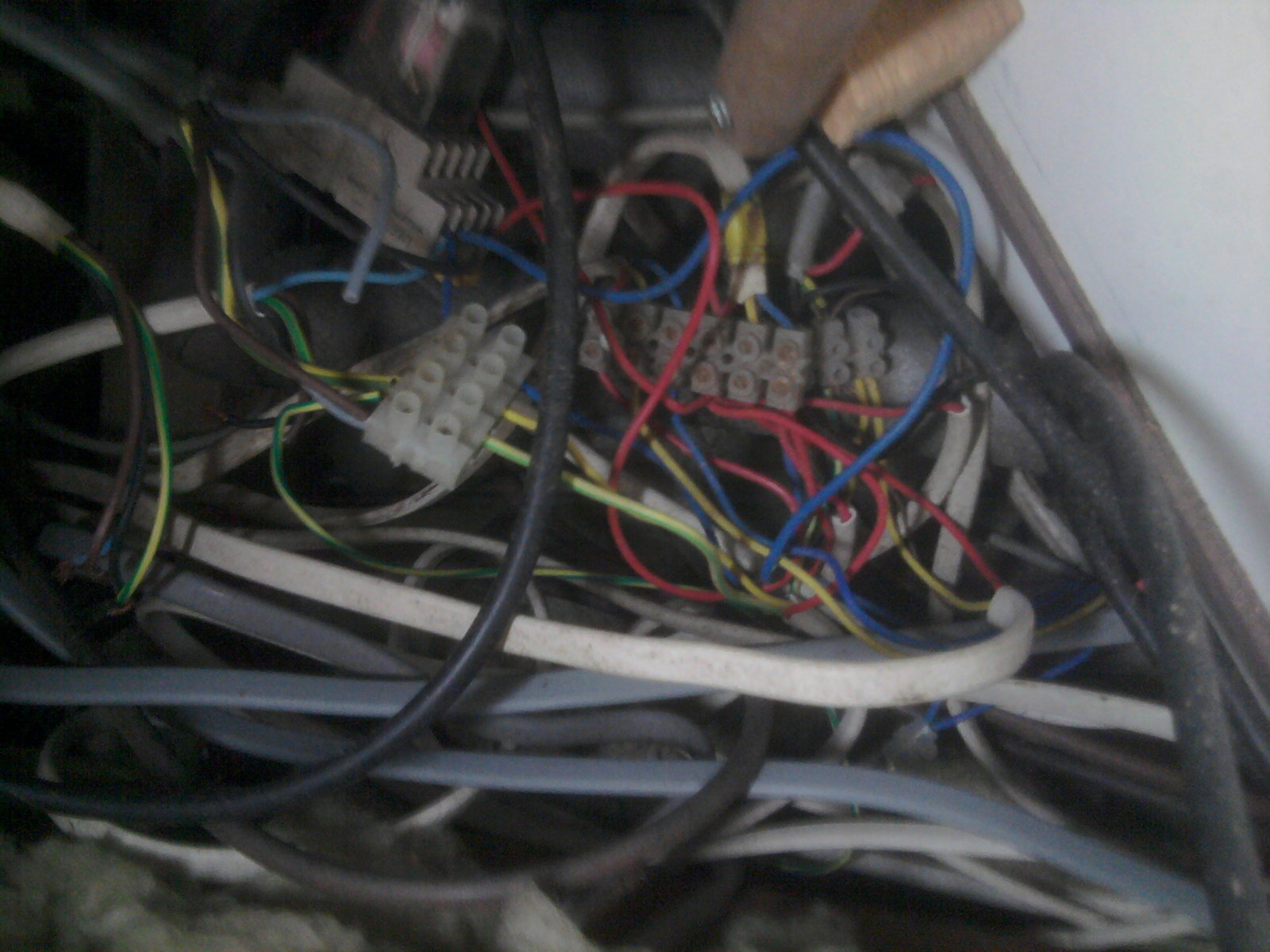

After being called out for a reported electricity failure, the DNO cut this (rental) off citing an illegal connection and demanding a new duct/cable to the street, the service head and meter look to have been moved and probably not by them, so may be a separate issue.
No idea what to make of this - kitchen wiring was probably tripping the RCD but I can't understand quite how you arrive here whether your plan is to steal electric or circumvent the RCD.
Landlord completely ignorant, says it was all in the hands of the agent.
