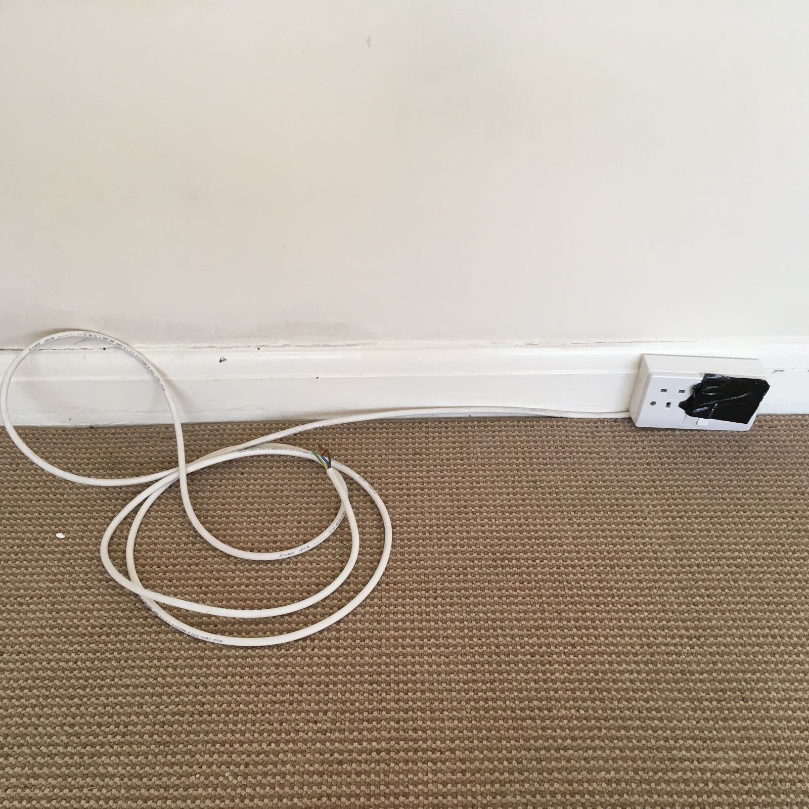

Got asked to reconnect an outbuilding that the previous owners has disconnected from the house. No problem, new swa to the outbuilding and garage C/U fitted but had to laugh when I saw the existing set up. Apparently it was disconnected to get a satisfactory EICR for the house sale rather than fix the many faults.
Yeah water cooler, pulled it forward when pat testing then I noticed the lid was hanging off.

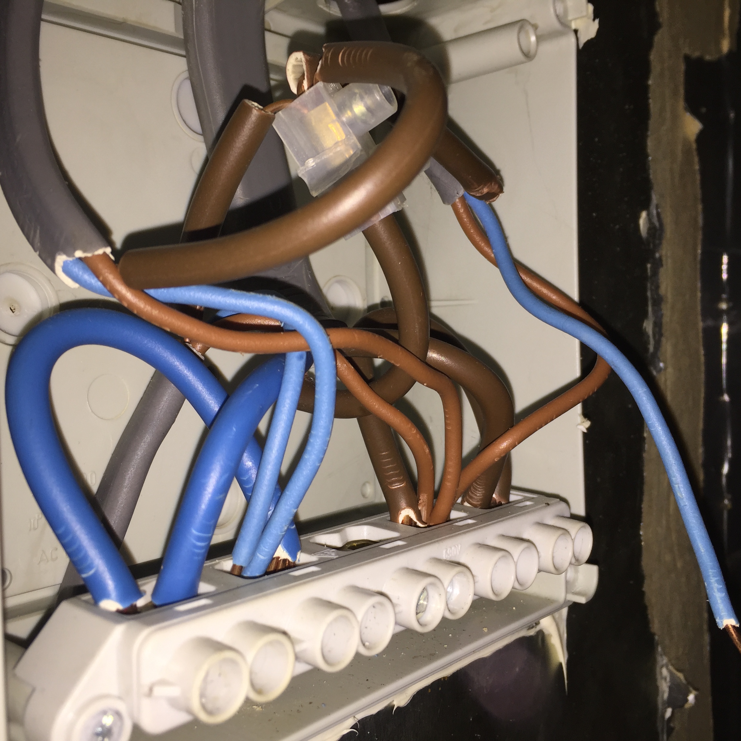

Found this behind an old consumer unit NOT ACCESSIBLE OR VISIBLE:
A freaking henley block! Luckily there was enough slack on the existing meter tails to connect to the new consumer unit without having to replace them.
Awesome. Never seen a MF Henley block before, maybe you should invent one, there's clearly demand for them!
