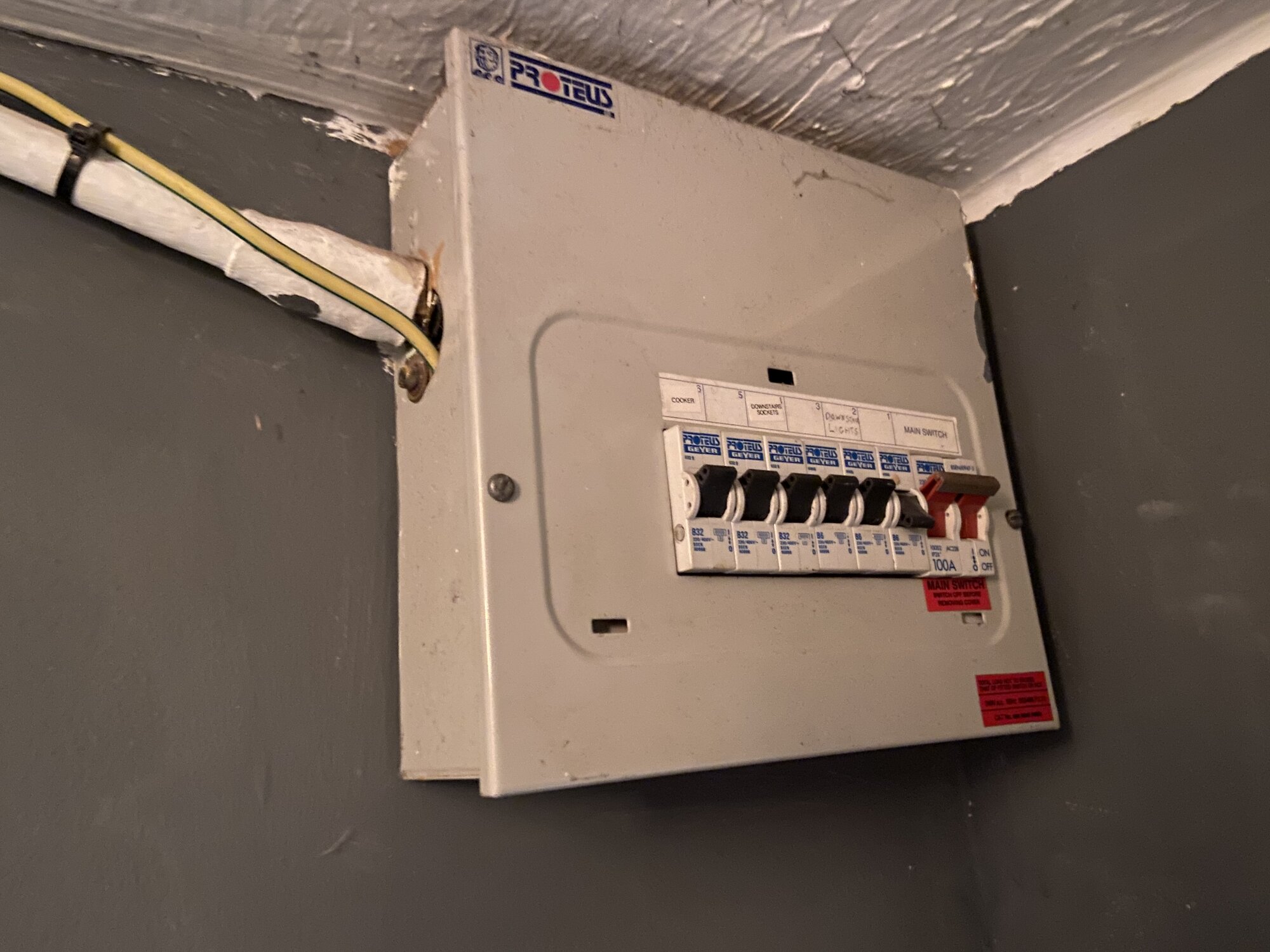

And here we bl**dy go…..
Gone to look at a little commercial kitchen job in the back of a pub….. there’s those alarm bells ringing!
PAT all the second hand equipment the chef has bought in… Tidy up a few bits and pieces….(broken sockets etc) Wire in a gas interlink cutoff when he can get a gas engineer to come.
Not an RCD in the place.
This is the board everything will be coming off for the kitchen.
And these are a couple of issues I saw just walking through the place….
View attachment 97255View attachment 97256
I also saw at least one light switch hanging off the wall behind the bar.
Domestic Aico smoke detectors in lieu of a proper fire alarm system with at least 2 detectors missing and one broken.
Place is a death trap.

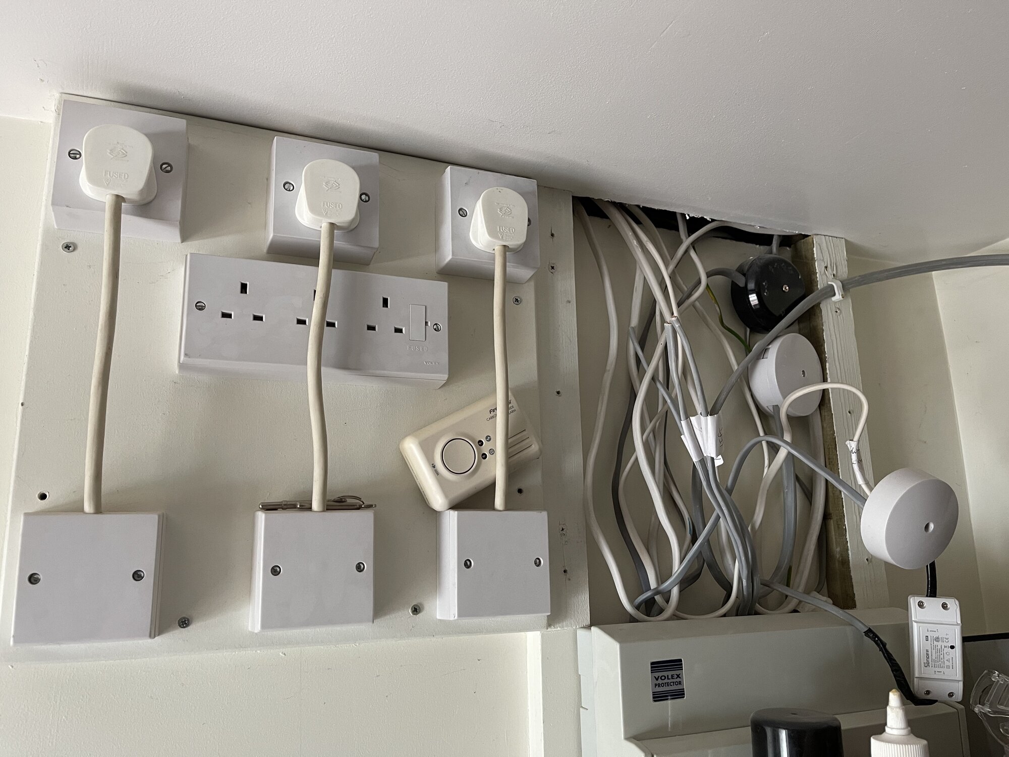

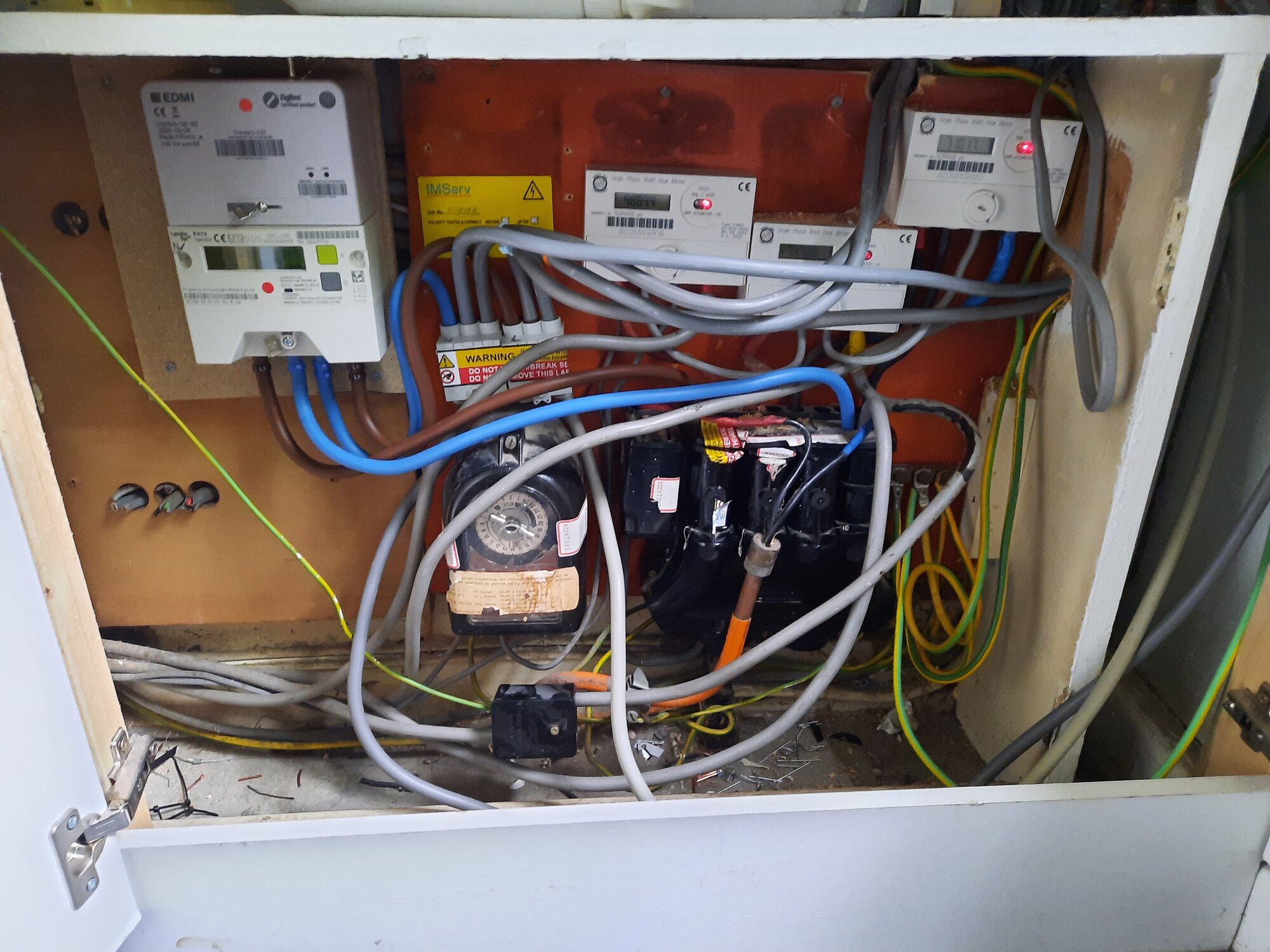

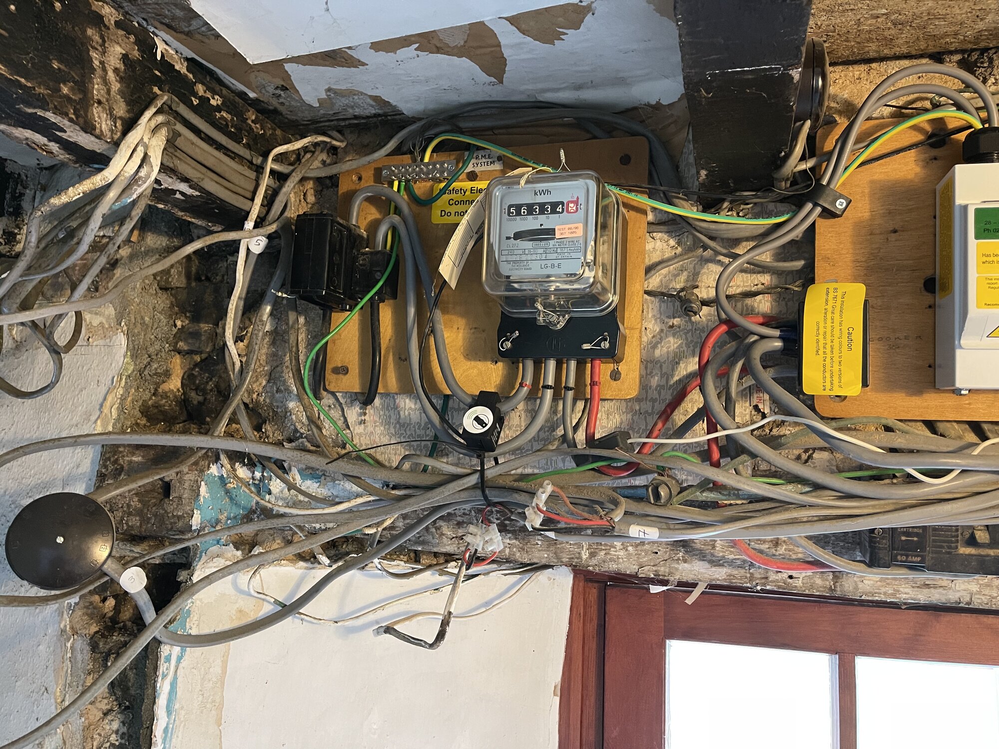

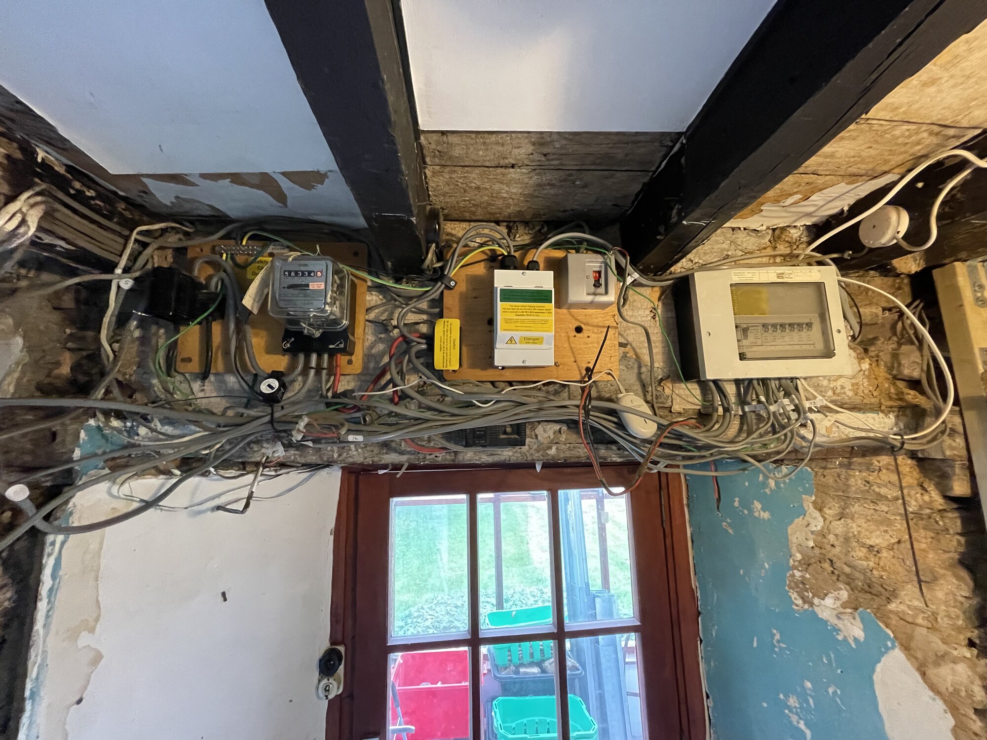

Went to a place today to fix a non-working EV charge point. Then got asked to sort this lot out. Shouldn’t be too hard with such a neat installation… 🤔
What's the story with the 3 13A plugs?
Reactions: nicebutdim
What does the MICC from the cutout feed?
Reactions: SparkySy
^^^^ and where is the earth to the pyro?
To another cutout in another property.
Slightly out of shot via a BS951 clamp.
This has been highlighted before and is part of many issues on site.
1, the load needs distributing across all three phases more evenly.
2, it needs a three phase meter, isolators and tails tidying up.
3, it needs this supply to next door rectifying.
Just had the DNO on site and to quote "nowt wrong with that", my gast was flabbered.
But he quickly backpeddled on closer inspection, and after being given a list of things that "are wrong with that".
Wait and see what they do to put it right?
Reactions: nicebutdim and DPG
