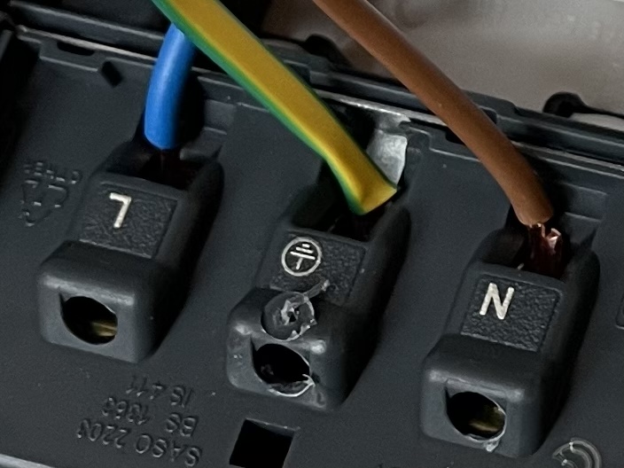

60A type 4 protective device.
2.5 swa cable.
16A socket outlet.
Armour not earthed.
Overcurrent protection not complied with.
Fault protection not complied with.
Below this are two type D 32A devices on ring finals, fault protection not complied with.
Stevie Wonder electrical is back in business! At least he got the CPC right.

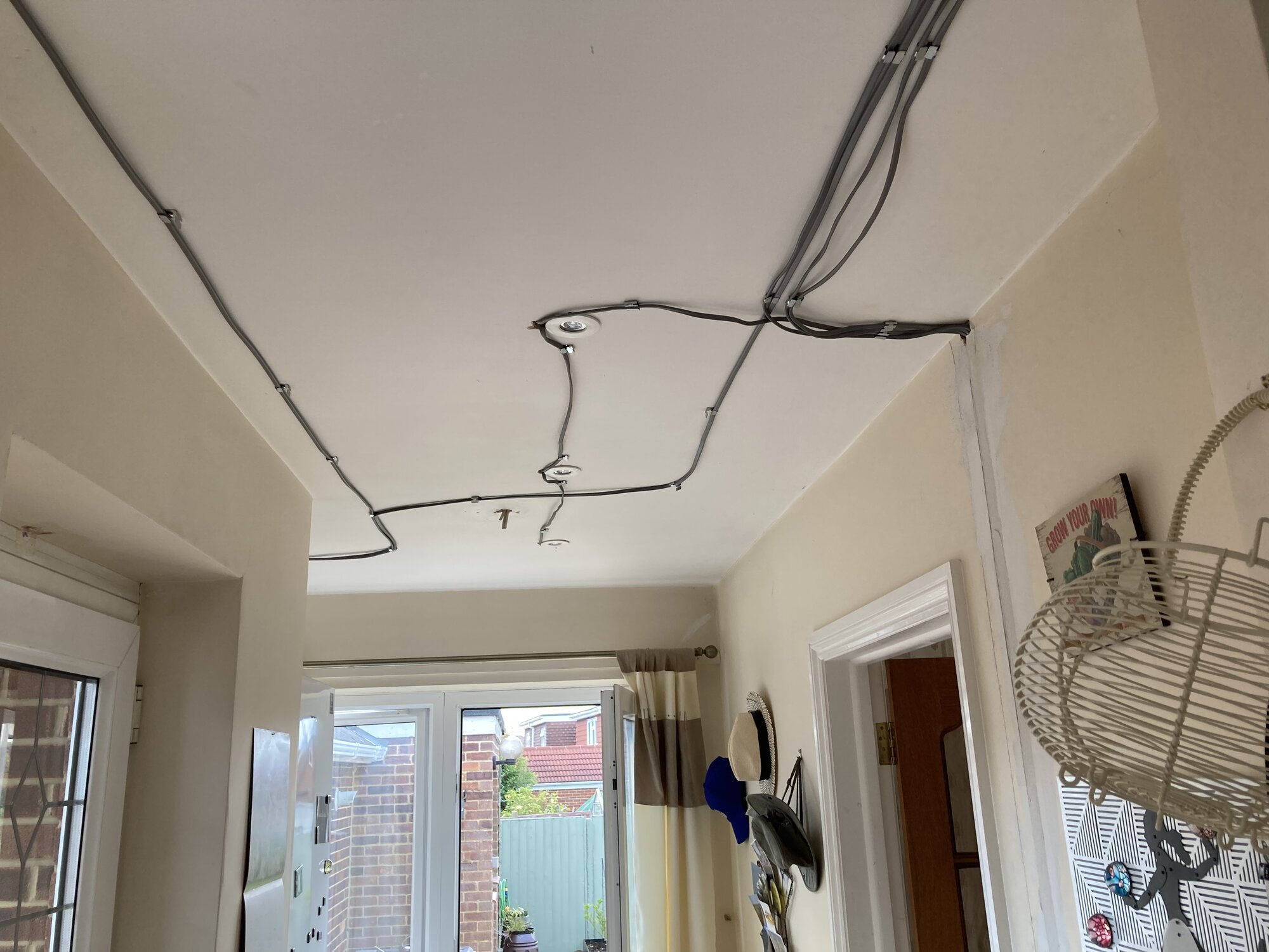

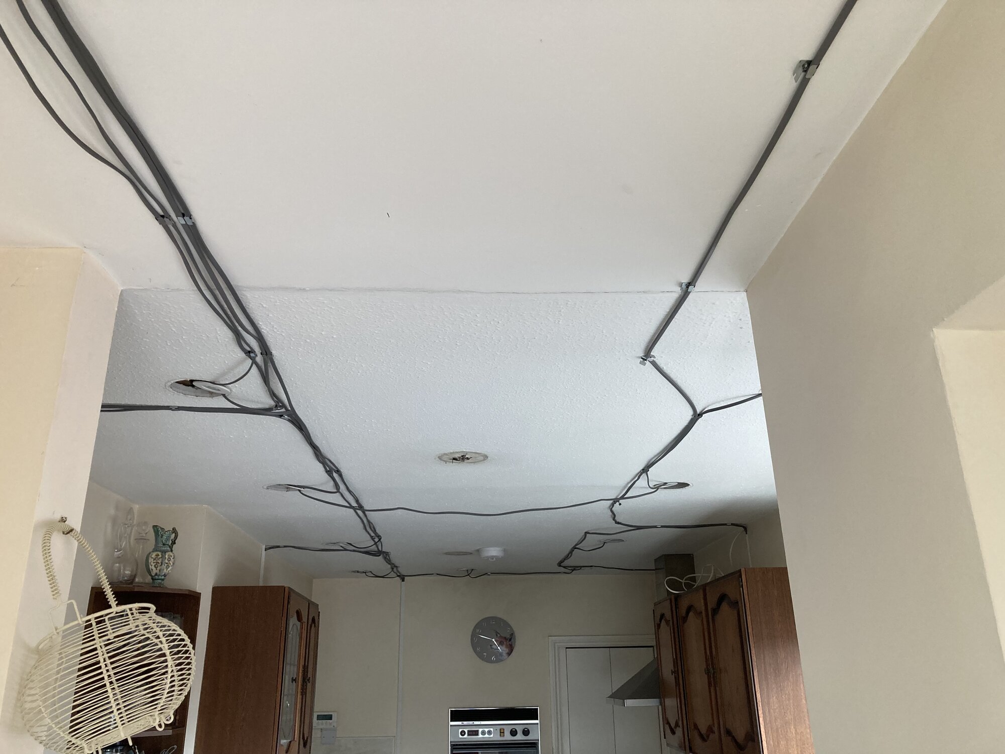

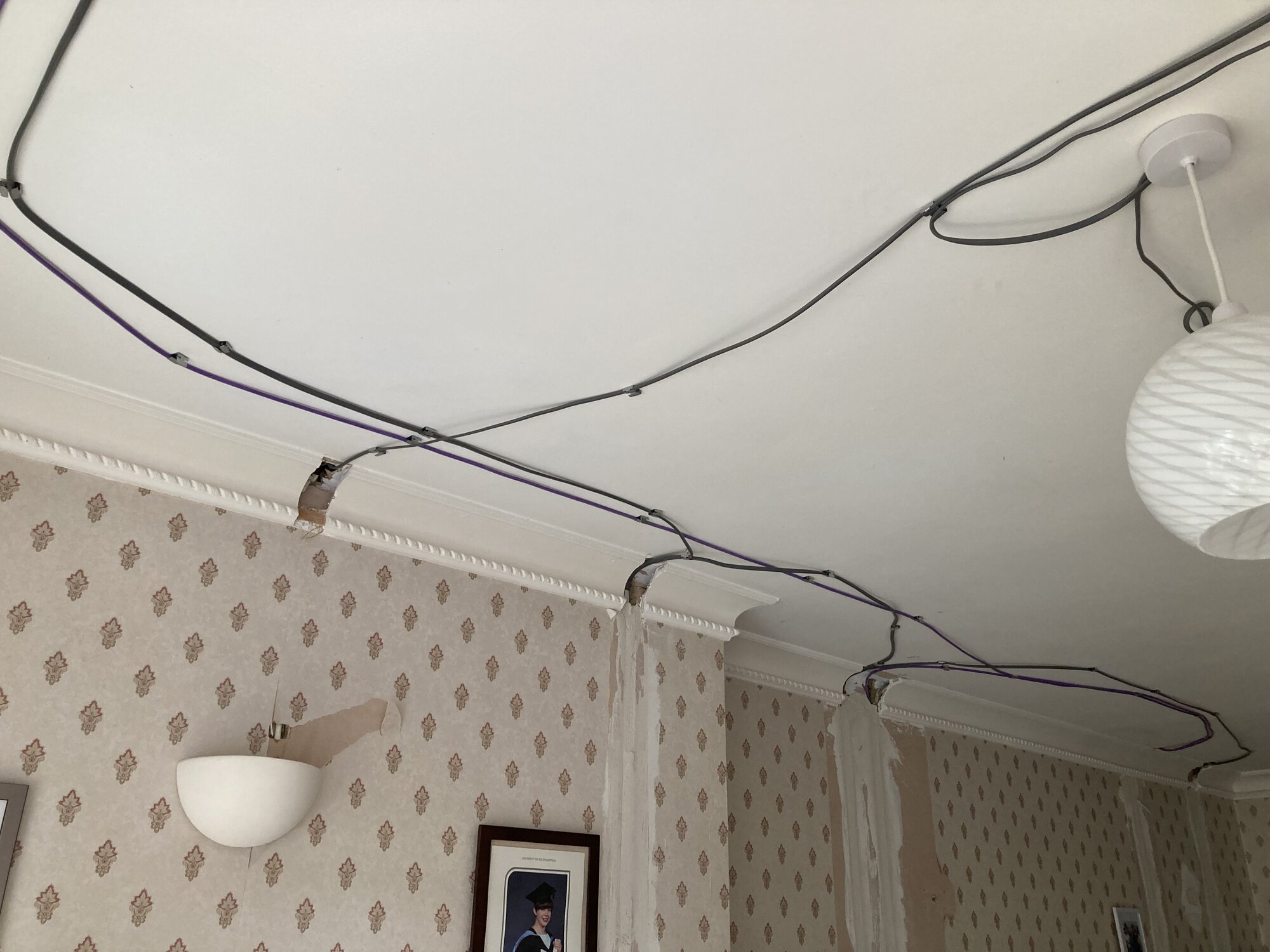

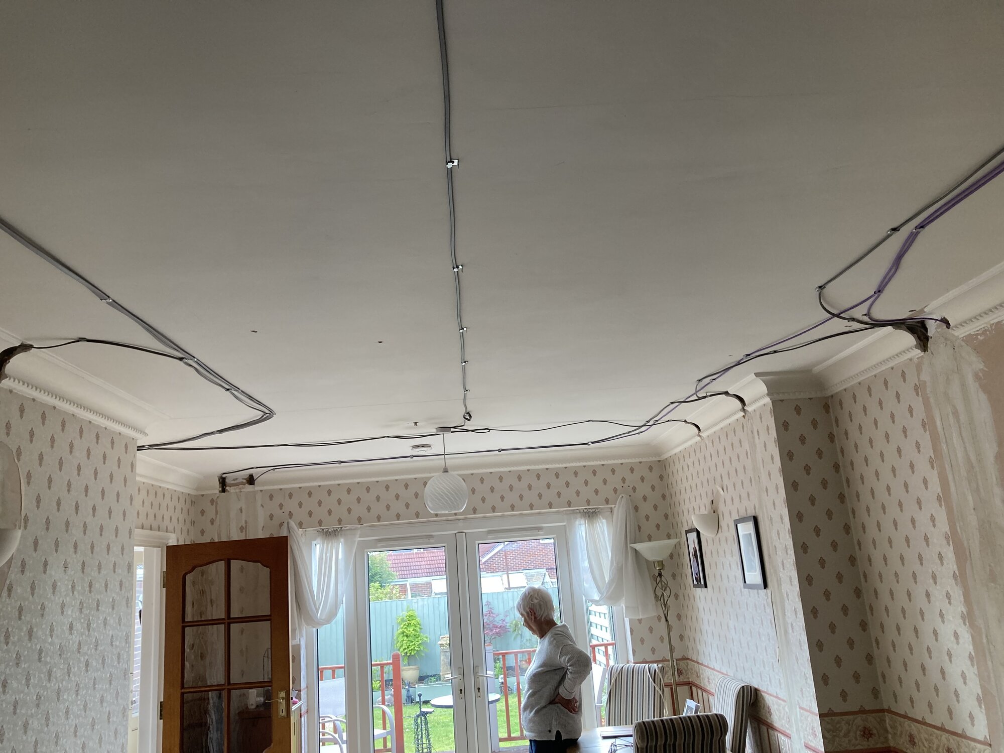

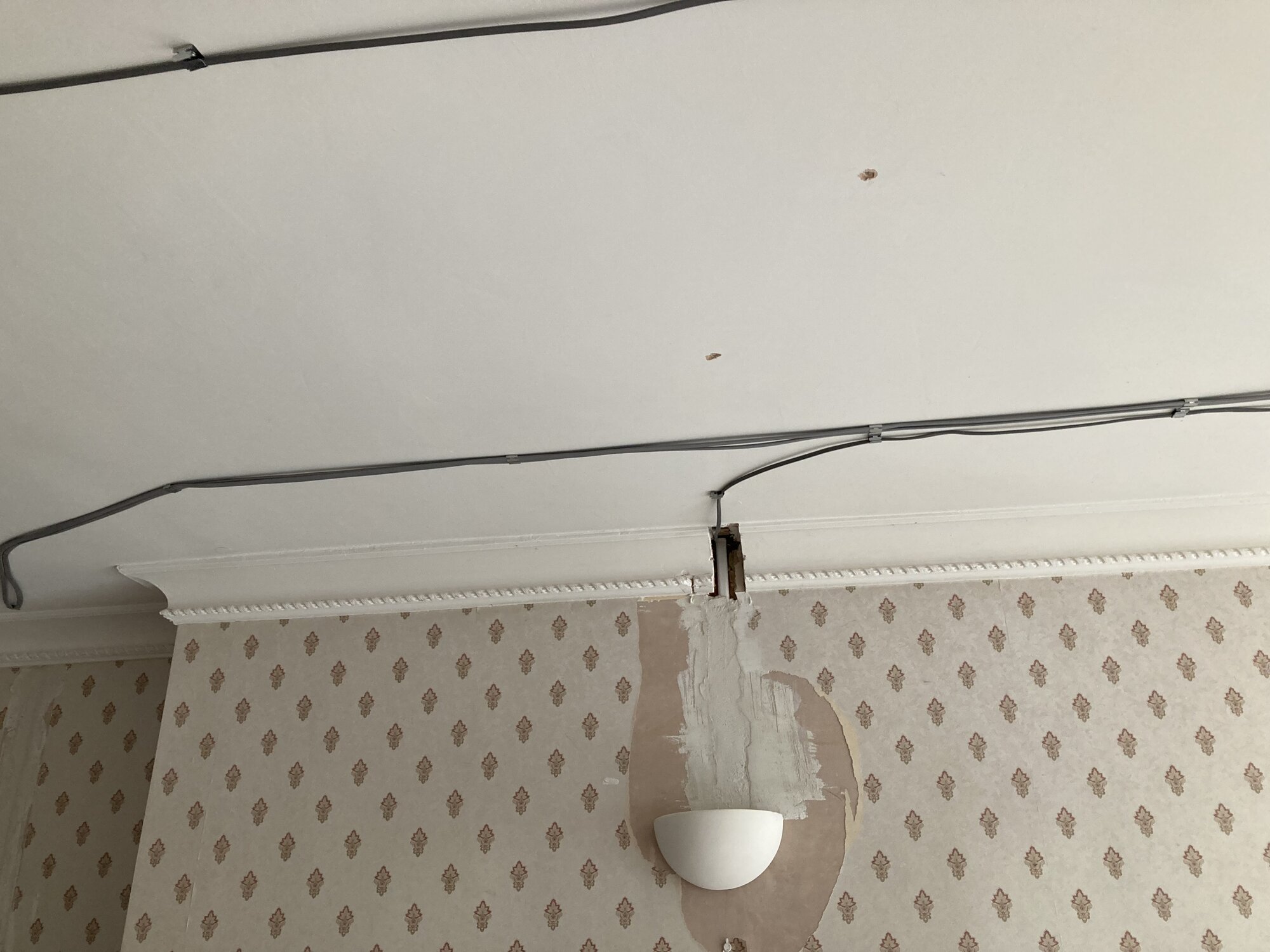

Just been sent these from a friend. Plasterer had been asked to go and make good the ceiling. 😳😳
Seems the ‘electrician’ told the old dear that it was the only way to do it because it was a flat roof. Basically taking advantage of her. 🤬🤬
She’s now left with a hefty bill for a suspended ceiling to be done or get another electrician to rectify.
View attachment 98426View attachment 98427View attachment 98428View attachment 98429View attachment 98430
And that is a special type of wrong!
Used metal clips I see.
