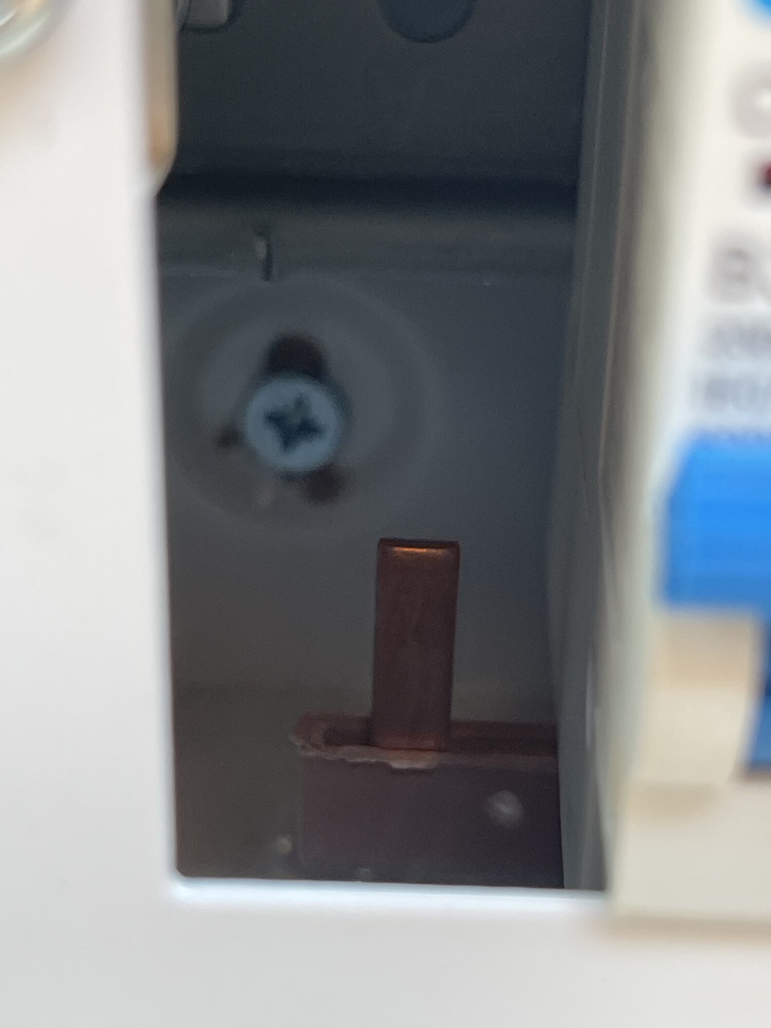

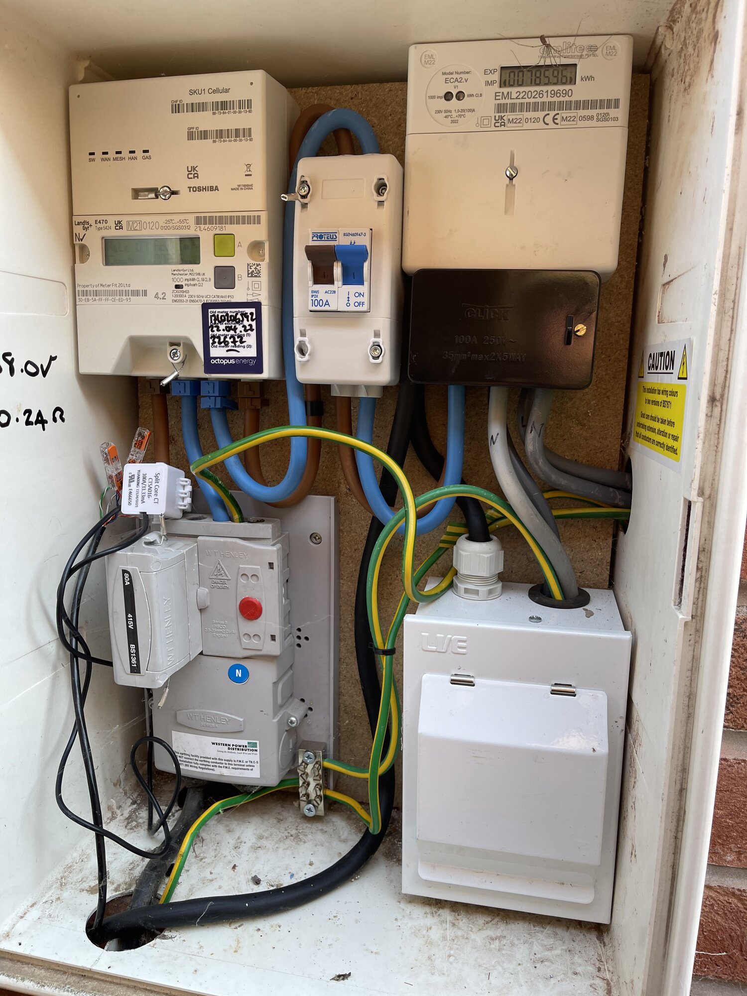

Went to look at a place this morning to do a site visit for a quote as they want a EV Charge Point. They had solar installed about 5 weeks ago. This is how the installers left it. Owner didn’t see the problem. 🙄
I stuck a blank in it as a gesture of good will.
I suspect the Pholcus phalangioides didn't think much of it either. 🕷

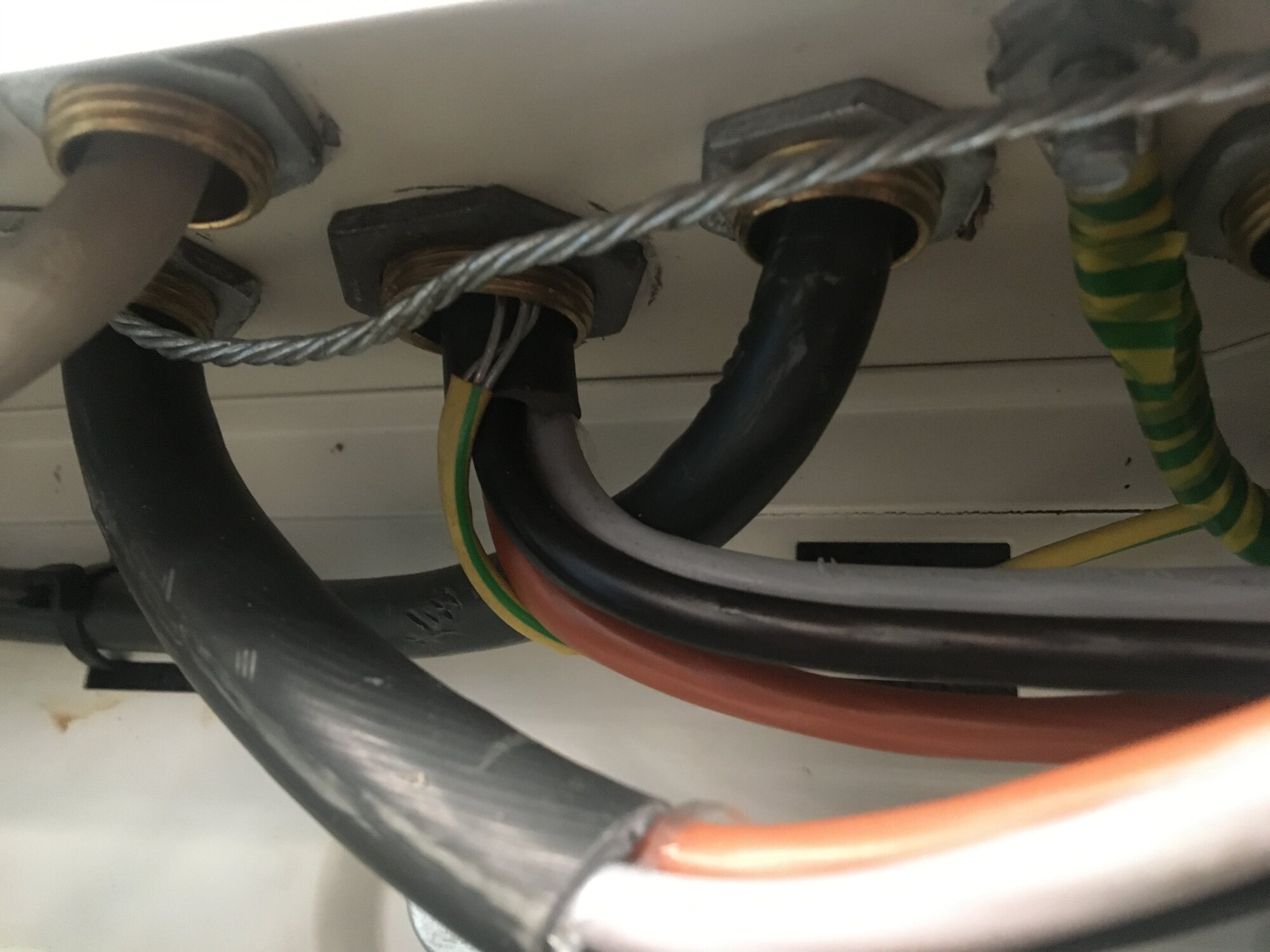

Never seen swa made off and earthed like this before. What are your thoughts? I am thinking poor workmanship and not following manufacturers instructions.
I have seen SWA made off like that quite afew times but normally when its made off into a plastic gland and the sparks winds the armour together like that parking it to earth
I don't like seeing SWA made off like that into a plastic box / plastic gland with the strands earthed like that but like most things its probably a new fangled way of doing things
It must be more difficult to do it like that rather than using the supplied earthing tag under the fixing nut?
Under certain fault conditions, the current flowing through those few strands of steel could be sufficient to heat them to a dangerous level. Not acceptable.
As it happens, I was removing it anyway and replacing with bigger cable that is correctly glanded and bonded
Oh no not following the manufacturers instruction in a CU whatever next. 😱
