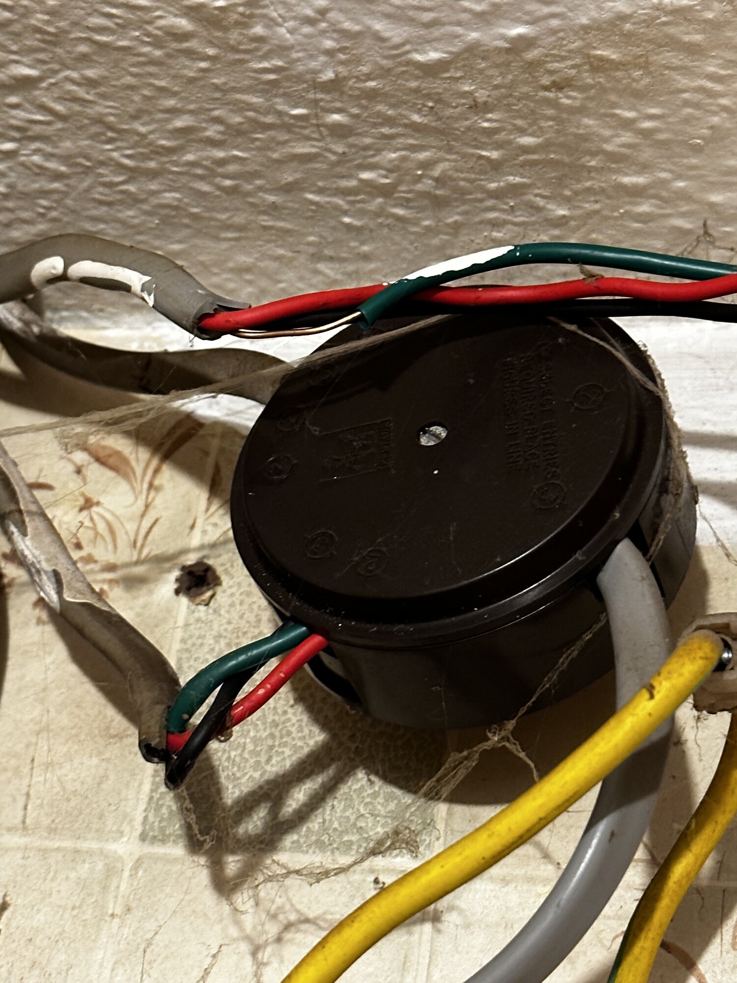

Hmm that's a creative way of fixing a group of lighting tracks. Hopefully the wiring has been installed a bit more professionally.
Oh, well I'm sure the supply connection will be better.
Oh.

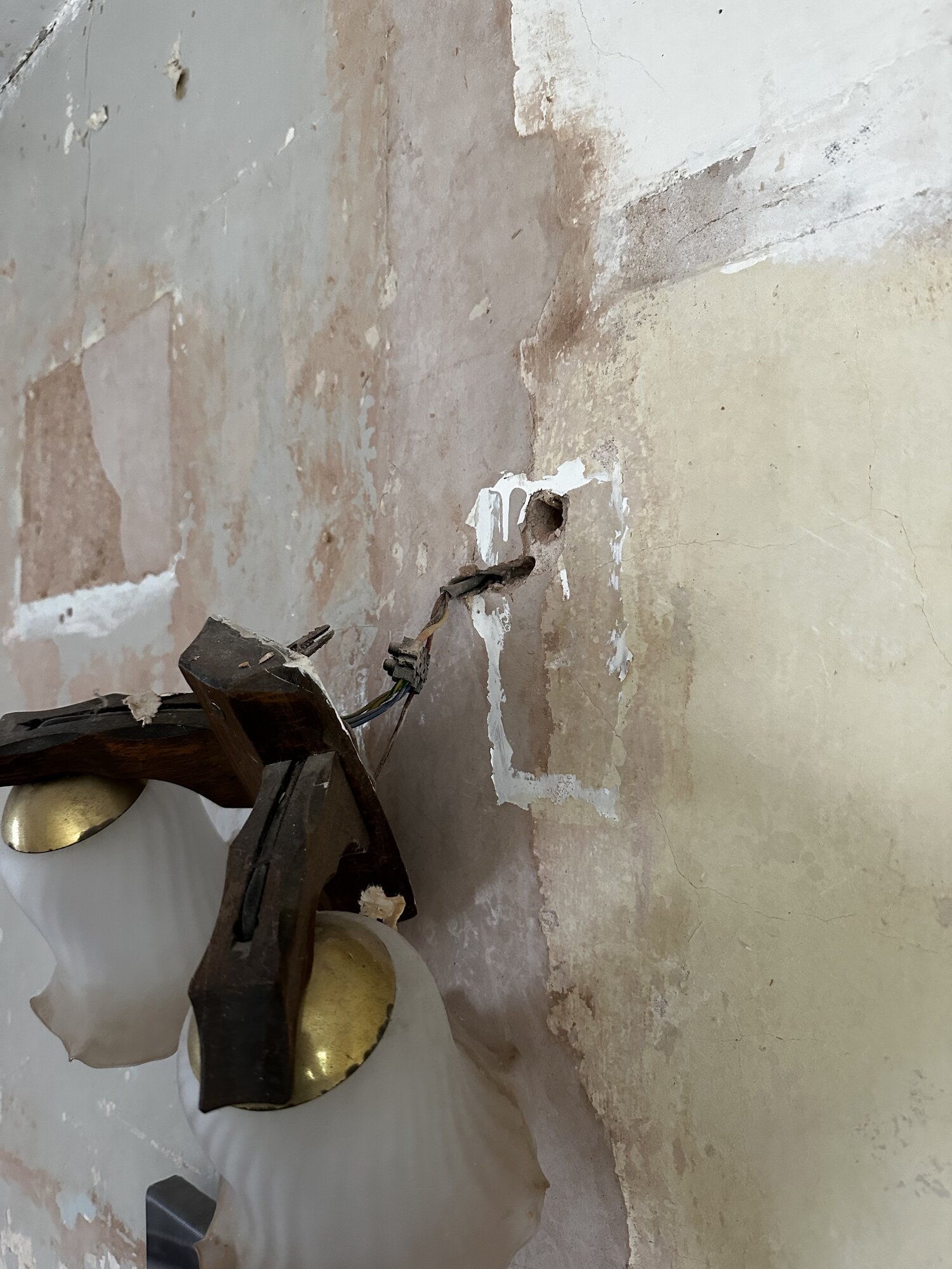

Also from the same place:
At least the switch is off.
Probably been there a while.
I have no words. (Except WTF)

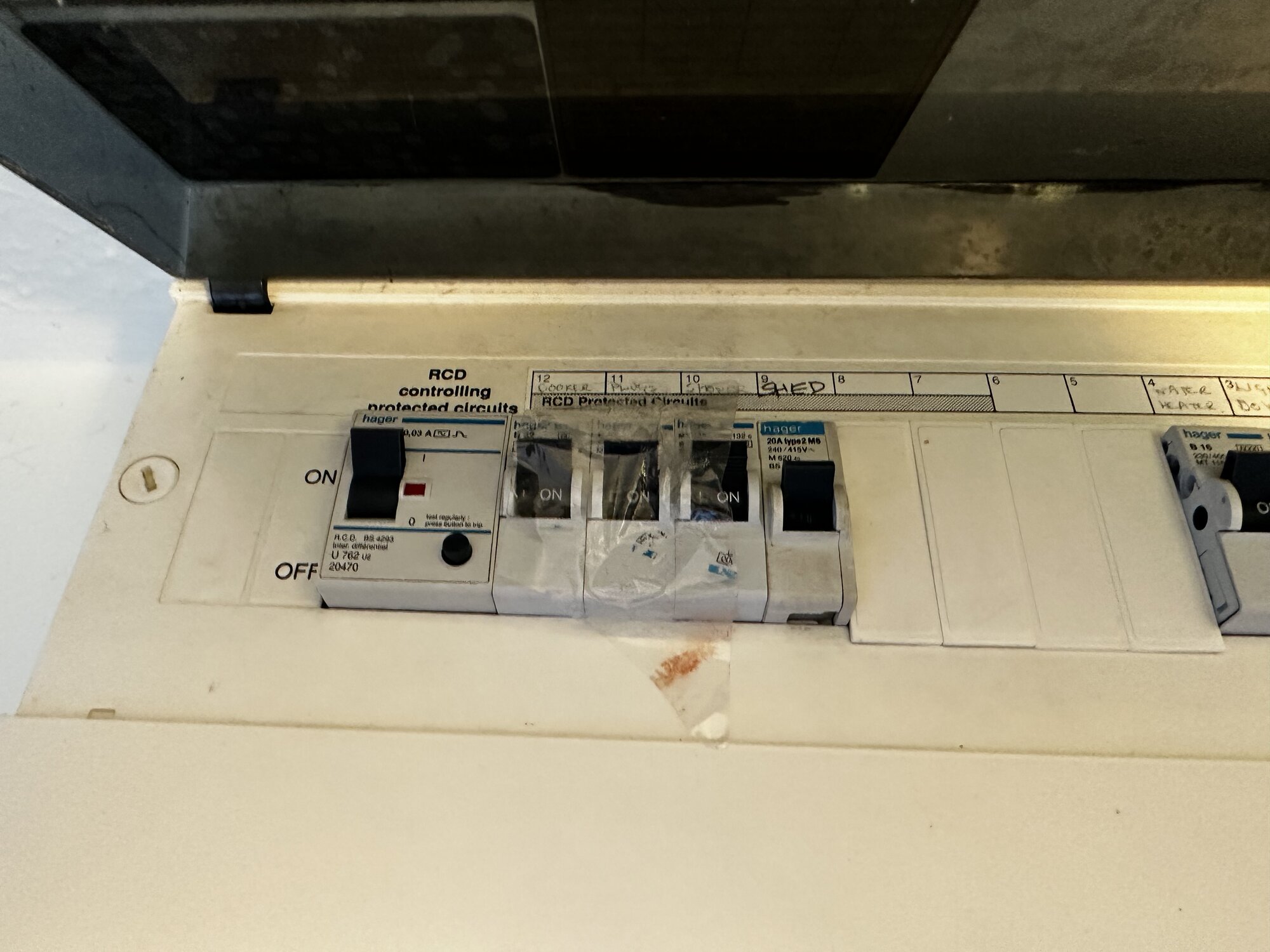

“Hi, wondering if you can help. Just moved into the property and every time we turn on any of the lights the electric trips.”
Hmm. I can’t think why! Can any of you more knowledgeable folk hazard a guess? 🤔🙄🤦🏼‍♂️
I’ve not even started on the rest of the place. Asked if they had a EICR done as part of the sale. Apparently one was done and came back as satisfactory.
So I’ve said they need to send these images to the solicitors and ask for their money back. Then I’ll come and do a proper EICR, which I’ve already pointed out a number of issues which make it unsatisfactory. 😂

I've looked at this for hours and can't think of a reason.
Maybe a faulty Rcd ? 😎

Let’s just use sellotape to keep a circuit on that keeps switching off. 🤦🏼‍♂️😂
Not a dodgy trade. But more a Cupid stunt in the property.
That is absolutely terrible, everyone knows you should use Gaffa tape as it's much more sticky.
One strange thing though is the Shed mcb looks to be the most stressed, and it's been left out, also wonder why all three ?
It was only the middle one (sockets) which was faulty and it was a faulty MCB.
Tested the circuit and it’s all fine. I can only assume the tape was over all three due to its size. 🤷🏼
I wouldn’t mind but I went for non working underfloor heating. Which was also due to a duff fused spur.
Reactions: Jim_e_Jib
What about the shed one that looks like it's been cooked ?

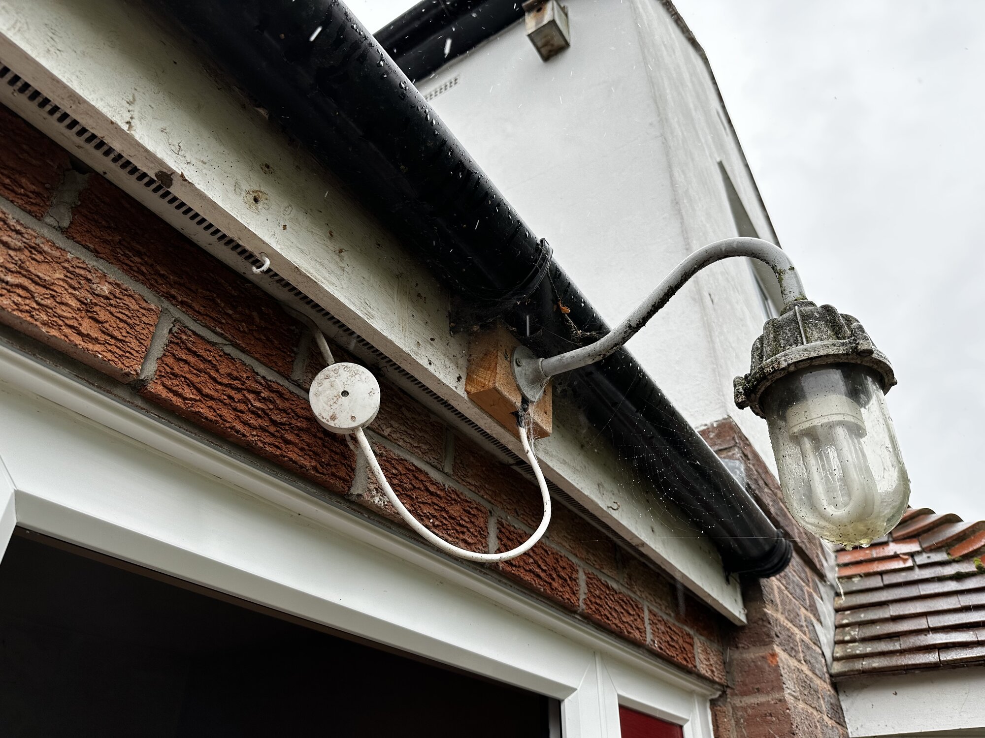

Earlier today customer says can you look at an outside light that hasn't worked for some time, problem being it's quite high up near the apex on a 2-storey house, No problem I say whilst grinding my teeth as it's also peeing down, get up there thinking It's probably just a bulb, change bulb ask them to try it, reply is ohh I don't know where the switch is.
Come down cant find switch, end up in attic. Turns out it's never been wired. 😩
It’s not. It’s just dirty. I thought it had too when I first looked at it. But there’s only a light and unused socket in the shed.
I replaced the faulty MCB and had a look at the others. Rest are fine.
Reactions: mainline
From the pic, it looks like it has a piece missing out of the bottom.
Indeed it does. Never noticed that earlier 🤓. I’m going back tomorrow as didn’t have a fused spur on the van. So will replace it and then get myself an eye test. 🤦🏼‍♂️
