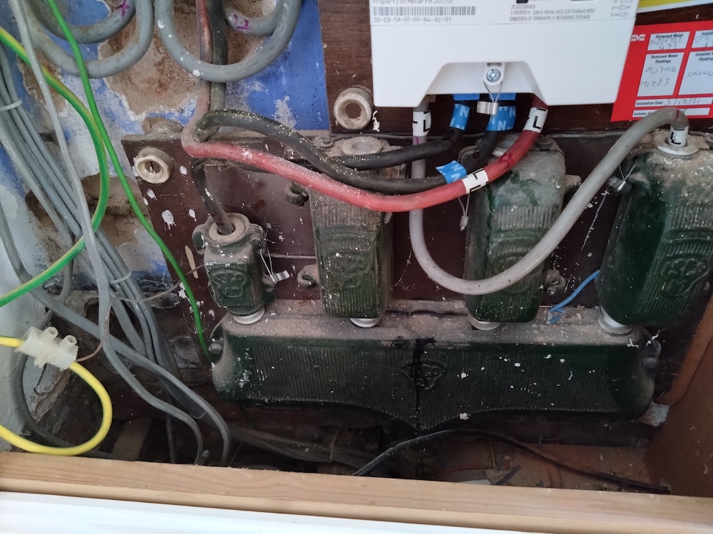

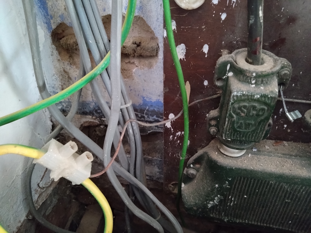

some interesting collection of wire types and not quite perfect terminations.
Reactions: DPG
As above, if it was buzzzzzzzing, i would Wasp the F out of there.
The house is full of weird and wonderful wiring. It was functional with a working RCD upfront but that was probably to do with nothing being earthed.

Slightly optimistic earthing. 16mm from each of the two DBs, to a single strand of something that would definitely have been measured in fractions of an inch when it was installed many decades ago (and not for the purpose of earthing the installation!)
