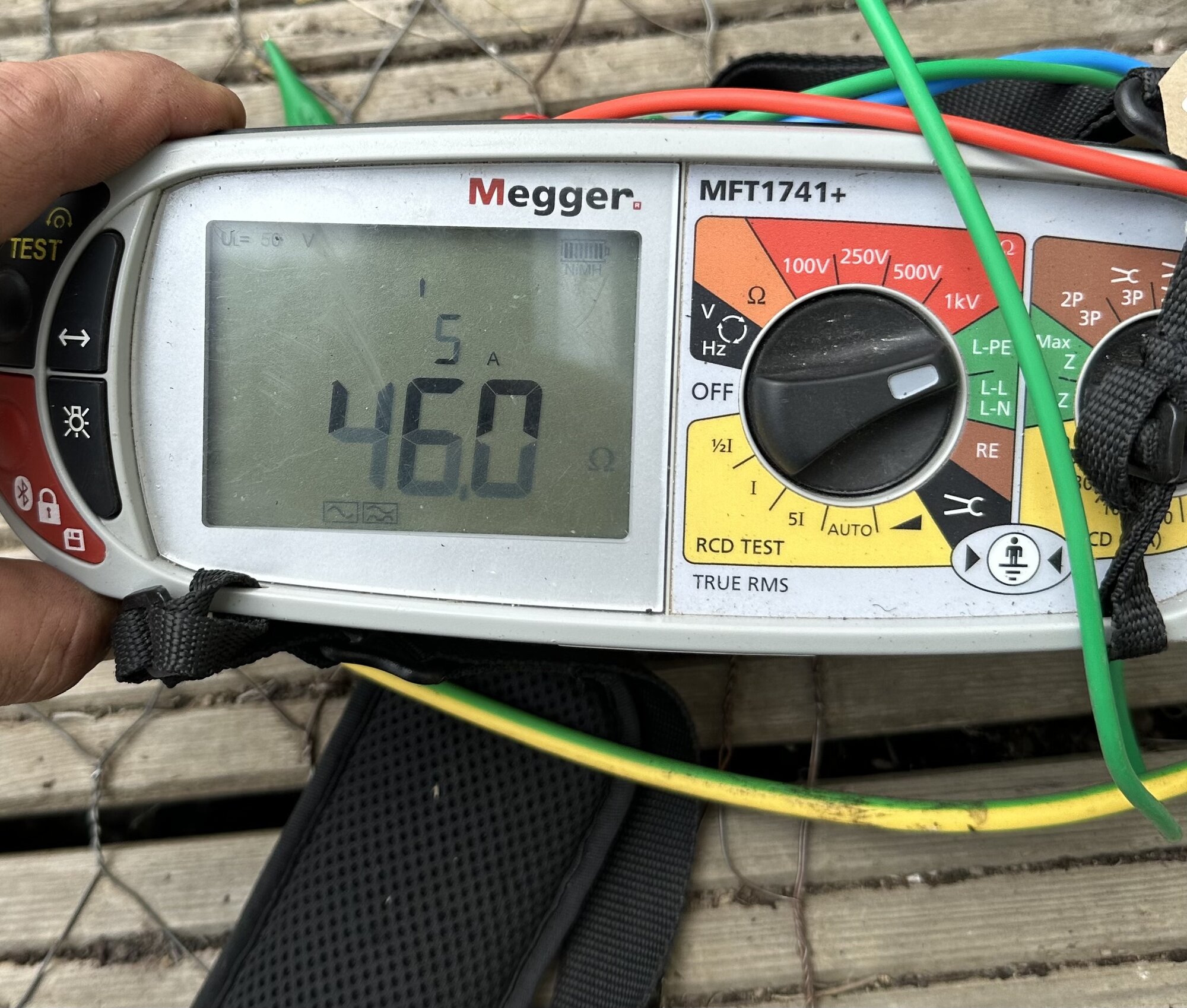

Done some investigating this morning to ascertain why the earth reading is so high on the TT system I went to on Friday.
I’m hazarding a guess that this might be why.
That’s the water pipe to the property and they have done that because they couldn’t (or couldn’t be arsed to try to) get a rod in. Will find out shortly if I can or not.
It must go plastic shortly towards the supply side (or at least non-condictive joint(s) somewhere otherwise it ought to be better. Re-label as pipe bond?
Still, see what a proper rod does, but I guess recent rain so not quite a fair comparison? Other than actually being done right, of course....
So on further investigation. There is approx 2m of copper pipe, then there is alkathene back to the main pipe where the water meter is (house was only finished in Nov last year).
Anyway, after banging in 2 x 2.4m rods I’ve got the reading down to this.
And the Zappi works again.

Sorry if I'm missing something here, but you do know the supply is TNCS there ?
It isn’t. I confirmed with the DNO. There’s no earth connected to the cutout.
In order left to right on the earth terminal are: rod, main cu, PV CU, EV CU.
This is what the cutout would look like if it were PME/TN-C-S
As you can see from the label it says not to connect the earth unless all the requirements are met. This property is in the middle of nowhere and I’m guessing they couldn’t get the Ze low enough to have PME.
Do you know what the PSCC was? That sticker normally means PME is fine, but warns you not to just reconnect any old main earth to it without checking it meet the requirement to support the bonds (e.g. 10mm +)
I'm going to make a wild guess here, I think it was an early EV install and whoever did it decided to TT the whole place to make life easier.
Reactions: Dave OCD
Have you read the notice on the service head.
Yes, now have a read of the other pic I posted.
I can categorically 100% confirm it is not PME/TN-C-S
