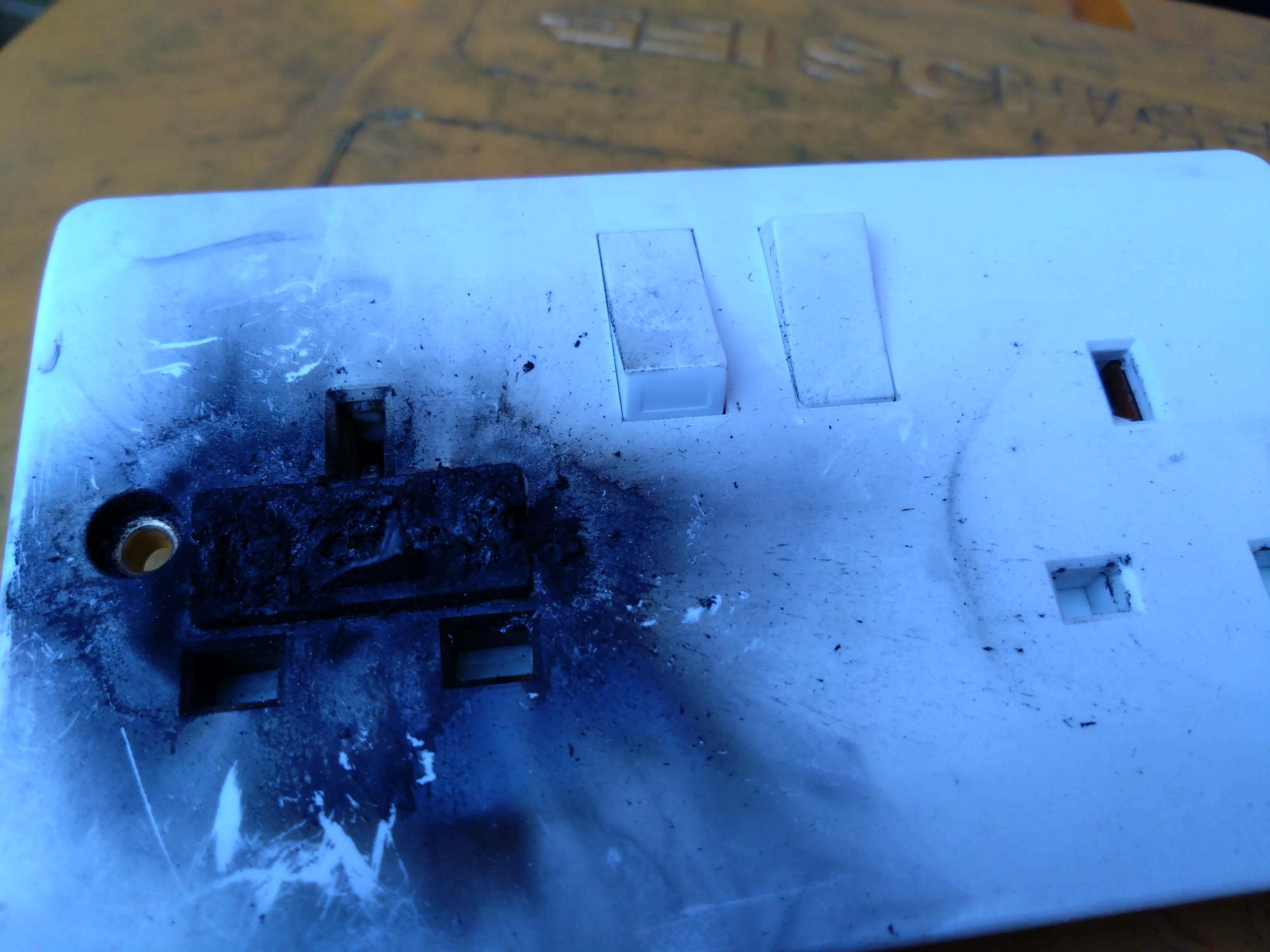

  • "If I put a new plug on, do you think the washing machine will be alright?"
  • "Put it this way: I wouldn't."
Zs @ socket 0.41Ω (so Ipf ~560A). Tripped the B32 MCB when it went, but not the upstream BS4293 RCD.
Stank.
I bet the wash machine is fine, looks like an overheating fuse / plug.
Well, I guess technically you're right... the fuse did overheat... things do tend to get hot when they... EXPLODE!!!
This was a very sudden failure (loud enough that the client heard it go from upstairs). I have seen first hand the result of an overheating fuse in a moulded plug... this ain't it :)
Is that a track or crack across the other outlet?
Good spot, but no... that's just a mucky spider's web
I suspect that the "explosion" was merely the finale of a process that started with an overheating fuse. I hypothesise :
Fuse gets too warm for "whatever reason". As a result of that, contact degrades, increasing resistance, increasing heat generation. At some point, things start to degrade and surfaces of the plug & socket get coated in breakdown products.
Eventually, the coating triggers flashover - at which point a current limited only by the supply loop impedance drives a plasma arc until the OCD trips and cuts off the power.
The power dissipated in the arc will be substantial. Quick estimate suggests a few tens of kW - that's going to make a big bang.

Bet you a beer that if you put a new plug on it and pat test it, all will be fine.
