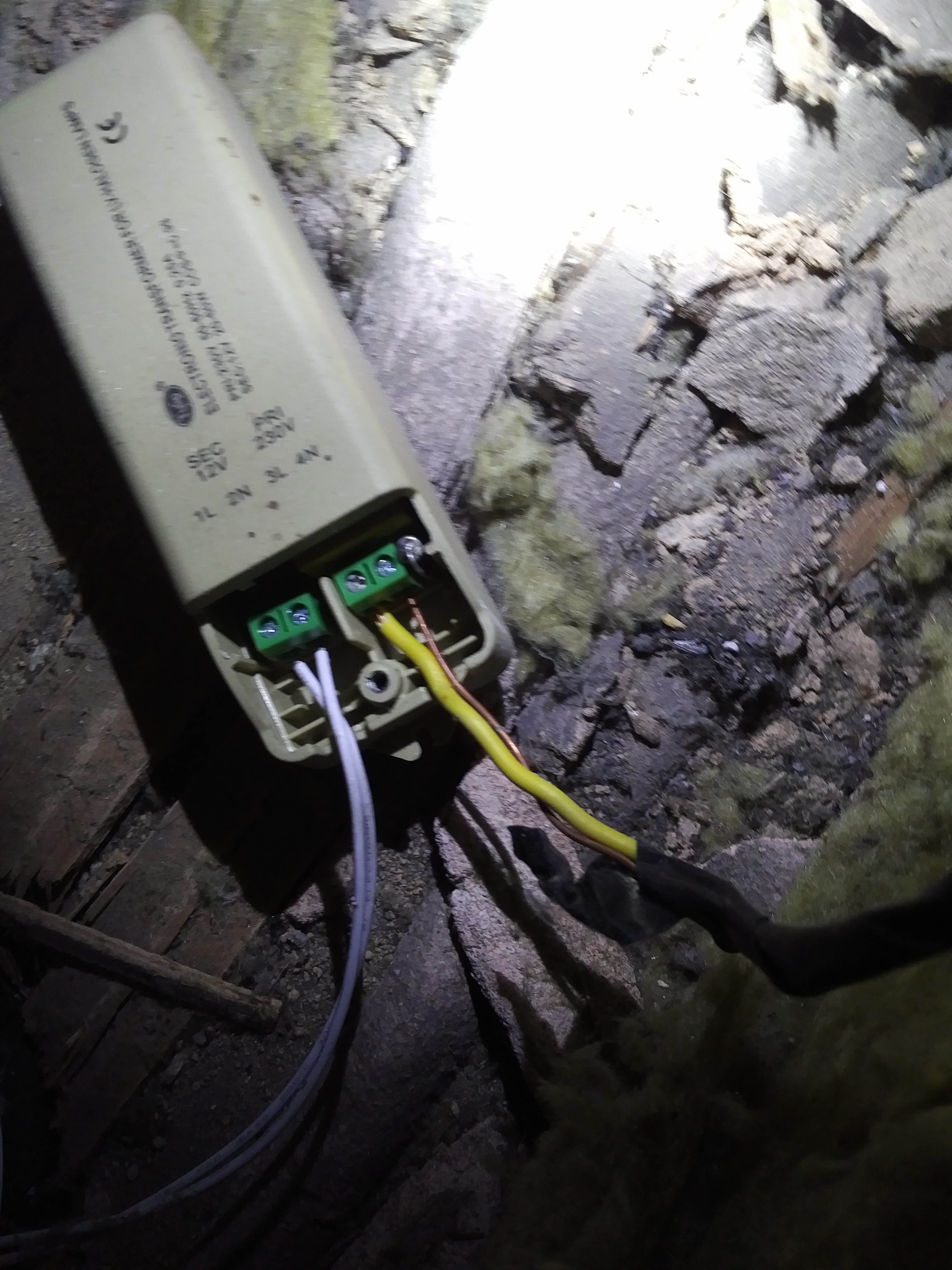

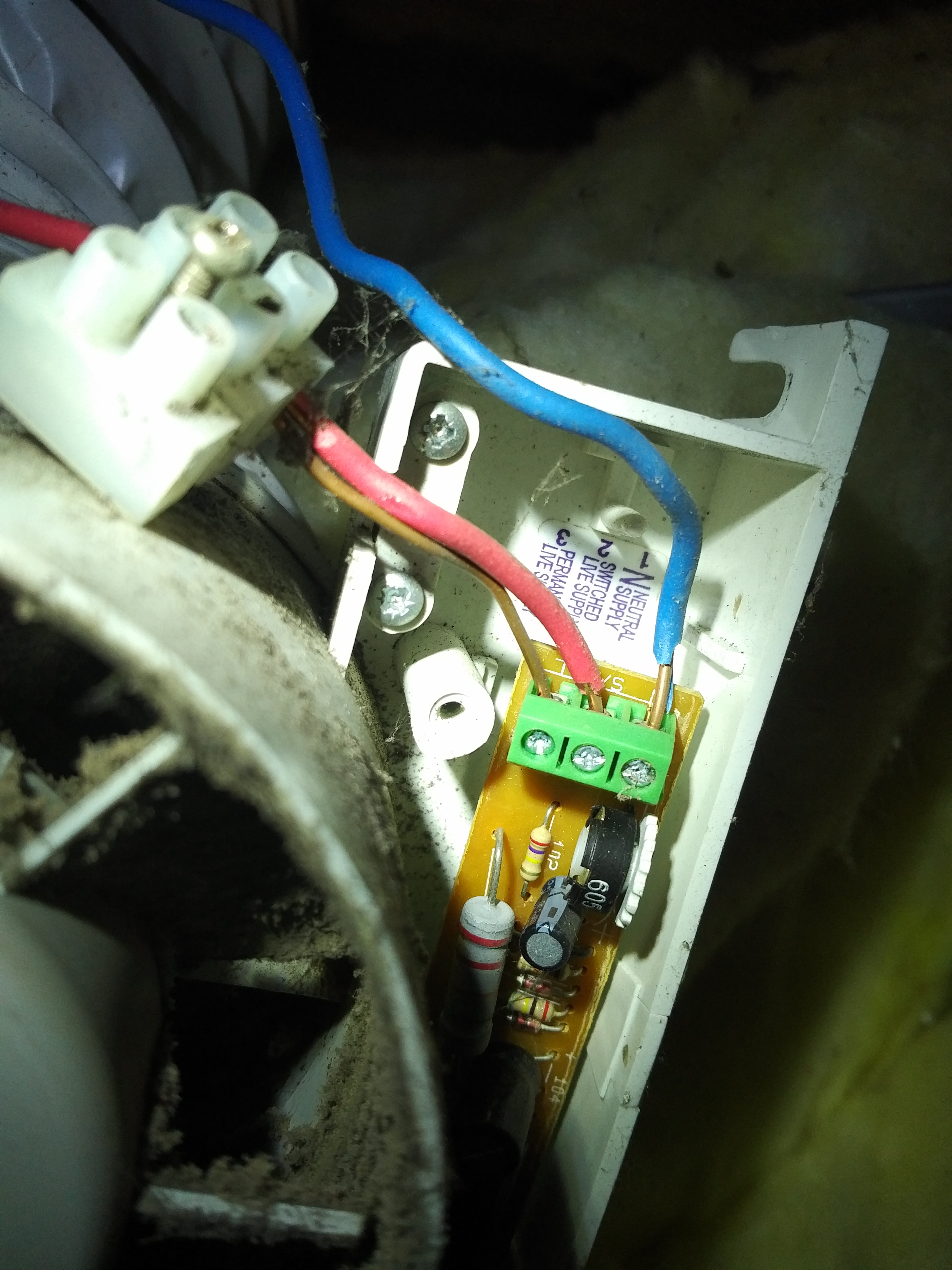

And the slightly more creative lazy sh1tes hide it under the insulation. :rolleyes:

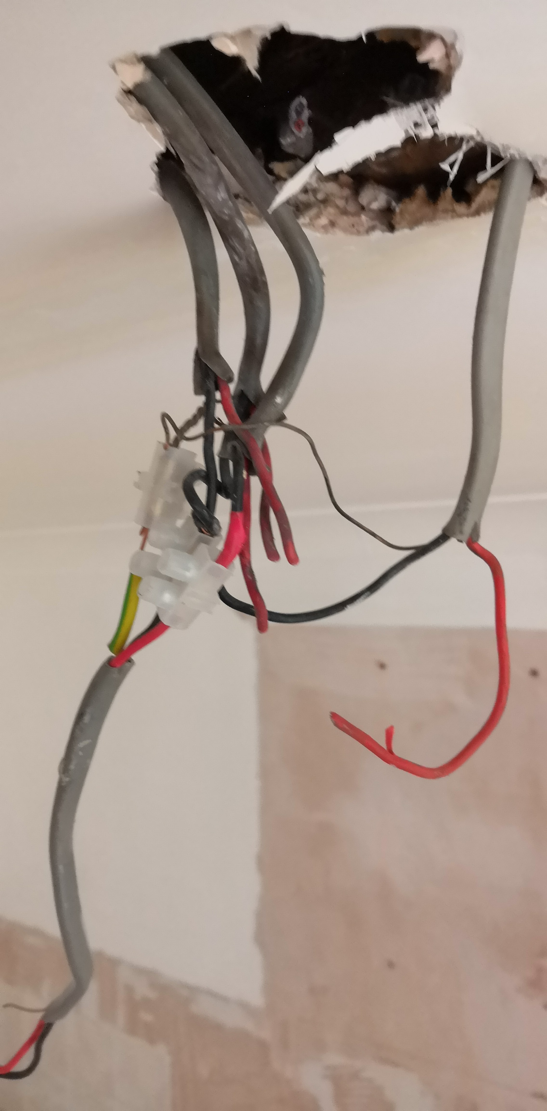

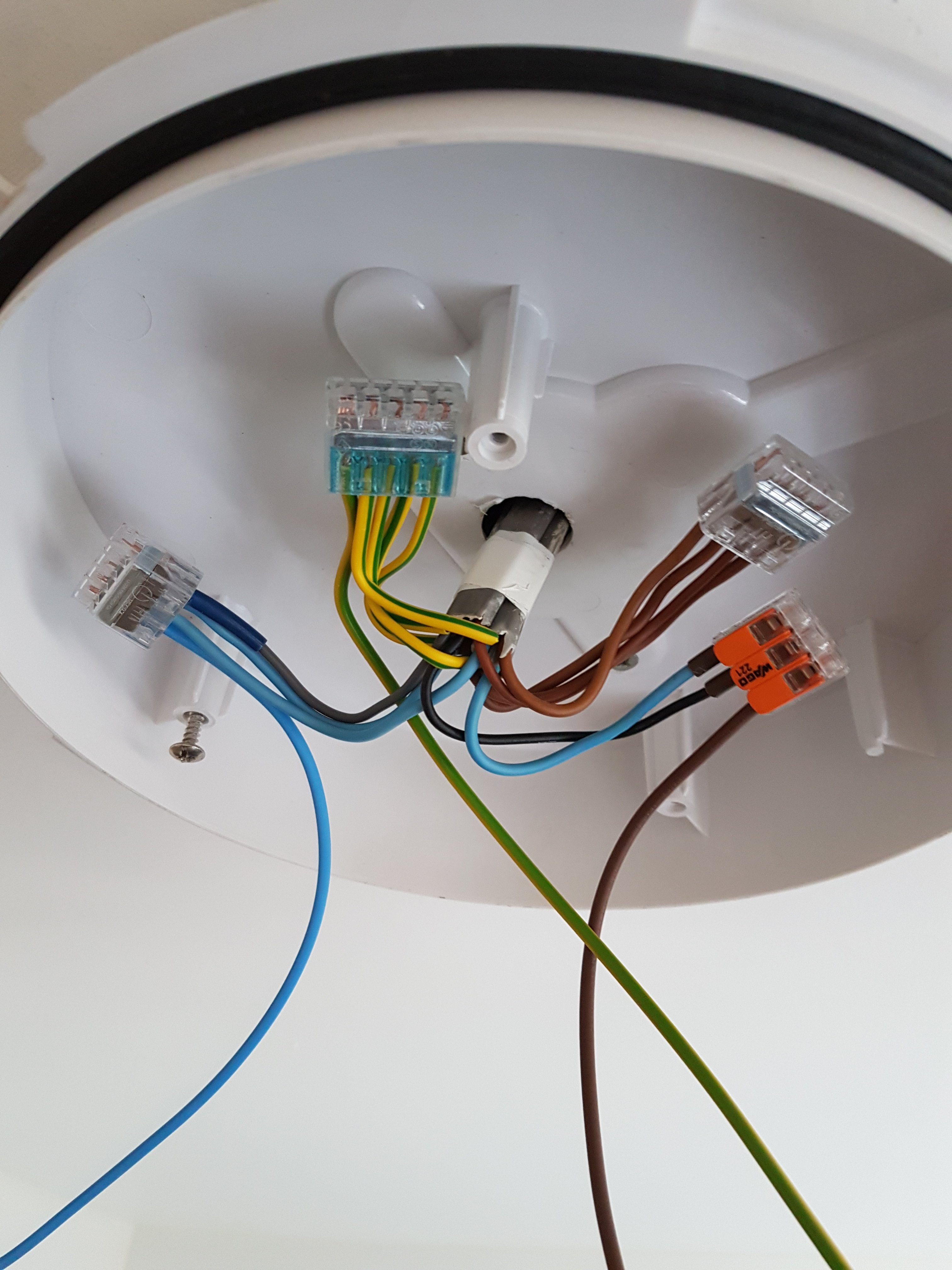

Bit of a mixed bag today though, had my first *BANG*. Replacing a light fitting for a landlord customer in one of her rentals, connected up, Zs was sweet, attached to ceiling, put the lights in and turn it on *BANG*. Looks like sharp edges cut into the poxy little cables running to the fittings. Suffice to say a ceiling rose is going up next week before I do an EICR on the place (no reason to do one other than she's not had one done on that property so she wants to get her paperwork in order).

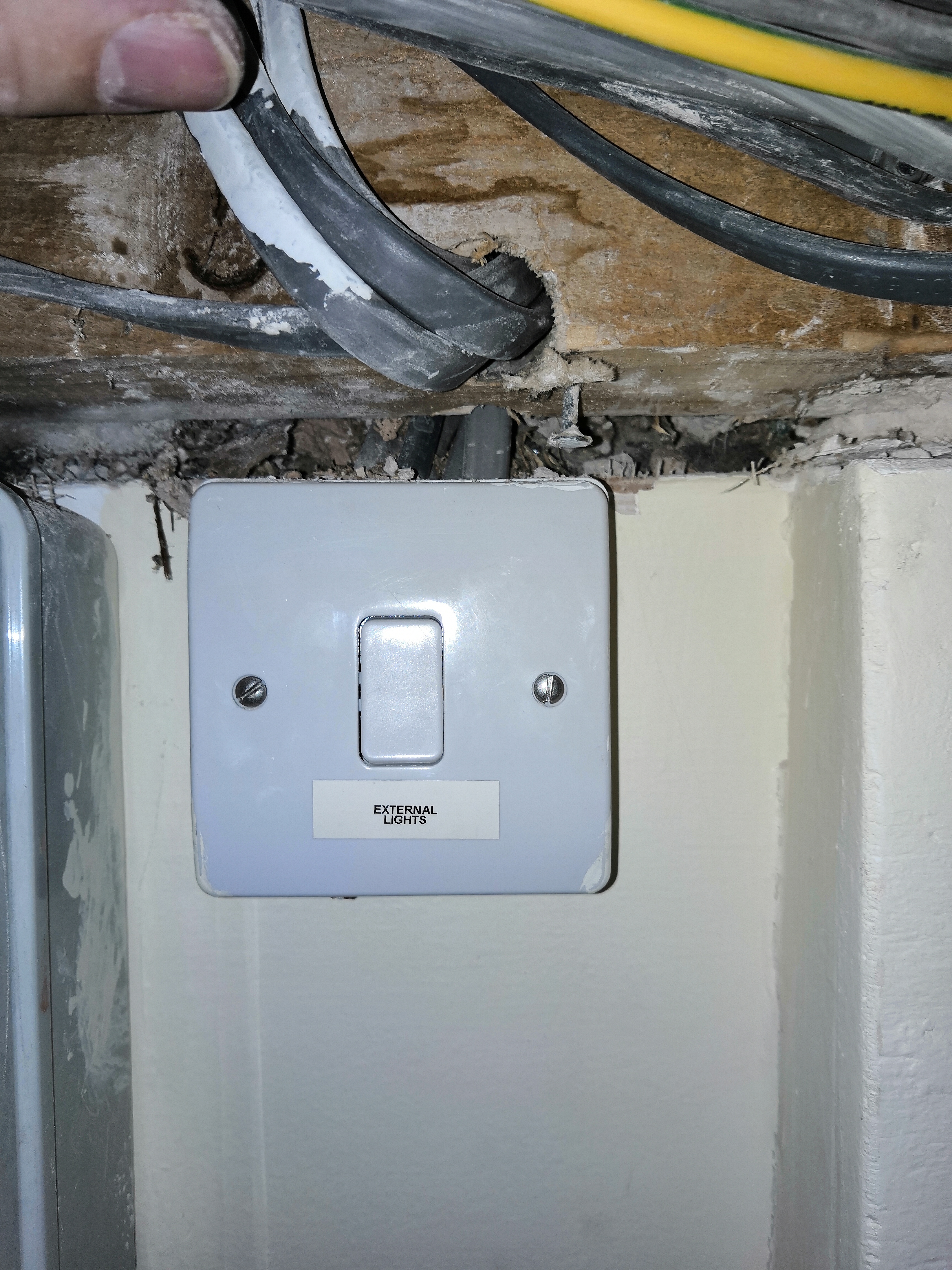

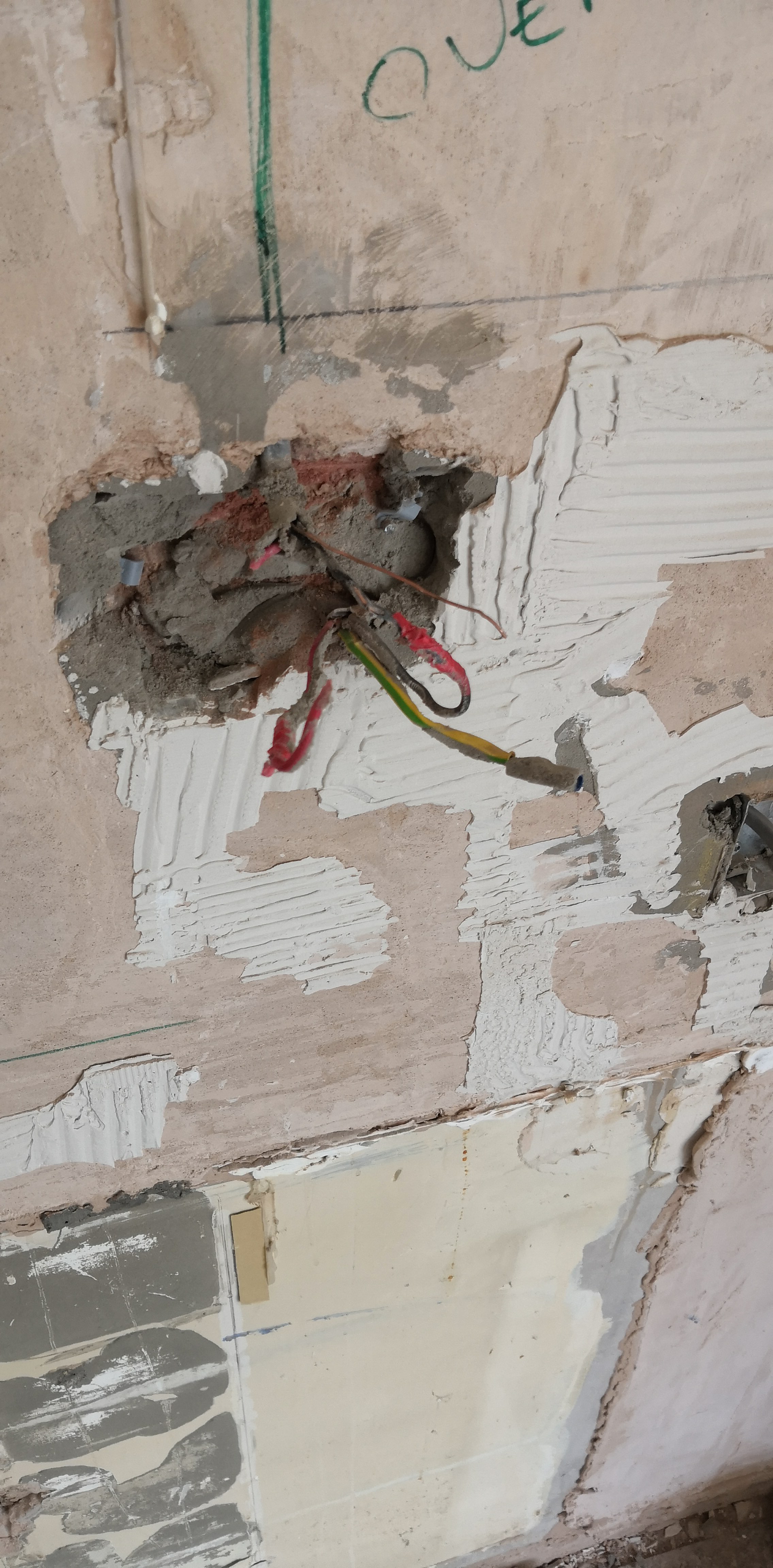

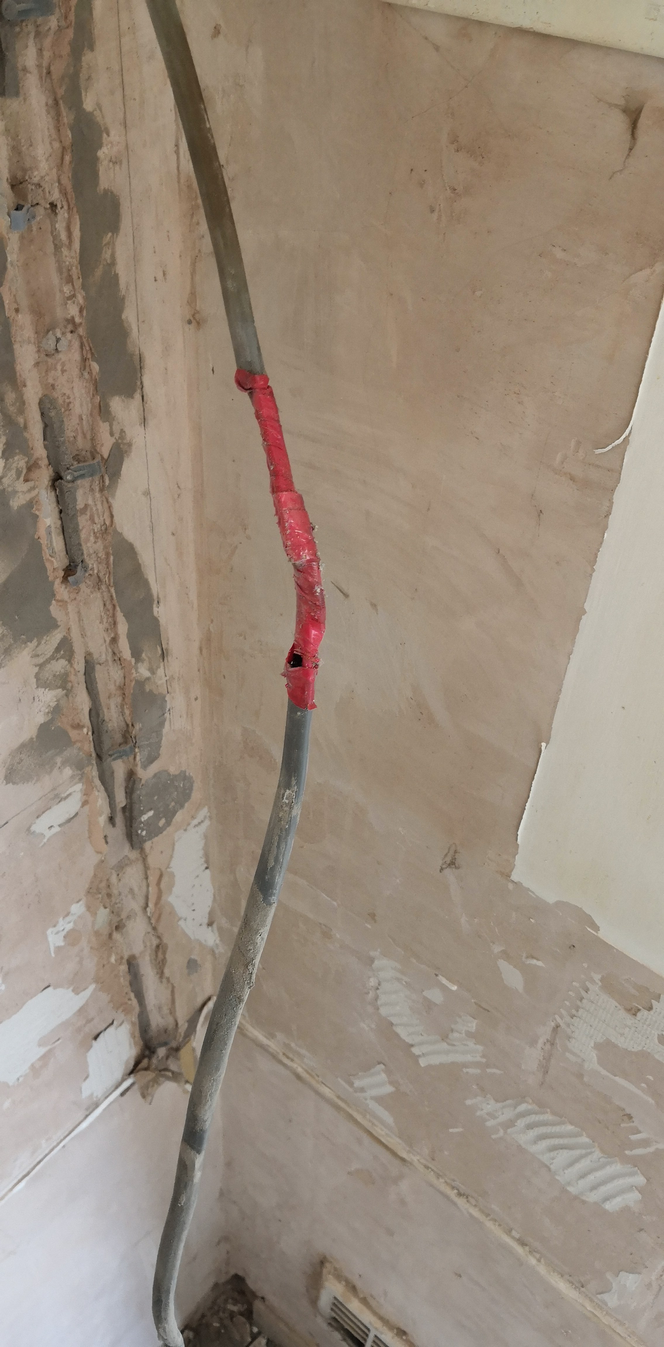

Absolutely butchered.
http://i.Upload the image directly to the thread.com/yfsdP21.jpg
Trunking filled to about 3 times its capacity.
http://i.Upload the image directly to the thread.com/AEnfeO1.jpg

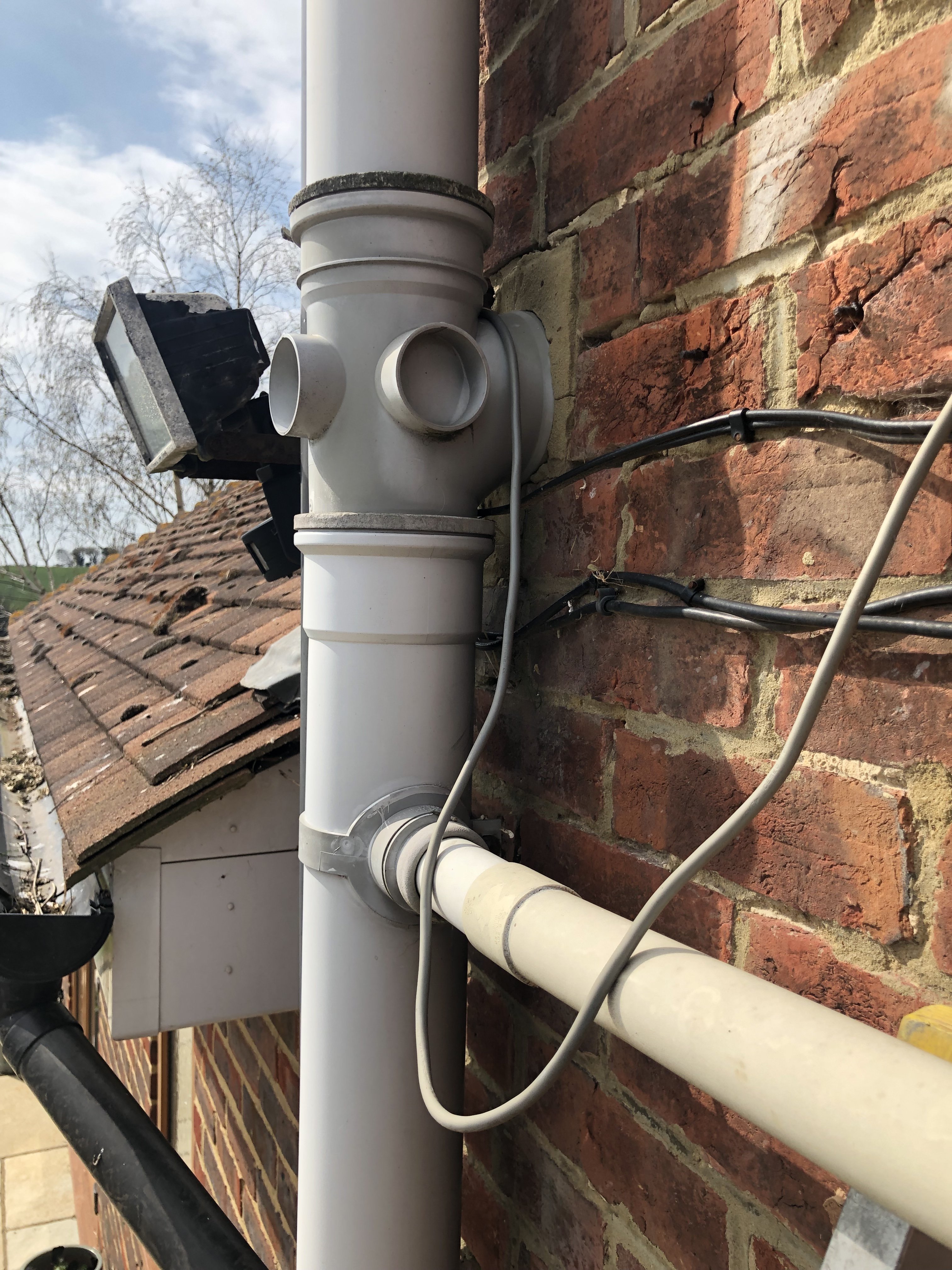

Finally a piece of bacon inside of a floodlight.

That looks like it could kill you with one sniff of it. :D
  • Funny
Reactions: David M
Luckily the water dampened the smell.
