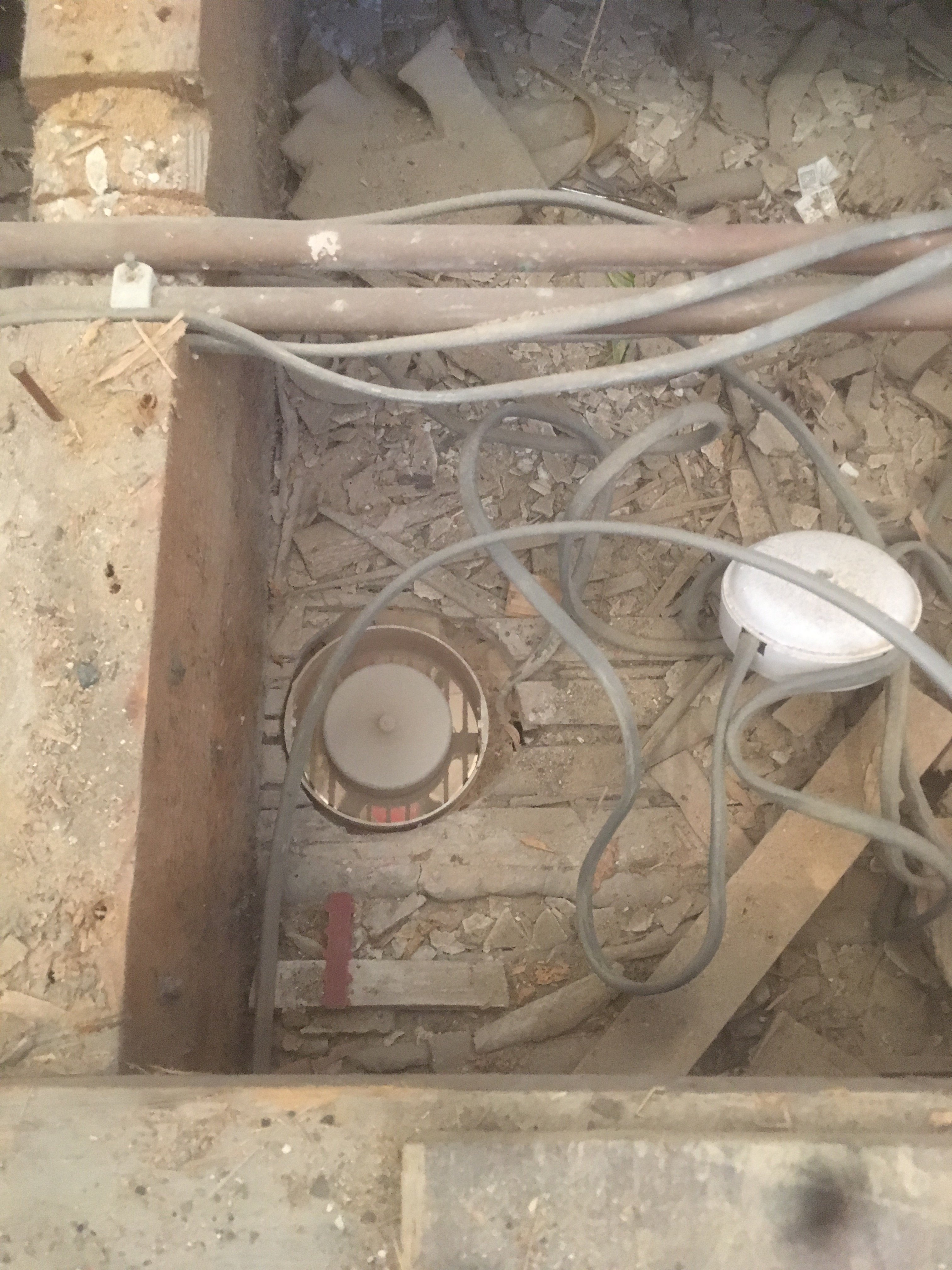

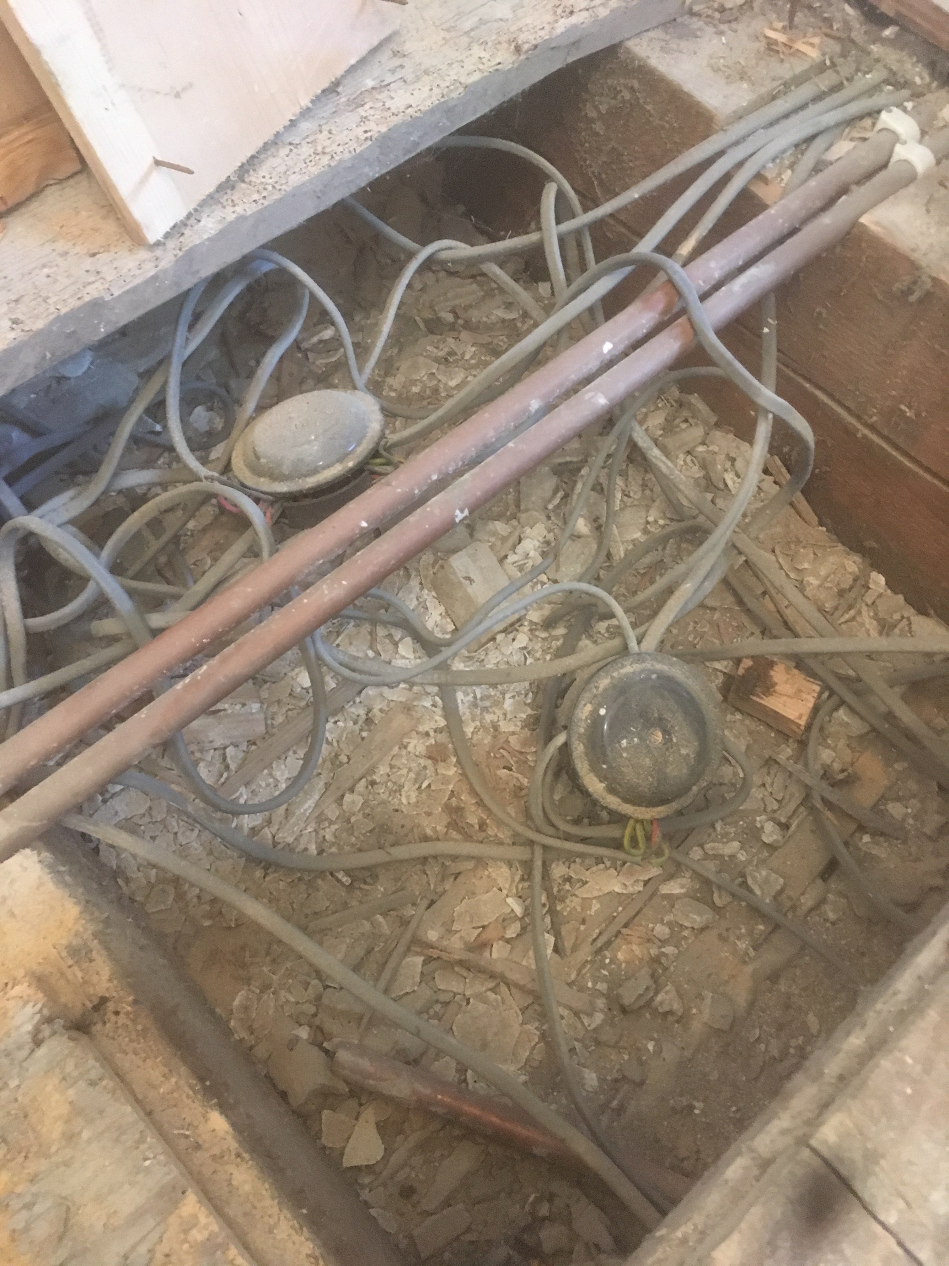

From a periodic in a property with dreadful wiring.
It was so much worse once the covers were removed.

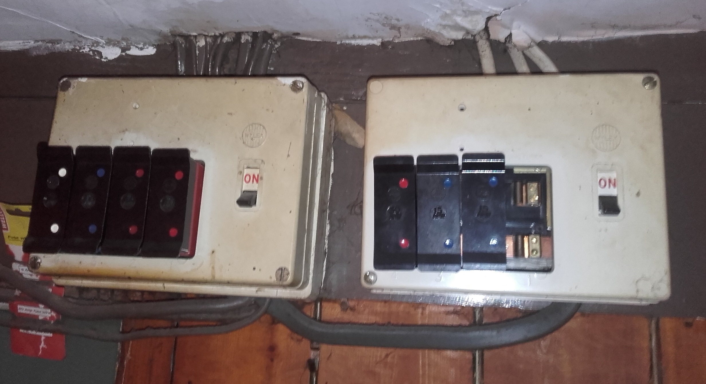

It doesn't look like it in the photo as I could poke the lens into the void, but the switch fuse that feeds the above 2 fuse boards it completely inaccessible. You can't get your hand in to reach it, as a stud wall has been built in front of it.
This join had several different colours of paint on it, so I assume it's been like it for a while... That cable spurring off of the ring final at this socket feeds 3 doubles.
Parts of the lighting circuit are also directly connected to the ring. I hope to go back to rewire as there are several things I couldn't quite find, such as the purpose of the red conductor that was connected to the neutral bar. Took me long enough to work out what was connected to what circuit, made more difficult by the light switches that were seized in the off position and various remote DP switches that sent power down a cable but no one knew what for.
