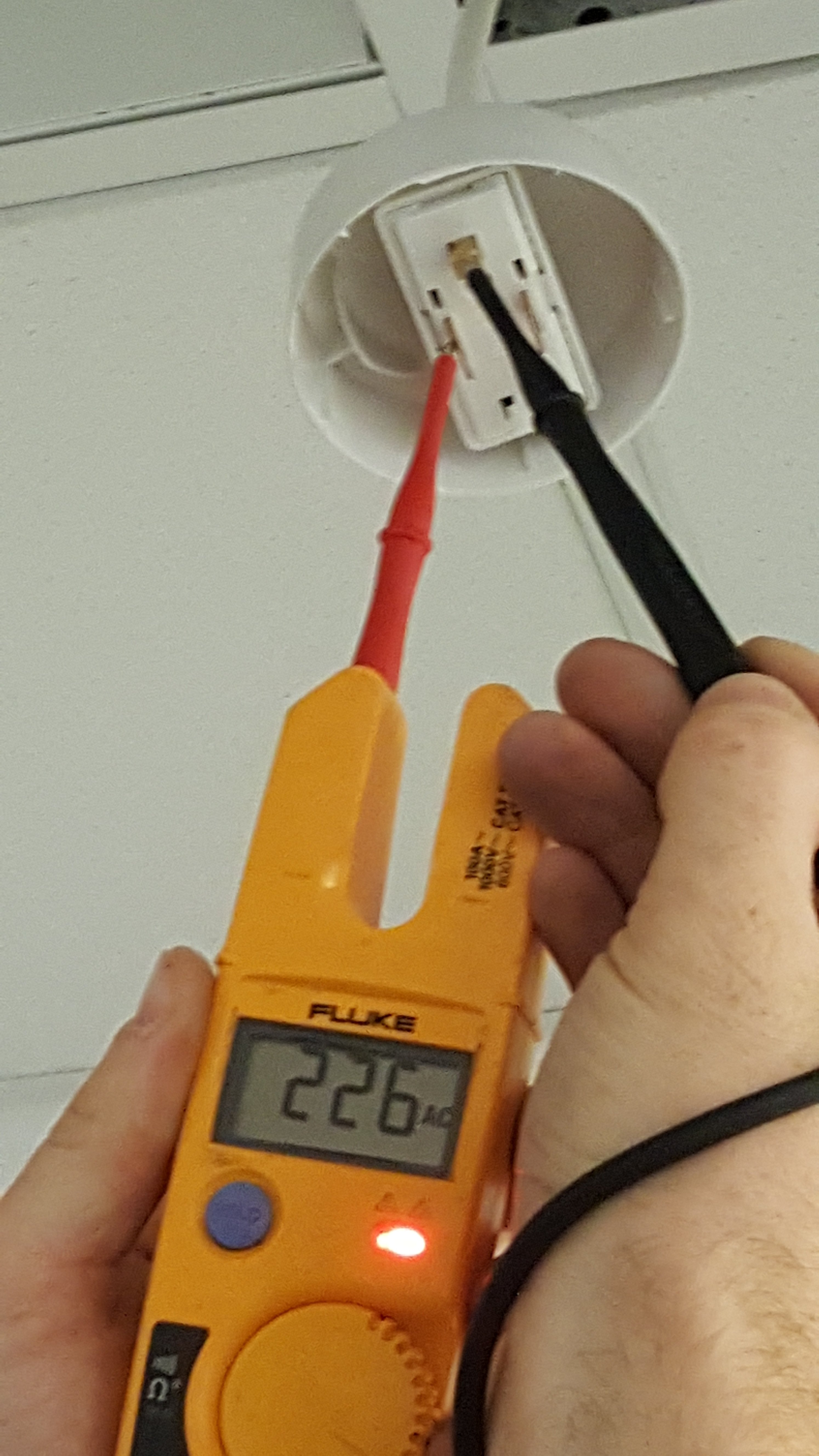

Came across this last week. Some moron had double fed a light fitting so that when the klik plug was unplugged, the pins were LIVE!
