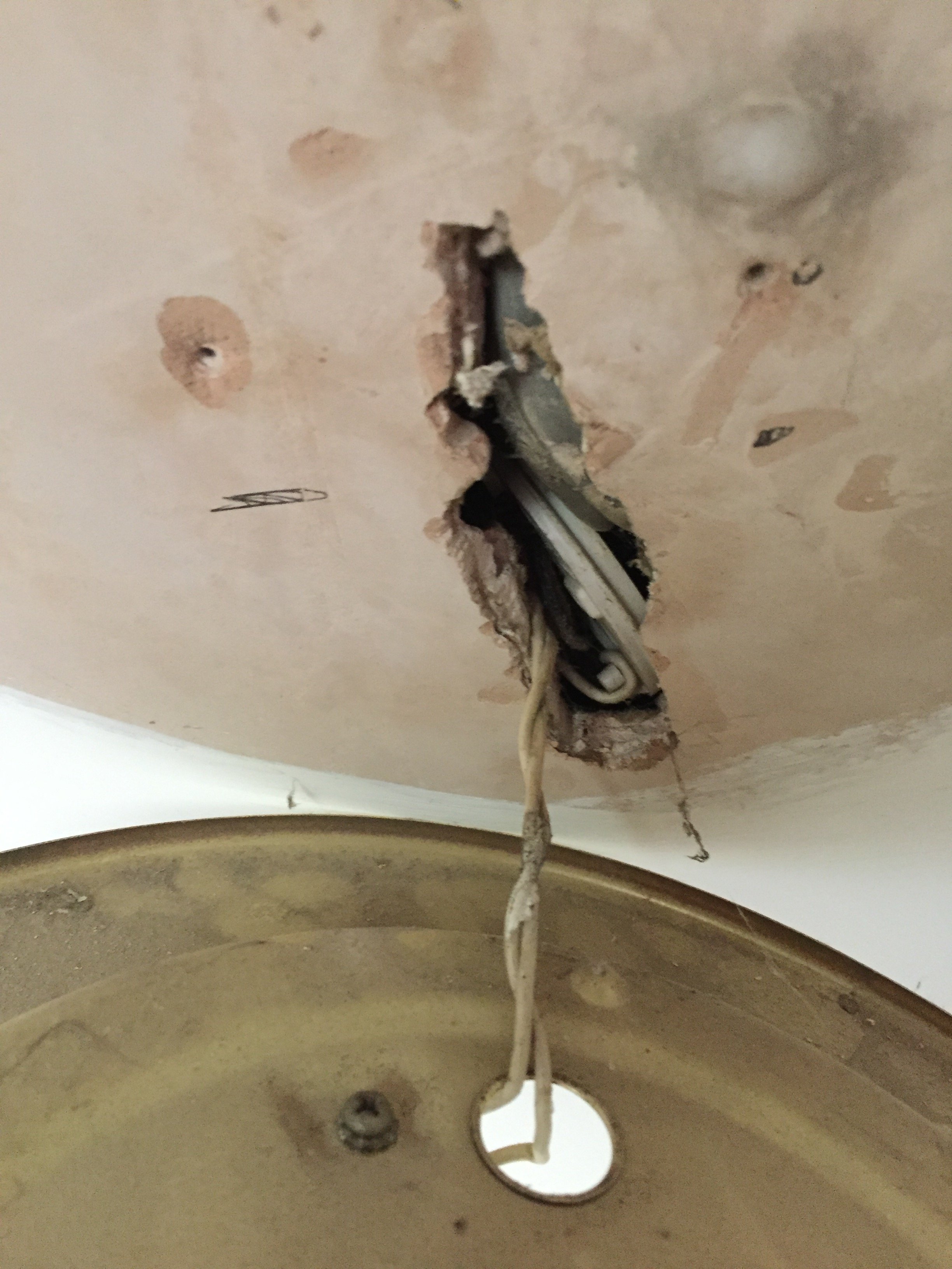

Quite special this, somebody has made there own bracket out of fixing band to hold the light fixture to the ceiling rose, wasn't a bad job to be honest apart from the earth not being attached.
https://i.Upload the image directly to the thread.com/pC6SAK9.jpg
At least they left it connected.

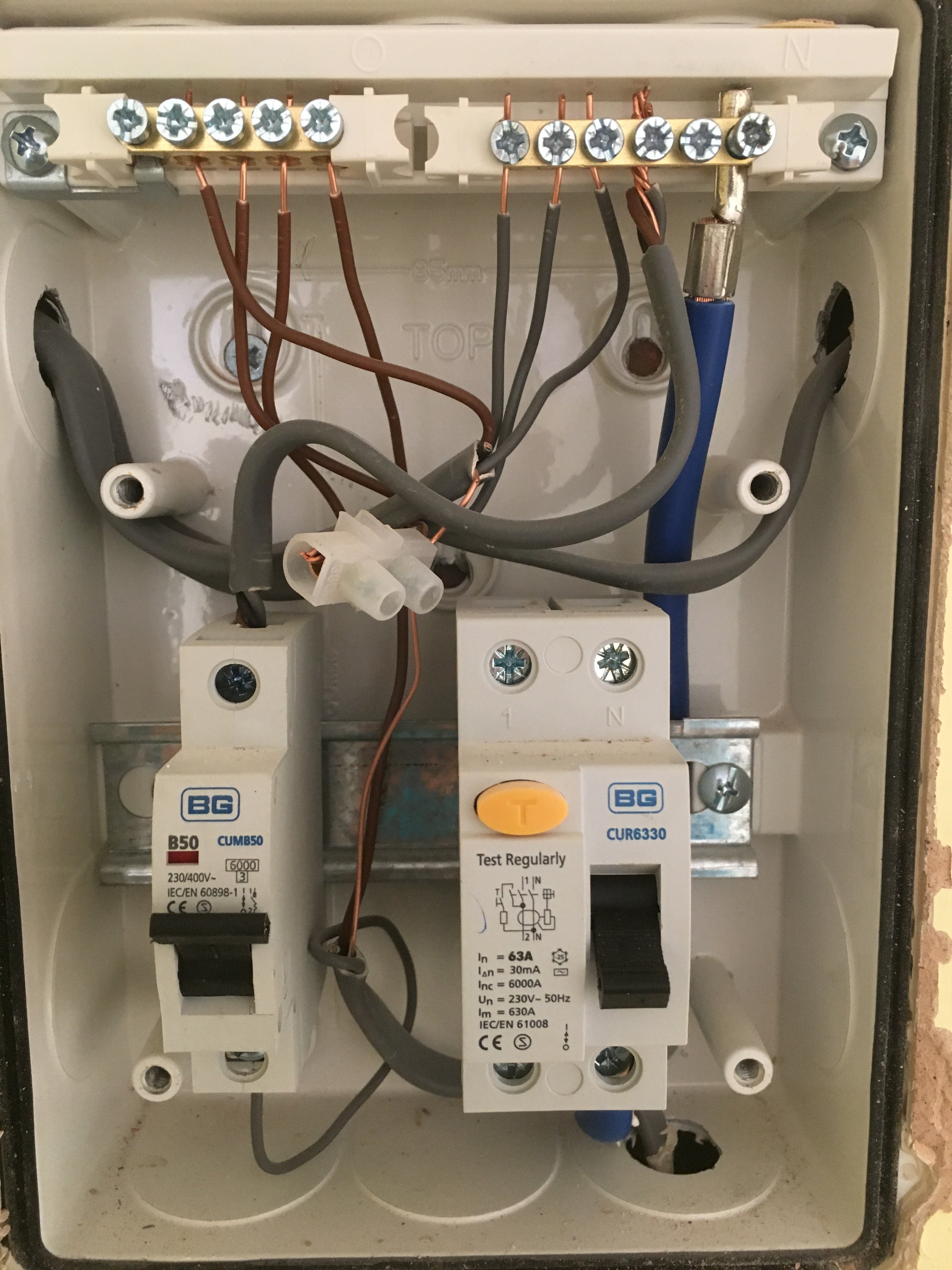

Just opened up this CU on a garage conversion.
Sweet Jesus.
Whole thing wired in 1mm 3 core.
Into a b50.
Supplies sockets and a utility room...
More later.
That there is a total abortion, @Marcus Vaughan
I can’t see one regulation that HAS been adhered to.
Is this a DIY bodge or a supposed electrician bodge?
Cant be a Sparky Bodge can it? surely not, Nah, Oh I dunno though
Reactions: Jim_e_Jib and DPG
I've tried three times to write an appropriate comment but words are letting me down. You'll have to invent some colourful new vocabulary for your report... I don't think standard English is up to the job.
E2A sorry I can't stand the suspense. You have to tell us what the polarity of the 'submain' is, what with the brown wires all being connected to the case and that. Pleeeease say it's the neutral or show us the other end.
Marcus, I hope you’ve told your apprentice to have another go ;)
Nightmare.
Cannot find the other end (the supply) at all. Must be buried in a wall or a JB under a floor. Maybe I'll find it tomorrow. Floorboards up tomorrow.
Polarity?
The grey to the bottom of the MCB is permanent live. This then makes the neutral bar top right an....erm...ehhh...'live bar'?
Then you have the three circuits, grey live and brown neutral on each, all from 1.0mm three core with black snipped.
Oh - and one of those 3 cores feeds sockets, including a washer/drier (or at least it did).
Worse still, this 3 core supply seems to have been put 'in-line' with an older radial socket circuit on 15amp BS3036 which serves bedrooms upstairs. so when I disconnected at this new CU, the upstairs sockets went dead.
What a mess.
nice little earner putting that lot right. start @ £400.
I have no idea how that even works??
Turn mcb on, twisted 3 core to top of mcb becomes live, as does the bar it connects into (normally a neutral bar). Hey presto. Everything works, until some meddling electrician comes along...
