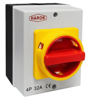

Those are industrial-use isolators; usually found in welding bays, factories, garages, etc..not that they couldn't be used in a domestic setting but it's certainly not standard. You'd also have to gland your cables into to do it properly and twin and earth probably isn't going to suffice.
What about a 4 pole rotary switch? Would this do it?
That is a 4 pole isolator, i.e. 4PST, it would need to be a 4-pole changeover switch which are a bit rarer to find.

Because simply putting in a 32 amp or more 4 pole double throw switch would solve the problem. I'm giving up with the idea of trying to make do with less than 4 poles because of the neutral problem. The problem now is I'm not finding very good results when I search for a suitable switch. Most switches don't even state how many throws they have, meaning I have to spend time considering switches that may not be suitable. A lot of switches that would work, have an off position in the middle. This would mean, every time I change over, there'd be a temporary break in the ring main.
What about this switch (the 32 amp one)? LW42 20/25/32A 4Pole Rotary Selector Universal Rotary Changeover Switch Isolator | eBay - https://www.ebay.co.uk/itm/363422468983?_trkparms=amclksrc%3DITM%26aid%3D1110006%26algo%3DHOMESPLICE.SIM%26ao%3D1%26asc%3D237334%26meid%3D0335e5c0502e49d38a40b2ad4f530fe3%26pid%3D101195%26rk%3D9%26rkt%3D12%26sd%3D144256490302%26itm%3D363422468983%26pmt%3D1%26noa%3D0%26pg%3D2047675%26algv%3DSimplAMLv9PairwiseWebMskuAspectsV202110NoVariantSeed%26brand%3DUnbranded&_trksid=p2047675.c101195.m1851&amdata=cksum%3A3634224689830335e5c0502e49d38a40b2ad4f530fe3%7Cenc%3AAQAGAAACMKy7vEOvBI8Auv8QpEnxmxLXZS4es8rMPqHXyNkGqLRd5oFGCqYoxmH%252FqjQpK%252FWirOlnB9WVZFMpP6mhJ1kymU1M8jq5VvMoo31uLspbmeLeWT%252BfvsZpO2ahpxyDvgjOcdQx0iWHkpUoufOD4JjzKJbU98t748WYITGs2%252BeHRSELeuBy%252FyCI7u9eoSg%252FyNXo6qpQ%252B9wRFeo6UyaXdJYDwV94mYw4QgnSmE1bx5KdINZkADZypdDrGs8yaDZhodCpmI4TXp3TQzGjrnPsl2IpifElkTLwDh4fpTCNn3sDPMUCNeWxkDyRKqGusVtcmGpEIvNovGHxFfG%252BR%252Fl3y0pwOD32S8sd0wUgtbt3xNmvYAtu1v1w6uIJwip7VAS6rCrOwDOhjV0%252FLwSQgcql6aq1bC9vV5xsq2VoeOPSCntndugYChkHKZiTOPvv30ceZBWp7lOPmbbwUWNZx2K9FpNHuutKbseOQ9d%252FEquPHxfkl%252FfdUDv6Iqa2h4MKN7KRpovWk47BLFPnx%252BkgNEDWsVIqnyOd7U94q9H%252BRXO%252FbTuFYREJjBoleUS3kjX8VsQsQBrbERTVnyQpFogFkGfmVL0u6WRY3EM%252FO5n5QCVoHVswC90ypxmvKQbcNo94%252Fud4b%252F%252BdycUV8LXOtmbnSmhYdRVE6ydArc5uKZyrnObyPmv%252BAygPVREKKKG7mF%252BBlevH%252BLkO7hOR%252FQvQXI27l%252BThCaU8vw65s5r2YGpG7lFOkf%252Fj5cN4%7Campid%3APL_CLK%7Cclp%3A2047675
It looks like the cables will fit into it without being glanded. Could it be any more dangerous than connecting the cables via wago connectors in a junction box?
That's basically the same thing, it's a switch meant for industrial usage. Last time i connected some of these up it was for 3 phase machinery in a metalworking shop. They're not meant for domestic usage.

It seems like fitting a 32 amp 4 pole double throw switch should be a simple task, and perfectly reasonable for maintenance and safety. Going from a faulty ring main to a safe ring main at the flick of a switch, certainly seems like a good idea to me. The problem is I've found no switches that state clearly they are 32 amp 4 pole double throw for single phase, no tutorials from fully qualified electricians about how to fit them. That's why the solutions I've thought of are "odd configurations to suit weird problems". It's also, why I am posting. It's better to make mistakes in the planning stage and correct those mistakes, than to follow through and learn the hard way. It seems to me that if the worst comes to the worst and there is a fault, being able to isolate the fault can only be a good thing.

Assuming a suitable 4 pole double throw switch was available (and the fact that they aren't readily available should indicate that your problem might be better solved in another manner), how do you propose to connect it to work in the intended manner?
