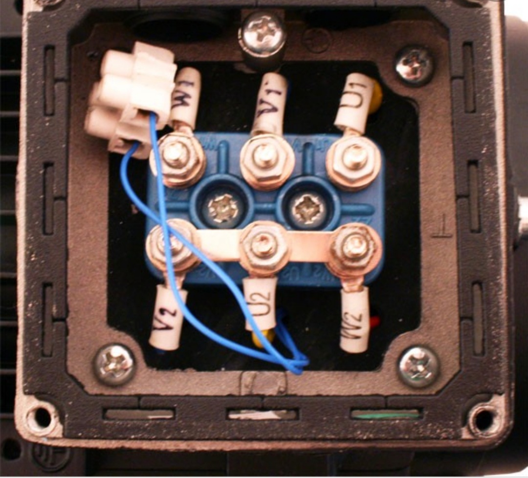

i would imagine it is the thermal overload, but surely a E-Stop would be incorporated with the control circuitry.
Assuming it is NC and indeed a thermal protector then yes it can be incorporated into the control circuit.

If you're on about connecting the thermal overload in the control circuit, just remember basics... 'stops in series, starts in parallel' and employ your t/o as a 'stop'.
I wouldnt call that the thermal overload, I would thnk that is a thermistor which detects the internal temperature of the motor. The resistance between the connection changes with the temperature, its not open or closed. For this to stop the motor it would need to be connected to a specific relay for this job.
the thermal overload is usually in the panel next to or under the contactor for the motor. Or atleast that is the terms I use for the components
It could be either a thermistor (resistance varies smoothly with temp) or a thermal switch a.k.a protector or Klixon (trademark) that opens at a certain temp. In the latter case it can be incorporated as one of the stops in the control circuit. As @WallaceP points out, the term 'thermal overload (relay)' usually refers to the overcurrent sensing device within the starter. That is 'thermal' because it has heater elements that mimic the temperature rise of the motor, while the thermal switch actually detects the motor temperature itself. It's more accurate as a representation of the motor temp, but slower to act, so the overload relay in the starter is still needed.
@Darkwood makes a good point that unless you know what category of safety the control system is required to achieve, you can't say anything about what is or is not acceptable for an E-Stop. E.g. if it fails to stop, what is the result... danger to life? A flooded plant room? etc.
