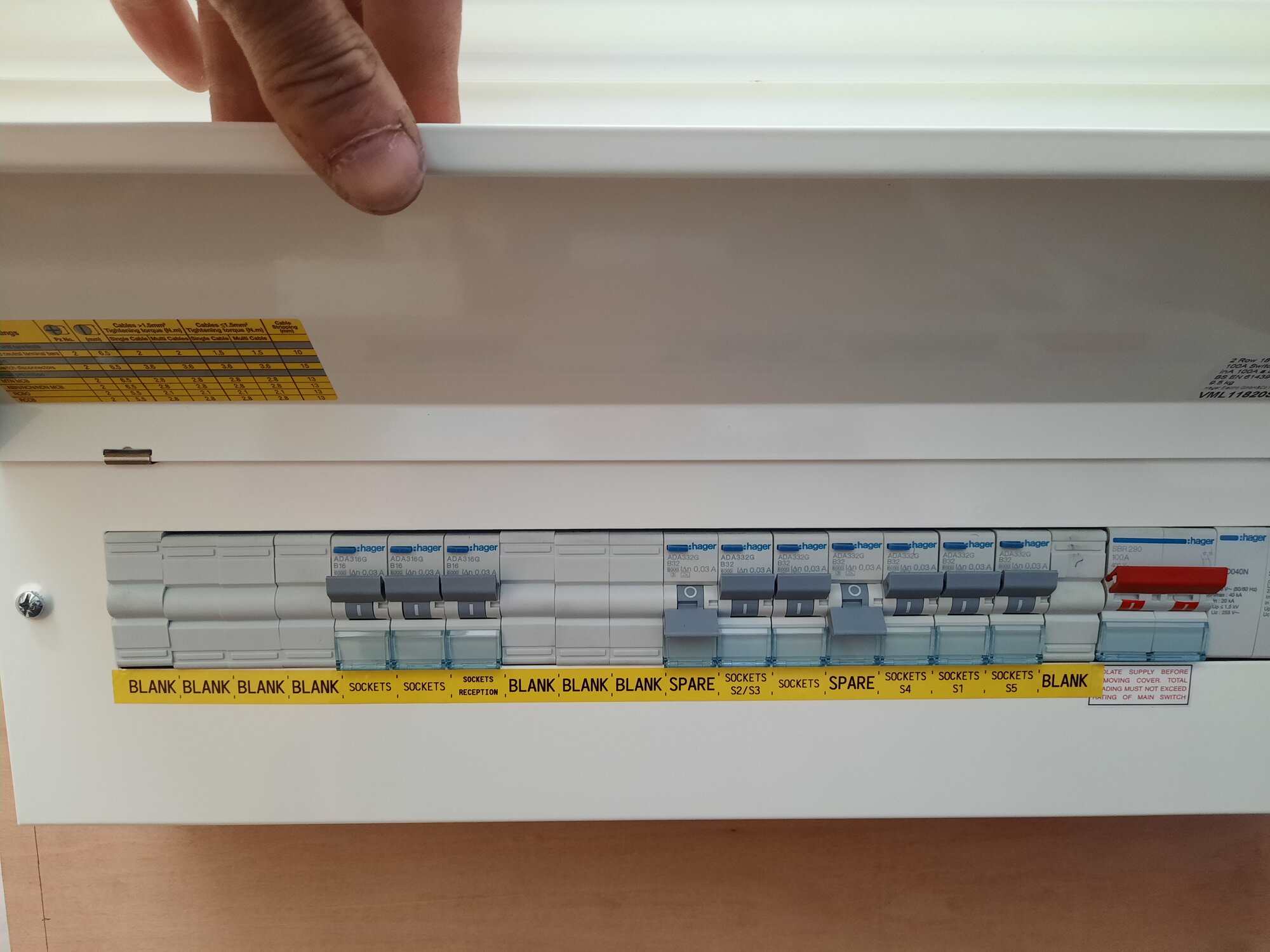

It needs to be a big box, I need a minimum of 16 circuits, by the time I separate out, probably more.
I've not done a double CU before, but I'm thinking a double will give me a lot of space for future. But all the Hager boards I see only have 2 RCD's. That does not seem enough. How are you guy's configuring your doubles. Maybe 2 RCD on the bottom and RCBO's on the top? Is it easy to install more neutral bars, or are they already preconfigured for several RCD's?

You can get an SPD and mainswitch only double decker from Hager, I've fitted a few.
Any wholesaler will be able to get one....
...although the last one I got was the wrong size, had to fit it regardless as it was a booked in shut down.
Ended up with more blanks than RCBOs,
Very decadent.
I think Fusebox are great. They are very affordable compared to others and seem to have everything you need. They also have the double layered CU which you are after, plus an even bigger one if you want. I would fit it with all RCBO's as they are only around £10 - £12 each.
Hello I have fitted a few of those Hager double boards, a really excellent board, and you know Parts will still be available in another 5-10 years!
Having said that I have fitted a few of those fusebox ones too and they are a great cheap board!
But in my own place I would most likely fit a Hager!
