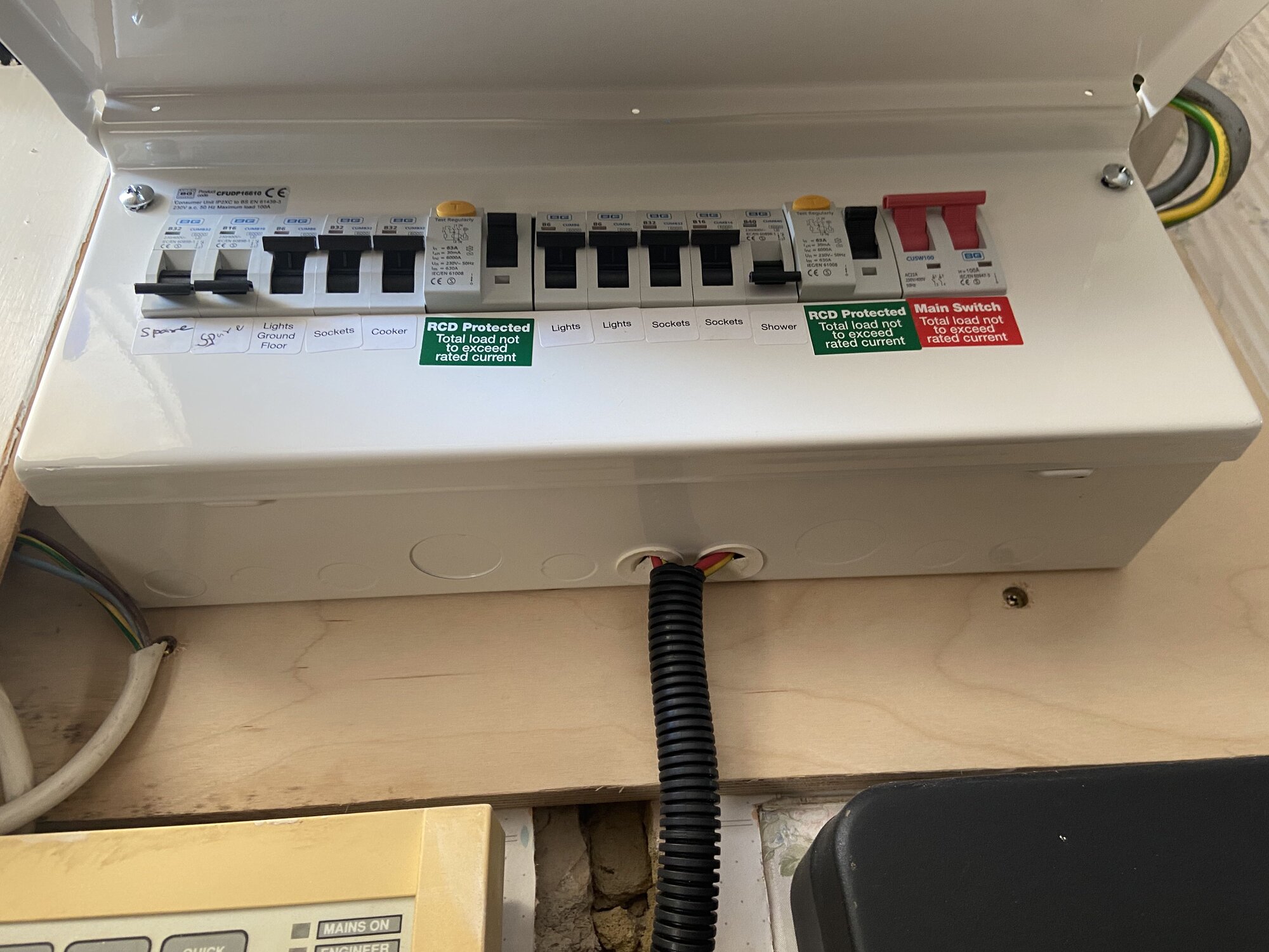

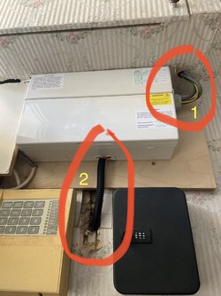

Hi Everyone, Thank you so much for your advise. Here are some photos attached:
I have spoken to another electrician today and he has said that it would be possible for the previous electrician to give a certificate saying that the consumer unit has been installed but highlight that the electrics are unsafe due to the lack of ring continuity which must be addressed.
Might you know if this is correct please? I am asking so I have an idea of what to say to the electrician who installed the consumer unit. I really don't feel comfortable asking any longer for him to correct the faults as I have been asking for the certificate for months and was under the impression that it was just a faulty oven. He told me last week that it was to do with a lack of ring continuity. I have contacted NICEIC who have recommended that I make a complaint so they can investigate, as the unit was installed December 2021 and there is still no certificate. I have shared this with the electrician who seems concerned now.
Other electricians have said that they could to a EICR report for £165.00 to diagnose the problem and resolve it but it would not cover the consumer unit.
Any thoughts would be greatly appreciated. Thank you, Vanessa

That black flexible conduit going into the bottom of it is dangerous there are wires exposed what a lash up, I would be sending a pic of that to the NICEIC if they have acknowledged your complaint.
Seems like you have used someone with little skill or competence which probably explains why they have not resolved the fault, they don't know how to.
Thank you for explaining this @westward10 I also wondered about this, my mum has Alzheimer's and often walks around touching things. I have asked them to return on so many occasions and honestly would like to find a way to receive a certificate until their point of work if its needed and then find someone else to come in who is going to do a safe job
No wonder the bloke don't want to put his name to that board , its gash
to be honest it was fitted in 2021, I would give up with the sparks who fitted it as clearly he don't give a sh!t
get a someone different in to sort it out

20mm flexi conduit …… 20mm hole….. It’s not difficult.
The NICEIC will probably tell you to get the electrician back in the first instance to rectify…. But 9/10 of these cases, I doubt the homeowner wants these cowboys anywhere near.
I’d hate to see what inside the board looks like.
I wonder if there were singles in the white oval conduit in the first place...difficult to see.
But why on earth he didn't find a way to run behind the board and in from the back is beyond me.
BG boards always say bodger, I fitted two in my life when they first came out, never again, out of two boards and 4 RCD's 2 were faulty and didn't trip, even with the test button pressed and on top of that the lid was such a pain in the arse to get on I could have fitted a whole new board in the time it took me to get it on.
Edit: looks like they are still hard to get the lid on, the right hand screw isn't done up. Also what are singles doing in oval conduit anyway, that looks like someone has drilled through the cable/conduit and done a quick repair, maybe it was done after the mains unit was fitted, cant believe someone who fits consumer units has done that, even a cowboy.
"BG boards always say bodger, I have fitted two in my life". See how that reads😂😂
You can get oval to round adaptors and it can be used for singles.
That's before I knew they were a bodgers board. when they first come out in Screwfix they were £50 inc VAT and were very heavy so they felt like a decent board for the money, we got two as we had two jobs to do both requiring mains units. The first one when we tested it failed the RCD test so I nicked one out of the other board and took that back as faulty. when we fitted the replacement board on the second job that had a faulty RCD as well.
whenever I see one now that has recently been fitted they never have things like the grommet strip installed or a tails gland, they are all fitted crooked and a mess inside. I asked if they got many back as faulty, no they said, I'm probably the only one that tests RCD's then on boards like that.
