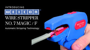

For flat cables I have a Weicon 7F stripper. It's fairly small and it gets into the back of backboxes very well. It doesn't exactly strip the cable flush with the entry point, it leaves about 8 or 10mm of sheath sticking into the box when it's finished. With me it gets low to average use, used regularly on some days then it's not used at all for some days, I've had it for 5 or 6 years now and it's still working well.

Mainly for twin and earth. 1.5 and 2.5mm so flat rather than round. I would consider 8-10mm about what I was looking for. I have the Stanley Fatmax strippers and while that kind are convenient when the cable is free they struggle to get near that much off in a back box, especially if there are any other wires in there.
I have seen others that are more the gun type but they often have pretty big heads as well so I forsee the same issue I'm having. I'll check out the one you recommend

Yes, 1.0mm, 1.5mm and 2.5mm flat twin cables are what I use it on, I haven't tried it on 4mm cables but I doubt it would do that size. They're not exactly cheap but I've always rated Weicon as a brand and I've had several of their tools over the years and I've always been happy with them. I live in a much warmer climate than you so cables are relatively easy the dismantle any time of year for us so maybe have a look around for a local wholesaler who stocks them and ask if you can demo/try it before buying.

I have a couple of Weicon strippers among a few different cable strippers. They're well made, but not a common brand in these parts. I can't remember the last time I went and got a cable stripper from the toolbox. More often than not cables are stripped using whatever is in my pocket and there's always a knife in my pocket, although I seldom use flat cables.
