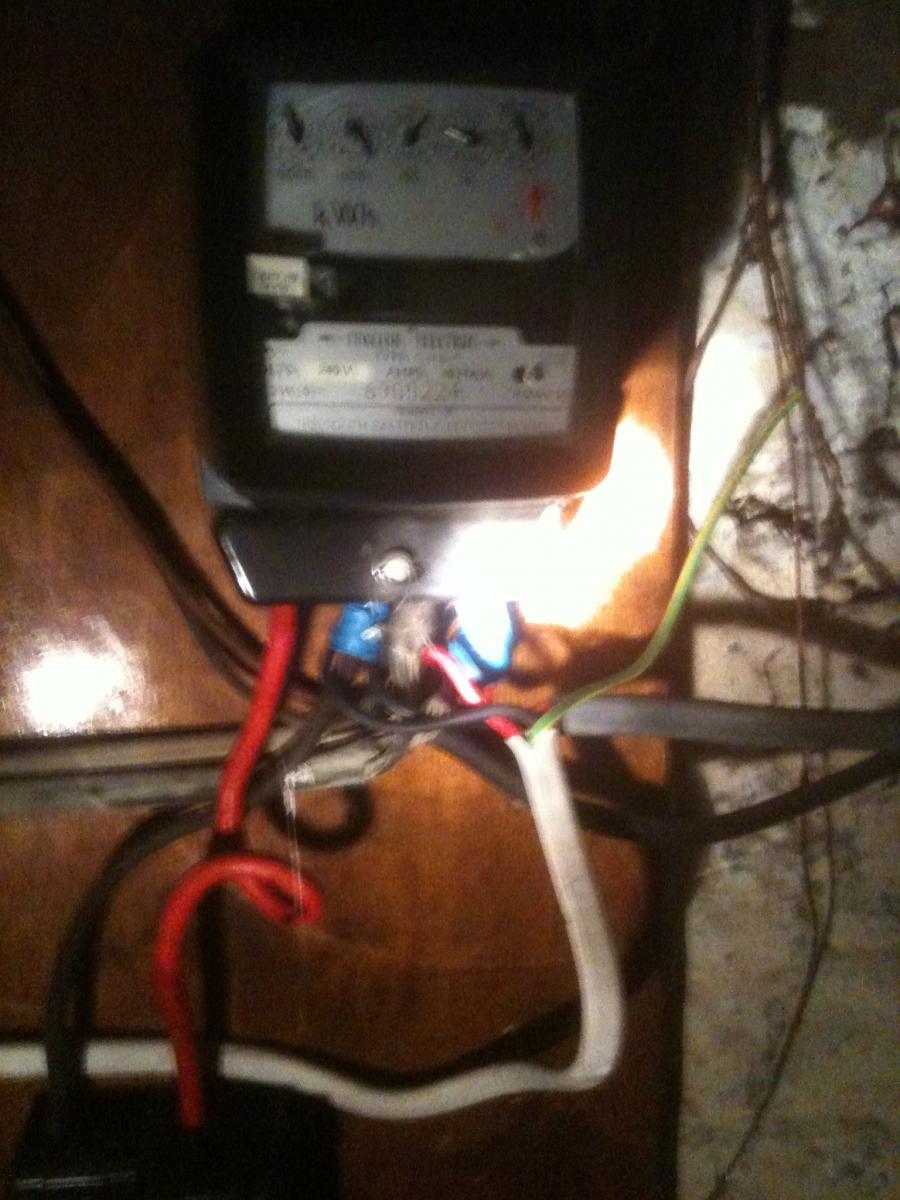

Here's something I found yesterday. Went round to a house to size up what was required to run power to the end of the garden, and went to have a look at Consumer Unit to check spare ways available etc.
Looking in the well used cupboard under the stairs found the meter in this condition...
...lower cover missing, and no obvious sign of it fallen down the back.
Decided I would put some strips of insulating tape across the live terminals as a temporary measure. As I did that, the live tail to the CU fell out! At least it wasn't the live from the supply...
Tightened all the terminals, covered with tape, and told the owner to call the DNO!
Reactions: 1 person
Why didnt yopou just ask if they had the cover as they probably took it off to get their free supply
