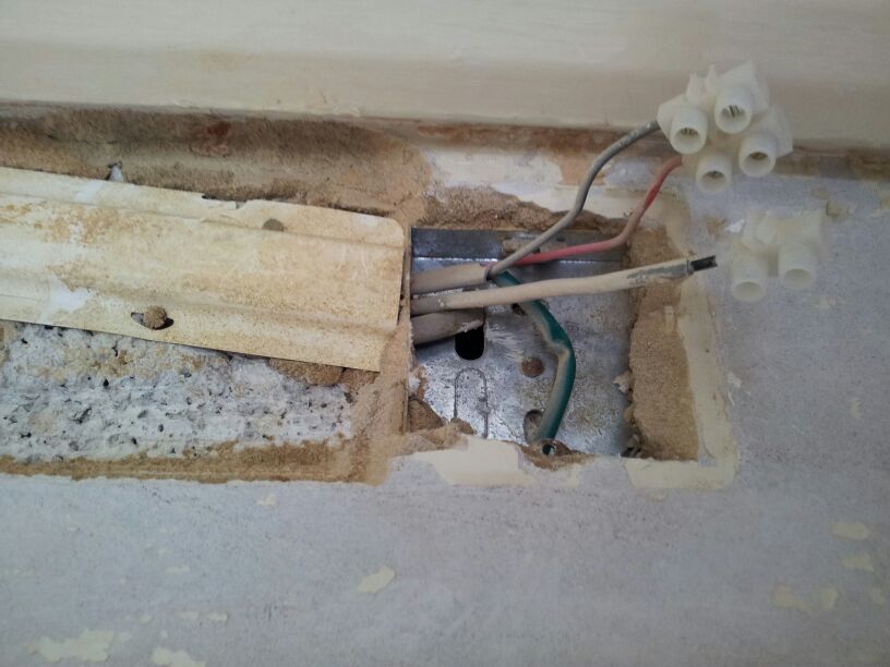

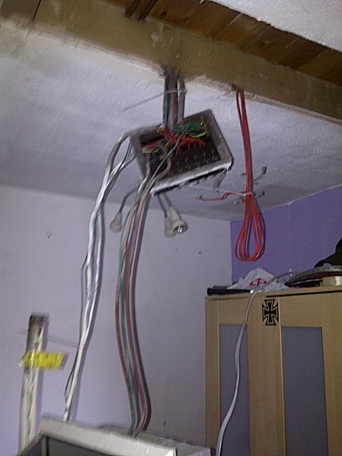

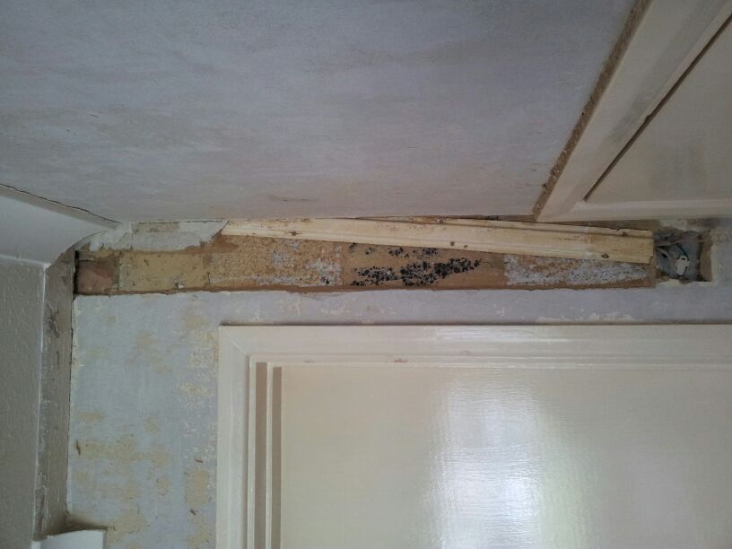

on rewiring my lounge (finally) fi.ding annoying and naughty (by todays' standards) things.
also, how many different types of masonry does one house need?!
Sent from my GT-I9100 using Tapatalk
Re: Tell us about your faults !
naughty naughty
no grommet for the cable leaving
the CPC should be feed to terminal block first for the fitting and then looped to the back plate
wires are ok in the safe zone just a bit of a bodge
with an attic hatch above it would have been easier to drop down
as fas as masonery it depends on the bodgers and whats handy
I recently found concrete used to patch studwork walls!!
and that bodge dates from 1958 when the house was built, the house had pre made studwork walls, you slotted into place, and you were supposed to drill the timber at top and use a rod to force a gap into the cardboard cells for the cables
this lot used a sledgehammer by the look of things and then used concrete to infill
that took soem digging out for a rewire???

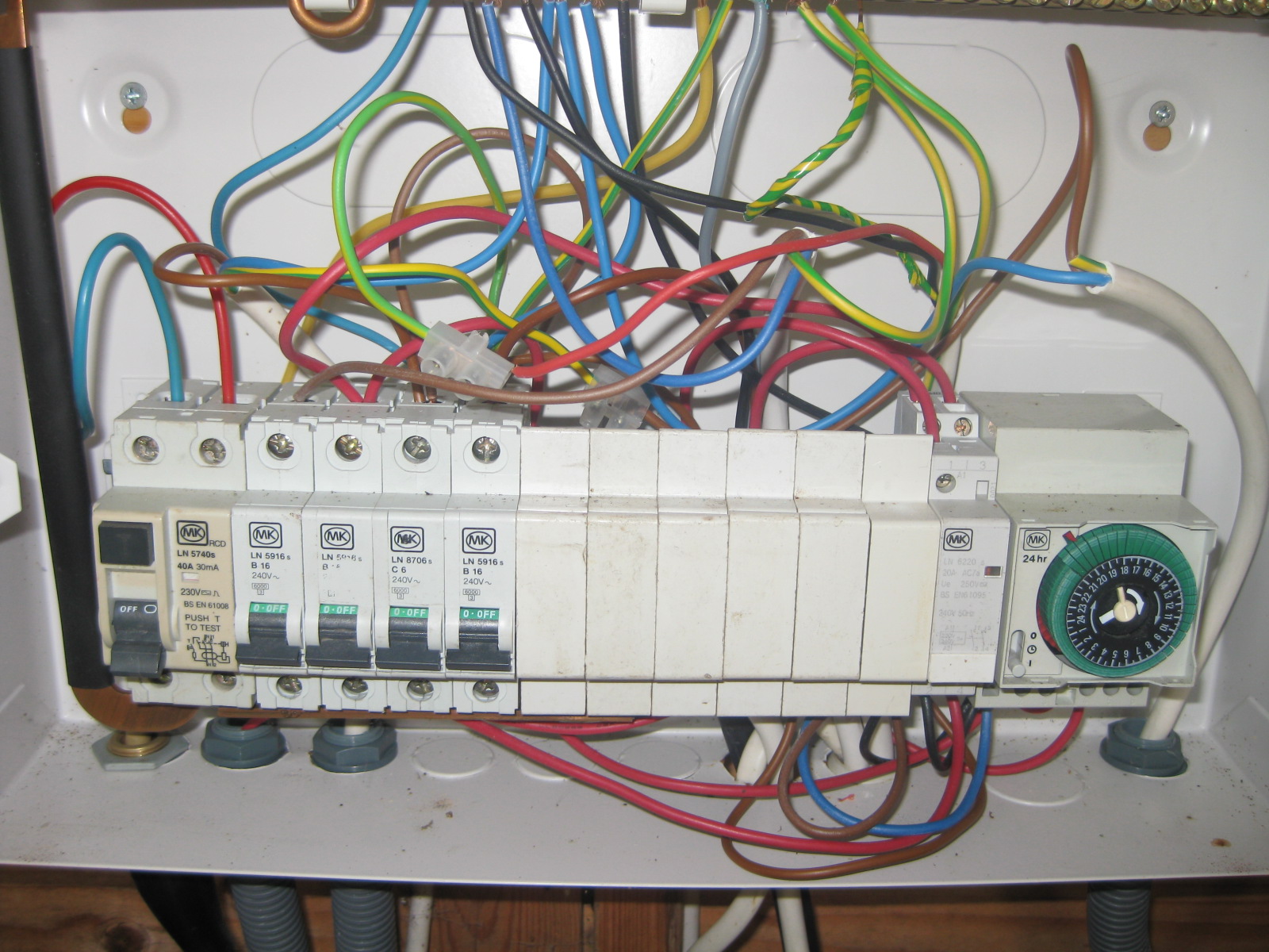

Following a recent Consumer Unit upgrade last year. We had two mcb trip events for no apparent reason. The last trip was accompanied by a smell emanating from the CU. I ordered a new mcb. As I went to fit it, I noticed that the pair of wires were charred, and came out of the terminals by hand!
there has been some problems with poor quality chinese clone equipment doing the rounds
even through the wholesalers
I would suggest you get the MCB checked, you may need to change them all

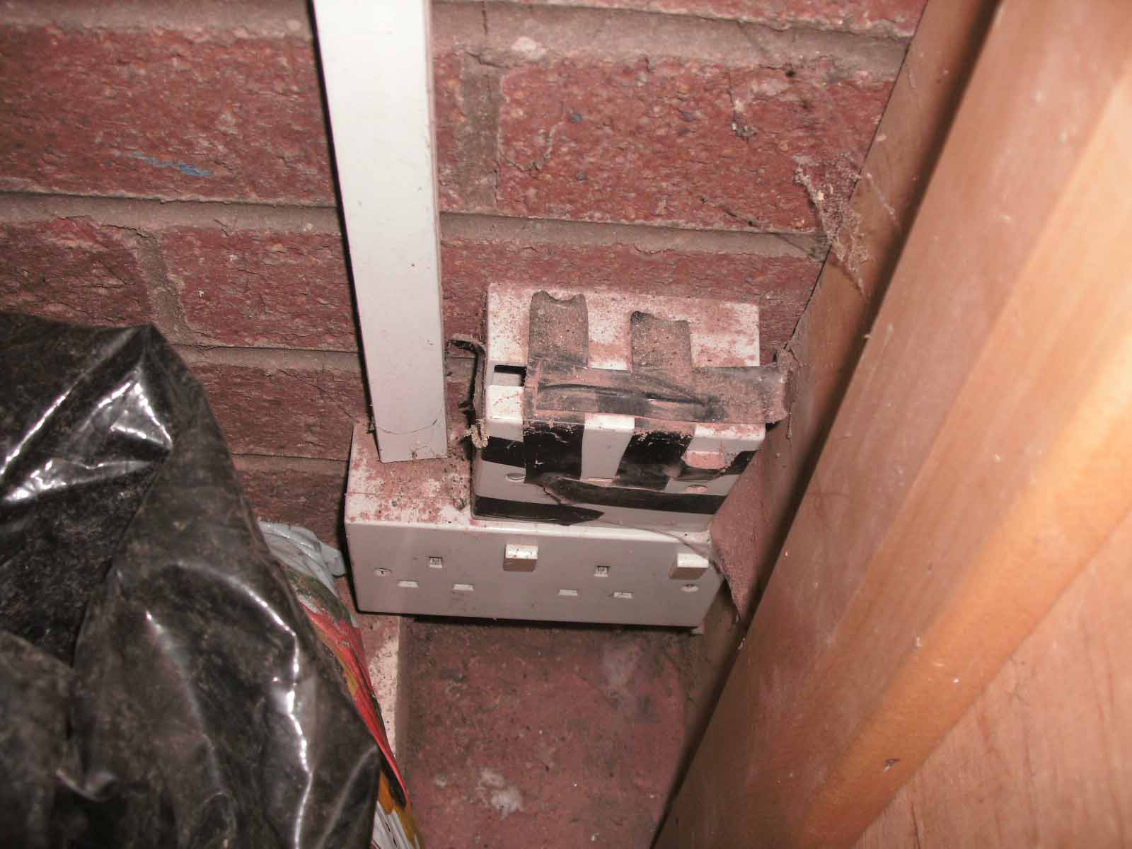

from yesterday.3 core/E feeding external class 1 security light. cpc cut off, cable slightly too long. like the FCU held together with tape. the client has young kids. FFS.
