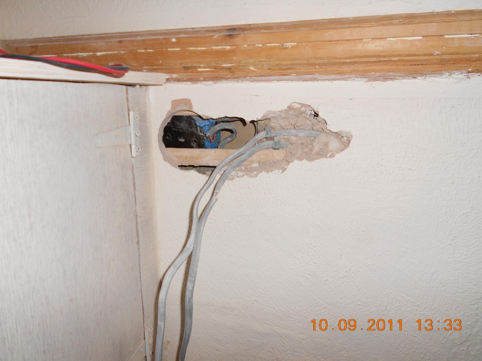

Found fault where joiner put screw into cables while installing cabnet enclosing CU and meter.
Thats a dado rail above the ring final cct cables where the cables run and the CU is a bit of a mess with a old cable left in for the shower!

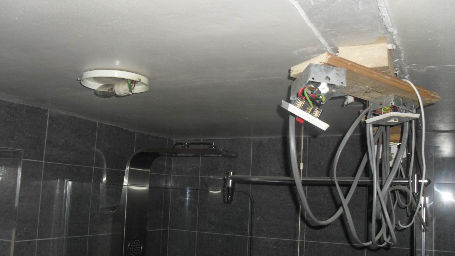

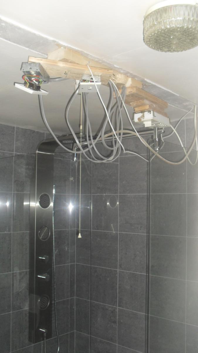

A few from a Dom PIR I did today........just had a whole new bathroom install mind, shower, fan, center light etc all connected to this lot.
An 8 way 3036 CU with upfront VOELCB & nowt else!!!!:skull:

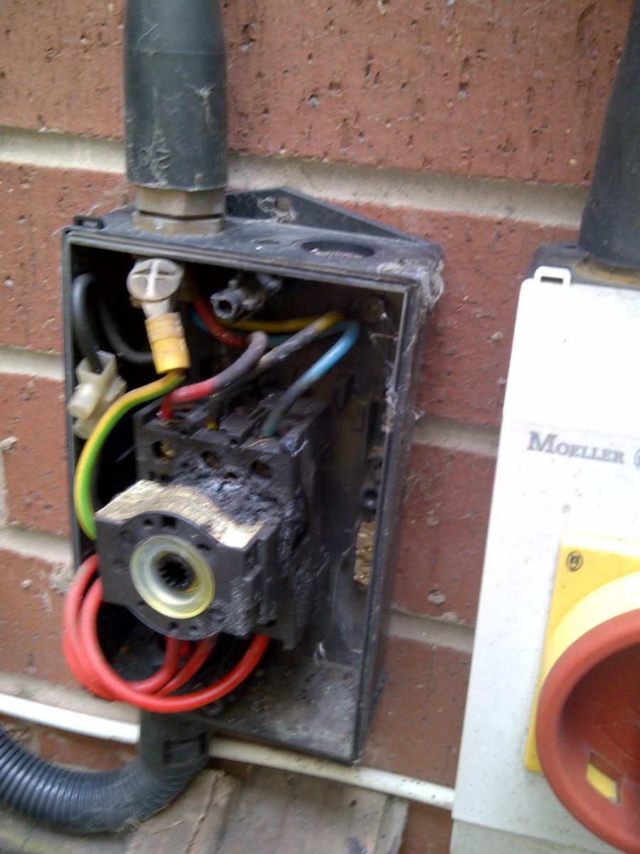

Installer left a drill hole for the swa tag on top of the 3 pole isolator. on the particular one he decided to crimp the earth seperatly leaving a hole exposed for the lovely british weather !

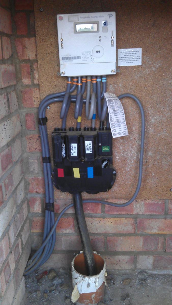

This was on a small private wharf, where I was asked to add a hookup point for a second boat.
A "keen volunteer" did the original installation for them - on the outside of the shed. It was "waterproofed" by a piece of plastic sheet draped over the board. It brings a whole new meaning to special location.
No RCD, Boat supply from TNCS not TT, borrowed neutral on lights, back of cu open to fingers etc., everything wired either in 2.5 T&E or odd bits of flex, mysterious taped up cables... I could go on, but won't.
I explained that a few other bits and pieces needed to be done before I could add the second hookup point. They agreed.

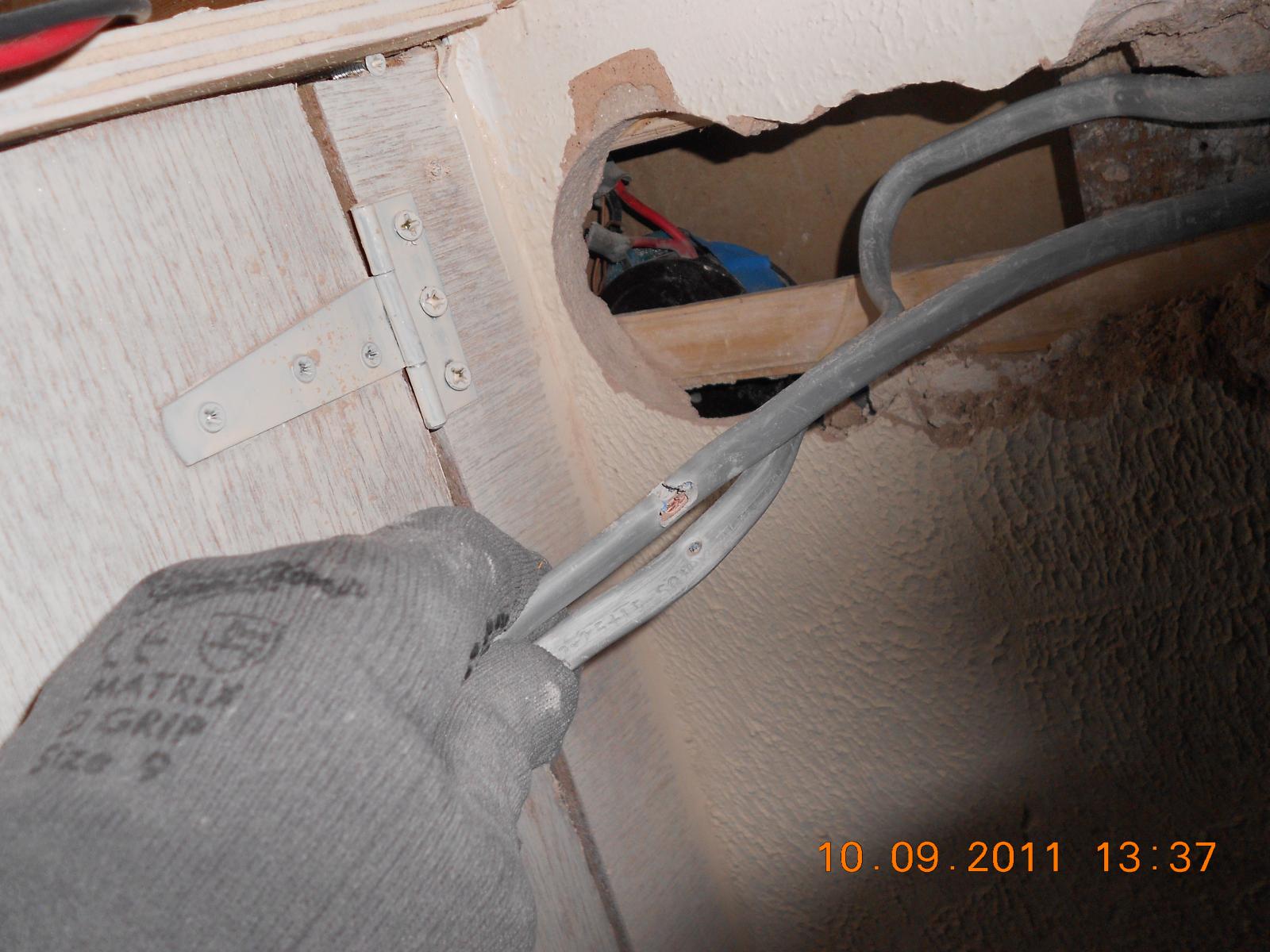

Got called to a house the other day, fault on ring final.
Have you had any work done recently?
Yeah i had some shelves put up on friday
When did the eletric go?
Friday
SOme clever b@stard only put up shelves above a CU in the cupboard, went straight through two legs of the ring on two sets of shelves!! Still, keeps us in work ;-)
