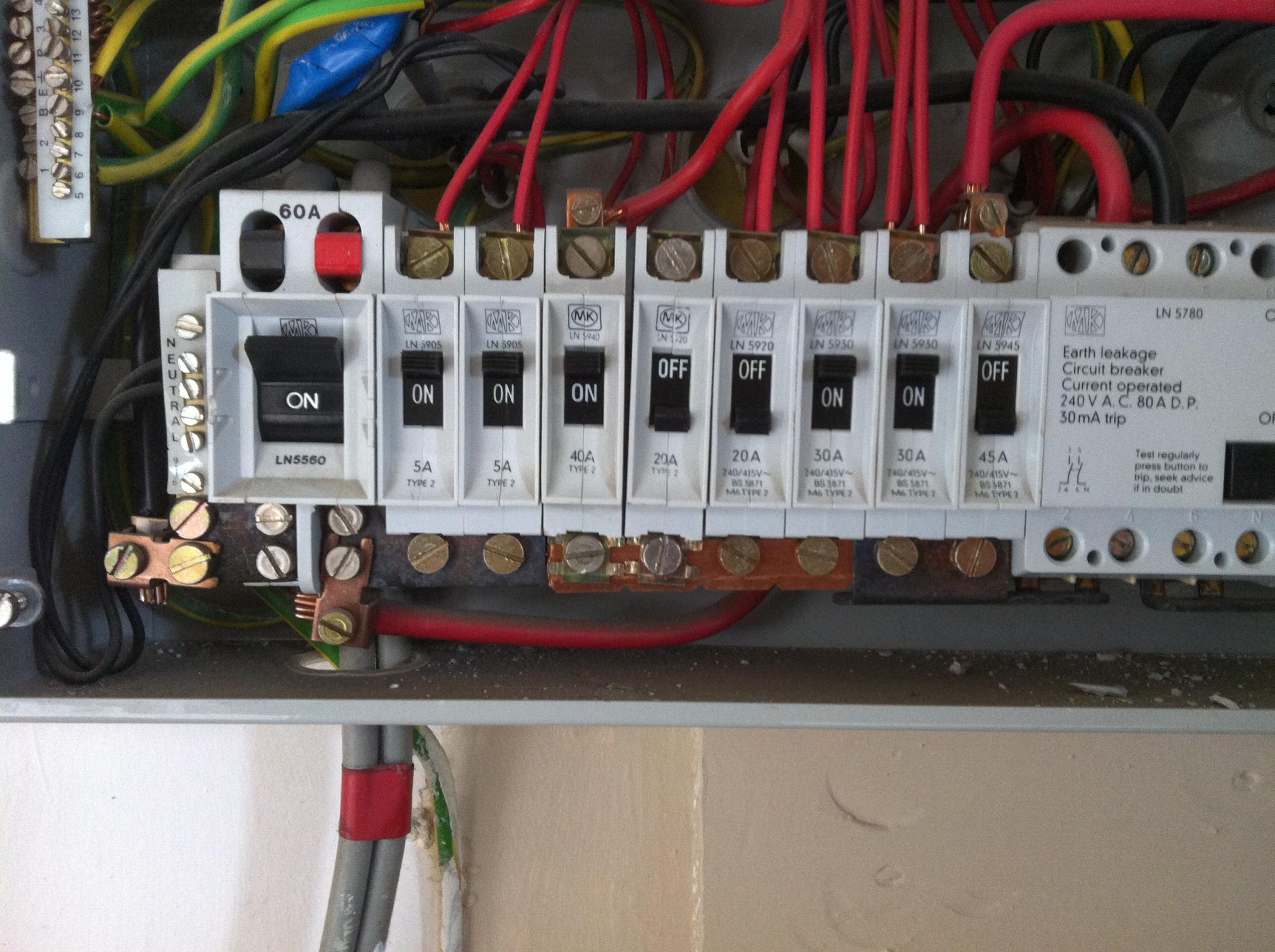

are the busbars on this right? first two mcbs on the left are on non RCD side.
busbars are touching, continuity tested them to be sure.
My brain is screaming that this is not right, but i wanted to double check.
the 'cut-out' for the MCB fronts in the DB cover has been modified to fit them all. To me it seems the busbars have been modified to fit everything.
is it right? is it wrong?

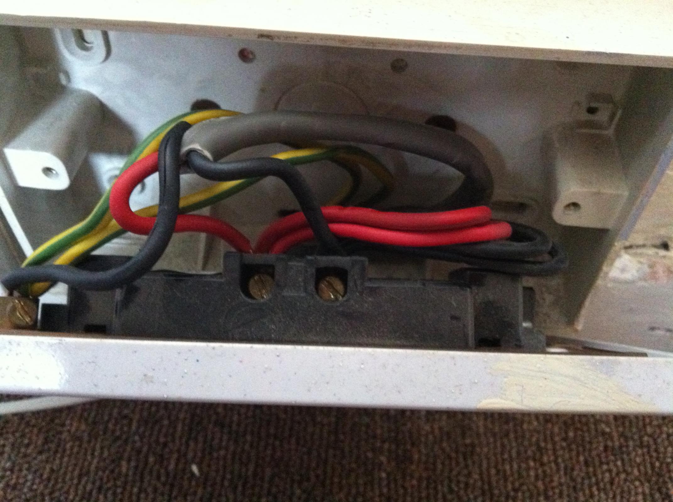

DIY job, in cupboard under sink. Has an earth fault
DIY. Spot the issue?
whats the earthing arrangement??

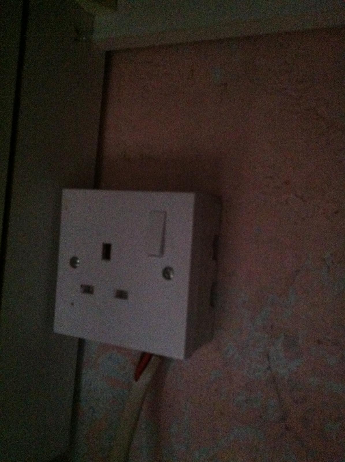

No cooker isolation switch, pulled cooker out..NO OUTLET either. Looked in tiny cupboard above cooker space and found this. Roughly a metre of slack cable lay snaked on top of the cupboard so assume tenant moved it here when refurbed kitchen.
all photos from same property...massive remedials list. DIY central

The RCD is fed top and bottom with the line conductor, if the RCD switches off then the circuits will still be supplied with the line.
However the "contact" for those two busbars may not have enough CCC for the load, though with the neutral off the installation should be at 230V everywhere including the earth, so must have missed something
thats what gets me, get 0 or 1v from 'RCD busbar' and either 'RCD circuits neutral bar' or earth bar when the RCD is switched off, and main switch is on. so no feed through the busbars.
But continuity test between the two seperate bars was dead short, and i mean dead short 0.00
ill add a photo of the other half of board...give me a sec
yes, my tester has a panic attack if i do continuity on a live source :)
they look in contact, continuity proves they are.
Yet no voltage?!? thats why im confused :(
