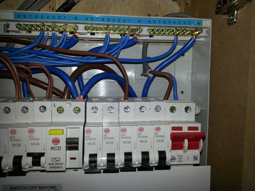

Is there a prize for spotting all the faults?!
Go for it ;)
