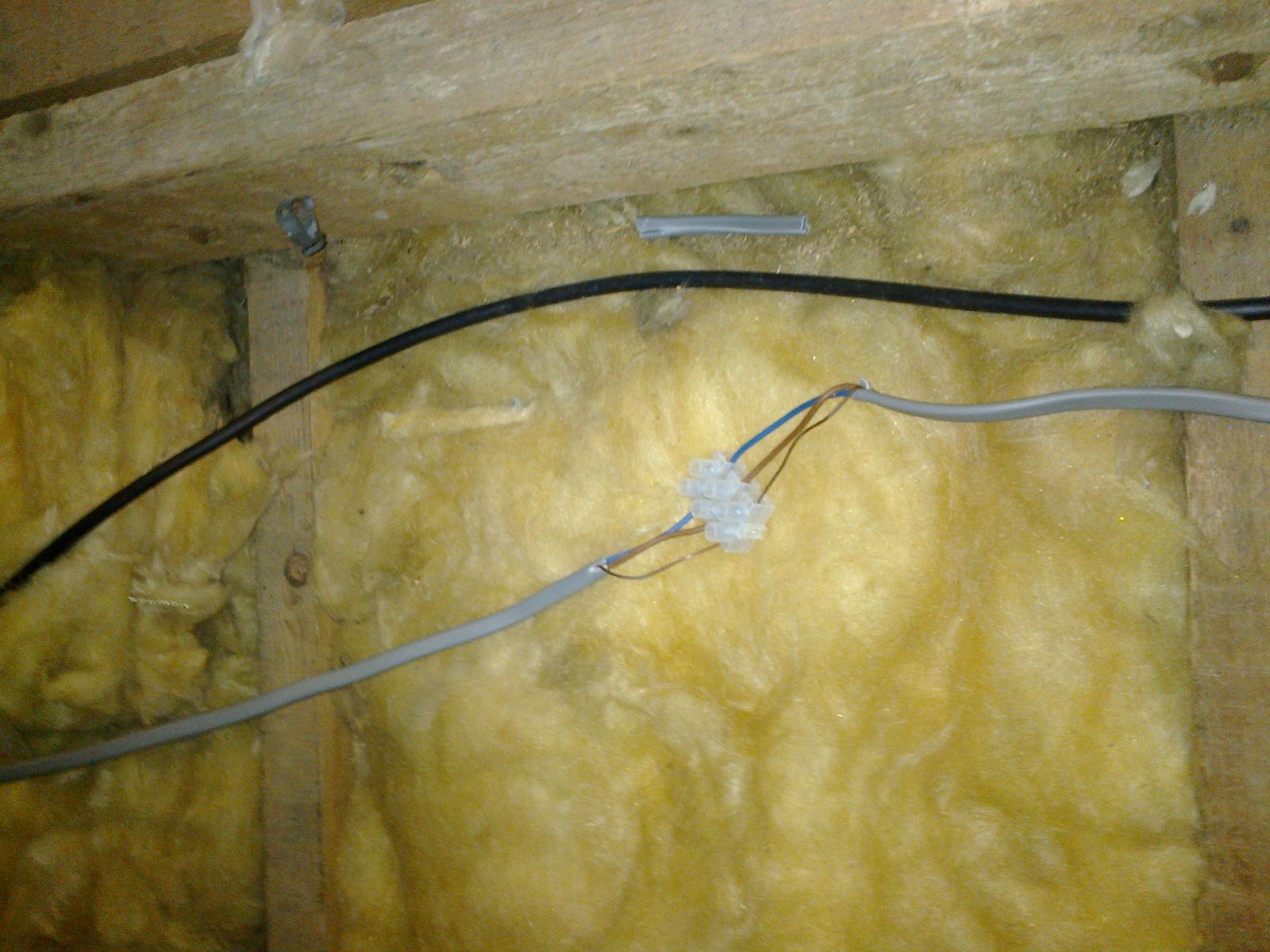

Pulled back one layer of insulation to find this. It was a live lighting circuit. Not even insulation tape around this one. Oh and the green/yellow sleeving is missing as well.
Reactions: 1 person
