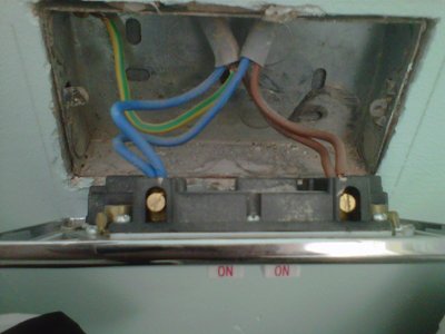

Hi,
Is this a fault on the side of the DNO?:
Void top floor flat (Council) (1 bed I think, not that it makes a difference). Been rewired by another team in company then we went to 2nd fix after plastering and kitchen fitting ect and then I noticed that the mains in to the flat (before bullet) where in 10mm cooker cable going down from the bullet in to gas cupboard under the fuse board cupboard then out the bottom of that cupboard. left in the air, not even trucked.
And on the earth only some of the earth strands where connected.
(Earth cable that is insulated is gas bond).
Sorry that images are sideways.
Thanks

Hi,
View attachment 18583View attachment 18584
Thanks
Hi,
Is this a DNO fault or are they allowed to do this?
Thanks
