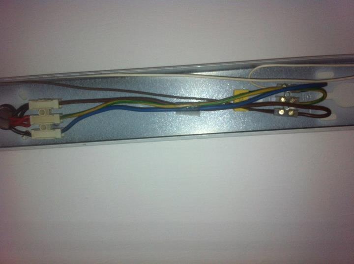

Recently had to do a bit of fault finding on a couple of machines, the panel's a bit of a mess
Like most of the equipment it's fed with SWA, even if it's on wheels!
Another panel, note the DIN mount PSU lying in bottom of enclosure
For the time it takes to make it look tidy why the hell do people leave things like this! I would be embarassed to leave an abomination like that
Unfortunately the people who buy the equipment try to find the cheapest second hand kit that can be modified (bodged) to do the job, it rarely comes with drawings so fault finding means pulling cables out to trace them.
