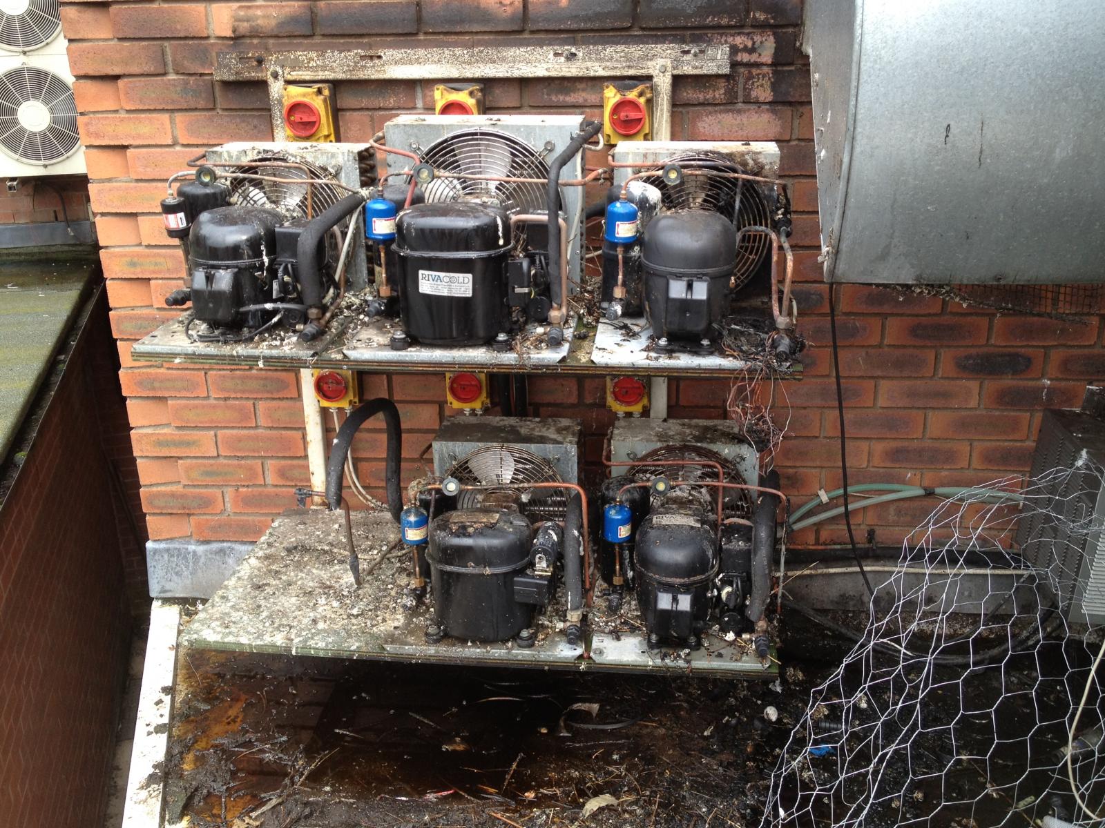

Here's a nice one if you like pigeon!
Called to a restaurant/bar a few weeks ago at the end of the day which had just had a fire from the fridge cooling units on the flat roof at the rear of the place.
Fire brigade had been and put it out but i was asked to come and check over the wiring.
Every inch of the units were covered in crap, feathers and sticks! The unit on the top right is where all the crap caught fire and you can see whats left of the wiring from that unit in a copper tangle. Plenty of fire damage and the isolators had all melted.
It was all poorely covered by a big stainless steel housing which was sat away from the wall, too easy for the pigeons.
I was asked if i could get them running by that night even after i'd shown the owner the state of it! I disconnected the circuits and told them i'm not touching anything else until a cleaning firms been in!
I was called in again the next day, a manager wanted to know why all the fridge temps were showing 14-16 degrees...
what a mess ryan! looks like the whole set-up needs replacing, they should have removed all of the stock and found somewhere with a freezer to store it,
don,t inhale pidgeon dropping/dust mate, it can cause serious health problems
Well I know why the stainless steel cover was left off now, the mounting of these units are completely wrong!! The fans are facing, and that close to the wall and isolators it's a wonder how these compressors worked with the cover on for any length of time.
I wouldn't mind betting that those isolators were suffering heat damage long before this pigeon crap fire... These units need tuning round and a mesh grill incorporating in the cover. The set-up needs free flowing air through the system....
